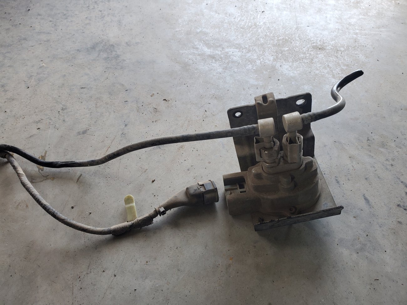

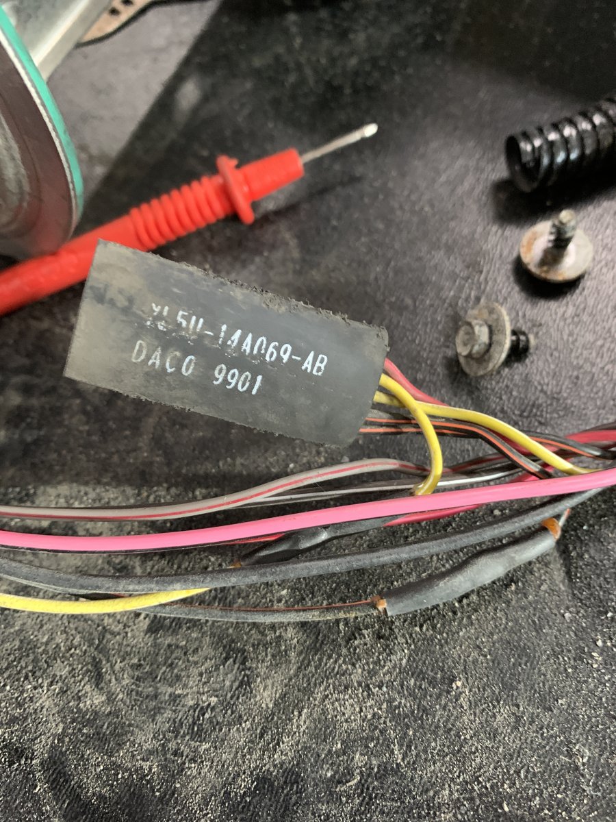

Do you have this little critter just past the fuel pickup? (in the 2000 - the one that was FFV from the factory)
AK Ranger has a 1999 3.0 FFV and this pic came from him, so in '99 the FFV's definitely had some extra parts.
That is a DC/AC converter to run the sending unit on AC (ethanol apparently gives bogus readings on DC or something)... right after that in the fuel line is the flex sensor (after the fuel filter, before the engine)
here's his quote on it:
"There is also a Flex Fuel sensor, in the fuel line. It is between the filter and engine. The fuel goes through it and it has some electrical connections. "
The Ranger never came with a flex fuel 4.0, that would explain why there is no place in the harness for the sensor.
the Taurus Car Club calls that the anti-slosh module. :dntknw:

I don't see the DC/AC convertor on the 2000 FFV but I suppose it could be tucked inside the frame rail next to the tank?
I pulled the FF sensor from the 2000 FFV

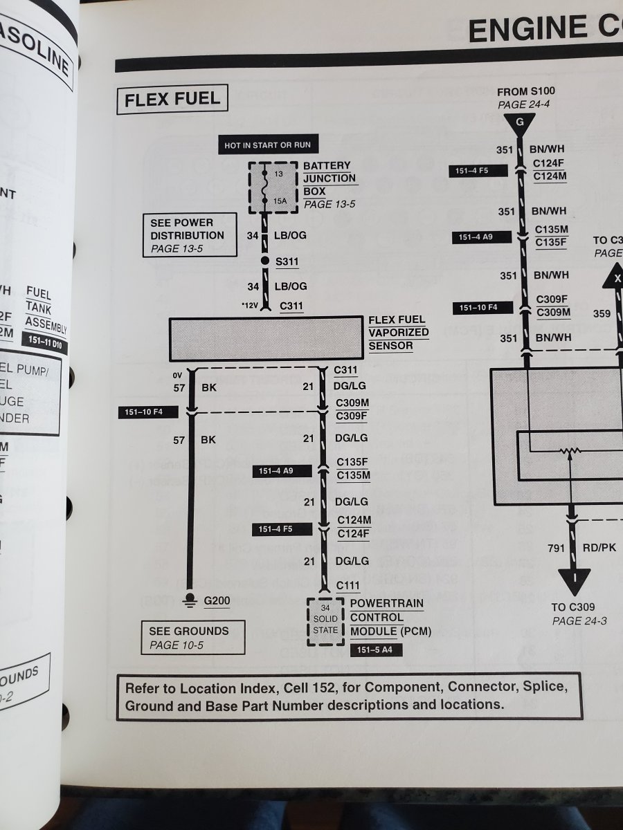

I also have a factory ford wiring diagram book for the 2000 ranger and the wires match on the plug to the diagram

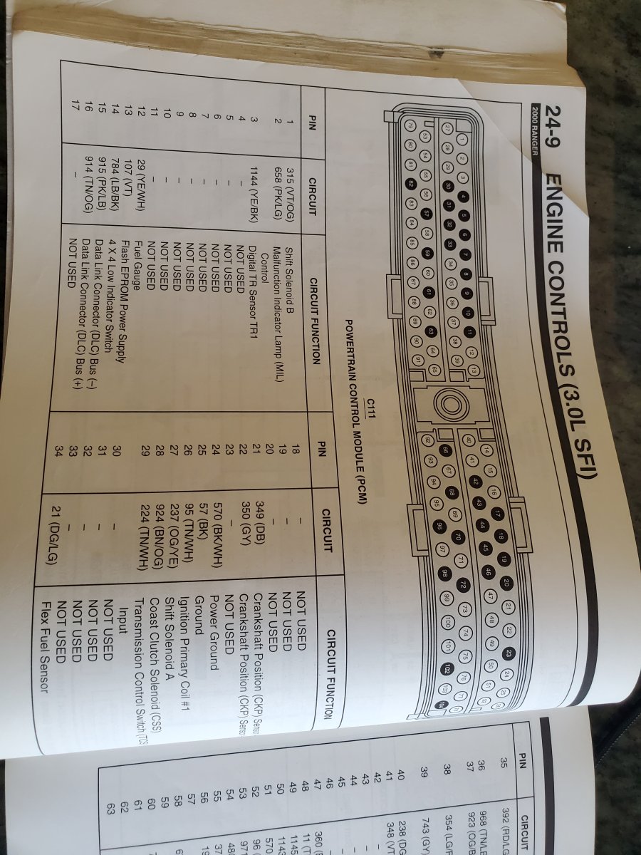

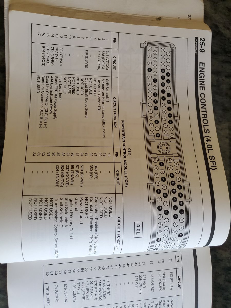

I checked the PCM inputs in the wiring diagrams for the 3.0 and 4.0 to see if it might exist where I could tap into it to either install the FF sensor on the 1999 or use an emulator to provide the PCM with a suitable input signal. Pin 34 on the 3.0 PCM connector is the DG/LG FF sensor output. Pin 34 is not used on the 4.0 PCM so I suspect that the 1999 PCM is not configured to provide a FF sensor output to the ECU even if I added Pin 34 as an input to the PCM
I think my next move might be to compare the 3.0 and 4.0 PCM connections pin by pin to see if everything else is the same. If they are, maybe the easiest option would be to swap the PCM from the 2000 FFV into the 1999 and add the pin 34 input from an emulator.

Comparison of the 3.0 and 4.0 PCM connections show four differences. I'm not too worried about pins that exist on the 4.0 PCM input but there are two (besides the FF sensor input that I would add) that exist on the 3.0 but not on the 4.0 and I don't want to trade one CEL code for another..
Here is a summary of differences:
3.0 PCM
PIN 6 - Not used
PIN 34 - FF sensor
PIN 47 - EGR Vacuum Regulator (EVR) Control
PIN 65 - DEPT sensor input
4.0 PCM
PIN 6 - Output Shaft Speed Sensor
PIN 34 - Not used
PIN 47 - Not used
PIN 65 - Not used
