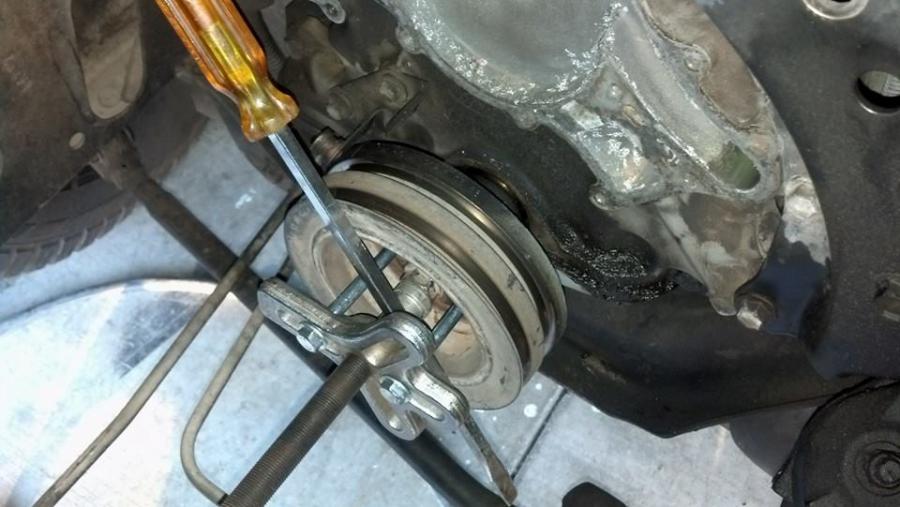

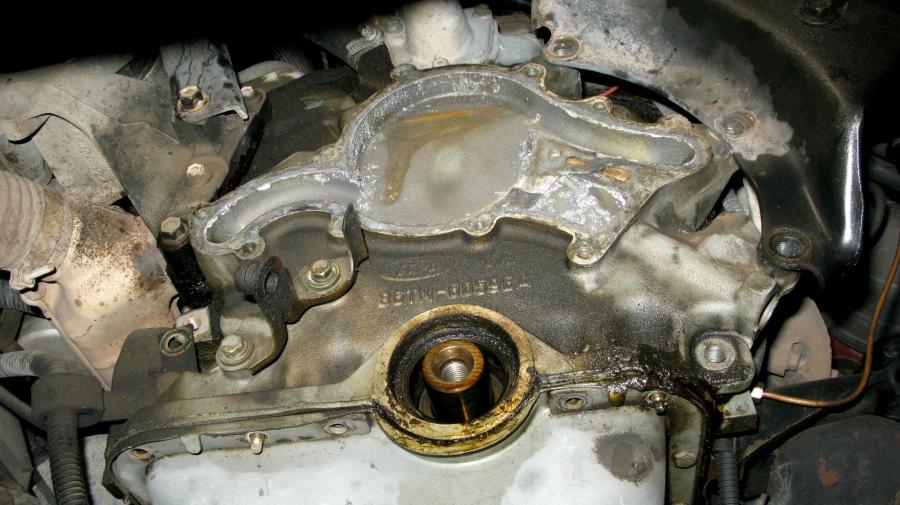

Ok, I will try to pry it a bit on the top and side, I see the two studs where I took the nuts off from. Will get back with pictures too

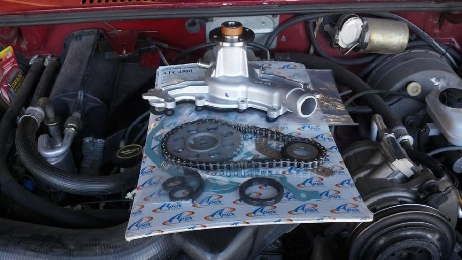

Nothing better than shiney new parts!
Yes, it is off, these are the pics along the way, just can't seem to get the cover to budge, all bolts that I can see are off, including the pan bolts and two nuts
alternator bracket bolt, power steering pump bracket may be hiding a couple of bolts, and/or maybe one of the bolts for the timing pointer may run through the cover to the block. i think i needed to remove the alternator and a/c-p/s brackets to get the cover off.

Thanks, nothing behind those brackets, I will take those pointer bolts out, they may only be in the case, but who knows!
went out a while ago to take a look and could see the holes in my timing cover are threaded for that pointer. so not a solution. heh. yeah, it was about 9pm or so as i was closing up that job so some non-essential stuff are still sitting on my work bench.
i also remembered those studs at the bottom of the cover running through the pan can be unscrewed and removed. now i remember having them off. it allowed me to slide the cover back on in a more vertical position as opposed to placing the bottom in first then swinging the top into place and having to deal with the top being blocked by the thermostat housing mounting area.
