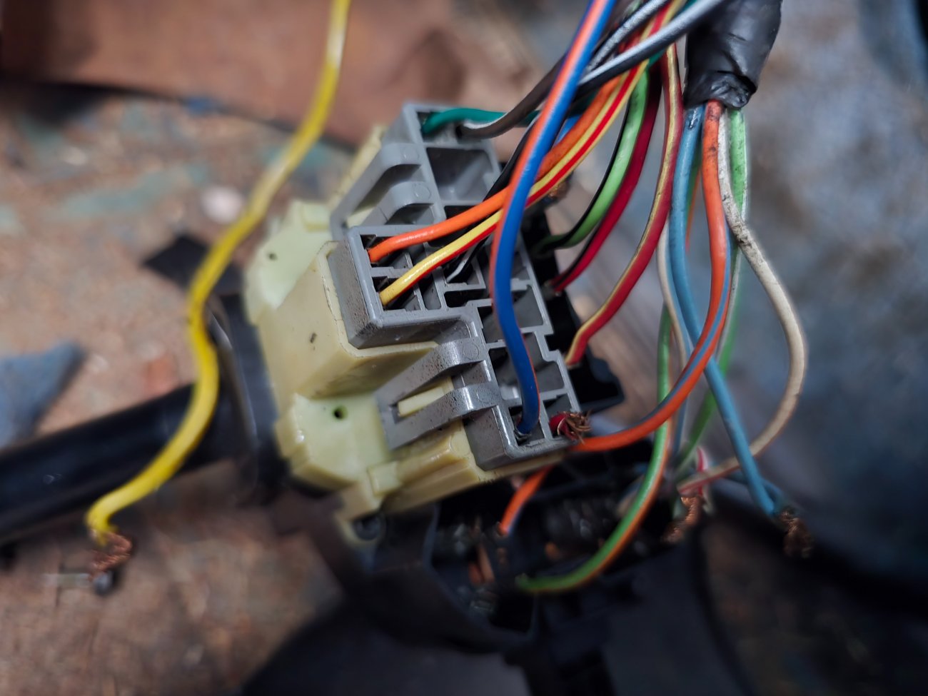

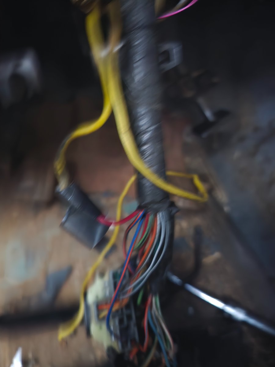

Could bad wiring at turn signal switch be the issue or am I solving a different issue I hadn't noticed

Got turn signal patched up and it shows its charging for a bit and then goes back to no charge its trying to run longer but is popping while running

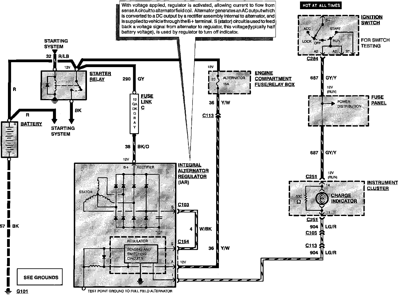

Alright checked voltage to wires on alternator circuit since new alternator was put on. The yellow white wire is at 12.5 volts with key off as it and the light green red wire only has 3.48 volts with key on after its connected to alternator unhooked from alternator its at 12.5 volts
I went to alternator rebuild shop had them test new alternator it tested good and they made old alternator a one wire alternator to bypass alternator wiring circuit. Truck still won't run. While truck is attempting to run the one wire alternator is putting out correct voltage even tried a different battery again. Hooked up my battery charger and it ran but it only goes up to 8 amps of charge on battery charger. So truck will run on low amp charge or on battery power but not on alternator charge
What does the large output wire read with the meter with the engine off? It should read battery voltage. There is a fusible link in this wire (fusible link C)

I've redone that wire when I went back over wiring i could shake it and reading would jump around. But now it reads 12.96 no matter how hard I shake the wire
