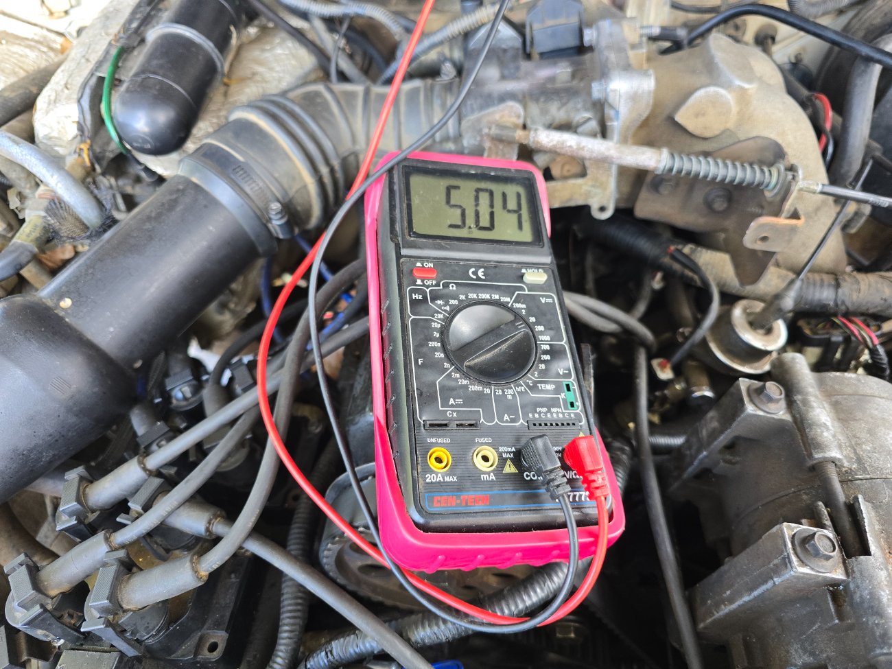

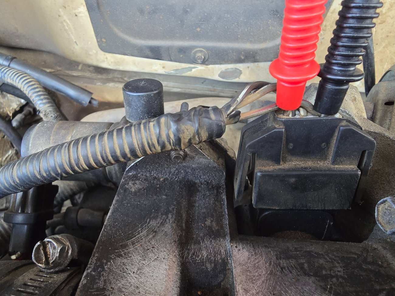

Injectors with harness disconnected ohmed at 14.4 to 14.8 with alternator connected and turning over tps voltage never went above 5.11 volts and voltage to battery never went to charging voltage i have videos of truck with belt on misfiring and videos of truck running with belt off files are to big to upload
Where are you checking tps voltage? Reference voltage is 5v, one pin should be ground and the remaining pin should vary 0-5v with the throttle.
Far left wire and ground I'll go make sure I'm in right sport update checked to make sure I was in correct spot and the middle wire varies when I move throttle middle wire didn't go over 4.98 with truck off key on

Can you have the meter hooked up the same way and try to connect alternator while running? I'm wondering if there is a spike.
Tps voltage stayed this time at 5.03 volts and when I turned it over and engine attempted to run stayed at 5.03 volts

The gray/white wire should be the one you are checking for tps voltage. Should be 0-5v and vary with the throttle.

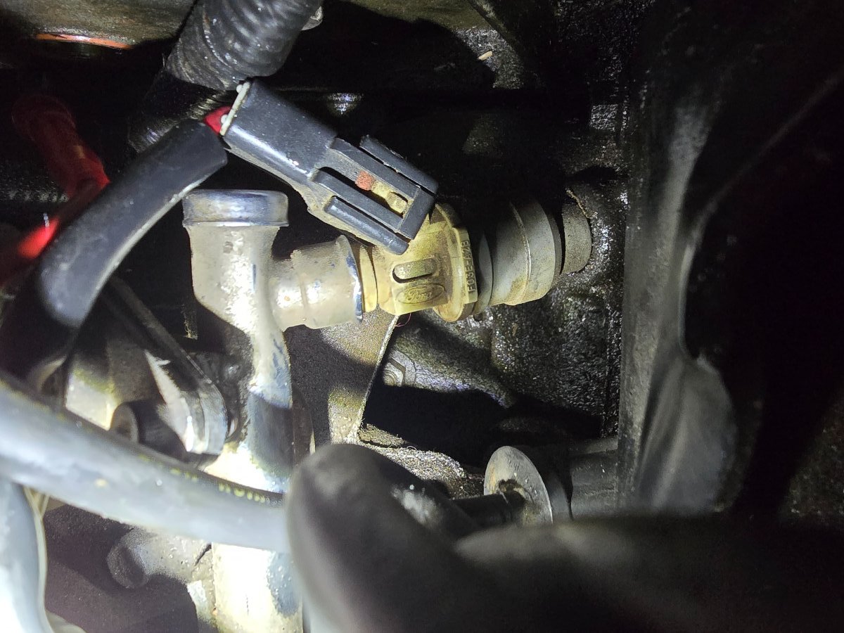

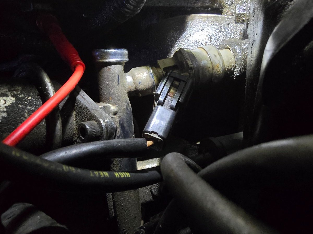

Alright I've put 2 new crank sensors on and a new ignition module when problems happens if haven't tried new coil packs yet. Only Codes I had was a engine coolant temp sensor code and when i checked the grey white wire it stays at 0.65. Old Codes on truck before problems happened were secondary on old ignition module miscommunication code and tps code i put new tps on before problems and that code went away then problem happened so I started with timing then ignition control module and truck wouldn't back fire or anything still had code for ignition control module miscommunication and then changed crank sensor and decided to see before I put serpentine belt on if truck would run it did so I put truck together then got it in thinking I was ready for test drive and got nothing but backfire or a split second crank so I thought maybe bad crank sensor since it was cheap so I order another one and had same problem so I googled symptoms of what I had and it mentioned alternator so I pulled alternator and went had it tested it tested bad so I took to place that rebuilt it 2 months prior to the problems and they rebuilt it and I only have had it tested at oreillys since they previously rebuilt it and they say it tests good I don't know whether to start with replacing coils first or try an ecm first

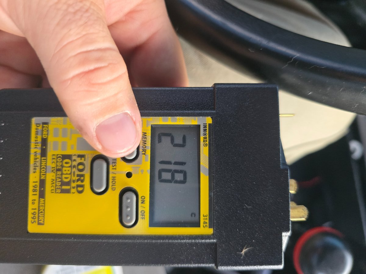

It was code 218 it went away when I changed crank sensor out and haven't been able to get any new codes to pop up

Code 218 is the IDM circuit between the ignition module and the PCM/cluster.

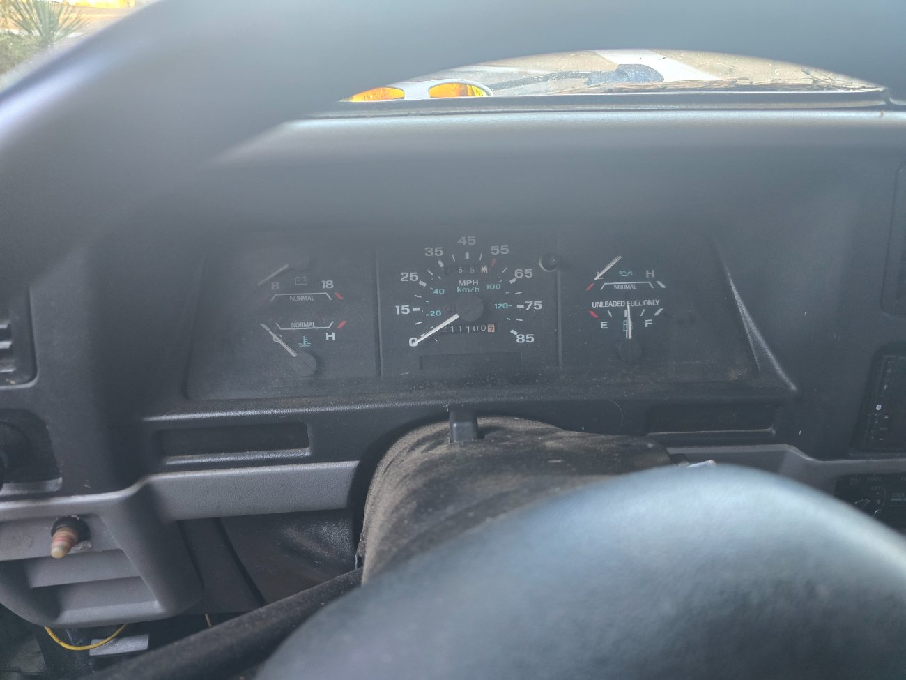

Does this truck have a tach? If yes, you might want to disconnect it. I've seen Ford tachs cause hair pullers like this. Access the cluster connectors and unplug connector A that has the tan/yellow wire. Leave connector B plugged so it will charge.
Truck doesn't have a tach
