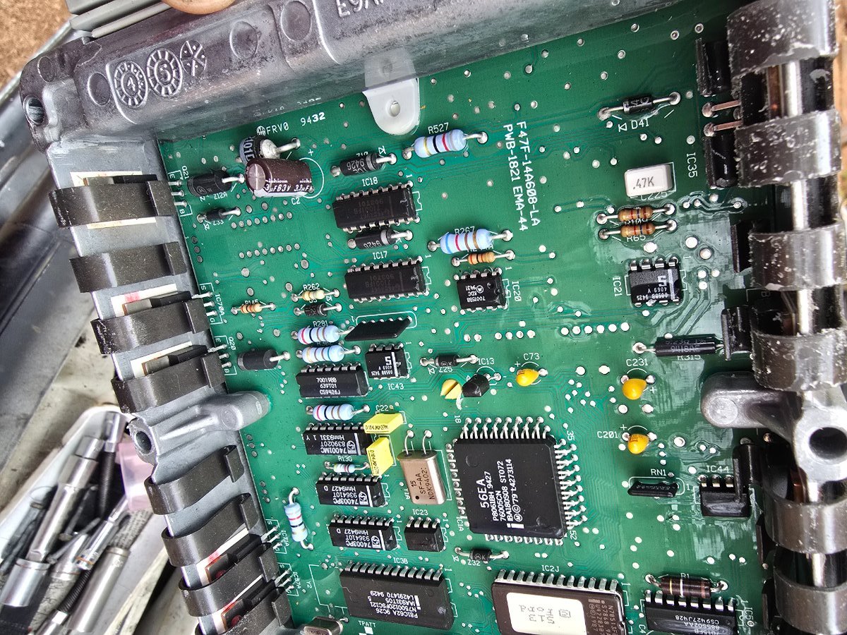

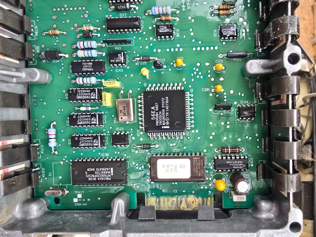

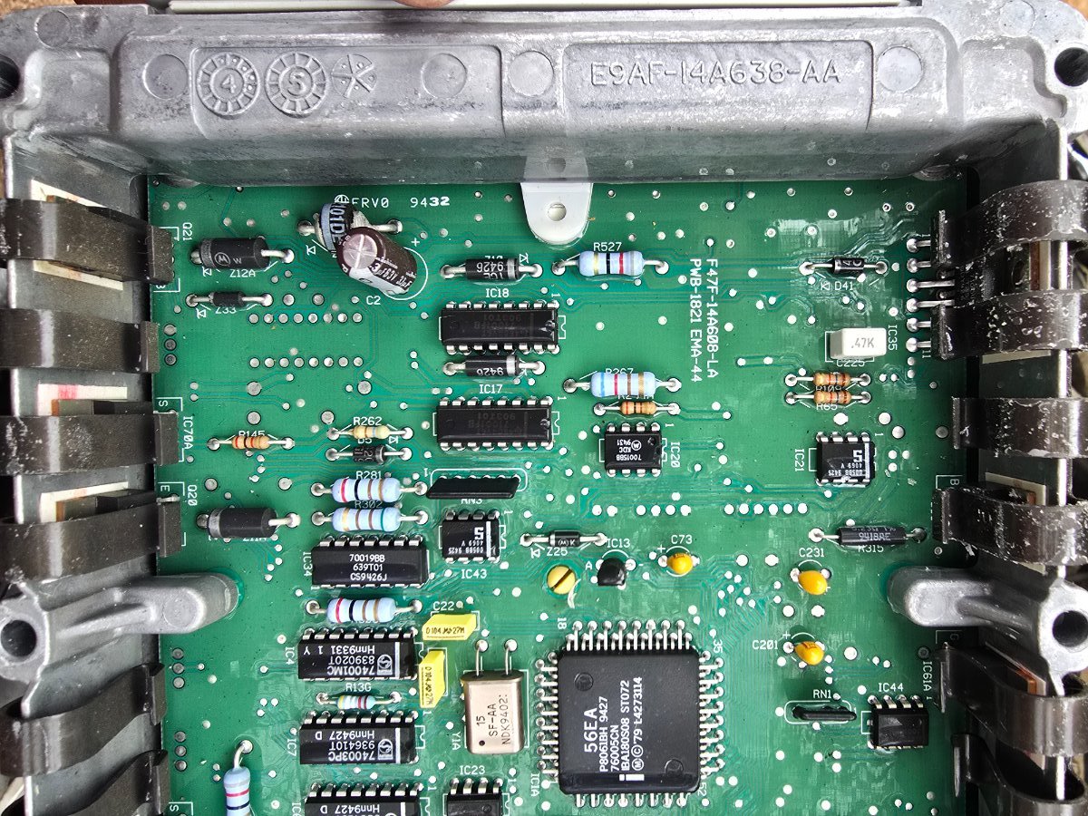

I don't really see anything wrong with ecm board

What's going on with that card edge connector in the second picture? Looks like it's covered in butterscotch fudge. Is that connector used in the truck or is that just for factory diagnostics or something?
I'm just looking for anything/everything abnormal.
I believe that's a port used for diagnostics or a daughter board in earlier iterations.
Isn't that the J3 port? Same one used for programmable tune memory modules?
Looks like very old dielectric grease.
But I fail to see how having the alternator disconnected makes anything work unless the alternator is outputting something it shouldn't be.

The black, barrel shaped items on the circuit board are the caps and they look ok.
