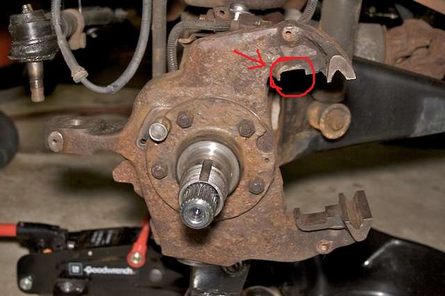

so the other day i was driving and felt something pop, turns out it was the upper tab on the passenger side steering knuckle that holds the inner brake pad in place, snapped clean off. fabricated a new tab, welded it in place. a few miles later snapped off again and lost all brakes, almost crashing in the process. at this point i believe i need an entirely knew knuckle for that side? anyone know where to find this? or have one for sale?? this is my only vehicle, as of now have no way to get to work or anywhere so any help is greatly appreciated! I am located in CT and am willing to pay for a fix!
can anyone confirm if the knuckle is made of cast iron or cast steel please?
i added a picture showing the tab that snapped off. I DO NOT have the tab, i attempted to fabricate and weld one out of steel but the weld did not hold at all. Should i consider trying to MIG weld again with a wire that is specifically for use with cast iron? would brazing be a better option? i would prefer to not have to take the entire knuckle off, considering the labor that would require (ball joints, etc..) but i already almost crashed once due to a bad weld failing. any help is greatly appreciated! this is my daily driver!

I believe the knuckle is cast iron. Special rods and technique needed to weld successfully. Oxy/acet and brazing rod might get you going until you get a new knuckle.

thanks for the response, we were also debating if the knuckle was cast, but cleaning and dropping a bead on a different part of the knuckle seemed to work, but i guess not. unfortunately i know absolutely zero about brazing.

the tab that broke off is fairly small, do you think it would be better to just make the tab out of the brazing rod, or to fabricate and weld a new tab? what type of metal would work best with the cast iron and brazing rod if i do make another tab?

I can't help much more than I already did. { I'm a self taught welder with not much experience with cast.} Welding to cast is tricky because of thermal expansion characteristics and the metal structure itself, cast has a larger grain that promotes cracking. Not thinking I tried welding some 1/4" plate to a large brake drum. After it cooled a little it went POP as the cast cracked along the weld joint. Brazing is a little more forgiving as it will "move" a little. IMO I don't think filling with brazing rod would work for long, it is too soft. But brazing a piece in would work better because the piece is hard enough to take loads, the brazing is acting like a glue. Personally, I'd use whatever I had handy, bearing in mind that it needs replacement asap.

thanks man i really appreciate it, it looks like i'm going to have to replace the whole knuckle unfortunately, which sucks because the truck is a total beater and not worth much to begin with. i'm really broke and trying to spend as little as possible. is it possible to reuse the old ball joints if i don't damage them pressing them out?

The ball joints are on the knuckle itself. With a little luck, the new knuckle you get from a wrecker might also have good ball joints in it, so you'd just swap one knuckle for the other.
If not, then yes it is also possible to swap the ball joints out if yours are still good.
Yes, replacing the knuckle is the only safe way to handle this.
