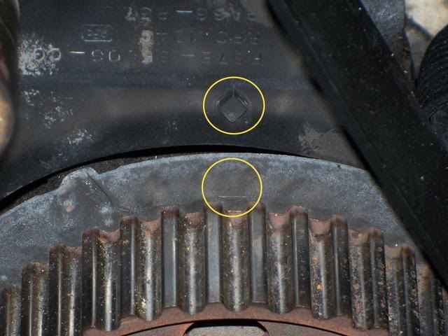

I looked long and hard trying to find this info, and finally resorted to visiting a freind that has an auto repair shop, and he looked it up on his alldata. Even that wasn't quite as clear and consise as the pics in that article....... Had to really blowup the "pic" (drawing) from alldata, in order to see the specific marks and how they were supposed to be aligned.
The pic of the triangle and diamond marks lined up is, in my opinion, priceless.
I saw the article the day after I reset my timing belt. Since the last person who was in there did it wrong, I was really at a loss as to how it *actually* supposed to be set.
Just as an example of how wrong they had it, they lined up the dimples with the marks on the cover. Here's a quick pic of the cam gear, showing the correct way, and the dimple can be seen 5-6 teeth over.....
Need B2500 Engine Specs
And a pic that shows the wrong way to set the aux gear.....
I know the aux gear is incorrect in that pic, but it shows just how far off it was, as it was also lined up with the dimple. The proper mark is a diamond, and is nearly 180* from the triangle mark.
Just for the sake of it, here's the crank gear without the pully, showing how it should be set:
This pic *should* be added to that article.
