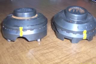

Good info! Can you shed some light on the difference between the powertrax and the lockright? They seem very similiar.
hey guys, as far as i know the powertrax is the same thing. This cost me right around 340$, plus i had to pick up an open carrier (50$), as i had a limited slip in mine previously. It is a VERY good investment if youre even considering it. If you have any other questions feel free to ask.
Oh, and just so you know, i DID NOT get teh notched cross pin that they say you need. I installed 4 56 gears, and yes the ring gear is too thick to install the cross pin. But....I was told by a veteran mechanic just to grind down a corner of one of the teeth on teh ring gear. There is only one little spot you need to grind and the original pin will slide right in. Reason for this is that the notched cross pins have been known to break and are much weeaker. The minute amount of grinding even isnt noticeable on the ring gear, and doesnt touch the pattern when you run it.
There are real similar but the No-Slip does not have the shear pins or the spacers as shown at the bottom right in the picture. Actually easier to install but usually run about $120 more than the Lock-Rite. Did learn from first install to paint the drive gear and the driven coupler with some paint to orientate the proper location of the missing tooth, they only go together one way. Once you start the install, real easy to get them out of alignment, everything being covered in oil. It actually took me two hours total from start to complete finish, one of the little springs flew off on me.

Do not use the notched cross pin. You can grind a little and not have to use it. My mechanic who did my gears said there is no way he was putting the notched one in there due to how it was made.

This one says it's a lock-rite, not no-slip, for 28 spline l/s.
