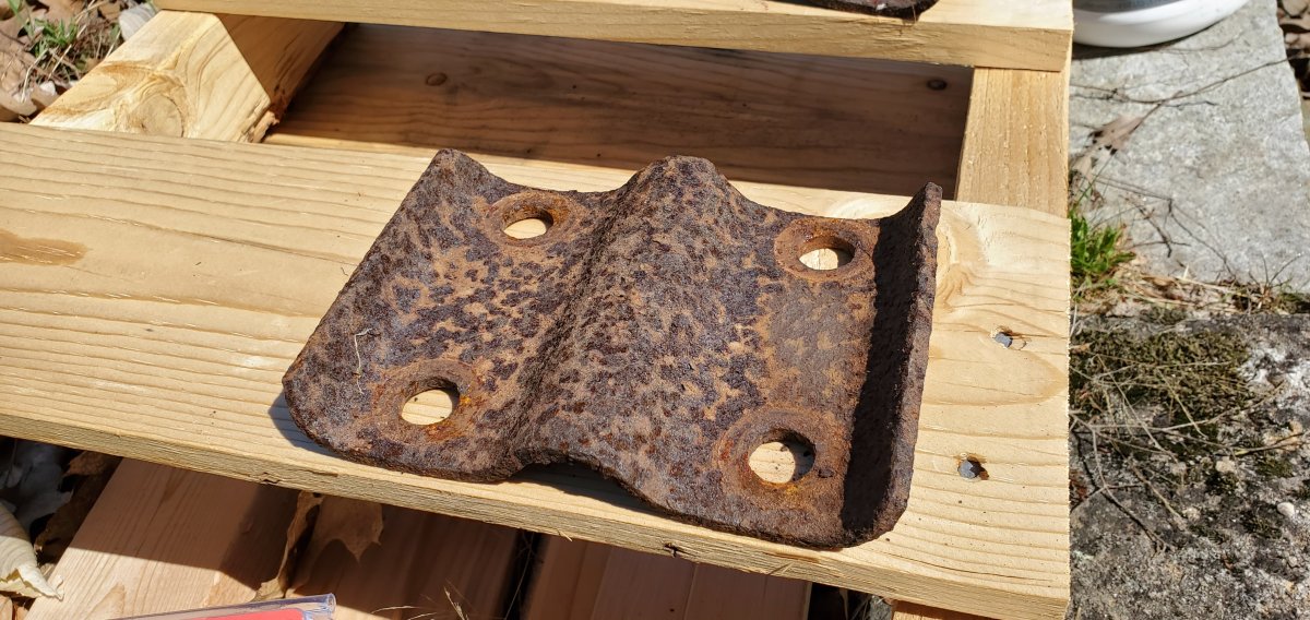

I bought a gallon to do the frame & axles on my squarebody, and tested it out on some ubolt plates so I could know what to expect.
35 year old salt belt u-bolt plate, freshly pulled.

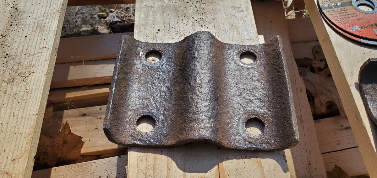

Quickly shined with a wire wheel, and wiped with alcohol.

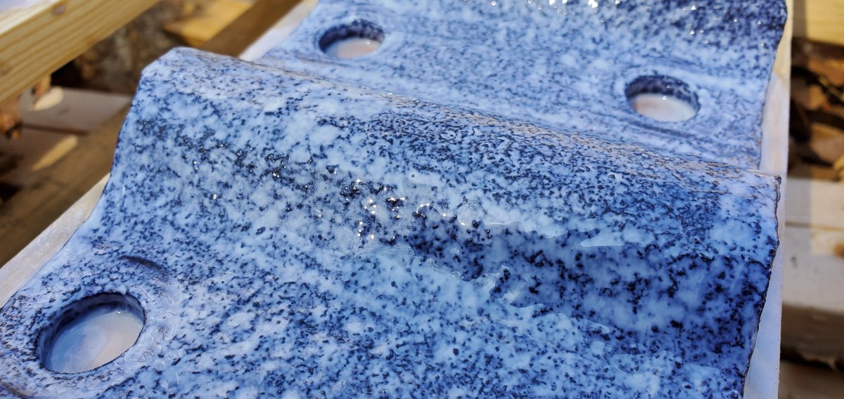

Apply the corroseal as thick as you can get it on, its consistency is a little thicker than heavy cream. The surface of these plates turned black almost instantly.

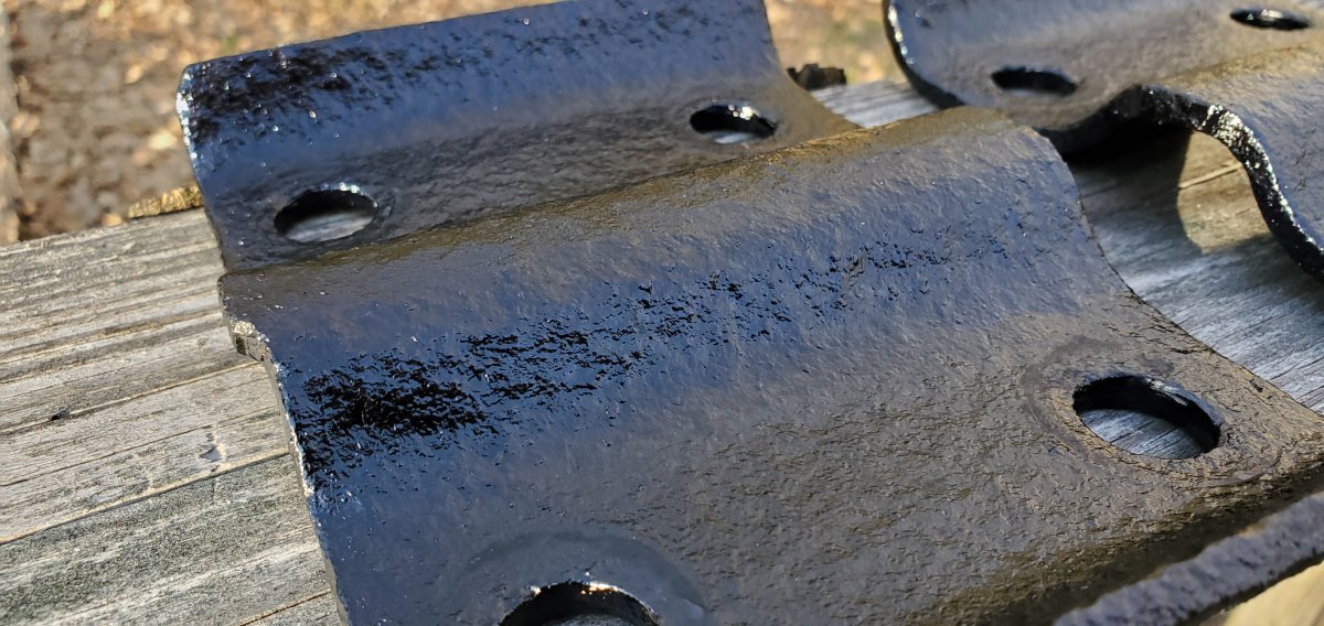

Took about half an hour or so at 50°F for the plates to be dry to the touch. Not tacky... dry. I took them inside for the night so they could fully cure in the specified temp range (45°F to 100°F)

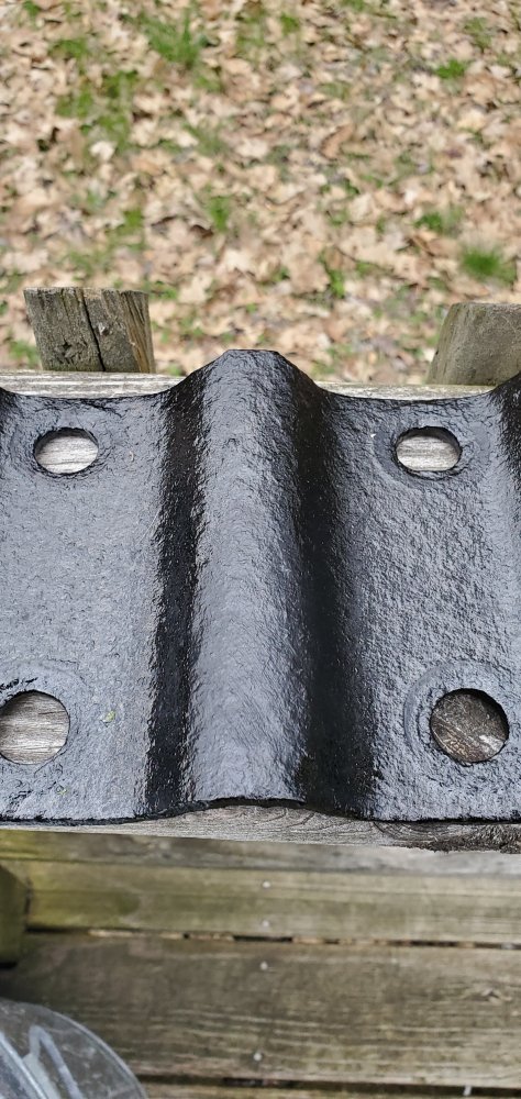

After they cured for 24 hours, I hit the finish with the wire wheel again to see for myself how tough it is....
It's tough. Wire wheel couldn't even dream of stripping this stuff off (picture is post-wheeling)
I'm really super happy with the 70$ I spent on getting a gallon of this shipped off amazon. I'm not going to drive the truck in the salt/snow.. or probably even the rain.. so this application really isn't going to be a "torture test" for its durability.. but I have no doubts that this crap is going to properly seal up its frame for the rest of its life.
