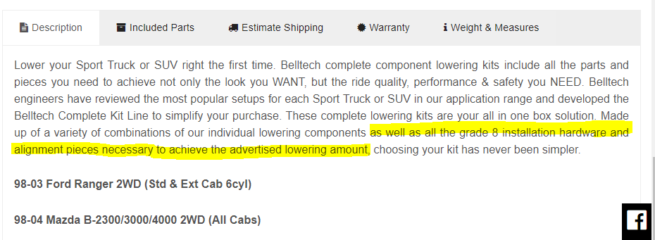

My single biggest annoyance with this kit is the fact that while it does come with alignment cams, it comes with precisely 0 hardware. Despite what is stated by Belltech, this feels like more of a miscommunication vs. a genuine attempt at scamming. The contents and photos list the 3 main components, coils, cams and leafs. However, product descriptions do state that the kits includes all the grade 8 hardware you need:
This simply isn't the case, I had to purchase my own alignment kit with bolts and cams to complete the job, and had to reuse/replace bolts to mount the leaf springs in the rear. A real shame because this kits single greatest value is that it's supposed to be the most affordable/simple way to lower your ranger, but in total I ended up having to spend nearly 200$ CAD extra to get the right hardware to make this kit work properly and install safely.

The alignments cams... As I mentioned previously, the kit doesn't include ANY hardware. So you'll need to buy some yourself if adjustable cams haven't already been installed on your truck. The cheapest solution I found was this AC Delco kit, which has an even greater range of adjustment, which is needed. Since I couldn't get the truck to reach anything near a decent alignment just from the string and jackstand method while using them, Thankfully I was able to install the AC Delco 3 degree cams and get the truck to a shop for an alignment.
