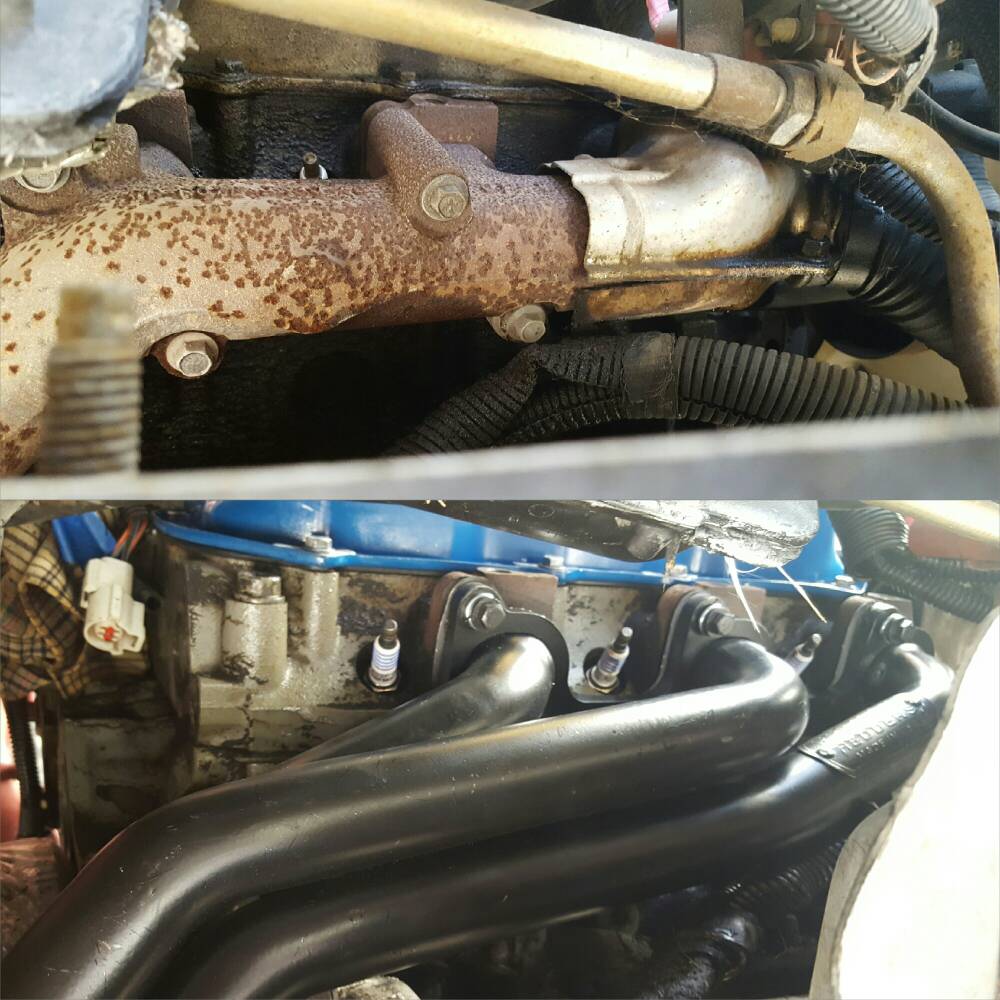

My POS Craigslist Special 92 Ranger

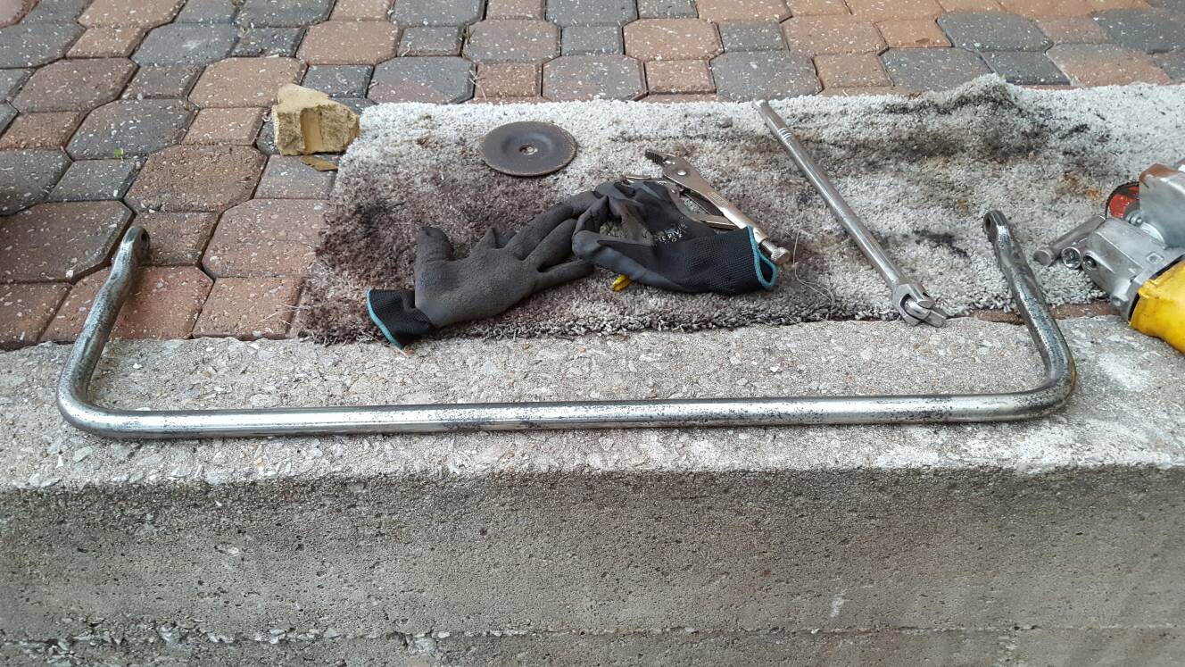

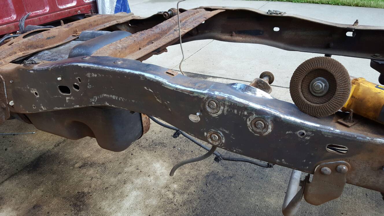

Whoa...why did I waste all of that time with wire wheels. These sandpaper flap discs are amazing
Also...yay

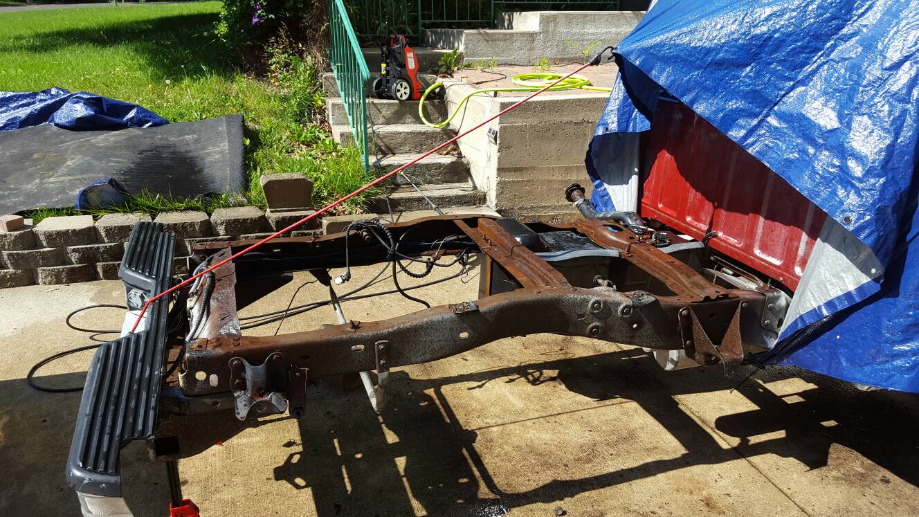

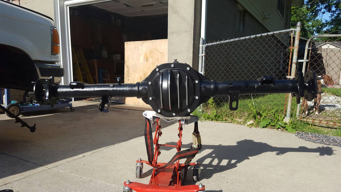

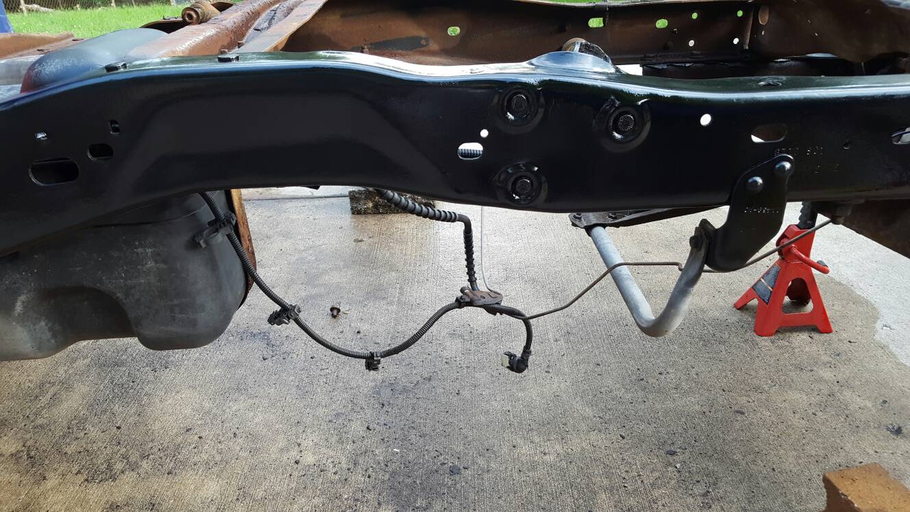

Pulled the axle back out of the garage for a good shot of it completed

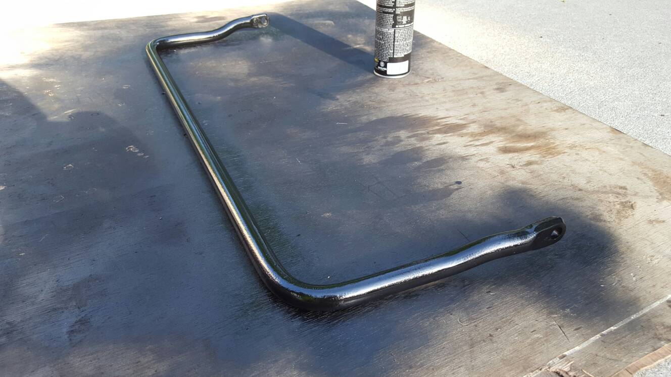

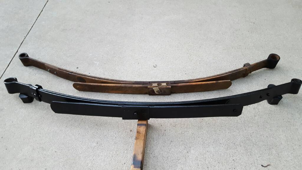

Sway bars are going black too

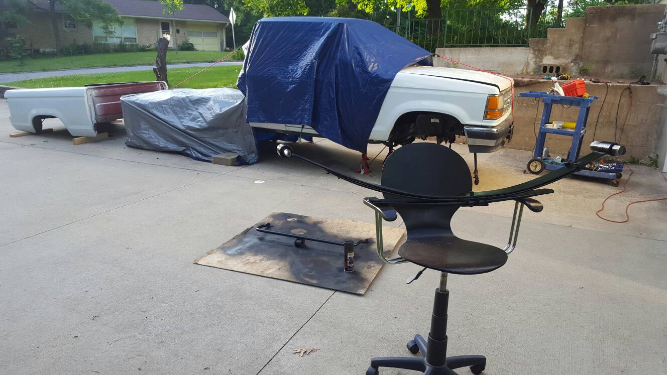

Second leaf spring has first coat

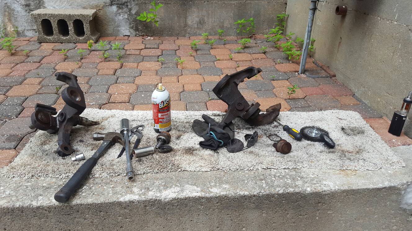

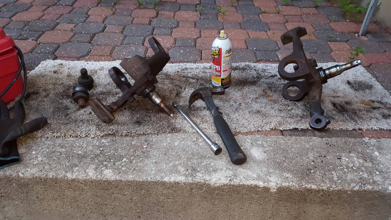

I looked up Powder Coating in my area. I'm probably going to take my front knuckles to get sand blasted
I don't really feel like grinding on those, that would take forever.
$90/hour for blasting, half hour minimum. Shouldn't take long for them to blast the knuckles.

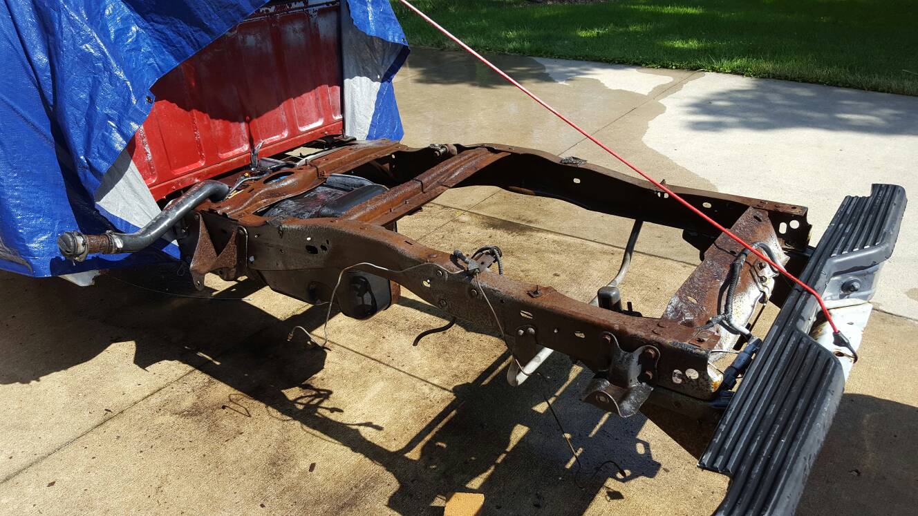

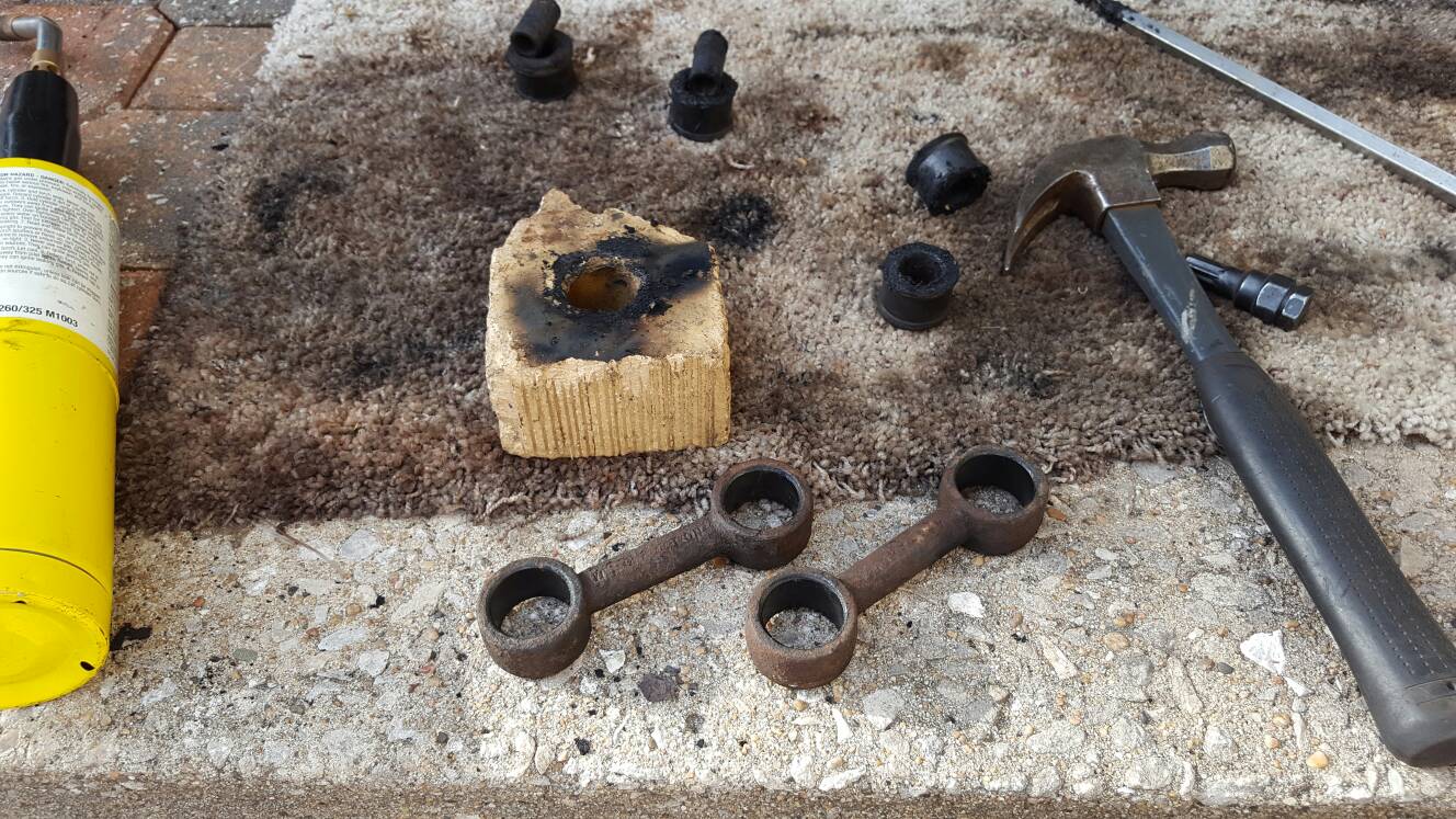

Removed ebrake, and rear sway bar.
Used a leaf blower to clean off chunks of rust, then pressure washer with hot water. Looks way cleaner already

Worked on the front sway bar a bit too
That's it...that's all I did today
I did actually finish both tho lol

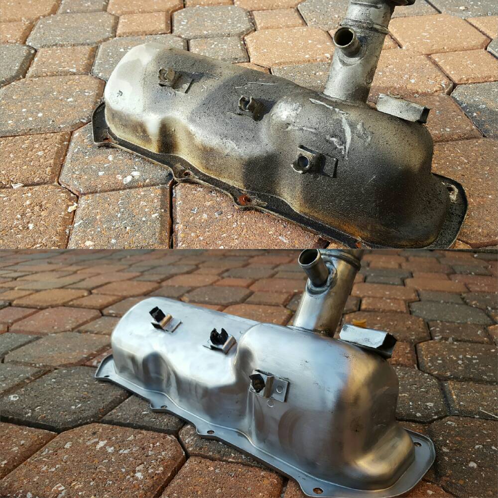

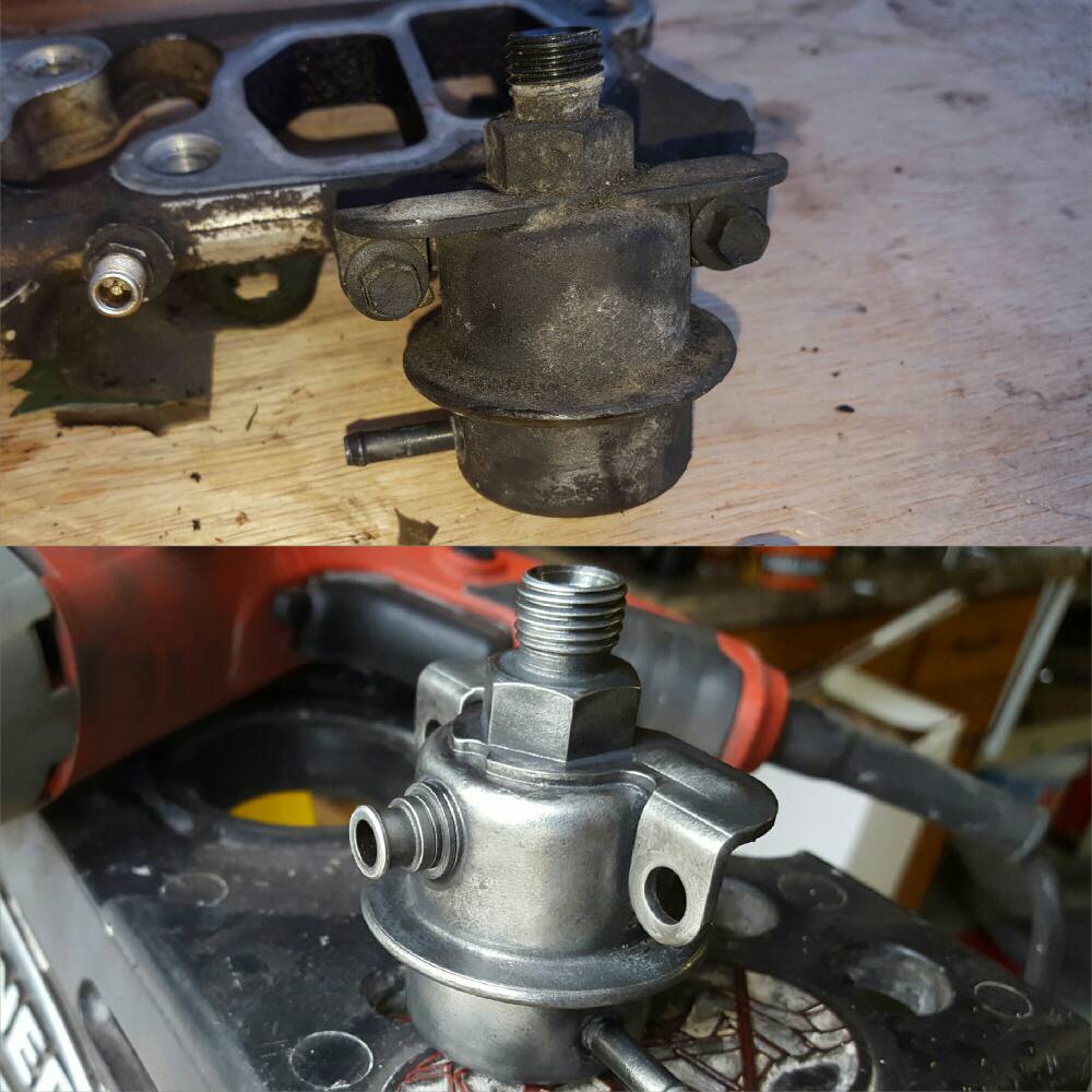

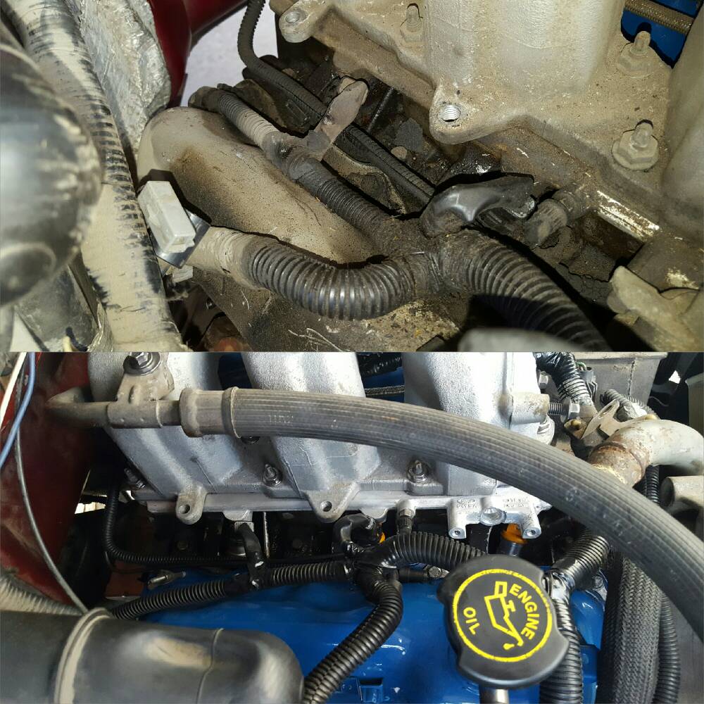

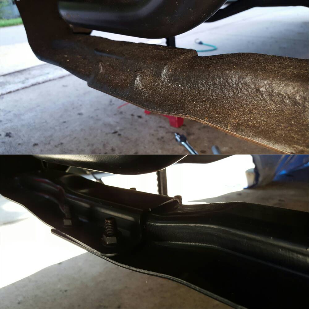

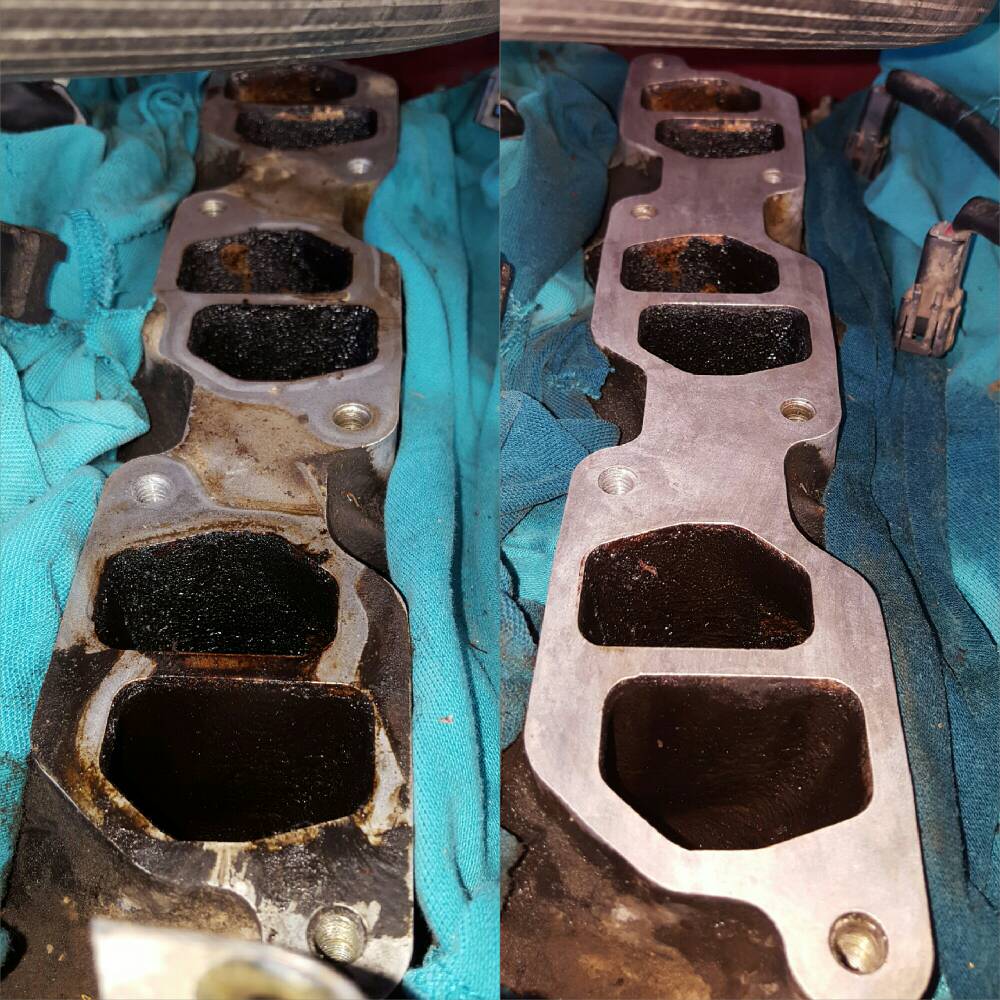

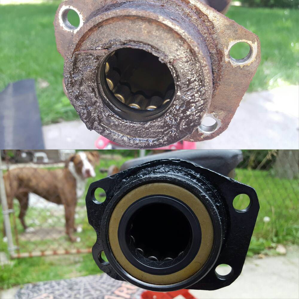

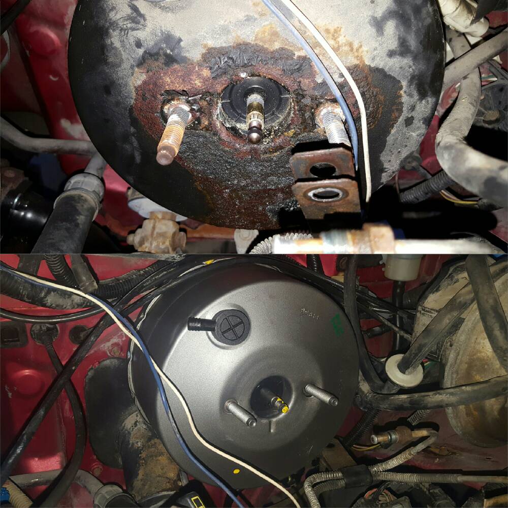

A few before and after pics of progress so far

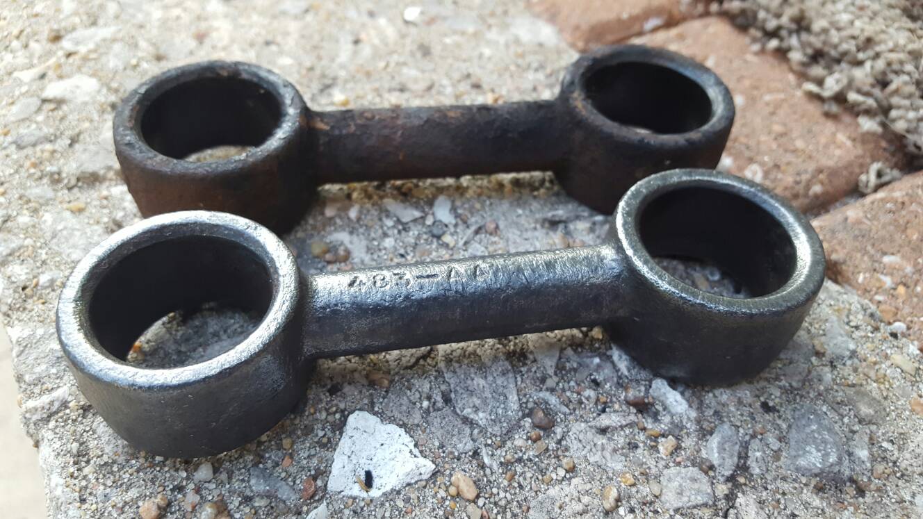

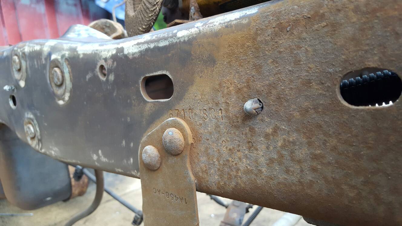

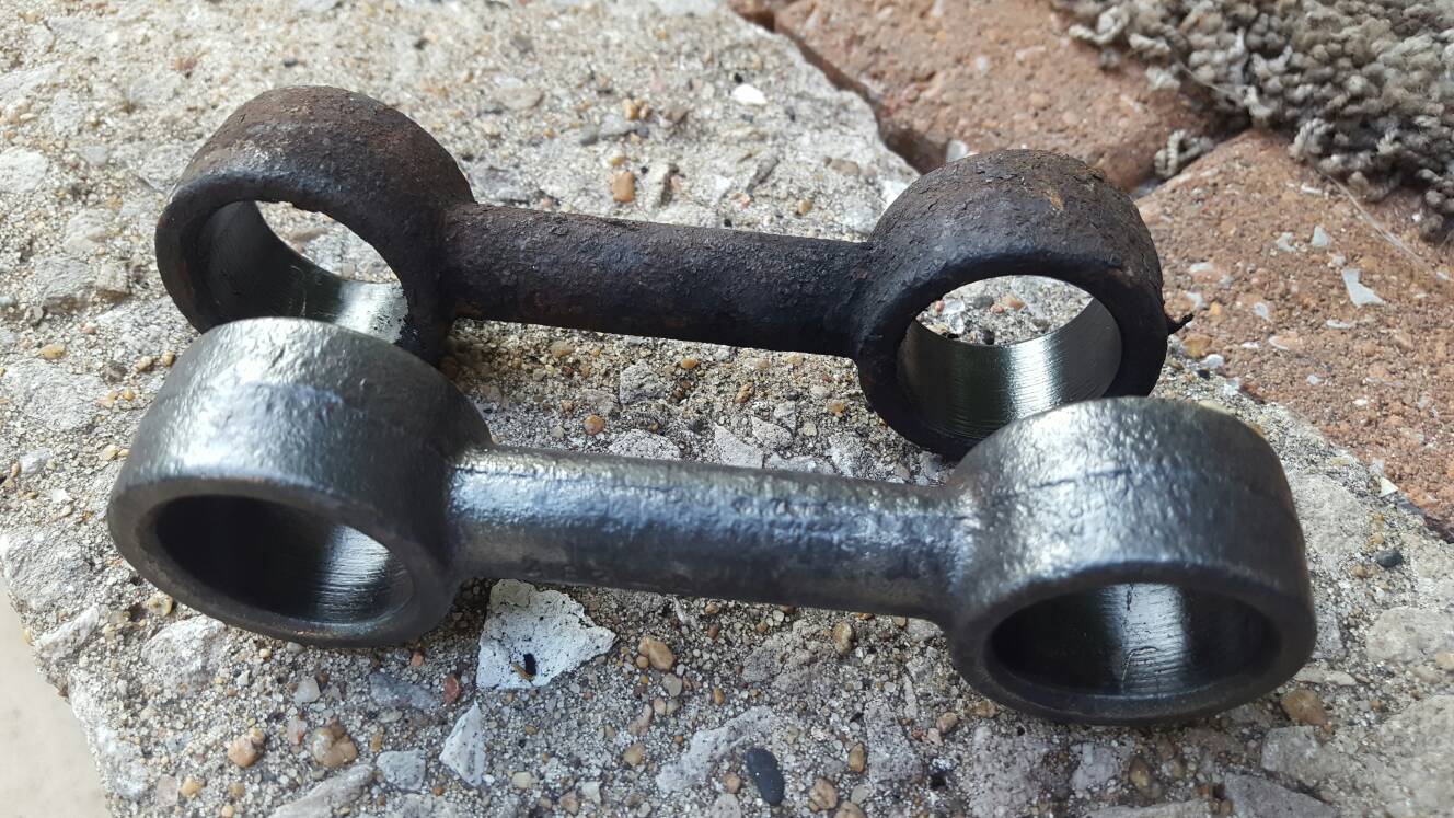

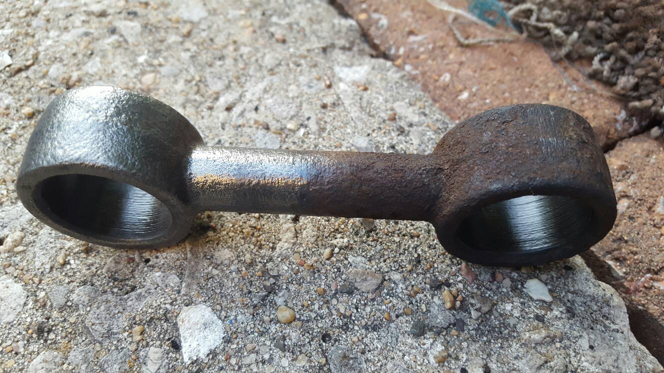

New radius arm brackets
I just can't put it back on the truck rusty

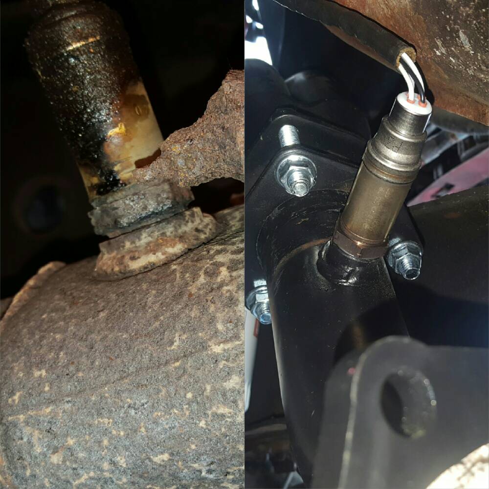

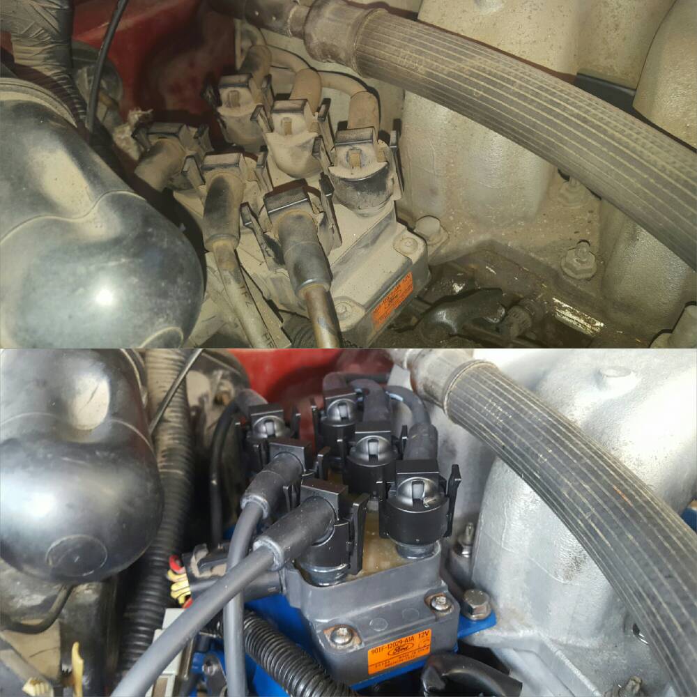

I know all of these pictures are posted here already, but I couldn't believe side by side what a difference I've made
And this was last night
