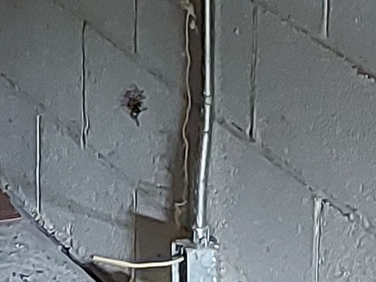

Today I walked in the shop and saw a dark object on the wall about 30 feet away. Suspecting it was a spider, and having a fear of spiders, I zoomed in on my phone and took a photo. Then felt the blood leave my face as I stepped back outside.
I grabbed a can of bee & wasp spray that will spray long distance and sprayed it. It fell to the floor and it's big black legs were waving around while it was on its back.
It was a big ass spider. I'm pretty sure it was a tarantula.
