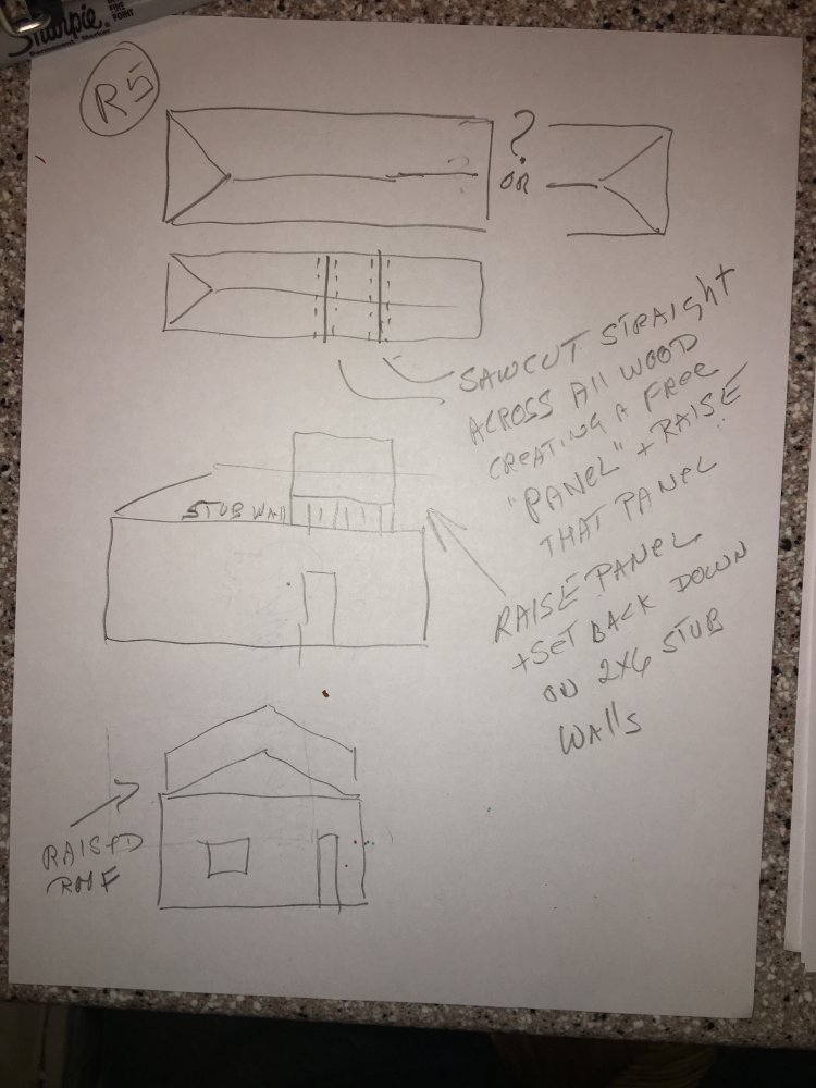

I’m talking about cutting from side to side in two places, and then jacking up the section in between. Cut in between two joists, not too close to either, and make sure you have enough room to build the side wall under the high roof.
I would temporarily support the new ends of the existing roof on either side (before you cut) until the raised roof has its end walls tied in. There’s a little bit of design to those end walls too, so they hold the high roof up, square, and protected from wind loads, and it should also support the ridge on the low roofs.
You need stub walls above the block on each side. & if you go this route, it’s peanuts to add 2-3 feet to what you’re planning so you can fit a lift inside later. If you want to go this route, let me know, and I’ll do some sketches for what those high end walls should look like.
& this goes back to my bump out design, a modification of that plan, for the big truck. If you cut and raise the existing roof about 2 feet higher than your planning, you can cut out the block the width you want, and put a little tiny steel I-beam across the span between the block walls, the stub wall on top of that beam. Do the bump out as far as you want, frame three walls shorter than the stub wall above the beam, and then just build a shed roof with 2 x 4 or 2 x 6 shed roof that comes down to the top of the newly framed walls of the bump out. You don’t have to reframe the roof.
Again, I’m happy to sketch if you ick what you want

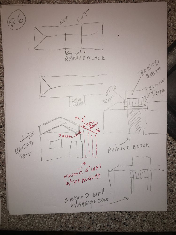

Here’s a much easier bump out couples with raising the roof section
The size of the beam and how it sets on the wall has to be designed.
&, BTW, in keeping with last comment, these drawings may not be quite ready for construction...

@Jim Oaks One problem you're going to run into with your raised ceiling going across the width rather than along the length is that at the ends of the raised section, you lose clearance. I like the direction Rick is going. I'd say go six rafters, just to give you some room. Maybe even seven or eight. You'll have more room. And, as Rick suggests, if you raise the roof there, you can raise it enough to add a lift (not important to me, but you might want one). You can also add windows to the gables, if you build a gabled roof perpendicular to the existing roof. Oh, and, unlike my drawings yesterday, this one won't fall down, especially if you run beams, as I mentioned to Rick.
I joked about my drawings being construction ready, but that’s a fact. I understand where @1990RangerinSK is coming from on the beams and posts. With every respect, it is a little overkill, but he’s right it will never fall down.
I’m not just looking at the structural integrity, I’m also looking at how in the hell would you get it done if you do it. The junior I-beam i’m talking about across a garage door opening is something you could manage without a cherry picker or a forklift. 2-3 guys can muscle it up.
As regards the gable walls and windows, absolutely, I’m just leaving that as a detail for later after you decide which structural plan you’re going to pursue.
Whatever design you decide to pursue, then we will zero in on the details to make sure you have structural integrity for the roof and anything you might want to hang off the roof, like an engine and transmission.
Right now, everybody’s goal is to provide you with alternatives and suggestions. But again, none of this is ready to build. When you zero in on what meets your needs, we’ll get you covered on the details.

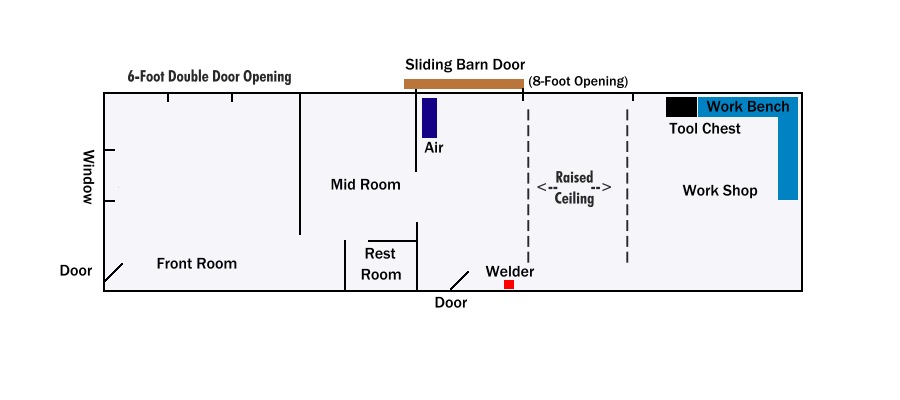

How did we get back to cutting open the roof and building it up higher with windows?
I just want to find a way to move the ceiling joist up 10-inches on my rafter. I thought a possible solution was gluing and screwing an additional 2x6 to the side of the rafter from the top plate to 24-inches higher than where the new joist sits (10 inches higher).
Was @Rick W Saying to cut the old joist even (angled) with the bottom of the rafter?
Apparently there was concern about supporting the cut end of the old joist (where I wanted to add a box / tray) by hanging it off the new joist, so I figured I'd ditch that and just drywall the whole length of the new joists from wall to wall.
The method below looks the simplest, using screws instead of bolts and putting the 24 inch piece on the other side.
You probably only need to buy a couple of 2x6's. Do all the work and get the new higher 2x6 ceiling joist in place above the old one, cut the old one out and use it for the next section. Once you get that section done, you will cut the old 2x6 ceiling joist out and use it on the next section. Of course you may need some short 2x6's for your 24 inch pieces.
