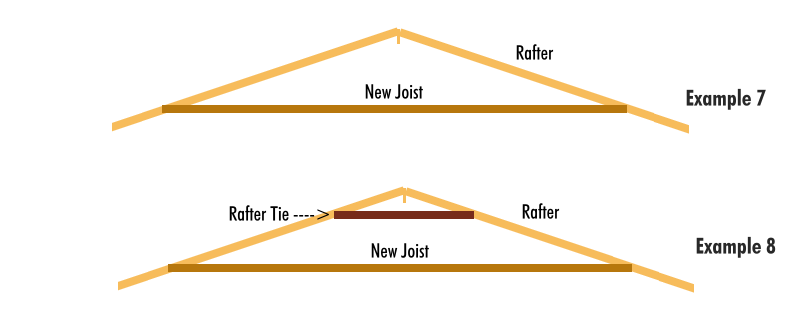

If I just went with something like Example 7 or Example 8 below I could just drywall the joists and move the whole ceiling area up instead of having a pocket, tray, whatever. The good thing about that is I'd really only have to buy one long 2x6. Once I put it in place I could take out the original ceiling joist below it, cut it down to size, and mount it above the next joist to come out.

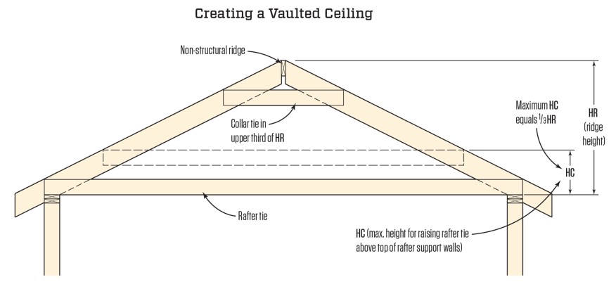

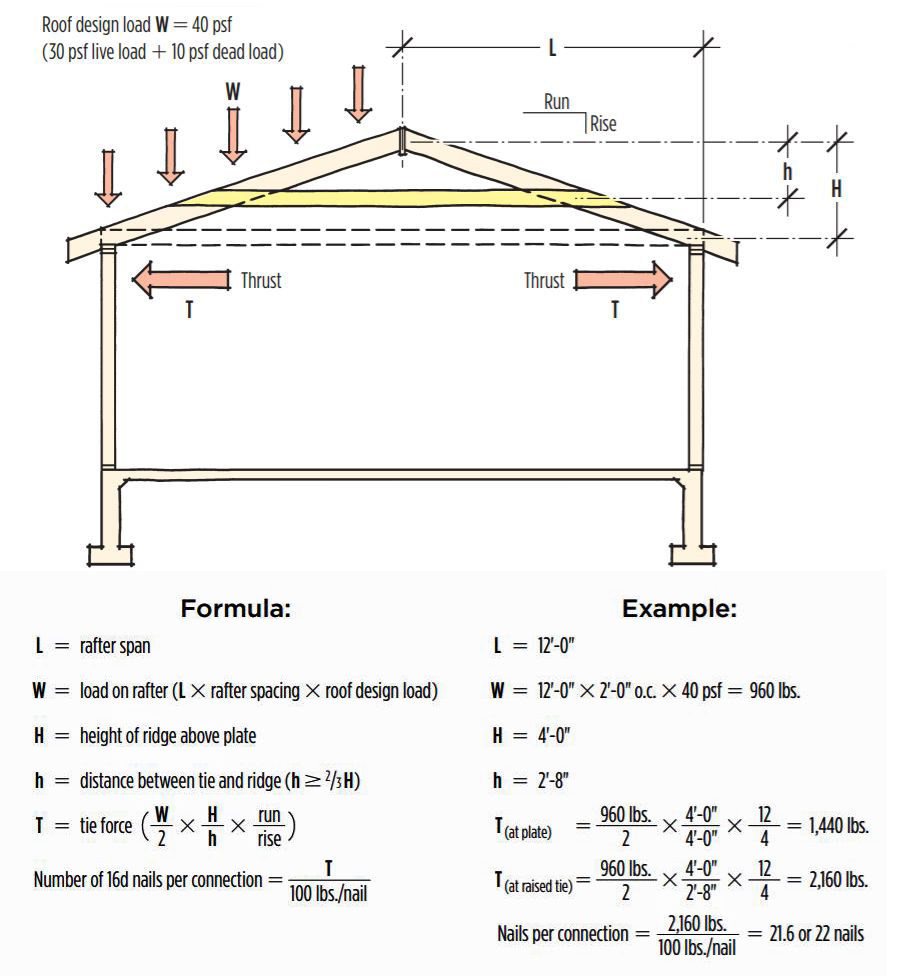

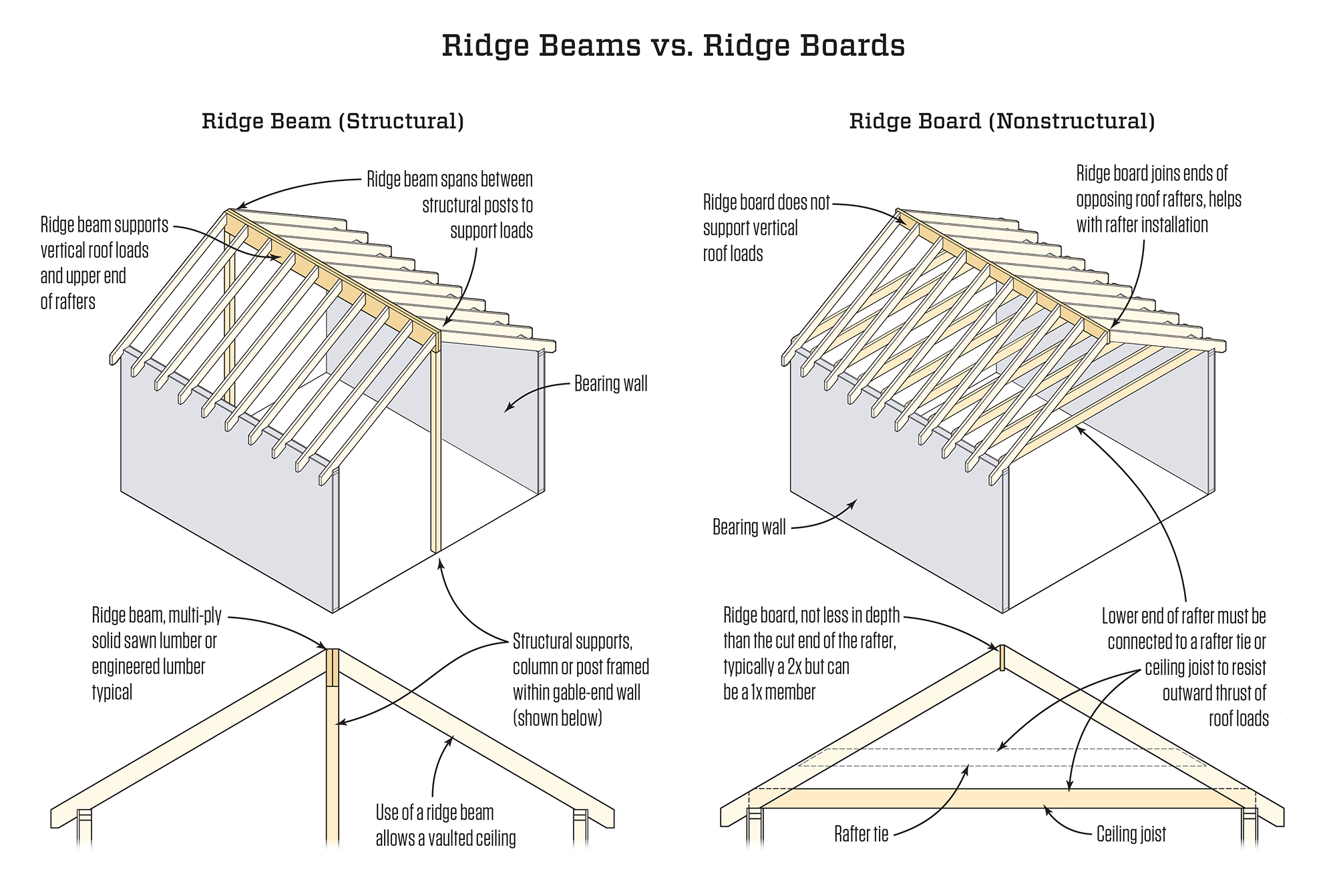

Here's an article I had found at https://www.jlconline.com/how-to/framing/raising-ceiling-joists_o
Q: A client wants to create a vaulted ceiling in an addition with a shallow, 4:12-pitch roof. The rafters are 16 inches o.c., with no structural ridge. Can I raise the ceiling joists to create the vaulted ceiling?
A: Darren Tracy, PE, owner of West Branch Engineering, in Saratoga Springs, N.Y., responds: Yes, you can raise the ceiling joists, but with restrictions. Because you do not have a structural ridge, you must utilize rafter ties. Ceiling joists can serve as rafter ties to resist outward thrust on the walls from the rafter loads if they are installed parallel to the rafters and in accordance with code.
In a roof with a non-structural ridge, rafter ties (which resist the outward thrust of the rafters) can be raised a maximum distance (HC) that is no more than one-third the distance between the top of the supporting wall plates and the top of the ridge (HR). Collar ties (designed primarily to resist wind uplift) must be located in the upper third of HR.
Figure R802.4.5 of the 2018 IRC states that a rafter tie can be raised a maximum distance of “HC” above the top of rafter support walls. HC is determined by a simple formula in which that height is a function of the ridge height (HR): The ratio of HC/HR cannot exceed 1/3 (see illustration). For example, in a roof structure where the ridge height is 9 feet above the top of the support walls, the maximum height that a rafter tie can be raised is 3 feet (3/9 = 1/3).
Additionally, be sure to adhere to the specific fastening requirements in the 2018 IRC Table R802.5.2 for the rafter-to-rafter-tie (ceiling joist) connections. That table provides the number of 16d nails at each connection based on rafter slope, rafter spacing, and snow load.
Section R802.5.2 also states, “Where the ceiling joists are installed above the bottom third of the rafter height, the ridge shall be installed as a beam.” In other words, to raise the ceiling joists more than one-third of the ridge height, a structural ridge would be required. With a properly engineered structural ridge, rafter ties can be eliminated completely. Also section R802.4.4 states that a roof with a pitch less than 3:12 requires a structural ridge.
As a final note, do not confuse rafter ties with collar ties. Collar ties, which are designed primarily to resist wind uplift, are required in the upper third of the attic space. Unlike ceiling joists, collar ties can be made of less-substantial material (1x4 minimum) and can be spaced up to 4 feet apart. Ridge straps can be used in lieu of collar ties to resist uplift.

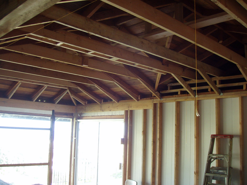

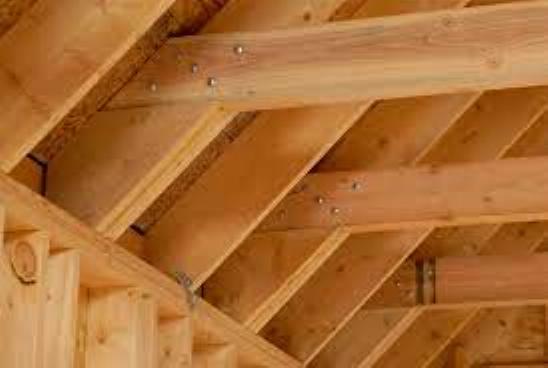

Misc Photos

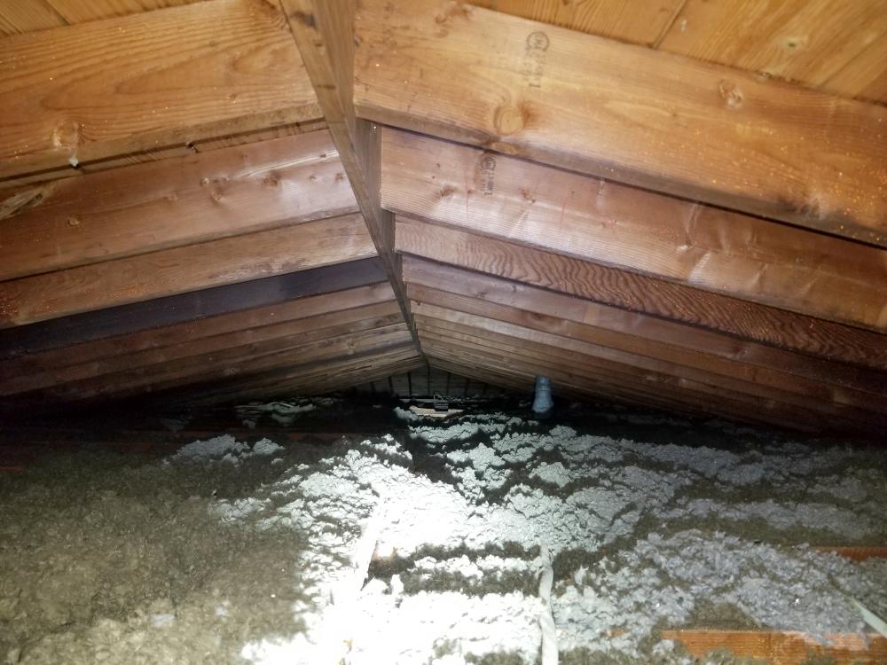

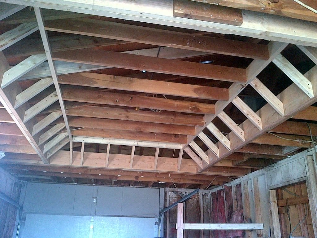

Here's a couple of photos I found online of some raised ceilings.
60232
60233

All the examples you are showing pictures for are examples of roofs with much steeper pitches that your building; that includes your and @1990RangerinSK's diagrams.
Per code: section R802.4.4 states that a roof with a pitch less than 3:12 requires a structural ridge - from what I'm reading in previous posts, your roof has a pitch of 2.75:12. Which means if you touch the rafters, you MUST are supposed to change the ridge to be a structural member to meet code. If you change the ridge to be a structural member, you have lots of choice after.
I know I'm party pooper.

@Jim Oaks: @85_Ranger4x4 's picture is worth 1k words: Basically it needs to be 4X material (or better, depending on exact length) and supported by post (on a pad) from ground to the beam at each end (If supported at end of the original building, you can get away with less).
Building specs evolve with time - the latest rendition dates from 2018. So, it might have met code when built and code updated since. And if you're that close, you should be doing it correctly, not double checking measurements. :)

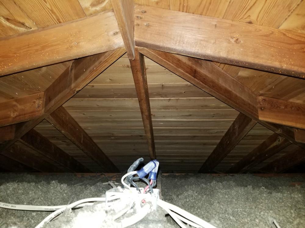

When I'm done remodeling the building I plan to replace the shingles with a metal roof. It's also my understanding that metal roofs are 50% lighter.
At least my rafters line up.
60267
60268
60269
"To resist thrust, the IRC calls for a structural ridge (required for any roof with a pitch less than 3/12) or for each pair of rafters to be securely connected to each other by a continuous ceiling joist (R802.3, 2006 IRC)."

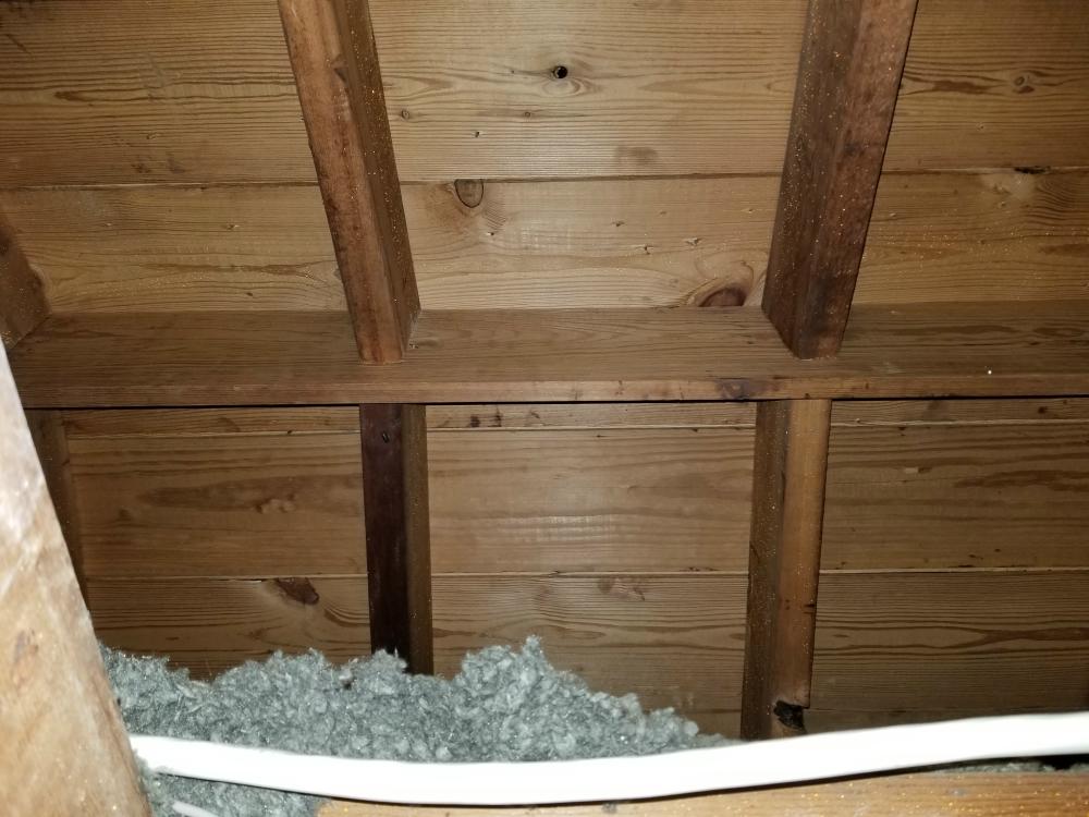

I do have continuous ceiling joists. 🤷‍♂️
There is a 2x6 ribband that runs the length of the building in the center of the joists that I guess keeps them from twisting.

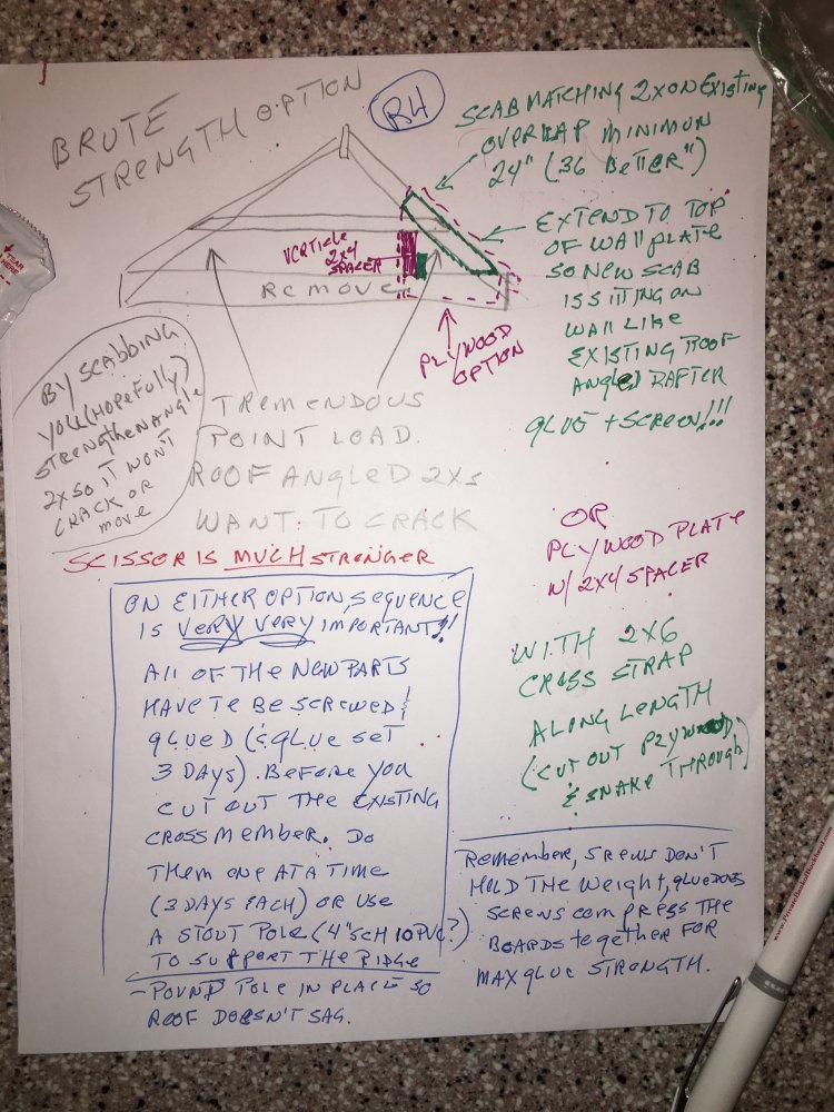

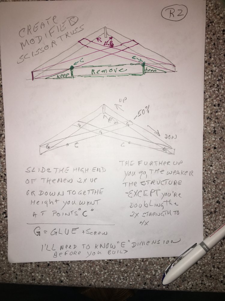

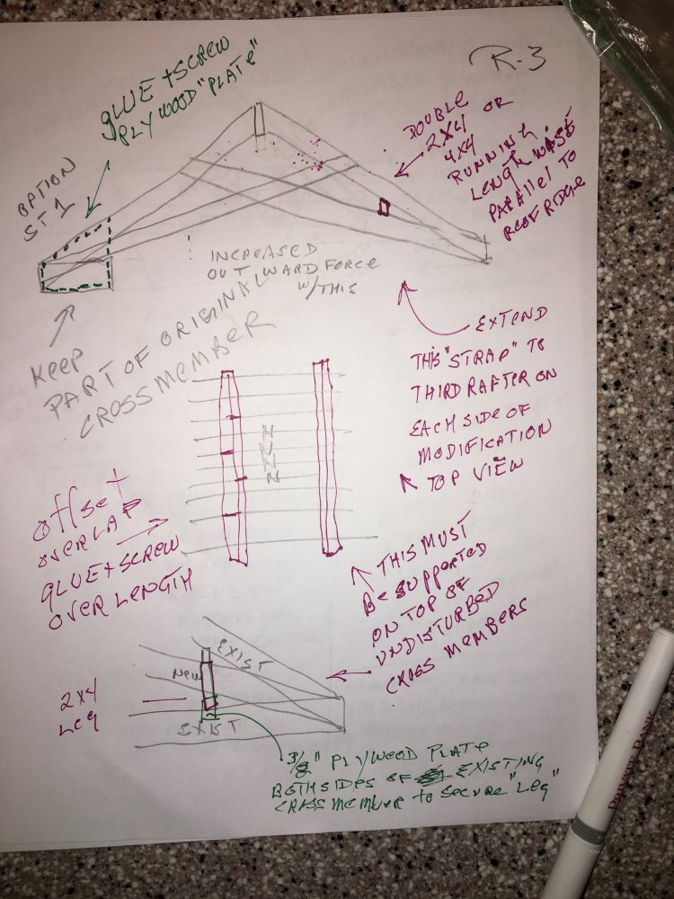

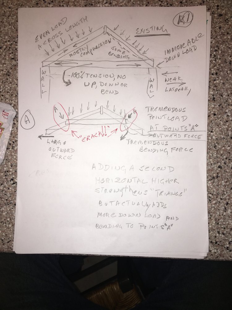

Here ya go, obviously I did this very quickly. The strength is in the triangle, whether it’s one or a combination of several. Right angles are very week if not part of a triangle. The shorter the short side of the triangle, the weaker it is.
@Jim Oaks examples 2&3 will fail, dangerous. Examples 4,5,6 & @1990RangerinSK second/horizontals example are weak, but they’re covered in my second example, you could use that.
Snowy’s example one will also fail, but it was the inspiration. It is not a scissor truss. In a scissor truss the lower angled members have to tie in to the higher angle member on the opposite side directly. The way Snowy has it drawn, under a heavy load, the two lower angles would push up into the horizontal and snap it in half just before the whole roof came down. But it was a valiant effort and I honor him, except for the whole roof falls down part.
First, DO NOT remove the existing crossmember until the new pieces are glued and screwed and glue is set (typ 3 days). Weatherproof liquid nails, a lot, 2-1/2” torx deck screws.
You can modify the existing pieces into a scissor truss. Before you proceed, I’d need to know the size of the 2xs, and lengths. If it’s too shallow, it will fail, but I know several ways to strengthen it. So this is a start.
Important: if the free space between the ridge board and new lower angle boarded is less than approx 3ft, we have to rethink it. If it’s 4-5 better. So, pull a couple strings where these scissors will be and measure up from the floor to see if you get the clearance you want at the 4 corners.
See “blueprints”
While I put in the option of just moving the crossmember higher, I cannot impress upon you enough that the entire weight of the roof and anything on top of it will be at a point load where that new crossmember ends. I fear it will snap a 2 x 6 or 2 x 8 like a toothpick with 6 inches of snow on the roof. And, without strengthening (scabs) the walls will still be pushed outward. If you choose that option, you need to scab another 2x whatever the same size on at least one side of the free part of the angled 2x, extending 24 to 36 inches upward past that point on the lower side, it has to be cut to exactly match the existing so it ends up resting on top of the wall plate. A variance of that is to use some half-inch plywood (plywood, not waferboard, not a 1x). While that might be stronger, but it is much more difficult to get it right.
On the lengthwise double 2x4 straps, us walk studs, and I can show you how to glue it in a slight arch, so load is transferred to the neighboring indisturbed rafters
If you hear cracking, don’t stand underneath it looking up with a flashlight looking for the problem.
If you pick one, I can provide much better details

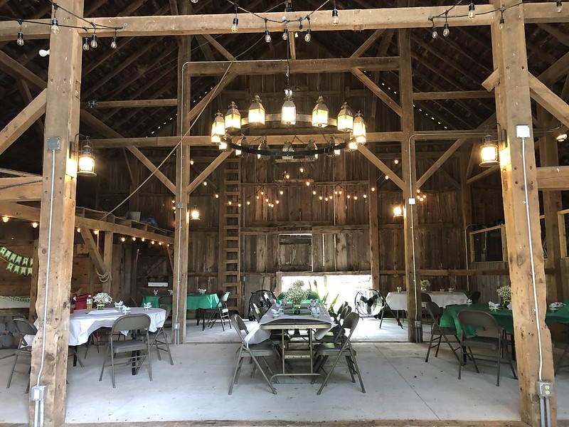

Probably not "up to code" but after all this talk about rafters I have been gawking at my barn roof as I work on my camper. It seems to be sort of a hybrid. Looks like a structural ridge with lengthwise running beams that are supported to the floor.
May or may not have room if it is legal to do it that way I don't know.
Barn has seen roughly 150 years of upper midwest snow loads, you can see the track for the hay trolley in the second pic...

In Regards to R4:
index.php
NOTE: If I move the rafter up I'll go 10" or 10.5".
If I'm understanding this correctly, you're saying to mount (scab) a 24" long 2x6 along the opposite side of the rafter that the ceiling joist is on, and mount it to the top plate next to the original rafter. This I'm guessing is to keep the rafter from cracking under the down force of the roof. Does it have to be screwed to the top plate as well, or just screwed and glued? What size screws and what kind of glue? While I'm thinking about it, is there an advantage or disadvantage between wood glue and construction adhesive like liquid nails? Every time you say glue I keep thinking construction adhesive.

In Regards to R2 and R3:
Are you telling me to keep part of the original crossmember because I need it, or because you think I want a ceiling there? Is the 2x4 parallel 'strap' meant to support the remaining section of original ceiling joist and drywall? At this point I'm thinking it would be easier to ditch all of the old ceiling and joists in the areas where I install raised joists. The peak in this design gives me some room for the GMRS antenna mounted in the center of my cab. LOL. I'd have to piece in 2x4's between the joists at the peak to screw drywall to. This method looks like it may be a little more difficult to put together than the R4 idea.
