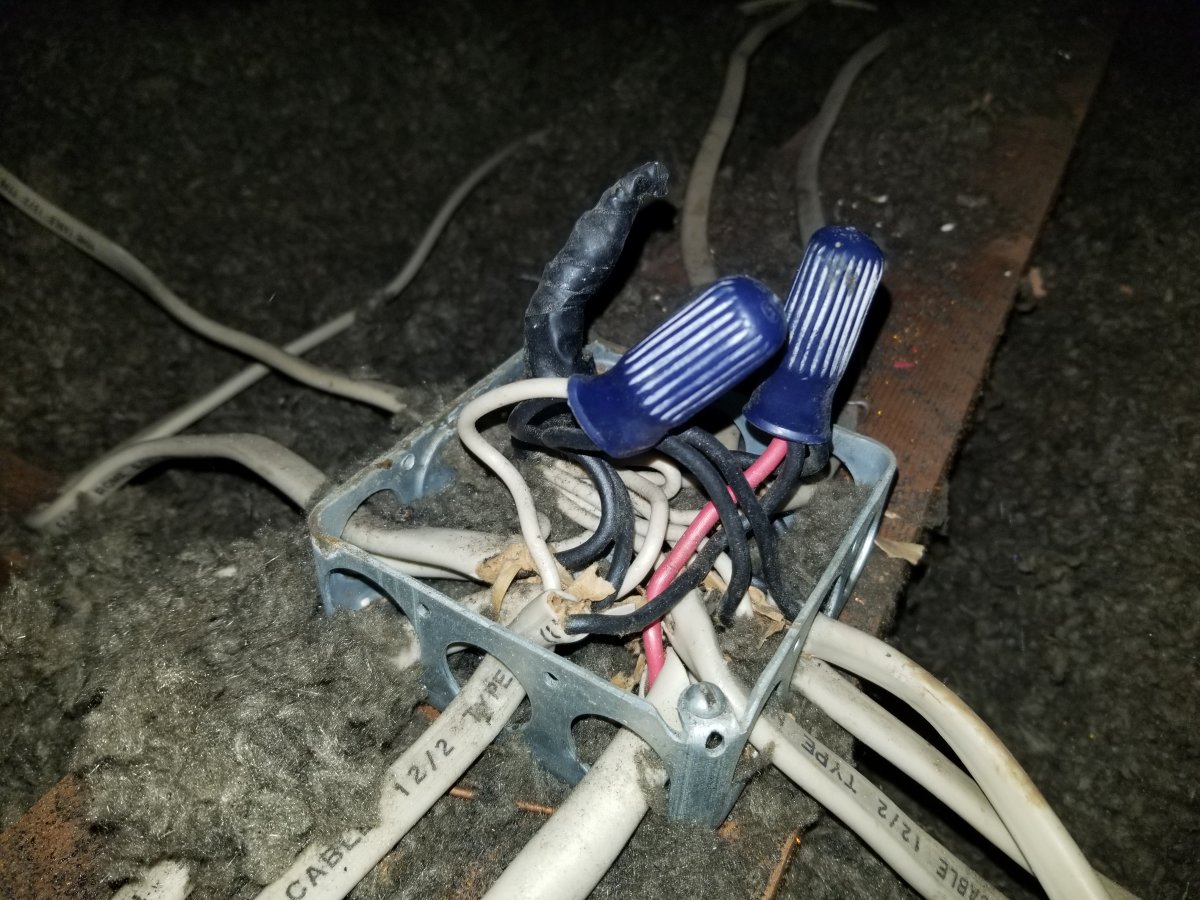

Electrical Figured Out (Mostly):
index.php
Here's the drawing I did of how the breaker box in my shop is wired up.

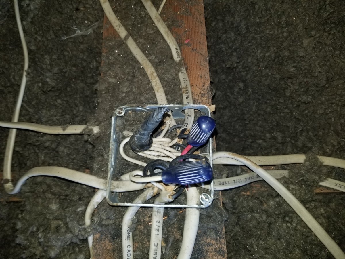

I opened up the ceiling and looked around. I found that the main building and the rear addition each has a junction box near the center of the ceiling.
The box in the rear 1/2 of the shop has a 12-3 Romex with a red wire coming in to it. The Red Wire feeds a 12-2 Romex to the wall switch, and then back to the black wire on all of the ceiling lights. It appears that the Black Wire on the 12-3 is feeding power to the black wire going to the outlets. And all of the white wires and bunched up together.
60176
The 12-2 with the white wire (yellow in diagram above) being used as a hot in the bottom of the breaker box is actually being used like a 12-3 for the 230 (?) air conditioner outlet. The only 12-3 Romex with a white wire running in the shop is the one for the lights and outlets.
With that said, I know for certain that a 12-3 Romex with a red wire goes to the front air conditioner. The other unknown 12-3 Romex most likely gets split between the outlets and lights in the front 1/2 of the building (front and mid room) like the rear 1/2 of the building does.
One 12-2 Romex is likely the 12-2 going in to the wall furnace at the opening between the front half and rear half of the building. That leaves one 12-2 that's still unknown.
From what I see in this diagram:
index.php
It would seem that it's ok to use that 12-3 with the red wire to have a split circuit with a shared neutral (white) wire. So I believe if I put each wire on it's own breaker, it's actually allowed to be wired like that. Although I'm sure you noticed there's no clamps holding the wires going in to the junction box. I thought there was some plastic ones that you can slide over the wires after the fact.
I'm trying to decide if I just want to leave it be and just create a new circuit for whatever I add, or run a separate 12-2 for the outlets and one for the lights (instead of the split circuit on a 12-3 (black/white/red) with a shared neutral), and put them in separate junction boxes. I just don't want to create more work and cost if I don't need to.
I don't like the way the air conditioner is wired. I'd replace that wire with a proper 12-3.

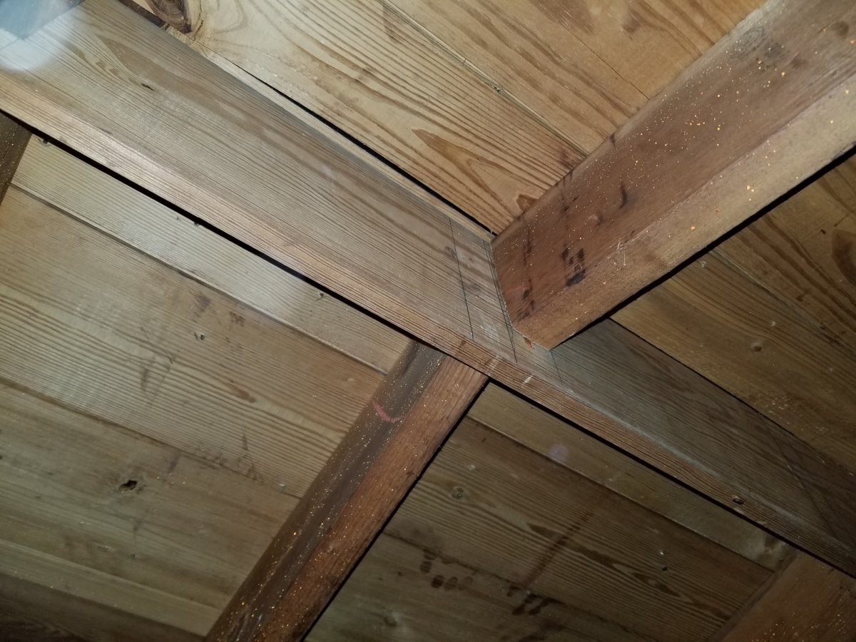

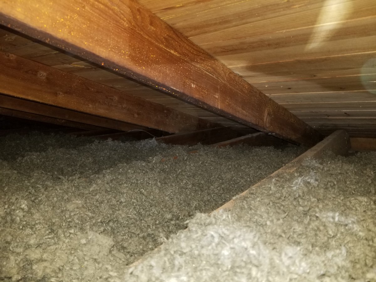

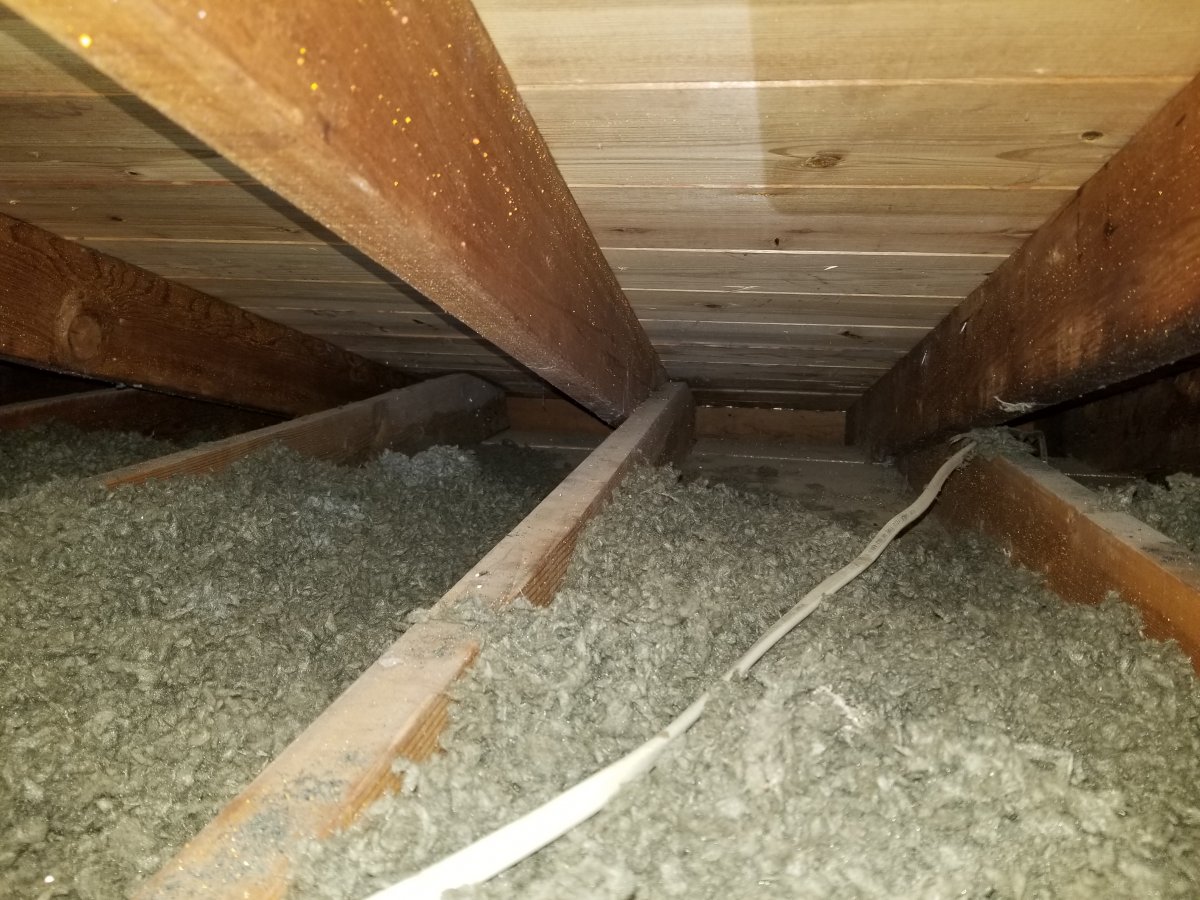

The Roof Rafter / Ceiling Joist:
I also looked at the roof. The rafter and ceiling joists are all 2x6's. There's a 12x6 ceiling joist every 16-inches. The rafter has a 1x6 running through the top of it along the peak of the roof. There's also a 2x6 laying along the top of the ceiling joists running the length of the center of the ceiling.
I measure the roof at a 12-inch distance and found that it rises 2.75-inches every 12-inches.

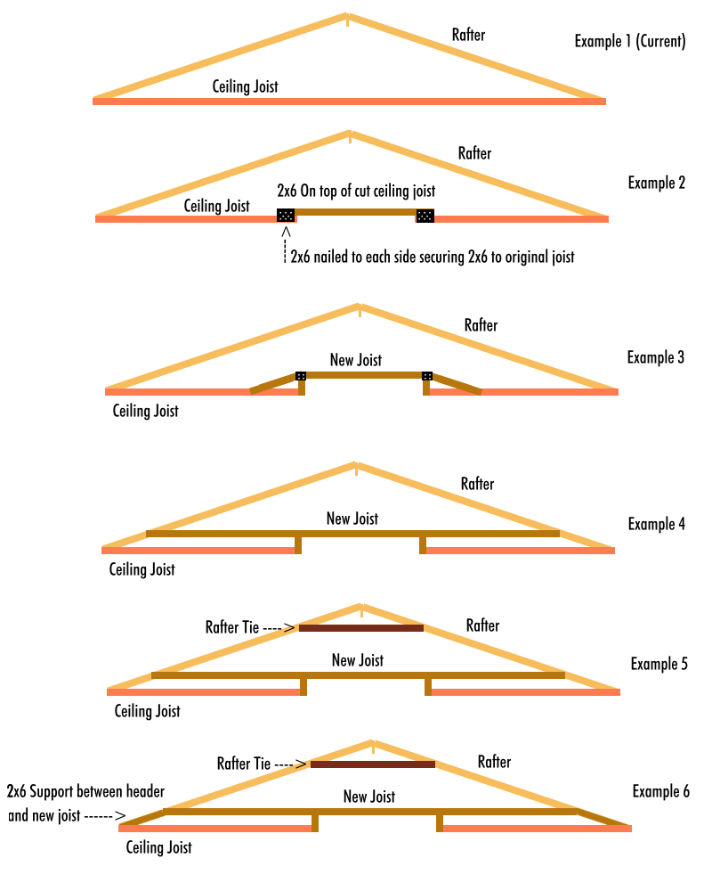

I still want to create a 6-foot wide by 10-foot long tray in the ceiling and move the joists in that area up 12-inches to create a pocket to lift vehicles up in to for clearance.

Not sure how you would do your ceiling "tray". You can't just cut the ceiling joists that the ceiling is nailed to, they are under tension holding the sidewalls from splaying out from the roof.
This section of the building is 31-feet long. I want to create a 6' x 10' tray in the ceiling. With 2x6 ceiling joists every 16-inches, there's a lot of reinforcement keeping the roof from spreading out.
Since the distance from the bottom of my ceiling joist to the roof is only 32-inches, I'm not going to raise the joist up 12-inches. From what I've read you can move the joist up 1/3 of the distance.
My ceiling height is 87.5" (7'-3/12"). If I remove my LED lightbar, the distance to the top of my bed cage is 77" (6'5"). That leaves me with 10.5" of space to jack up my Ranger.
If I cut out the rafter and secured a new one on top of it to form a bridge, that would gain 5.5" and give me a ceiling height there of 93" (7'9"). That would give me 16" of ceiling space to jack the Ranger up in to.
If I installed a new joist (like in Example 4 below) 10.5-inches higher it would give me a ceiling height here of 98" (8'2"). That would give me 21" of ceiling space to jack the Ranger in to. I'd like to have the space to lift the Ranger up at least a foot and get it on jack stands. Just cutting out a 6-foot section of ceiling joist and attaching a new one on top of it would give me 16" of space to work with.
I don't know if any of these examples would work. They're just ideas I've come up with. Like I said, I'm not doing this on the whole ceiling. Just a 6'x10' space in a 18'x31' (width x length) space.

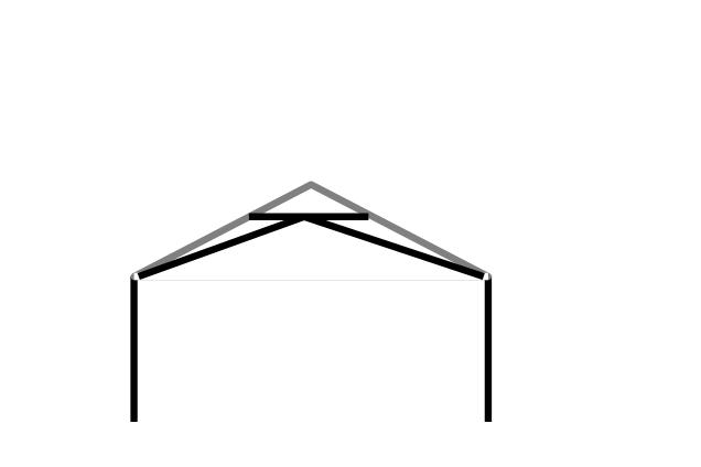

I like example 6, personally. Except that I see a problem. The end of your existing ceiling joist is unsupported. I'm not an engineer, but somehow I don't think that hanging the ceiling joist off of the new joist will be enough. I would think that you'd need to support it from underneath. @don4331 what do you think?
This might work better (note that it's not drawn to scale):
60215
I've eliminated the need for supporting the inside end of the existing ceiling joist. Now, the end of the joist (or is it now a rafter?) is attached to, and supported by, the collar tie, and the opposite joist (rafter?).
Here's another option that might work better, also not to scale, and also eliminating the need to support a hanging inner end of a ceiling joist:
60217
The upper collar tie would be optional. I'd put it in, just because I like overkill, but I don't think you'd have to.
This is essentially Example 5 but in the example it shows the old ceiling joist that will still be holding up the drywall ceiling.
In my shop the ceiling joists also serve as rafter ties. But in a garage without a ceiling, the rafter ties are spaced 4-feet apart. So it would seem that moving the joist up no more than 10-inches still allows it to serve as a rafter tie. In my drawing they would also help hold up the ceiling joist where it's been cut.
Right. I've eliminated the old ceiling entirely in the area where you want the raised ceiling because I'm uncomfortable with hanging the inside edge of the original ceiling joist off of the new, higher, ceiling joist.

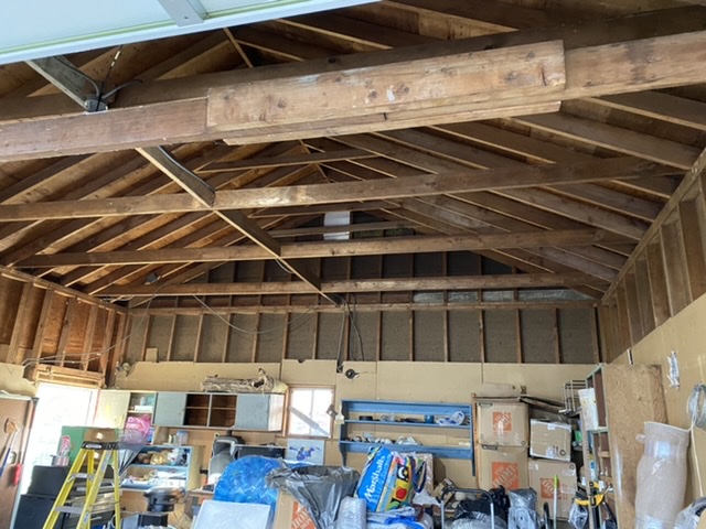

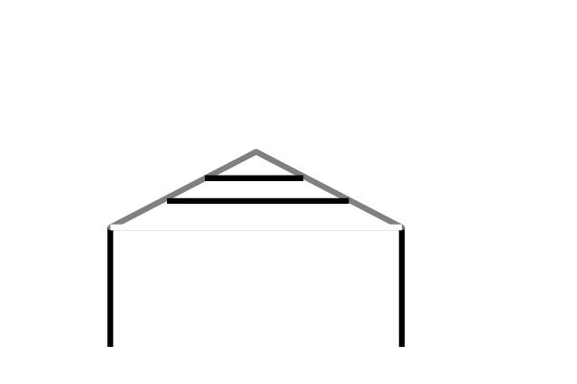

@Jim Oaks
I’m about 100 miles away from home doing a property inspection on 81 acres in about a dozen buildings, so I can’t send you something right at this minute.
A few of your sketches are a disaster waiting to happen, but a couple of them have potential. And @1990RangerinSK Inspired me, with something you can change, something you can implement pretty easily with a little money. I’m swamped again tomorrow but I should be able to get you something by Friday
