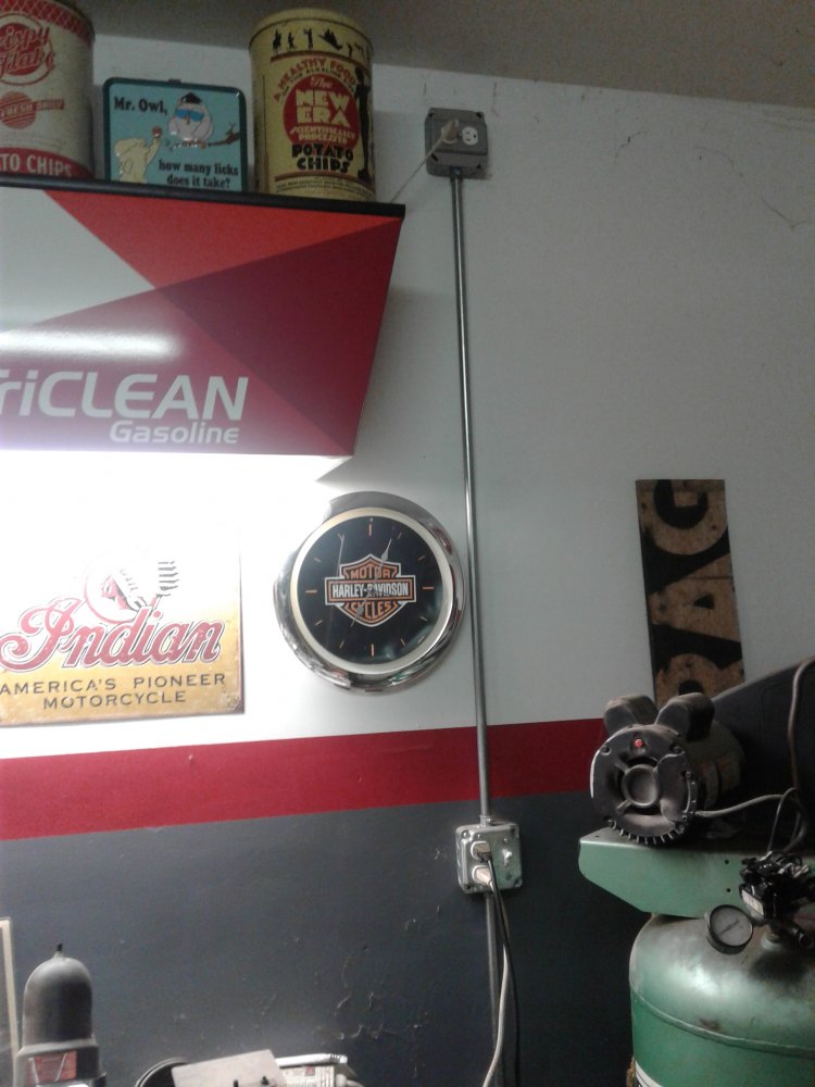

Being you're running exposed conduit... when I did my garage I ran conduit up the wall and installed a box and outlet plugs near the ceiling in three places. below those I installed double boxes with a light switch and outlet plugs. That way I can plug lighted signs/clocks and a big oscillating fan high and no cords running down the wall. Between those I installed lower floor outlets. I have power high... medium and low heights all over my garage.

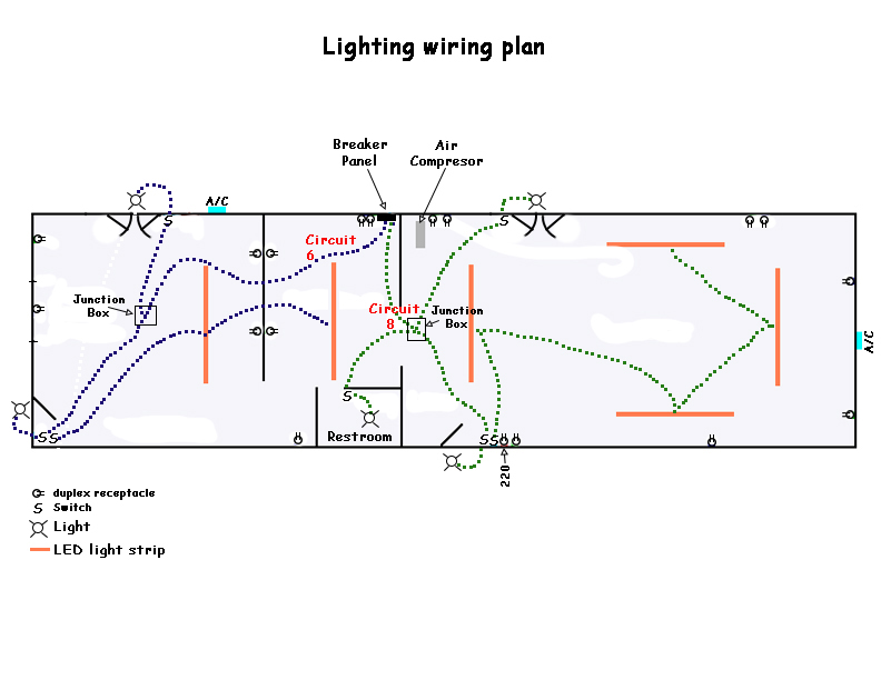

I fixed the diagrams to show the light fixture in the Mid Room.

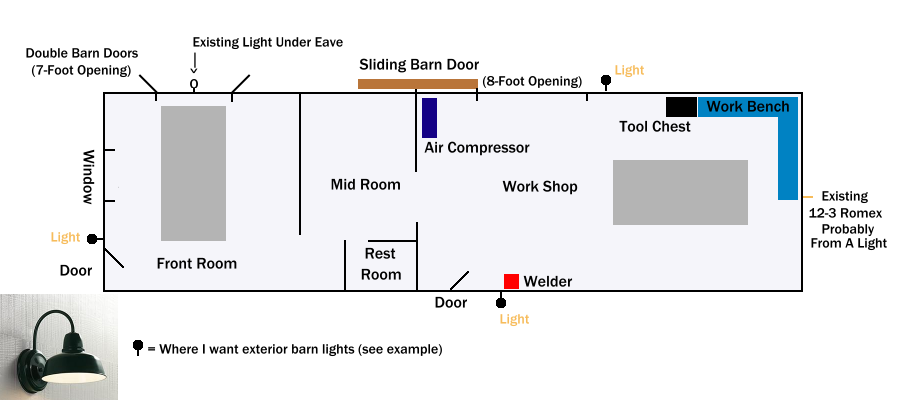

This next diagram shows what I'm thinking for a layout, and where I want to add exterior lights.
59868
NOTE: Not to exact scale.
Exterior Lighting:
@ericbphoto had asked me about exterior lighting, so this diagram is meant to show where I want to add lights. Each light will also need a switch. I plan to use the light over the double doors for the front room and just update the fixture. There is Romex coming out of the back of the building. I'm guessing it was for a light, but it's kind of long. I'm not sure if I'm going to add a light back there or not. I want to eventually have a small patio/ fire pit area back there though.
Barn Doors:
The side of the building along the top of the drawings is an alley. The building currently has (2) 6-foot double door openings. The plan is to widen the double door in the front room from 6-foot to 7-foot. This would allow me to pull a car in there and park it. For the work shop, I'm thinking about opening that door way from 6-foot to 8-foot. There's a gas meter and sewer clean out / inspection pipe in the area outside of the door way. With a sliding barn door I wouldn't be hitting a door on the gas meter or having to drive around the end of the 4-foot door. These door frames are commercial style frames that resemble steel tubing. The front door is the same style of frame. I'm replacing that with a steel pre-hung exterior door. I will use that frame to widen the frame for the front room.
There is a row of cinder block that sits on top of both 6-foot door frames. That block will likely fall out when the frames are removed, so I'll have to build a support to hold the ceiling / rafter up when I remove the frame. I'm concerned that the top plate might not support the rafters in this area on it's one. Then I'll either reinstall the block or just put a wood header in above the metal frame to fill the gap.
For the rear 6-foot door I'm undecided if I want to widen that frame and do the same thing, or build a new frame from lumber with a header to support that top plate. I'm kind of leaning towards doing that in wood, but I need to do some research on how to build it to to be sire it supports the 8-foot span.
I would recommend either adding more lighting over your welding area and workbench or relocating the planned lighting.
As it is, your head will be casting a shadow on your work. I would put a light down low over the bench to help to see what you are doing the best.

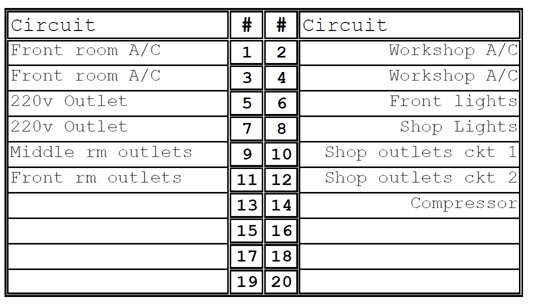

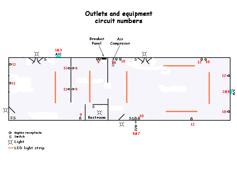

Ok. While I was absorbed in my thoughts, you updated a little bit. What you will see below can be modified “on-the-fly” to suit actual conditions or changes you decide to make. But between this and the book you have plus asking more questions as needed, you have what you need to get started. You can use either PVC or EMT conduit to protect wires coming down the wall to switches or outlets. Technically, there should be a cable clamp where the romex enters the top of the conduit. I would argue that a staple within 12” should be sufficient strain relief in lieu of a clamp at those locations since your work is not getting inspected. Do not pound staples too tight anywhere. It is easy to pinch the cable tight enough to break the insulation and short the conductors together. I have earned money repairing that for people. With the staple in place, you should be able to wiggle the wire slightly under it.
You can arrange your circuits in the breaker panel any way you want. I just came up with a plan so I could identify circuits on the drawings. You can also divide the outlets among the circuits differently if you want. There are ways to do it that will use less cable. When it comes to outlets in a shop, I alternate circuits going around the room. That way, if I’m using a power-hungry tool and need another tool working at the same location, two different circuits are available near each other without having to stretch an extension cord across the room. I put your air compressor on it’s own circuit because that is usually a power-hungry device and you don’t want it interrupting progress when you are in the middle of doing something.
On the lighting drawing, I show two junction boxes. You should probably use three. Circuit #8 for shop lights will have 4 cables going into that box. If you are using 12 gauge wire, that will require putting 4 wires into each wire nut. That is a lot. It will require the largest wire nuts (usually dark blue). That also takes a lot of room in the junction box and would require an extension ring. Code specifies what you can put in a box. But in all practicality, that gets to be a lot. It would be better to put two of those cables in one junction box and two in another junction box nearby with a jumper cable running between the boxes. Much easier that way. I can explain that better later if you don’t follow me.
Anywhere you have wires in a junction box, switch box or outlet box, you need to leave them long enough to work with comfortably. Code specifies that they extend 6” out past the front of the box. It is difficult to work with short wires.
If you want a wiring drawing for outlets and other equipment like the one I did for lighting, Just say so. I’ll make one up. But that can become a very “busy” and almost confusing drawing.

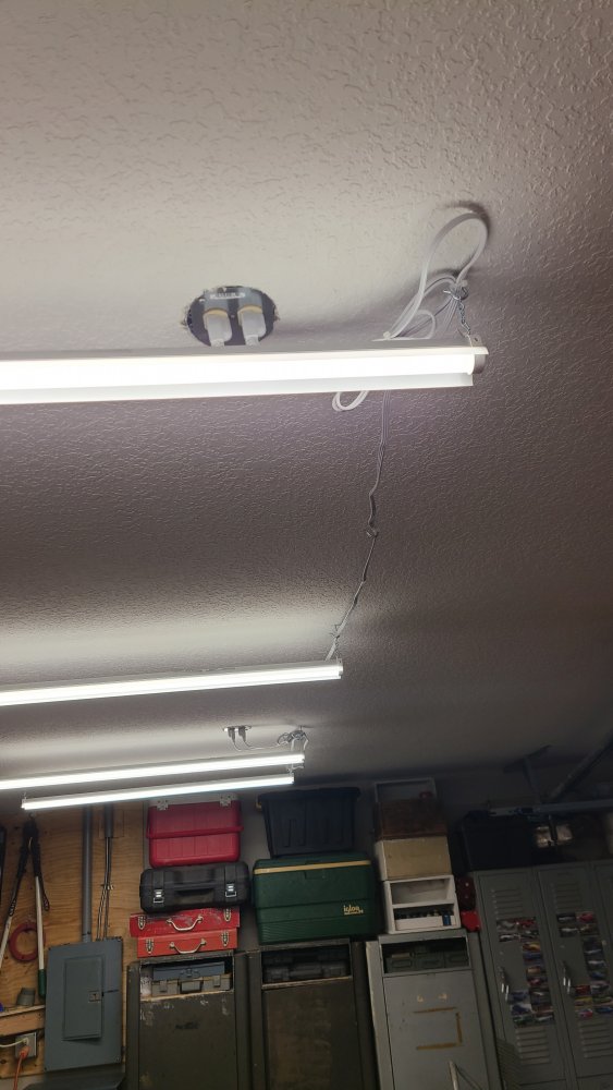

Not sure how code it is but I have converted my built in lights to outlets and have just been adding the $30 4' LED lights around my shack so I can actually adjust where light is at on the fly. Pretty much I basically have 3 around my truck with one four footer right inside the door aimed at the engine bay of a backed in vehicle and a LED worklight aimed in from the other side. Garage door is above the said open engine bay so I had to work around that and it took some trial and error to get it dialed in.
Nice thing is there are no bulbs or ballasts to fuss over. If one dies (one has died so far) you unplug it, trash it and get another one.
Like this?
Yeah but the garage is framed with cedar posts, no flush mounted outlets and the ceiling isn't as fancy. The ones I have are the roughly 8" wide ones from Menards, they have more of a spread pattern than some which is critical with my low ceiling.
It's come a long ways from when I got the place and it had two incandecent light bulbs.

This is what I did and was trying to describe... I'm no electrician... so don't flame me to bad.
Probably doesn't meet code but it survived a couple home inspections and has worked for the 10 years I've lived here.
The switch controls the upper outlets...
