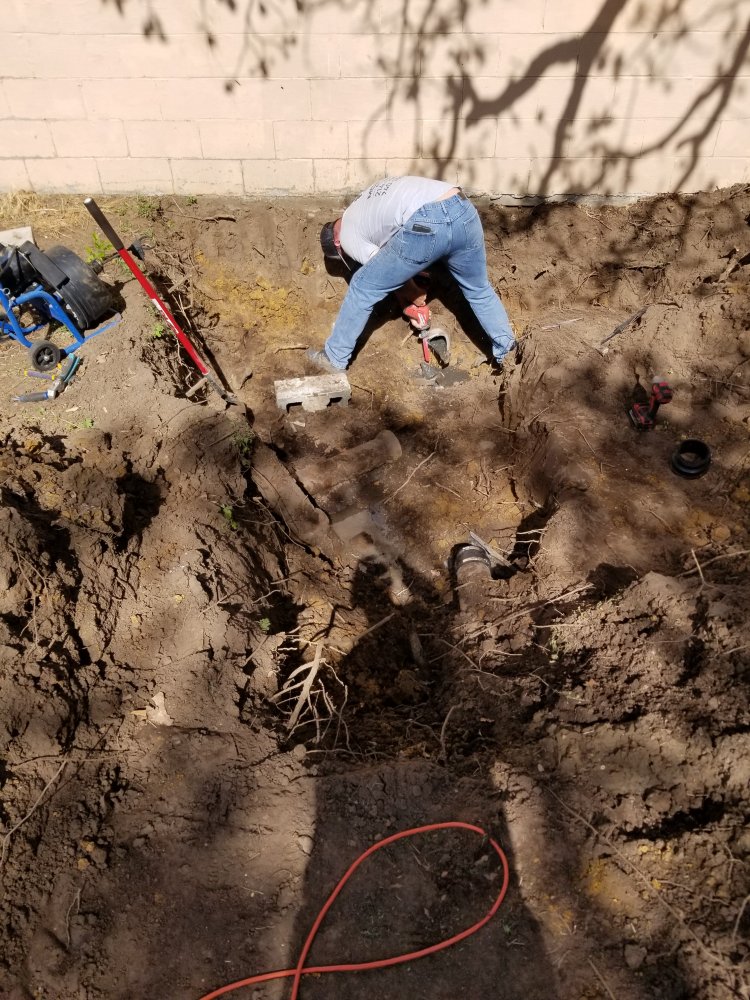

The sewer line is obviously the most important thing that needs dealt with. I just don't want to make plans to get it fixed until I get a quote from this last contractor. I want to be sure of the direction I'm going before I get it fixed.
The existing sewer line is definitely clay pipe. I watched them open it up, cut it, and use a rubber coupler to join the new section of PVC to it.
This picture should give you a better idea how far the pipe is below the building:

Why you taking pictures of random guys buts?
I was raised in New Jersey and I’ve got a pretty thick skin which I guess is a good thing considering all my thought on this has spurred everybody else to think about how and where they take a crap, and further thoughts of men’s butts....

Why do y'all want to bust up the floor of his shed so bad?
I agree with @Rick W of dig up the ground on both sides of the shed (as one side has recently been dug up, it will dig up again easily) and shoot the level of pipe at both sides. If outbound side is lower, on to next problem. If it isn't you know what your problem is.
A trench mole will drill a hole under the slab for a lot less effort/cost than cutting the concrete, trenching, installing new piping, refilling and refinishing the floor. Make sure you keep the mole at the correct slope and probably best to feed in piping as you go. Best to trench enought at pipe level to be greater than shed + trencher, so you can put a continuous pipe under the shed. (If Jim was in Moosomin he might have to cut the slab as renting a trench mole might not be worth it/possible, but he is just outside of Dallas and owns a Ranger to transport it).
OK, it doesn't get the bathroom in the shed working, but Jim can come back to that another day when time and finances allow. And it would only need to be small hole inside, so could even be a rainy day job. :ROFLMAO:
