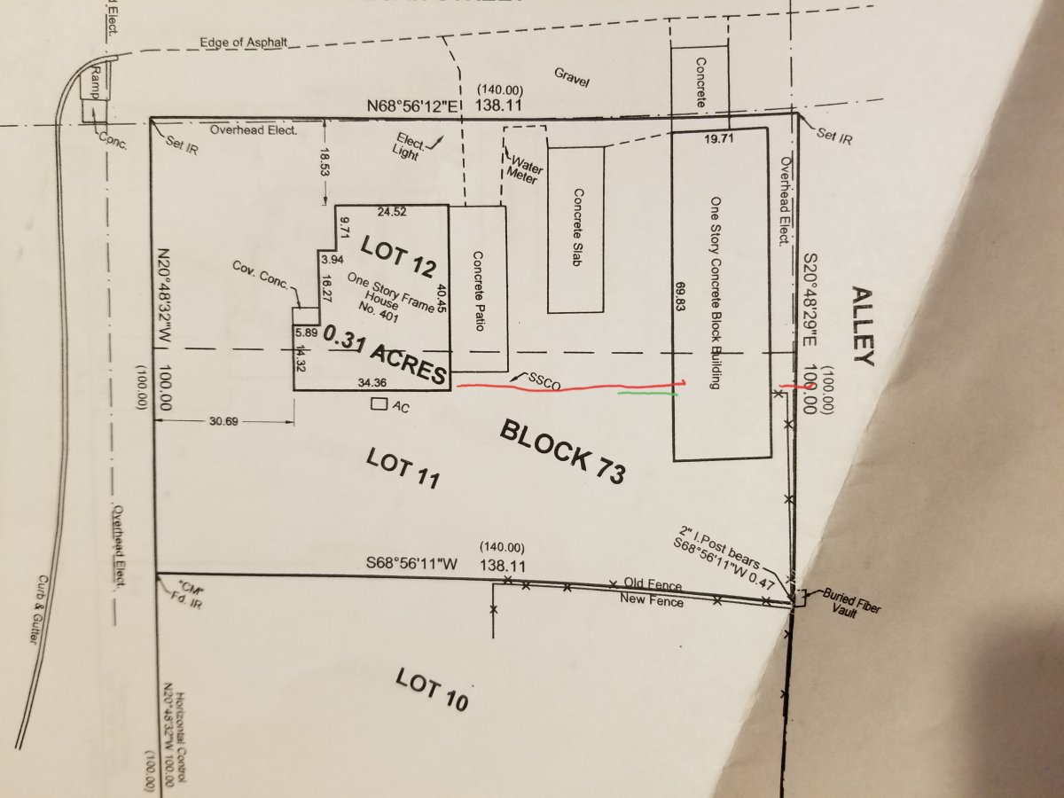

Could you humor me another time, and just with a pen on your site Platt, draw a line where you think that sewer line goes from the house to the city sewer. I want to know where it is relative to the two slabs that are between the House and the Alley.

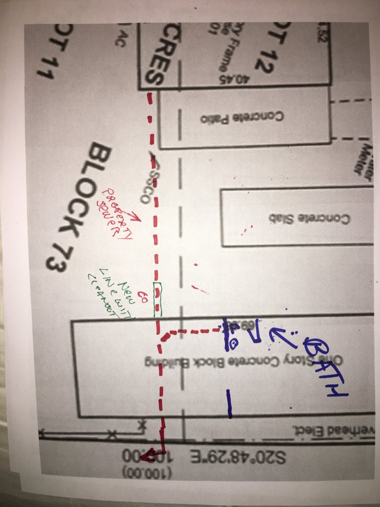

The red line shows roughly where the sewer line runs. There is a cleanout near the bottom right corner of the concrete patio. The green shows where 5 or 6 feet of the red line was replaced. Another cleanout was added on the right of the building in the alley that swoops towards the main sewer to the right.
Another question is where does the sewer pipe for the shop bathroom connect with the house sewer line? My guess is it came straight out of the back of the building until it hit the house sewer line, which is now under that building.

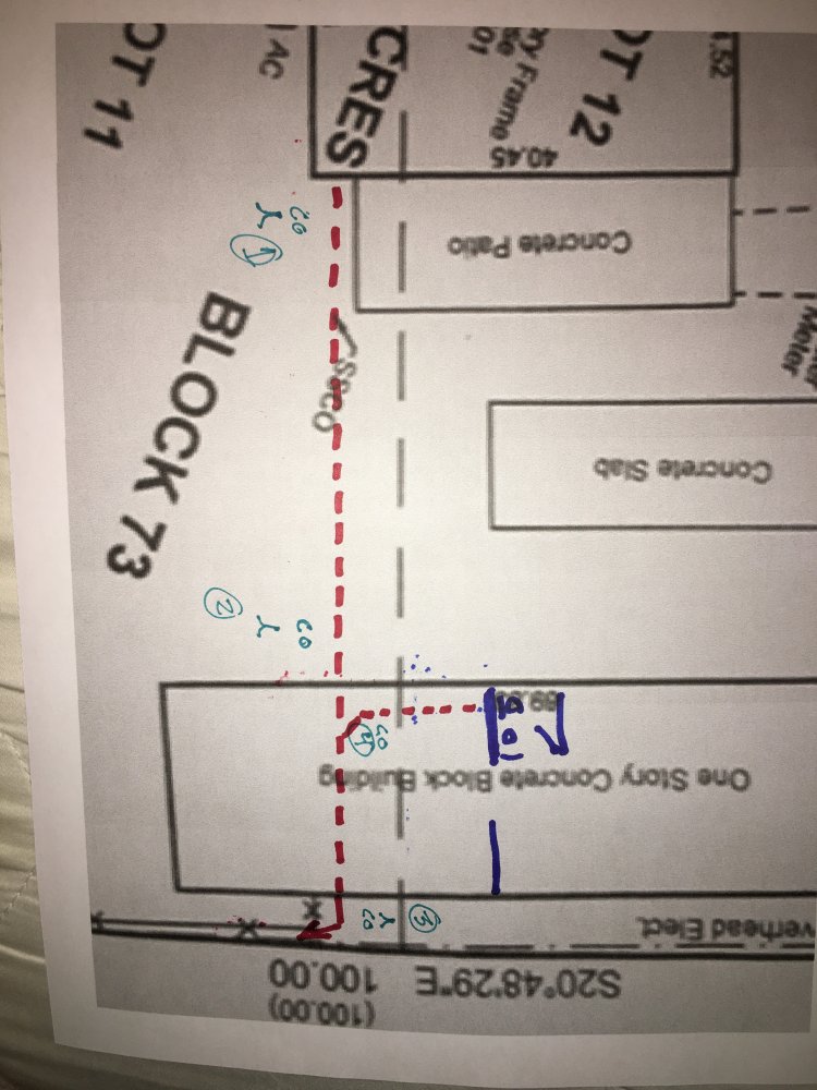

Step one. Get a day laborer and dig down in three spots: C01, CO2, and CO3 on this next drawing. You don’t have to dig up the pipe, you just have to dig down enough that you expose about 6 inches of the BGTC to get the elevation. You’re making sure that CO1 falls to CO2 and then falls to CO3. 1-2 should drop about 11.25 inches, 2-3 about 6.25 inches. If you are far off that, STOP, let me know and let’s regroup!
I’m pretty sure those dimensions will be close, but that still doesn’t tell us if it’s dipping in the middle of the building or even across the yard. Again, rather than dying of 1000 cuts, I would just dig the pipe up from the house all the way out to the tap in the street and replace it. To good rent a grunts can dig that up in a couple three hours. If the soil is hard, rent a little ditch witch and cut two ditches straddling the line and then knock out the center exposing the whole line.

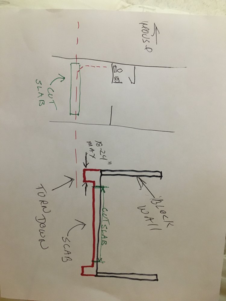

As far as cutting the slab in the building, look at this:
Most of the slab is probably no more than 4 inches thick, might even be 2 1/2 or 3 inches thick, probably is not a sophisticated hard mix, and may or may not have wire in it. If it was done right at all, there should be a turn down underneath the block which is the footer for the block wall. You want to cut a trench across the building, but you DO NOT want to cut through any part of that footing. So I would start about 18 inches inside each wall and cut across the slab, then cut across each end parallel to the wall, and break that out.
Then dig down and identify the bottom of the footing on each side, and down to the pipe. Let me emphasize, do not dig anything out underneath the footing, you just want to find out where the bottom of it is.
Now, with the exception of a 2 foot section underneath each wall, you can dig up and expose the entire length of pipe. From your plat, it’s less than 50 feet across the yard, 20 feet across the building, and whatever less than 10 feet to the sewer tap. That’s four lengths of pipe, child’s play!
