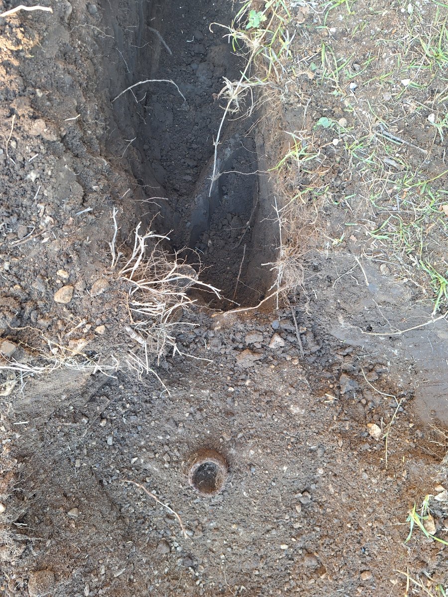

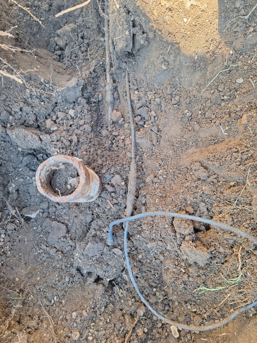

Digging my trench I ran into the old gas line, the old 3/8" copper water line going to the shop, some buried coax cable, and a huge chunk of concrete with a pipe sticking out of it that was some type of post at some point. Yay.
It's been cleared out besides the gas line. I dug out from under it so I can run the conduit under. I ran into this when I did the water line.

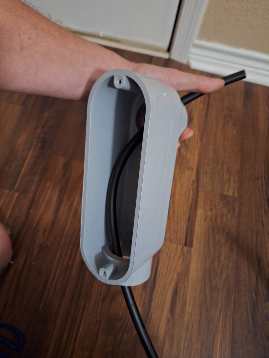

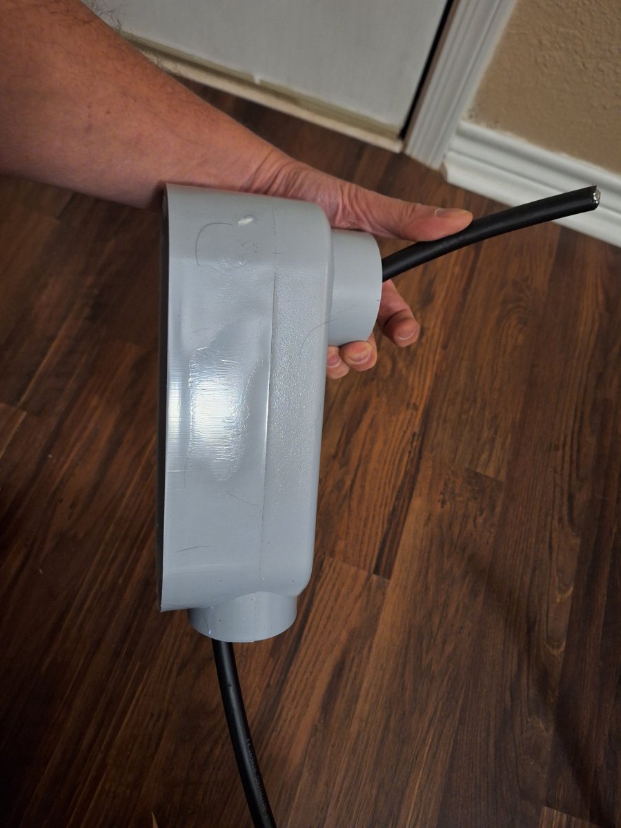

My biggest concern right now is getting the 1 AWG aluminum cable into the building.
I'm using 2-inch conduit, but I have a very real fear the cable won't be able to make this 90 degree bend. I'm trying to search for more info and options.
Looks like it should work. Might be a little tight.

When I was doing a trench from my house to the barn I used a metal detector to help make sure there was nothing that would surprise.me along the way. Of course I was using a trencher so I really did not want any surprises. No
Take the cover off, and feed it from the inside. When it comes out where the cover is, loop it up and over the top and then down the vertical conduit. Makes it easy to pull it in the horizontal conduit and feed it down the vertical conduit.
When you have the ends kind of where you want them, you can twist that loop as you push it down the vertices and it should roll over and bend downwards. You can push it in place with a hammer handle so you can close the box. Works best with two people.

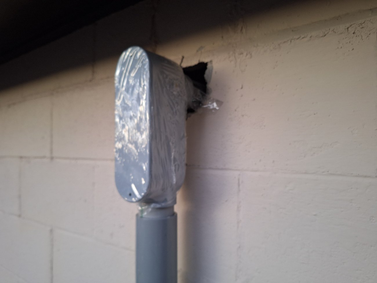

Don't worry about getting the wires into the bend at first. The first thing you need to do is get a proper length with a little extra for mistakes, and then pre-cut all your wires, ground included. If you forget to mark the neutral, you can do that later with a ohmmeter.
You need to get a pull rope into the conduit first, a fish tape works well for this. Some people use a string with a rag on it, and a vacuum cleaner to suck the rag through the conduit, I have never tried this.
Then carefully tape the wires to the pull string or rope. You could use the fish tape too. I usually make the ground extra long, make that one wire into a hook, and tie it to the string and tape it, and then tape all the other wires to the ground wire. Tape them so they are tapered so it's smooth and won't catch in the conduit.
Then with a helper, someone pushing, someone pulling the string, pull the wires through. Don't worry about that bend (it's called a "LB") just pull the string and the wire on the outside of the building. Once you get the end there, keep pulling, estimate how much wire you need in the building, and pull that all out on the outside of the building. Then if the panel is just on the other side of the wall, take all the tape and the string off, and you can then push each wire individually into the panel through the LB.

I totally concur, but let me emphasize how you tape the ends and create a hook to pull it through. The first few feet pull fairly easily, then it’s like trying to pull a Sherman tank out of the mud when you get 2/3 of the way down trying to get to the end. I’ve never done wire that heavy, but I learned the hard way half a dozen times that when the friction builds up, you pull the pull string off of the wiring, instead of pulling the wire through the conduit.
It’s an excellent idea to leave the ground a little bit longer and bend it over. But I would actually bend it over and twist it, and then tape it smooth. Run your tape from the backside by the wire up to the hook so if the tape catches on anything, it will just slide over, not ball up the tape.
Also, if you stagger the wire ends just about an inch or two, nothing that will affect how much wire are you use, the whole end of the bunch ends up being tapered down to the ground hook that’s on the pull string. It’s not a bad idea to chamfer the ends too. A little tiny 1/8 inch lip can catch on a joint in the conduit, and make it impossible. Don’t spare on the tape so it will feed easily.
Jim, I'm not going to read thrpugh RickW's book. But, you're doing fine. That wire will go in fine. Do that part through the wall last. You can bend that wire sharper than what is shown in your photos. You are using oversized conduit. So, it should pull pretty easy. As someone mentioned, smear some dish soap heavily on the first 2 or 3 feet. That will help it through your bends. Don't overthink it. Go slow, check both ends oeriodically to make sure you're not snagging something or scraping insulation off the wire.

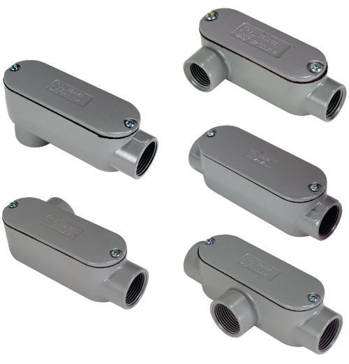

By the way, if you haven’t found out yet, some of us often use the term LB as a general term for several different styles of fittings. These fittings come in styles with the cover, entrance and exit in different configurations. LL, LR, LB, Tee, straight through. Choose what works best in each case.
