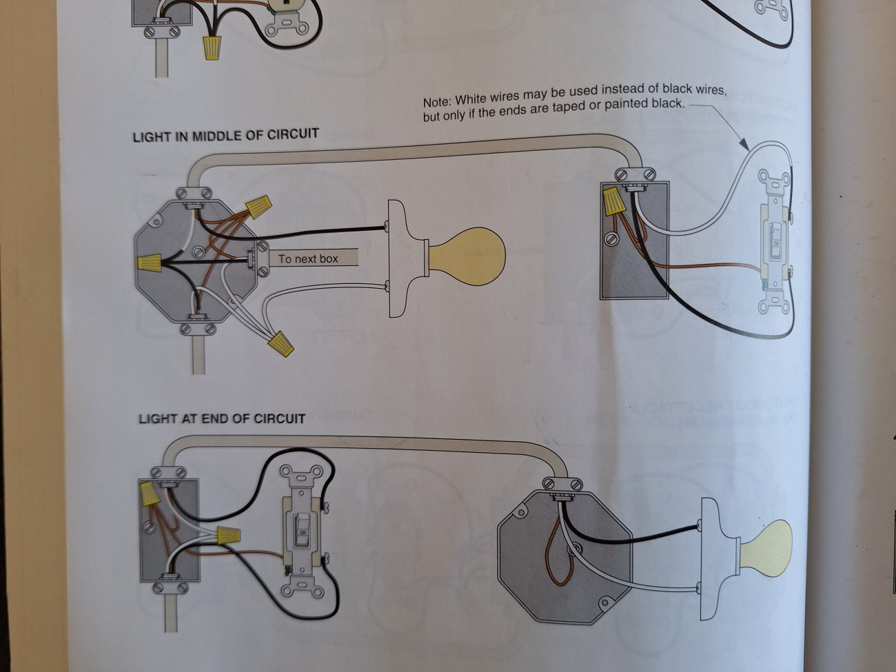

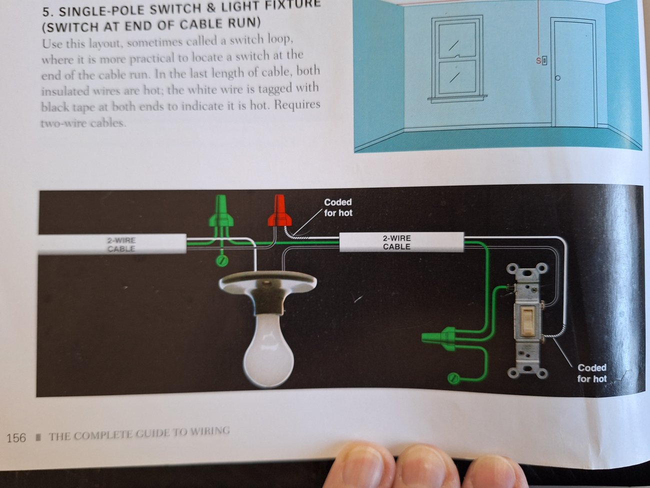

The way you used to do it, yes there is a white wire going to the switch. But that was because the romex came with a white wire. You would take a piece of black tape and put it around the white wire, the white wire became a hot wire. Power coming in on the black wire, power leaving the switch going back up to power the light on the white wire. So in the old days, a switch leg had 2 hots and a ground, no neutral. Using the ground as a neutral is a no-no.

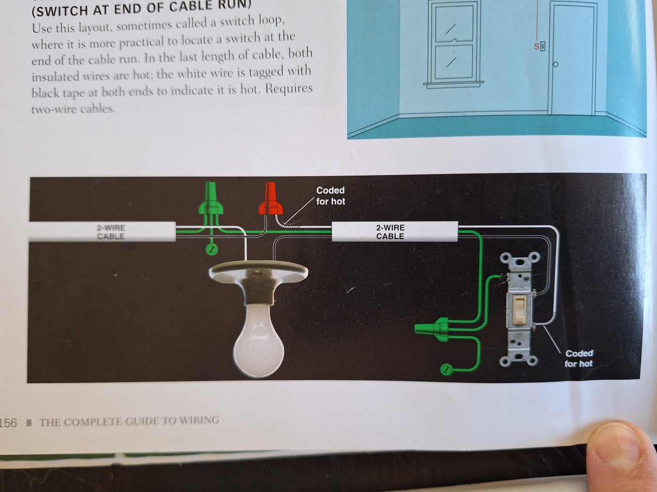

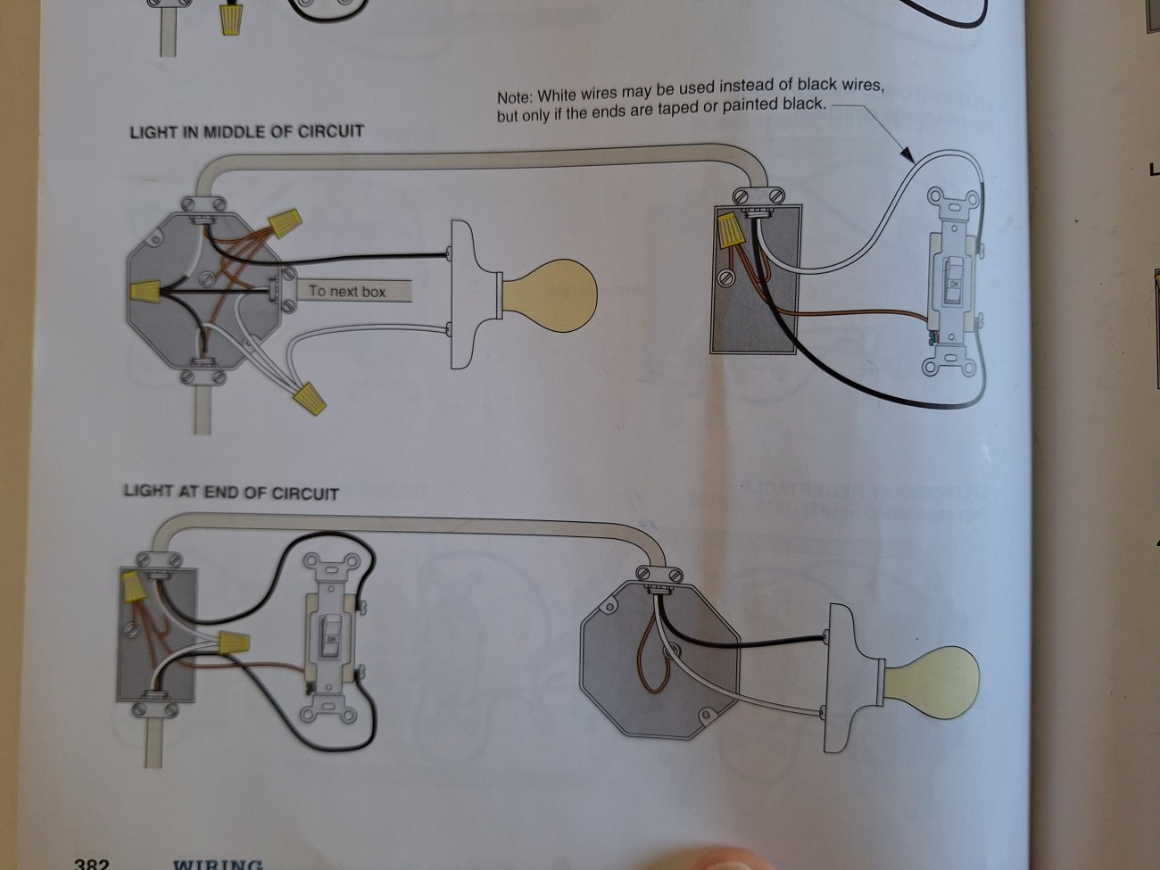

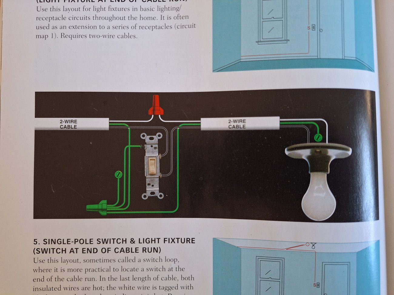

I retained the wire that ran from a junction box in the shop attic to the switch. I have a wire that comes into the box from the breaker. The black (hot) wire from the breaker goes to the black wire to the switch, when the switch is turned on it continues the electric along the white wire which then feeds the black (hot) wires going to each light. The white wires for the lights are wire nutted together along with the white wire going back to the breaker, and the bare ground wires are all wire nutted together.
I bought these (2) books a few years ago:
The Visual Handbook of Building and Remodeling
Black & Decker - The Complete Guide To Wiring

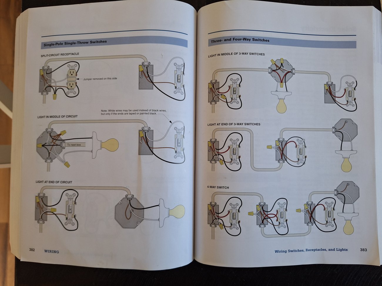

And I use them if I'm not sure about something. They have a lot of diagrams for different types of circuits, but I looked at these before wiring up the light switches:

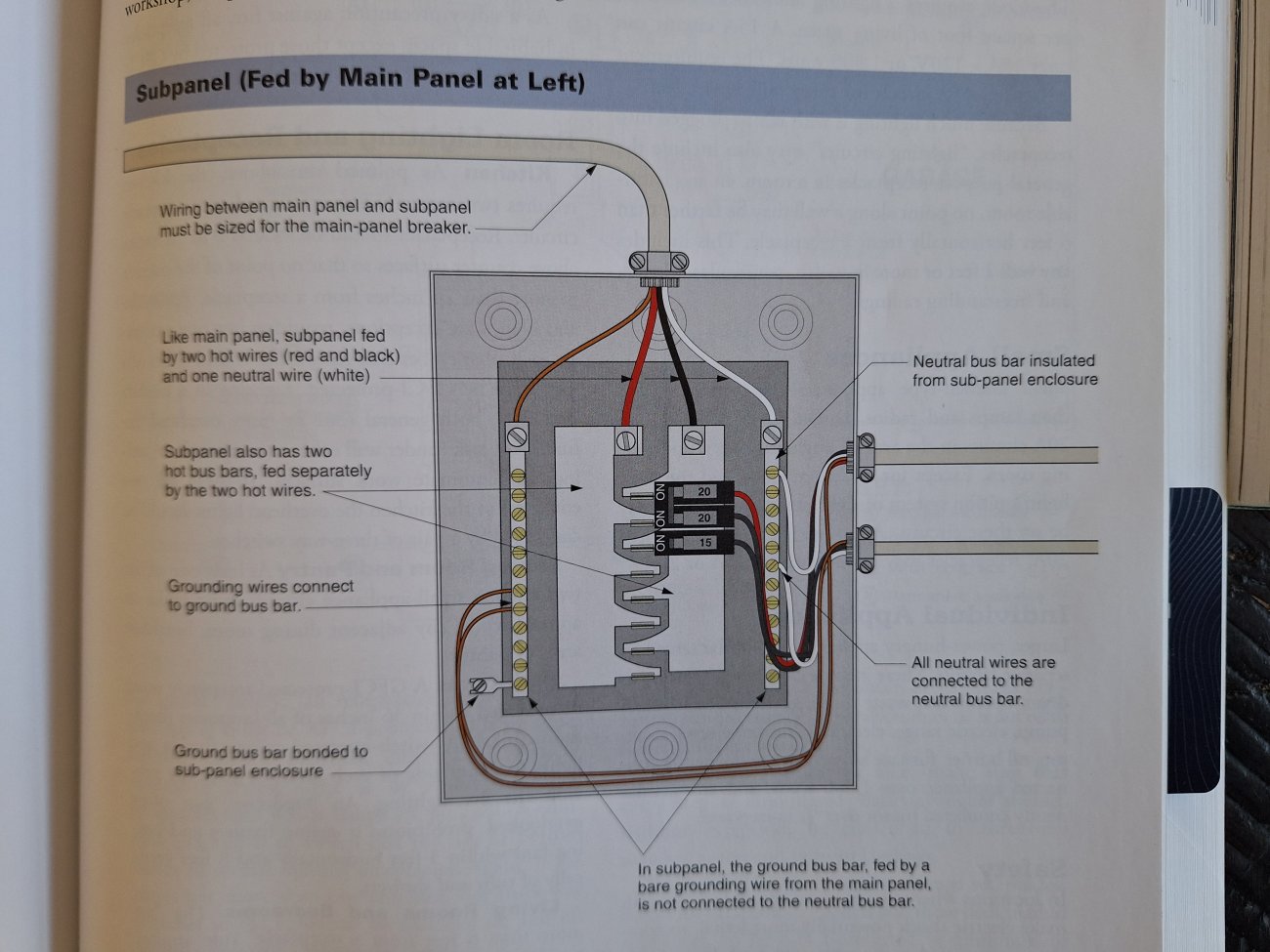

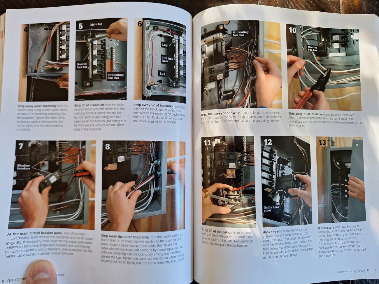

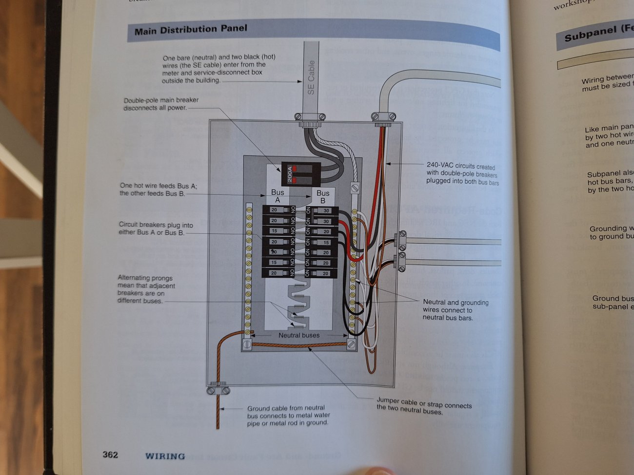

They also have sections for adding a subpanel that I'll use when I start wiring the subpanel:

See how this is your main power where the power comes in from the power company. See that brown jumper on the bottom that is tying the ground and the neutral bars together, making two neutral slash grounding bars all together.

I bought the extra ground bar when I bought the panel. My only concern is that it's not a 'sub panel' because I wanted / needed a main breaker on it. It came with a big green screw and I'm thinking that besides adding the ground bar I don't install the big green screw. I haven't really looked at it yet. I think the subpanel being used in that video I posted is essentially the same one that I bought.
Jim, you are installing a sub-panel. In your instance, you do NOT use the green bonding screw. You DO use a separate connection bar for your grounds.
Grounds and neutrals are only bonded to each other in one place in a service. That is in the mainbreaker panel or the meter can. Your subpanel is a part of your primary service for the entire property. The bonding that is done in the breaker panel or metercan on your house provides the single instance of bonding.
The reason for this is that if the neutral and ground are bonded a second time somewhere else, such as your subpanel, this creates a parallel path for current to flow - some through the neutrals and some through the ground wire. That is not safe because the ground wire is not insulated. The purpose of ground wire is to conduct fault current only. That is, they never carry current unless an appliance shorts to ground or you drop your curling iron in the tub, etc. Those are fault currents. So, by not bonding the neutral to ground at the subpanel, we prevent normal currents from taking a parallel path thtough the ground wire.
