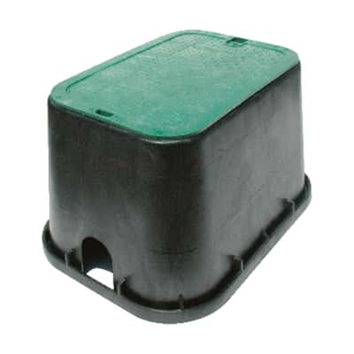

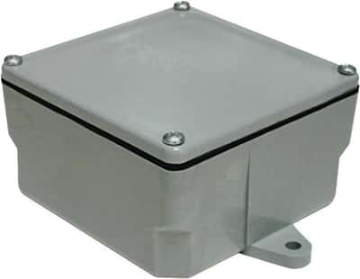

I just read back through his description. He’s still going to need a pull point somewhere even if he used LB’s where he went through the walls into the house and shop. If I was doing it, I probably would have cheated with some gently curving trenches instead of some if those 45’s, if possible. In the Texas sunshine, that conduit would have layed in a gently curved trench very easily.I should have read @Curious Hound post first, but these are not considered bends.
So between the one coming out of the house and the one going into the shop, the only bends you need to worry about are the ones underground.
