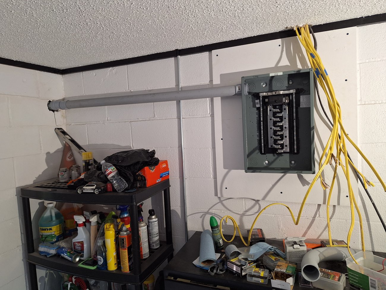

The breaker panel is mounted, and I have wire for all of the circuits running to it. I went through and installed outlets and switches in all of the boxes and wired up all of the connections in the junction boxes (light switches are always fun). I struggled trying to get a light switch and GFCI outlet to fit in a box and finally got them crammed in there. I think it's going to be 50/50 that they work or throw a breaker.

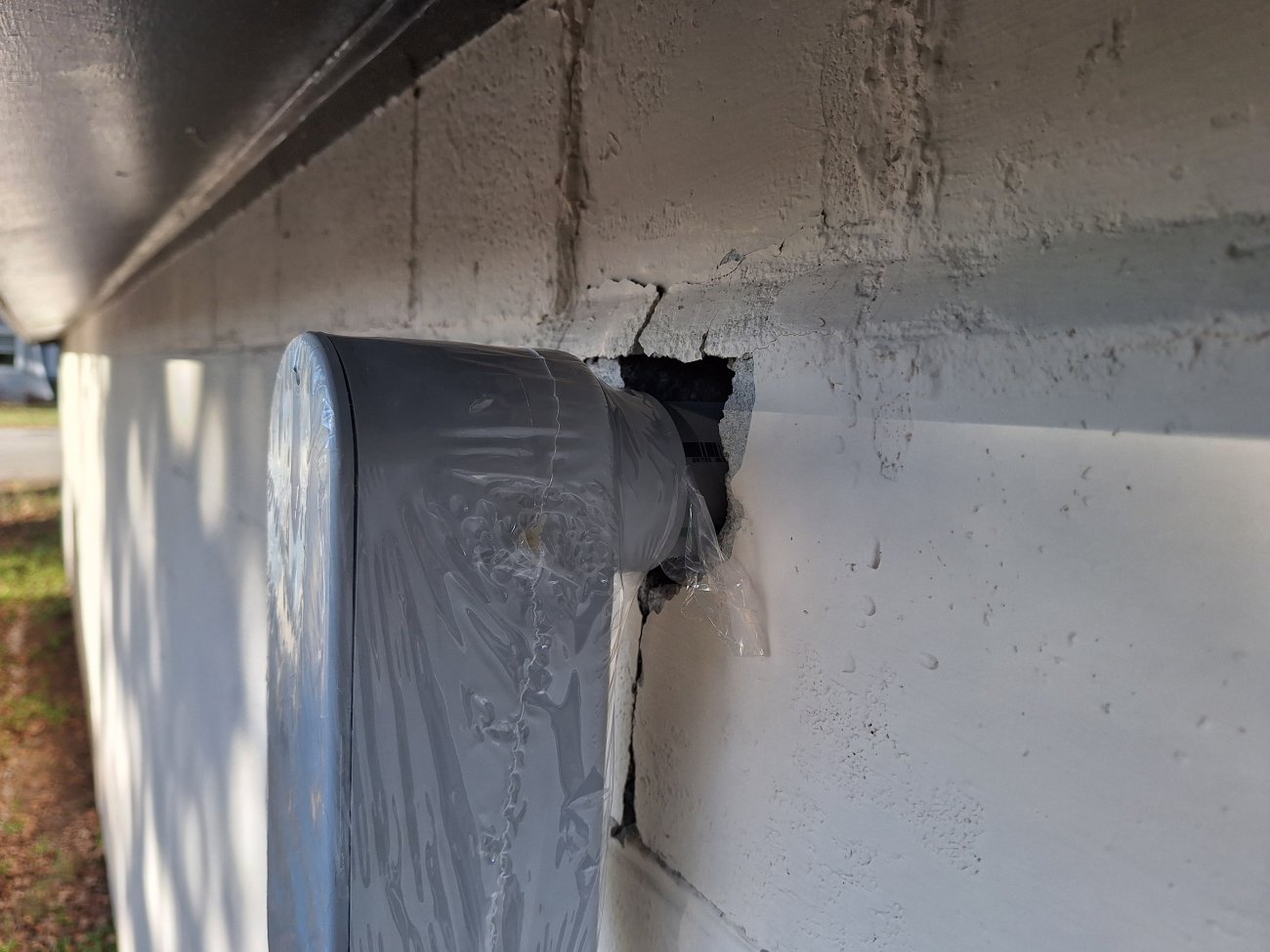

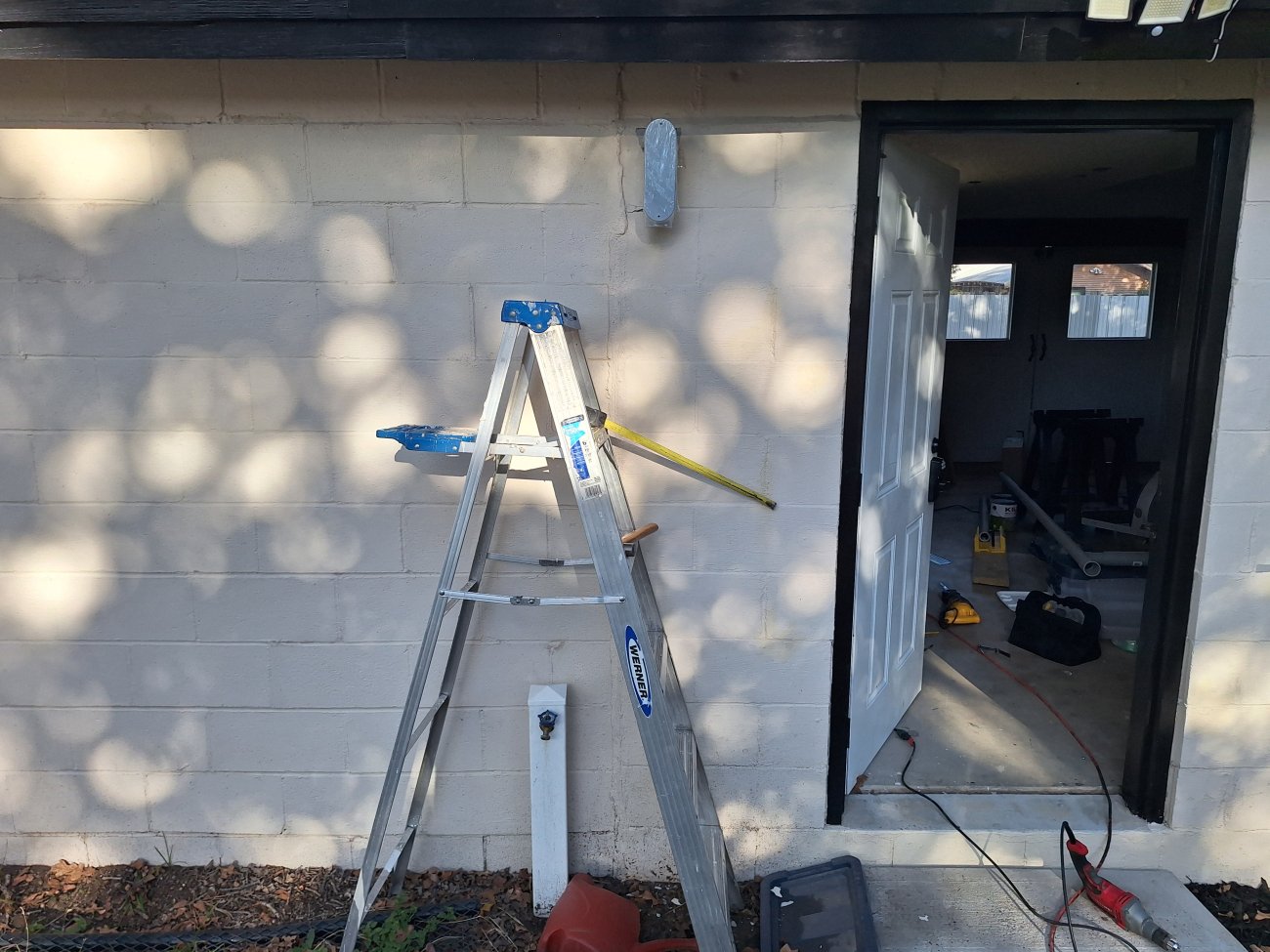

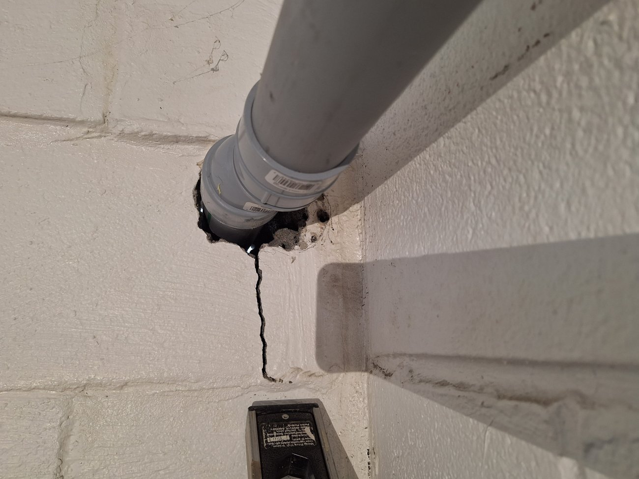

I made a hole in the cinderblock to get the 2-inch PVC conduit through. I had to get a 'meter offset' to stick on the end and move it away from the corner to get through the void section of the block.
I need to take a little more off the bottom of the hole to level it, and then figure out how to fill the gaps with cement and fix the concrete without it all falling down through the void in the blocks.

Lowe's /Home Depot sell a concrete repair caulk in a tube that would work well for that.
