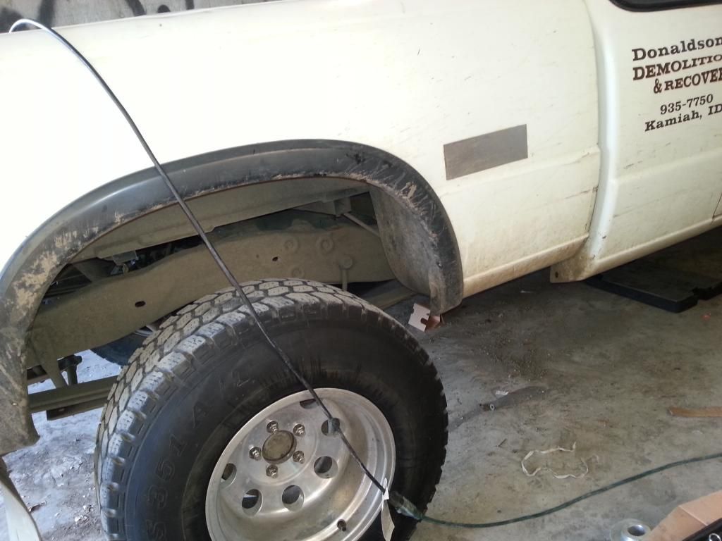

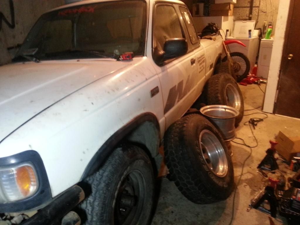

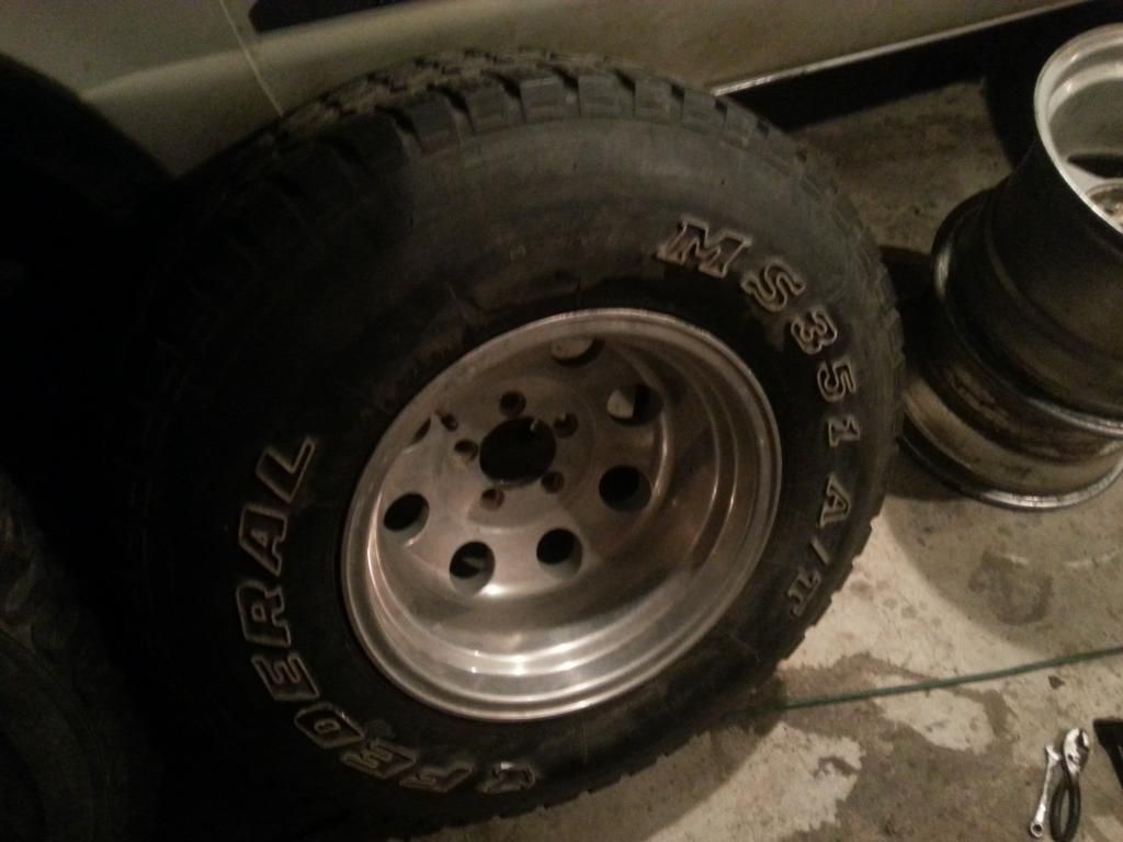

asked my girlfriends dad if he had any rims (owns a junkyard) gave me these, so i mounted them on my free tires. shop refused to balance them, got lucky any ways, never had any vibrations.

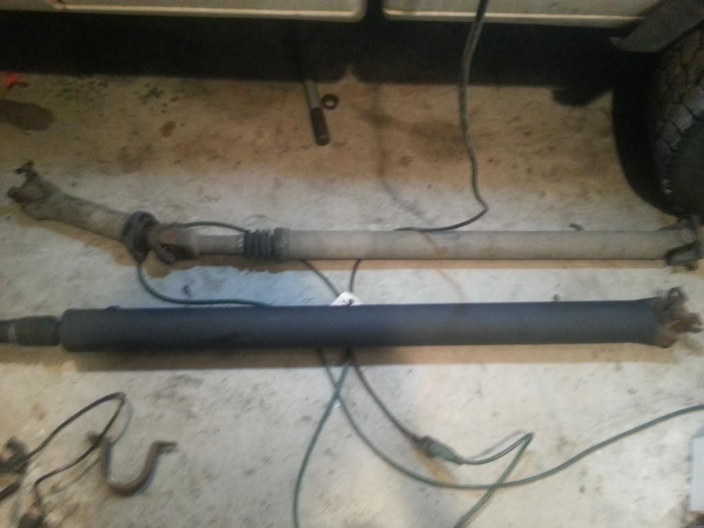

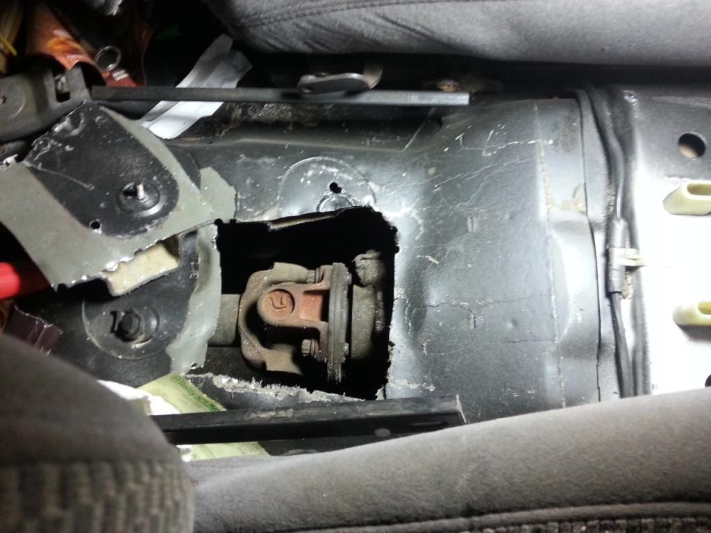

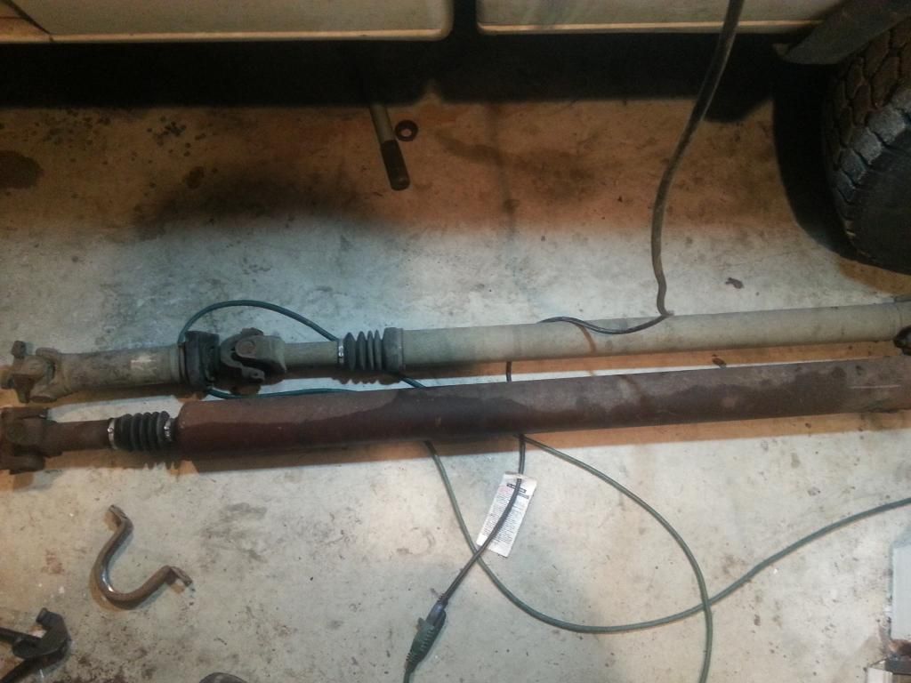

i had a clunking sound every time i took off, thought it was the u joints in the drive shaft. so i did a clutch in my moms car for her, in return she bought me a 1 piece drive shaft.
my mazda
all painted.
my mazda
turns out it wasnt the u joints, and the larger diameter shaft just made it worse.it was hitting the bottom of the cab at every bump. i HAD to take the truck out of town. so out came the sawzall.
my mazda

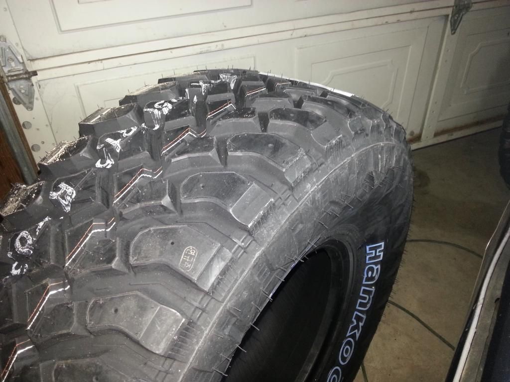

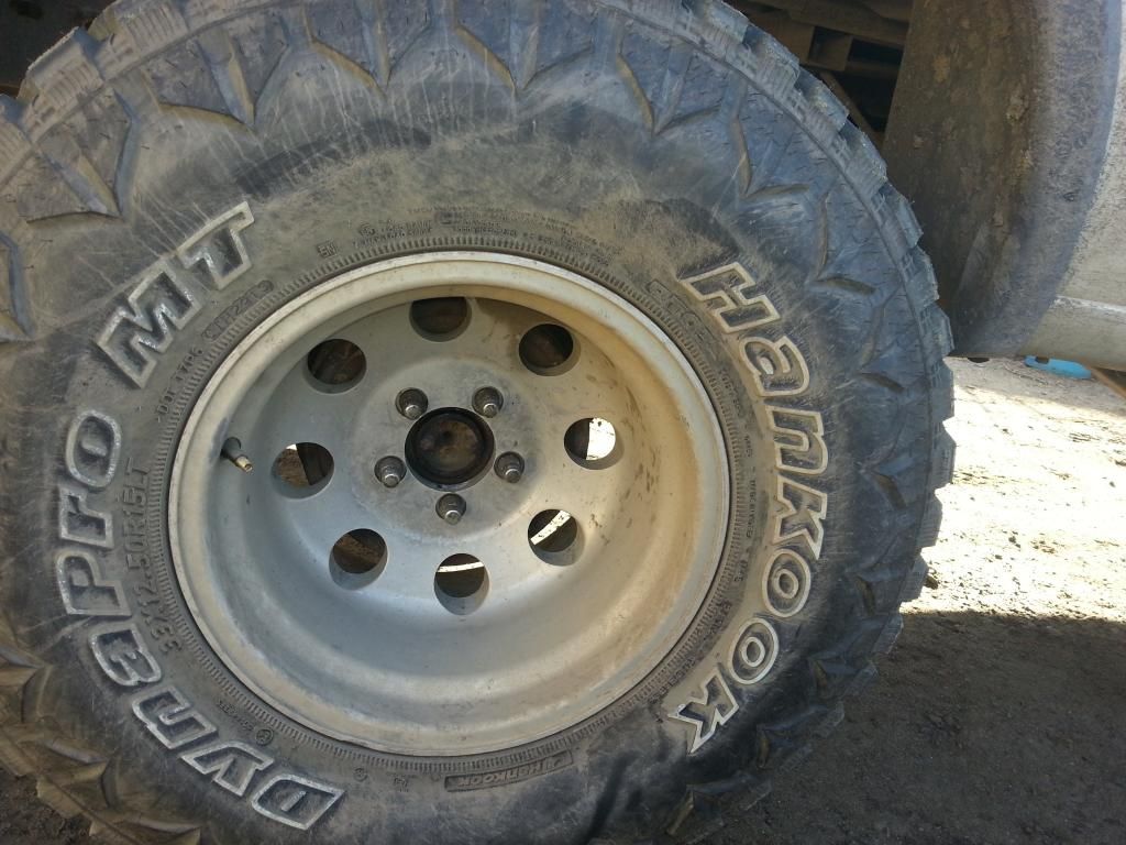

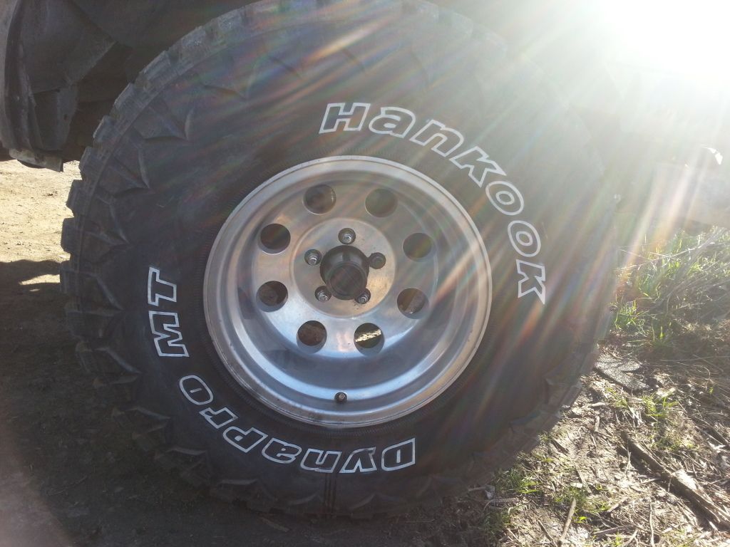

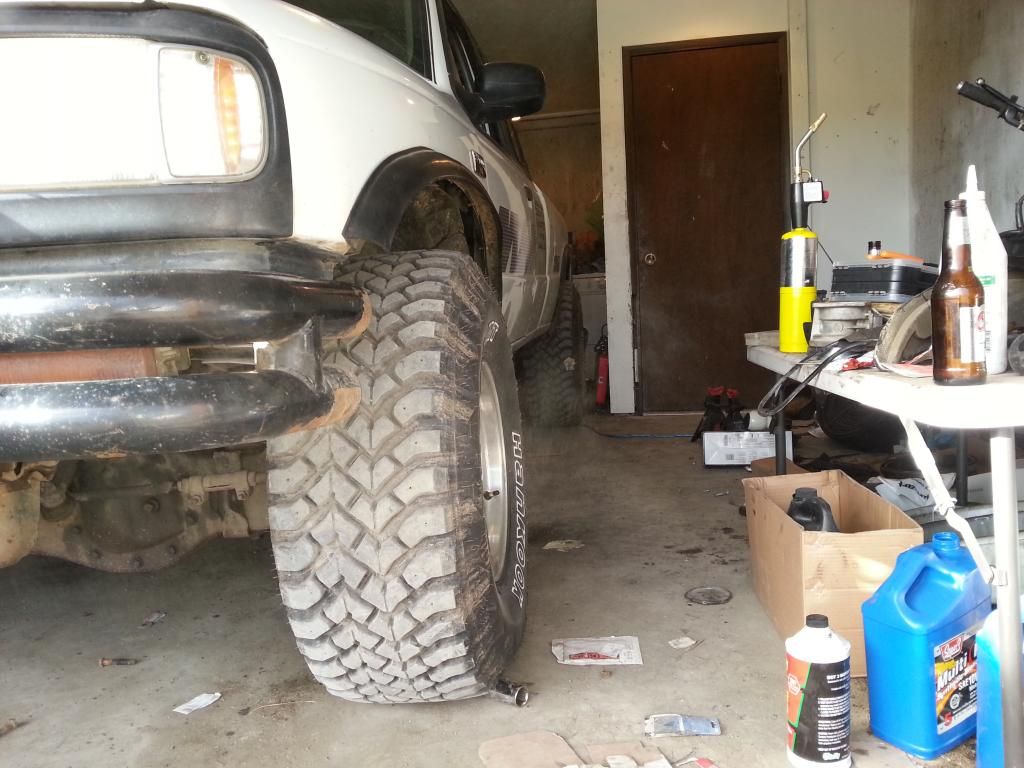

drove it with the 31s and a 2 inch body lift for a few months, saving up more cash for more upgrades, then i pondered on 33s or 35s, ordered some 33x12.50xr15 hankook dynapro mt, 800$ mounted and balanced. so far i love these tires. bought a aussie for the dana 35. tryed to order a lockright for the trak lok 8.8, after a few weeks of it not shipping i returned it and tryed to buy a detroit for the 8.8, it was on back ordered for 8 weeks.
so i got a refund and bought a 42 inch led light bar off ebay. i have yet to have any problems with this light bar, and i would recomend it. 150$ at my door.
put all this in within the last 2 months and wheeled it quite a bit.

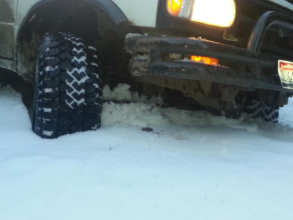

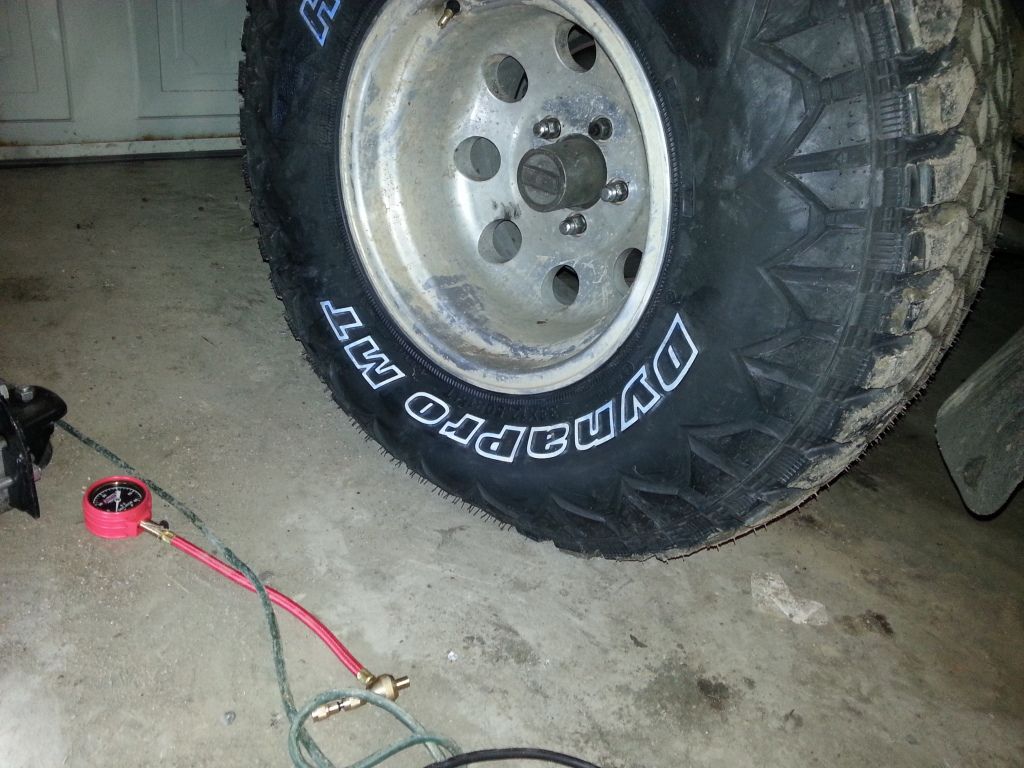

10 psi, these tires air down great!

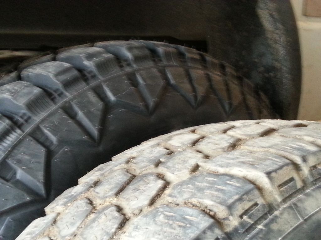

31 next to the 33

i think these look terrific mounted up
my mazda

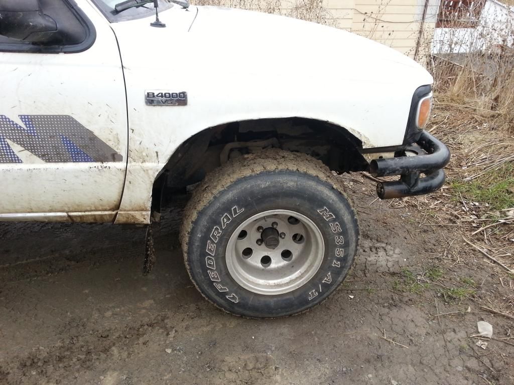

flares on, 2.5 inch surface mount, there barely enough

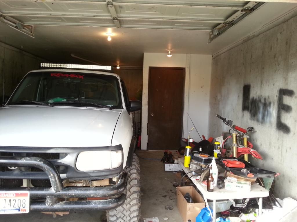

my tiny garage, with the 42 inch light bar mounted. rather have this garage than no garage tho. bit small with 3 dirt bikes in there.

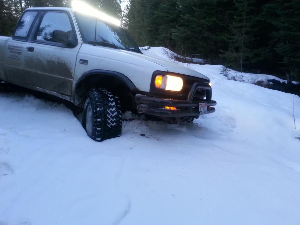

light bar at night, cameras dont show the light very well.

42 inches is just about perfect, 44 inch probably wouldnt fit without some sort of brackets.

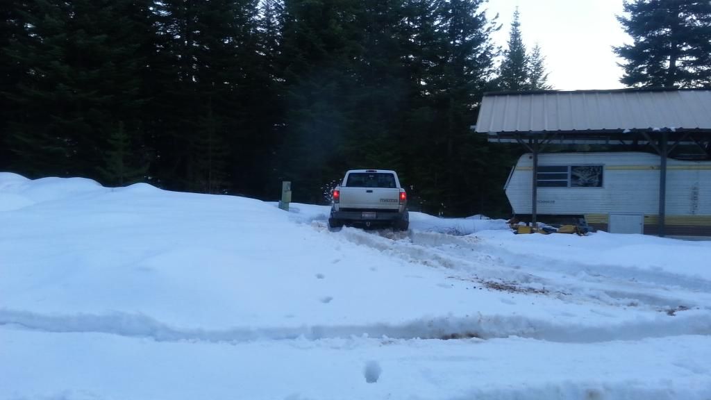

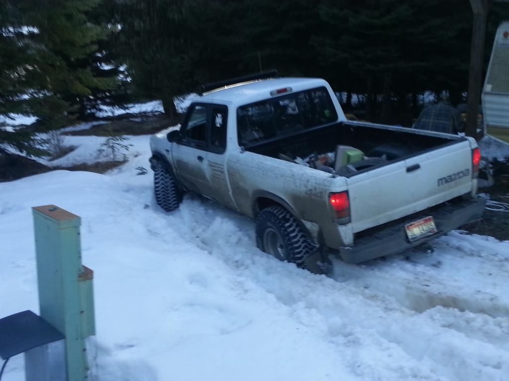

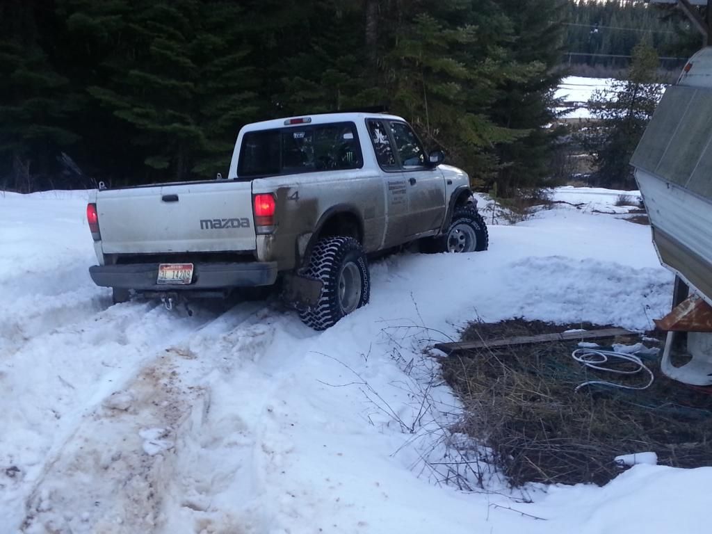

went up to the property, didnt air down, was just screwin around. aussie preformed flawlessly. drug frame and pushed snow the whole time.

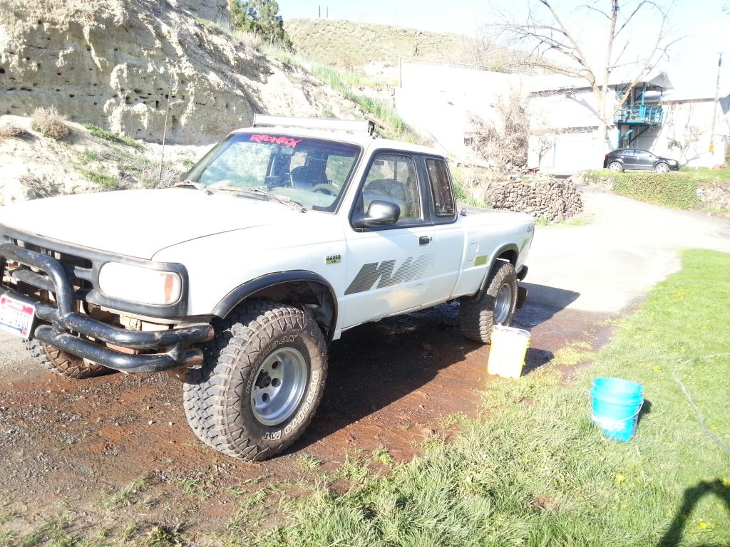

my mazda

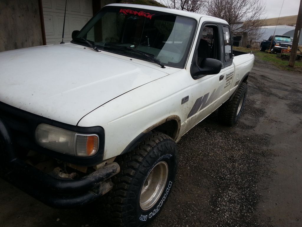

all cleaned up, as many scratches as it has it still looks good.

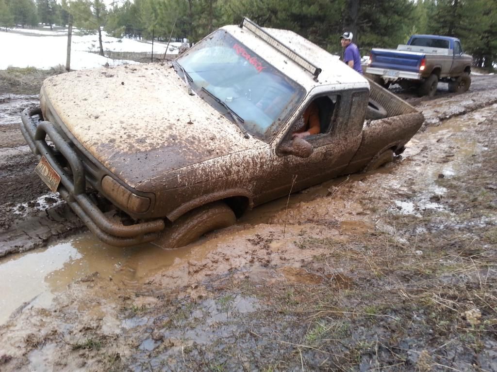

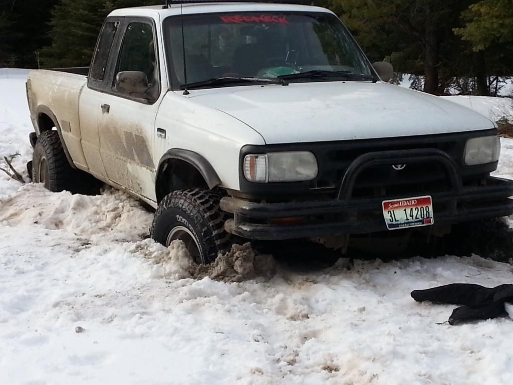

burried to the ttb, had to be pulled out by a one ton.

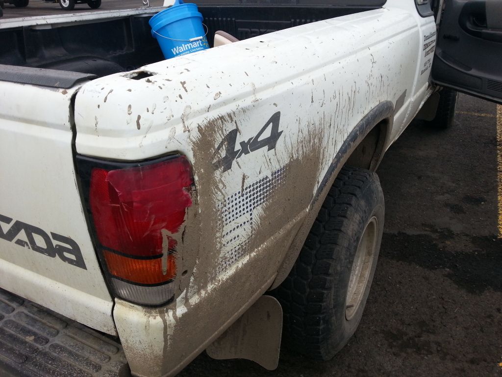

3 days after i washed and waxed it we took a trip to hoover
my mazda
thanks for looking.
Thanks, I try.. but its still a trail truck before any thing else.
Went back to Hoover side of the road is a slush box. Got pulled into it the first time then decided to play in it. You can see where I drug going both directions.

My buddy in the f250 with a 460 and 35s didn't make it as far as I did, made it about where I stopped in reverse. Thanks to the aussie locker. He flooded out in that spot and I had to pull him out only took 30 or so pulls to get him out.
Both of our steering boxes are leaking at the Pittman arm after going through that.

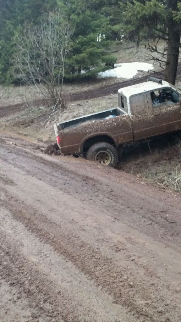

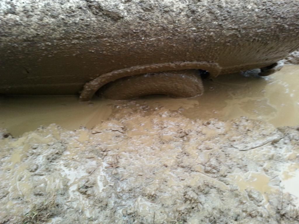

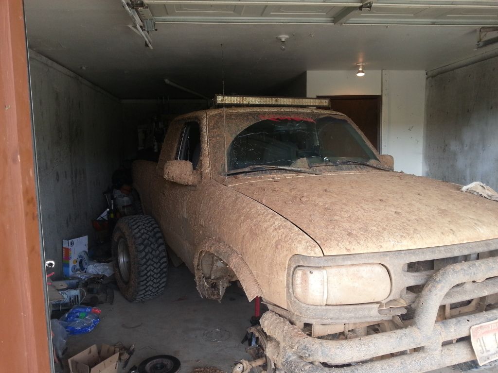

Didn't take many pictures because most of the holes are just to deep. Started going into one whole and the mud itself was above my bumper and being pushed by the oil pan so I backed out. I do have more to upload once photo bucket cooperates.
Came home and lubed her up to find the beams filled with mud.

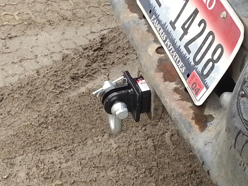

One of those "betcha can't" moments.... hit reverse and dug in. Had to be pulled. Tough ass bumper. Damn thing didn't take any damage.

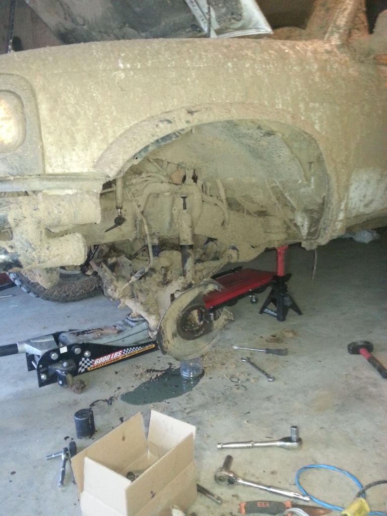

Tore it down to clean it all up and shim my sagging coils. I had some old washers laying around from my radius arm bushing kit that I used. Worked perfectly. Took an old center concsole and made some mud guards for my door hinges too.

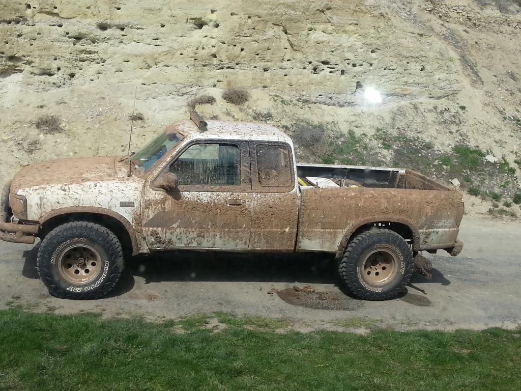

My buddy says its camouflage. First time he saw the truck it was covered in mud. He came up and. I just happened to be starting the wash. Said he had no idea it was paste white.
Cool truck, man. Looks like it can hold its own.

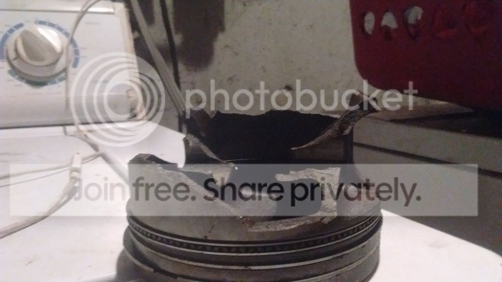

updates... went to the pull and save pulled a sohc.
at this point the truck has been in the garage for 6 months with no drivetrain
i built some extended radius arms, extended 12 inches, kept the donut style bushings (because of mud), put in a set of 3.5 eb springs from the bronco grave yard (320 ppi, for road usage), lifted the rear using belltech 6400 shackles, super packed the limited slip rear, added f250 shock towers
my goal is to have a dana 35 ttb that will support long travel on 37's, i do not plan nor do i want to sas this truck, i want to keep the ttb.

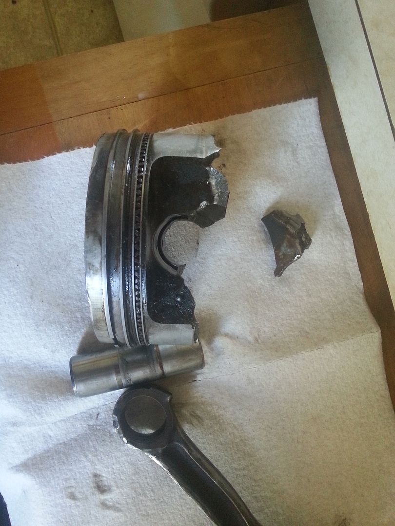

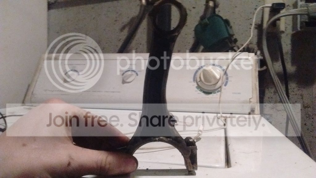

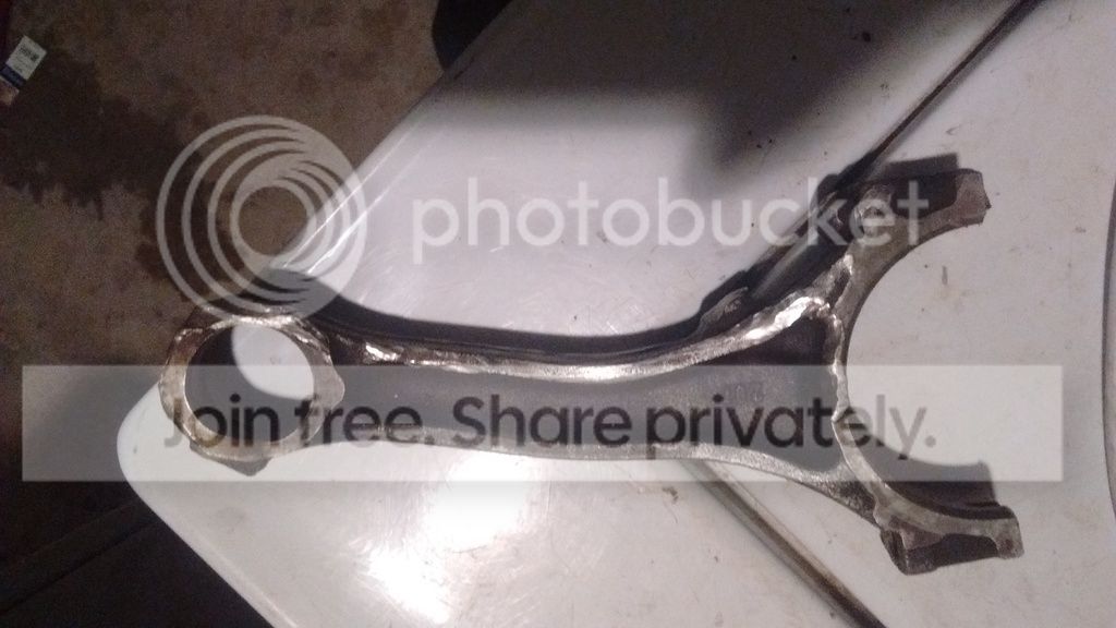

pulled apart the old engine

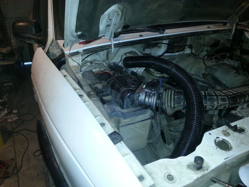

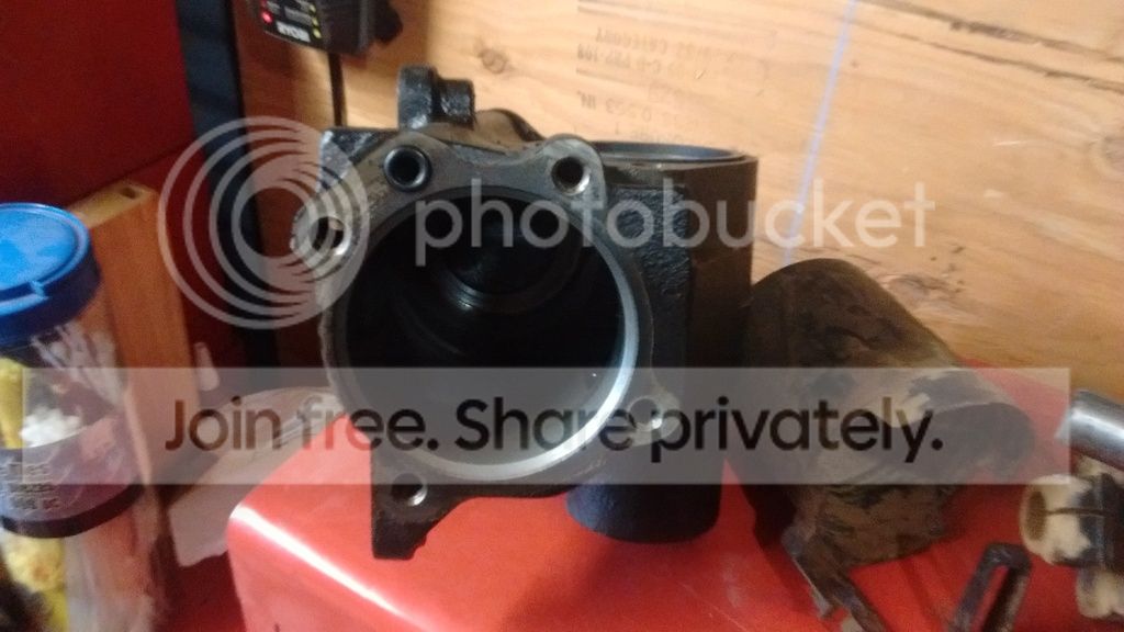

picked up a 1996 engine, swapped the intake, drivers side exhaust manifold, motor mounts, and all the old sensors onto it. i did not have to swap the oil pans.

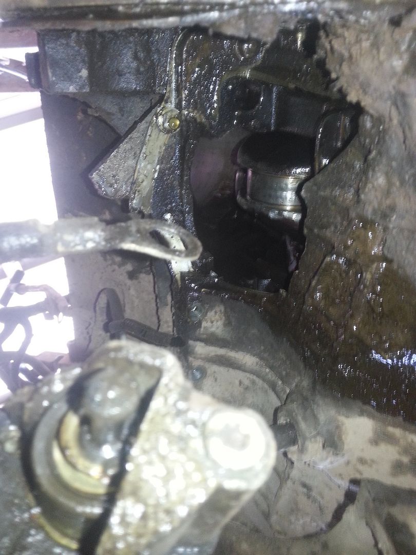

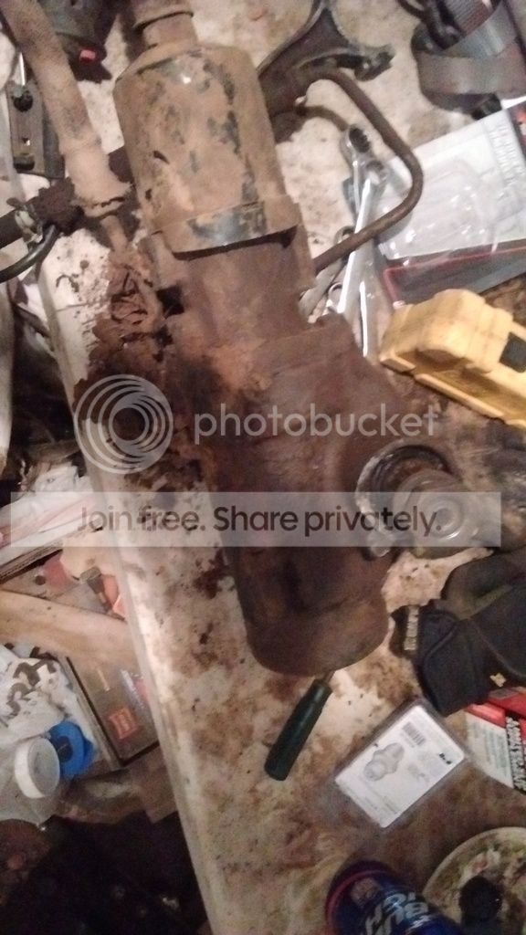

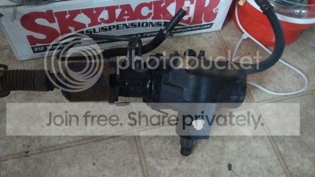

the gear box was leaking, so i pulled it apart and put new seals in it. there are 28 ball bearings in this thing!
my mazda
my mazda
my mazda
my mazda
it does not leak anymore, and i feel like i have more steering input.

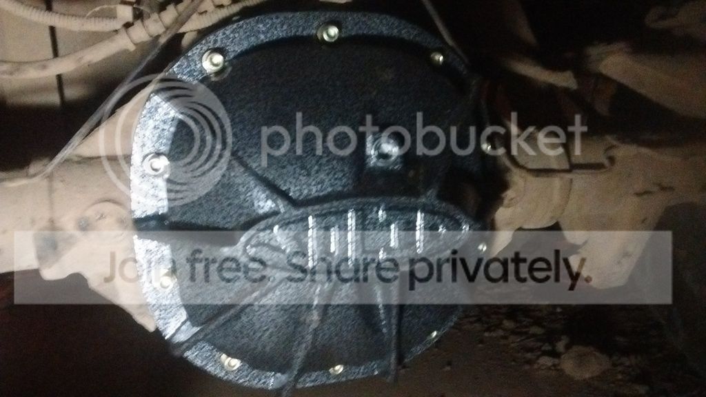

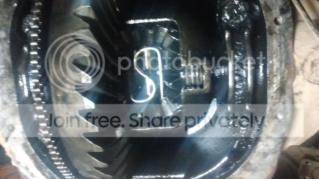

decided to super pack the rear limited slip, since i had the original cover, i decided to replace it as well.
my mazda
my mazda
this is the not super packed unit, you can see that there are only 3 tabs sticking out.
my mazda

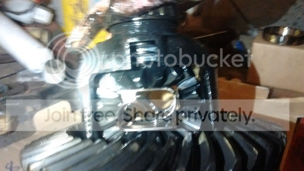

this is the super packed unit, you can see that there are 4 tabs sticking out, being as that i replaced a steel plate with a clutch pack.
my mazda
at this point the spider gears wouldnt just rotate in like usual, i had to hammer them back in, along with the pin...
my mazda
it was hard to measure but it did take up about an 1/8" of room after the super pack, if you look closely you can see the difference in the spring.
if you want positive traction to both wheels and cant justify the 500$ for the limited slip unit locker, i would recommend this, as i only paid 80$ for the clutches.
i have very minimal fuss about this and will continue to use it. it makes no noise in a parking lot, or when turning. the only time i even notice it is in low traction areas, thats when it does act like a spool.
