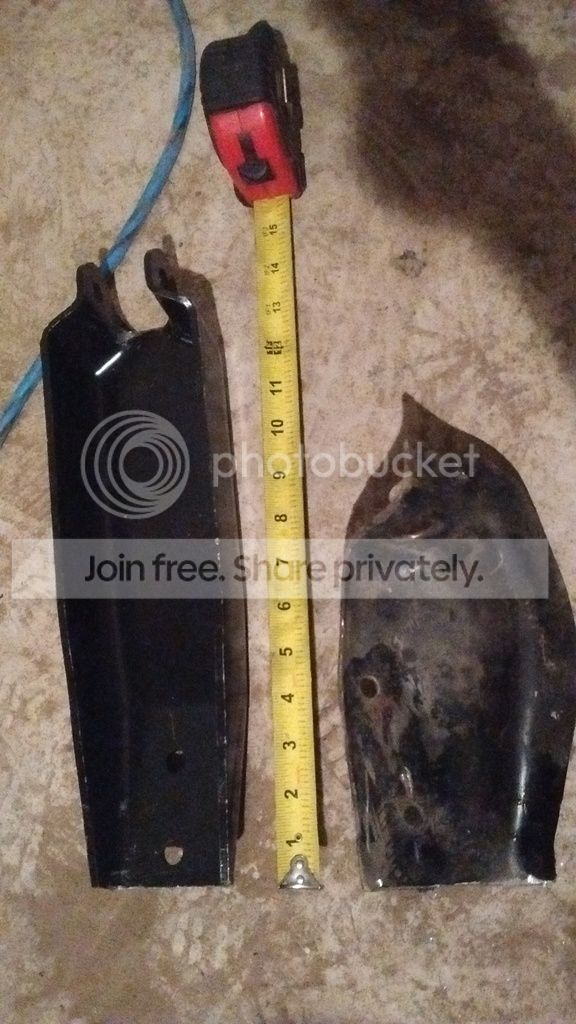

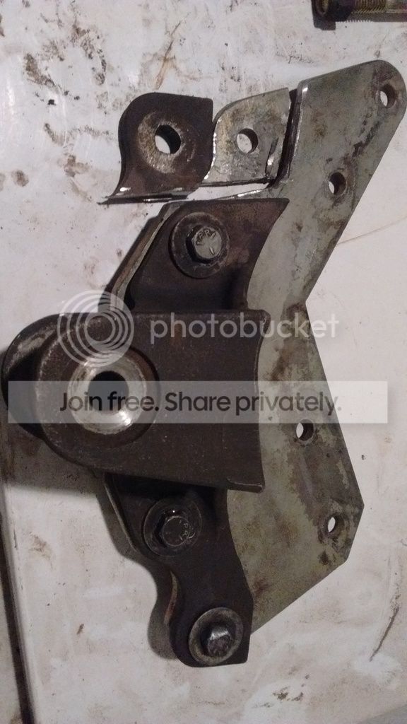

so i wanted more lift so i ordered some 2 inch skyjacker rbv coils for the pickup, some time later i went to the pull and save i spotted a few rangers with lift kits installed, so i pulled the lift brackets off of one of the rangers, and modified them.
this turned into buying 3.5 eb coils, extending the radius arms, and installing f250 shock towers.

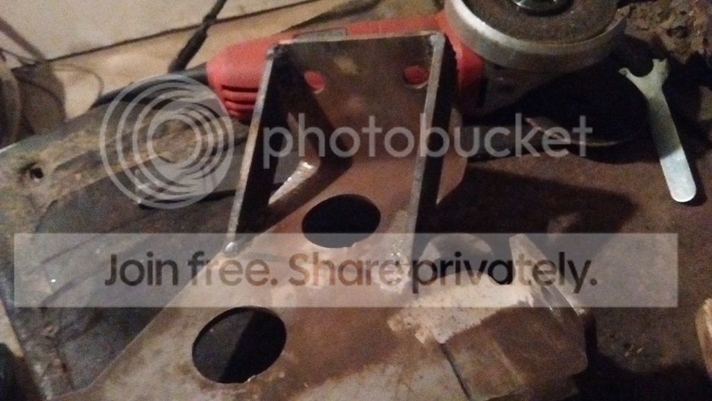

had to cut the shock tower off the coil tower, for the f250's, i mounted them seperatly from one another so i could move them up/down to compensate for whatever.

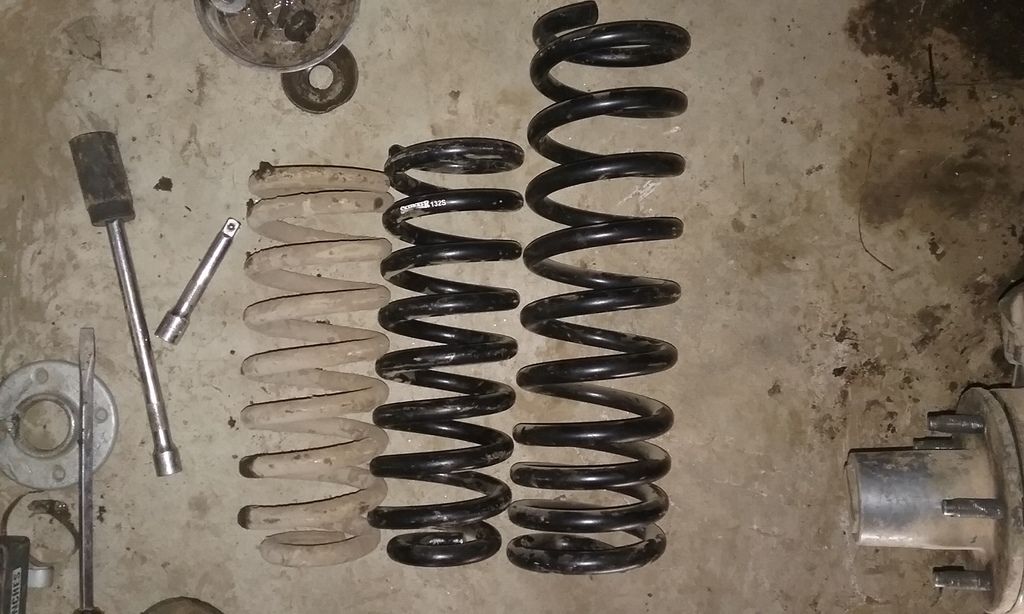

from left to right, stock coils, 2 inch rbv coils, and 3.5 eb coils.

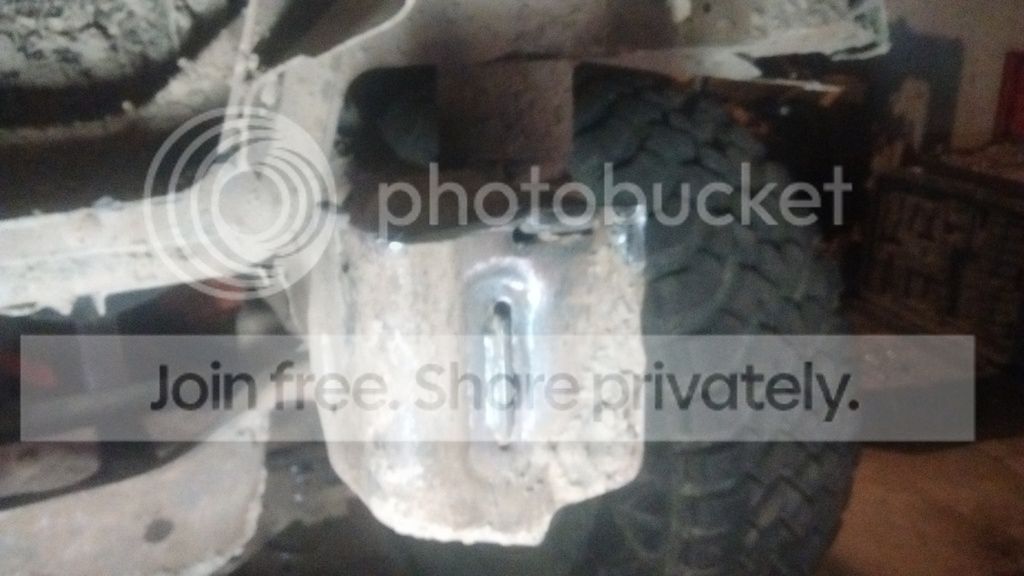

i extended the radius arms with 2 pieces of 15" 1/4 wall dom, for a total of 12" per arm, it came out perfect to where the holes for the transmission crossmember and the radius arm cross member use 1 of the same holes, on the same side, and yes i did reuse the stock radius arm crossmember.

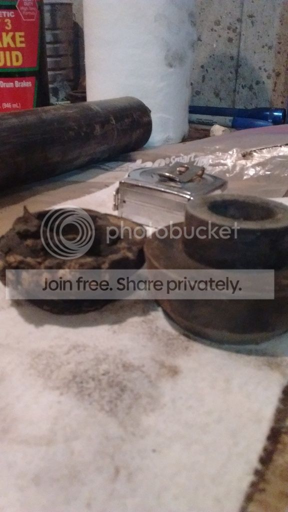

here you can see how maxing out the stock radius arms was chewing up the rubber bushings, in fact these have less that 2000 miles on them.

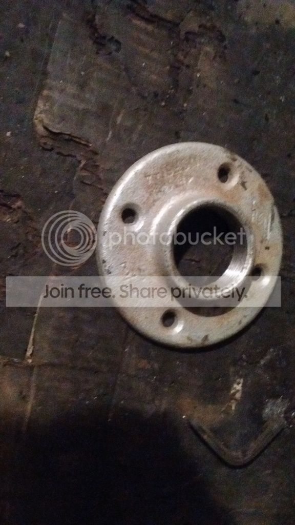

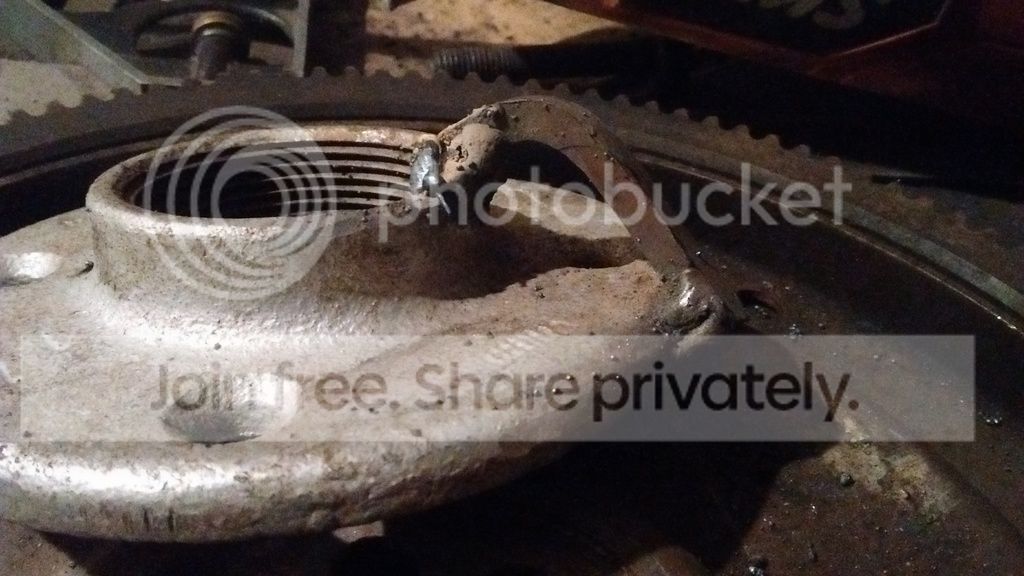

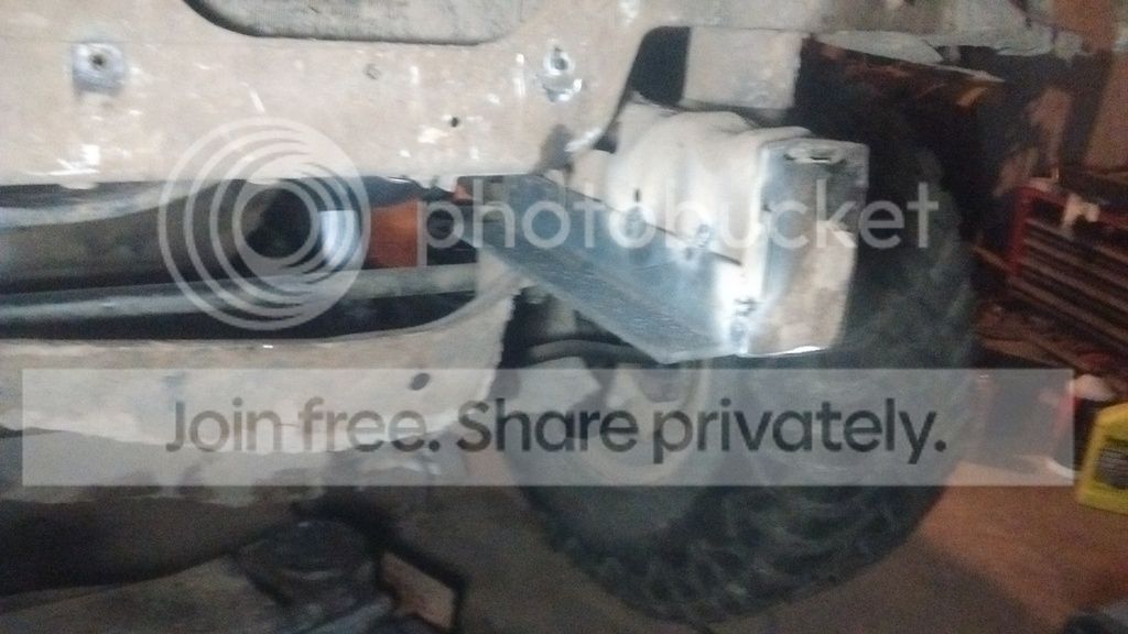

had to figure out a way to seat the coils, and then retain them. visited home depot, grabbed some 4 inch piping ends (im not sure what its really called). they fit the 3.5 eb coils perfectly.
my mazda

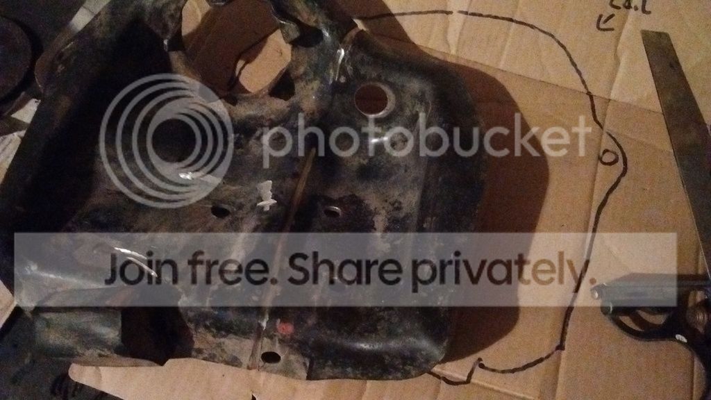

took some scrap i had laying around and folded it over.
my mazda

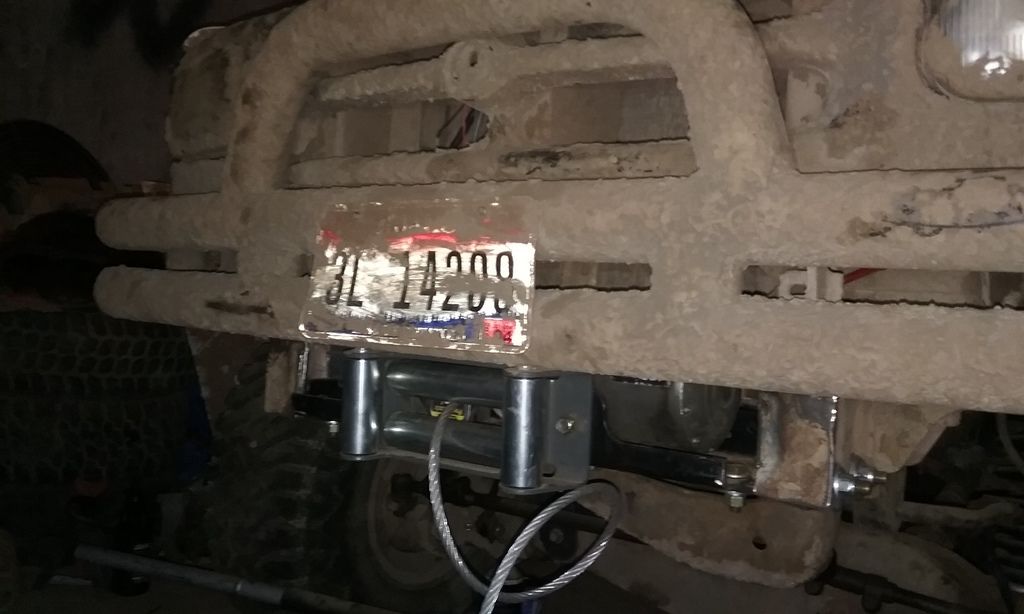

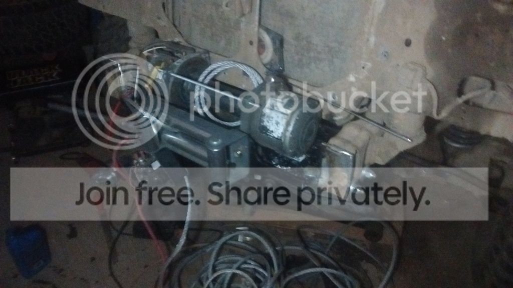

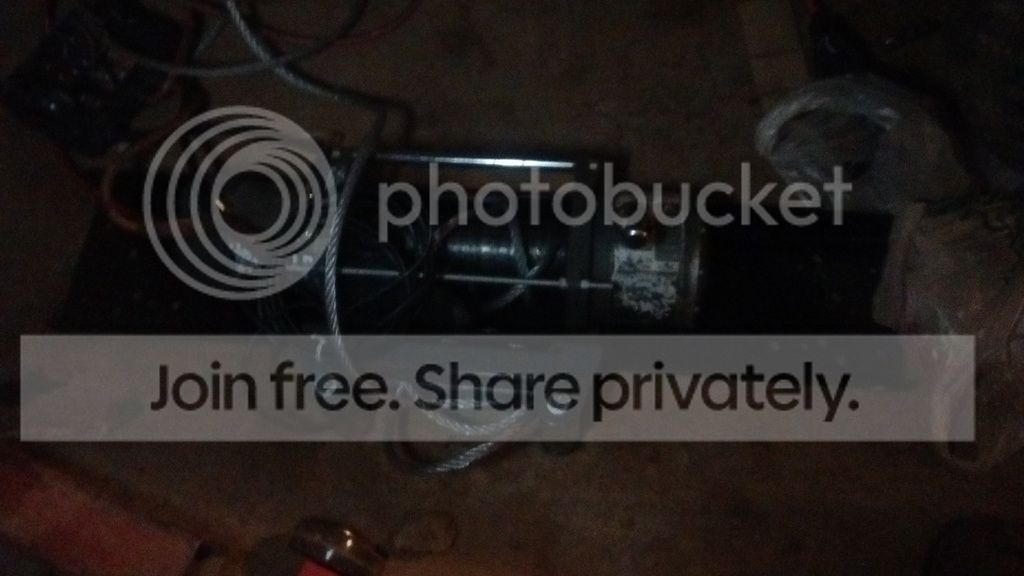

picked up a 12k lbs winch.
my mazda

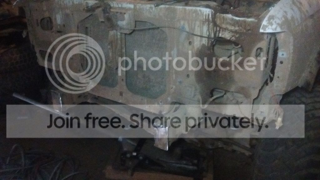

decided that i wanted it between the frame rails, so i started trimming these ends caps.
my mazda
my mazda
picked up some angle iron, each side uses 4 bolts through the frame, past the crumple section.
my mazda
my mazda
and then as it turns out, the 2 inch body lift left the perfect gap for the bumper, it sits right behind/ on top of the fairlead, and it looks alright.

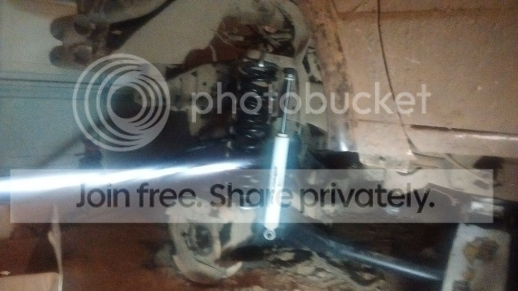

this is one of the first pictures i took after installing the 3.5 eb coils, and some 10 inch travel shocks, with the lift brackets on. i decided it was too tall for the 33's, and i would need taller shocks, for full droop. at the time i was also experiencing some problems with the brackets, so i took them off, and raised the coil buckets 1 inch. i was able to get it aligned and only gained 2 inches of lift.

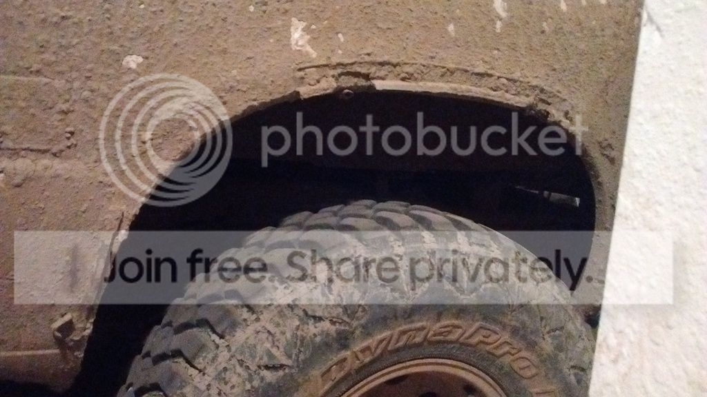

i have trimmed my front fenders a lot, and my rears not at all, so it appears that the front is taller in the first pic, when in reality it is not. once i trim my rear fenders for larger tires, i will probably have to remove the block in the rear to get rid of the rake. the 2 inch body lift and 2 inch suspension lift is the max i am going as of this moment.

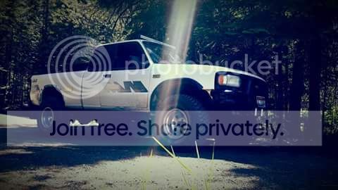

here is how the truck sits now.

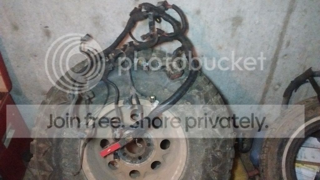

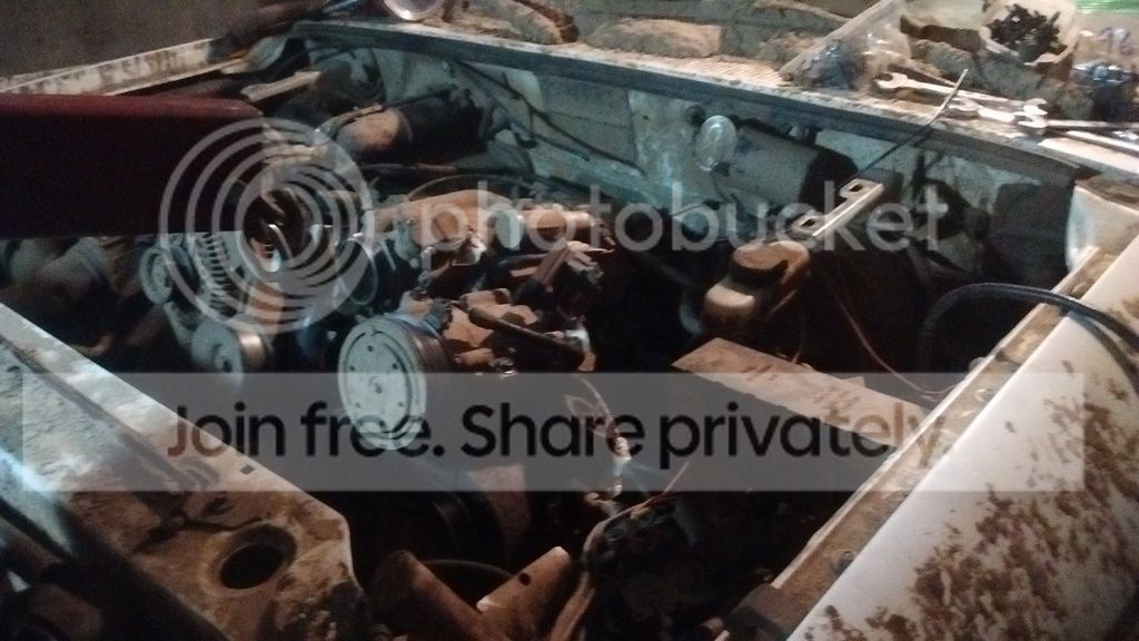

pulled the intake and obd2 wiring harness off.
my mazda
obd2 harness out
my mazda
1994 accessories, starting to be added, drivers side manifold installed, 1996 upper intake pulled off

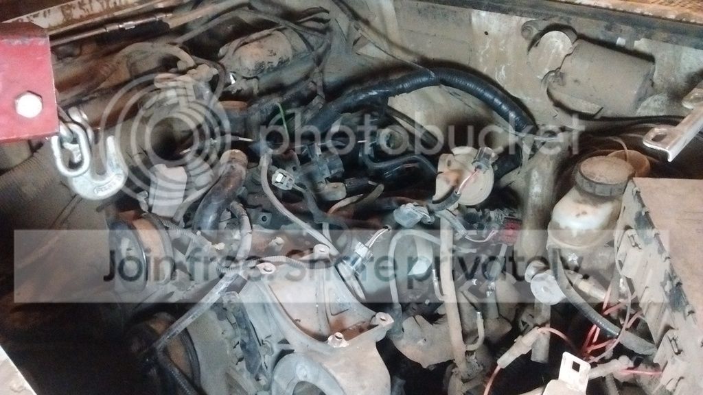

all of the 1994 stuff put onto the 1996 engine.
my mazda

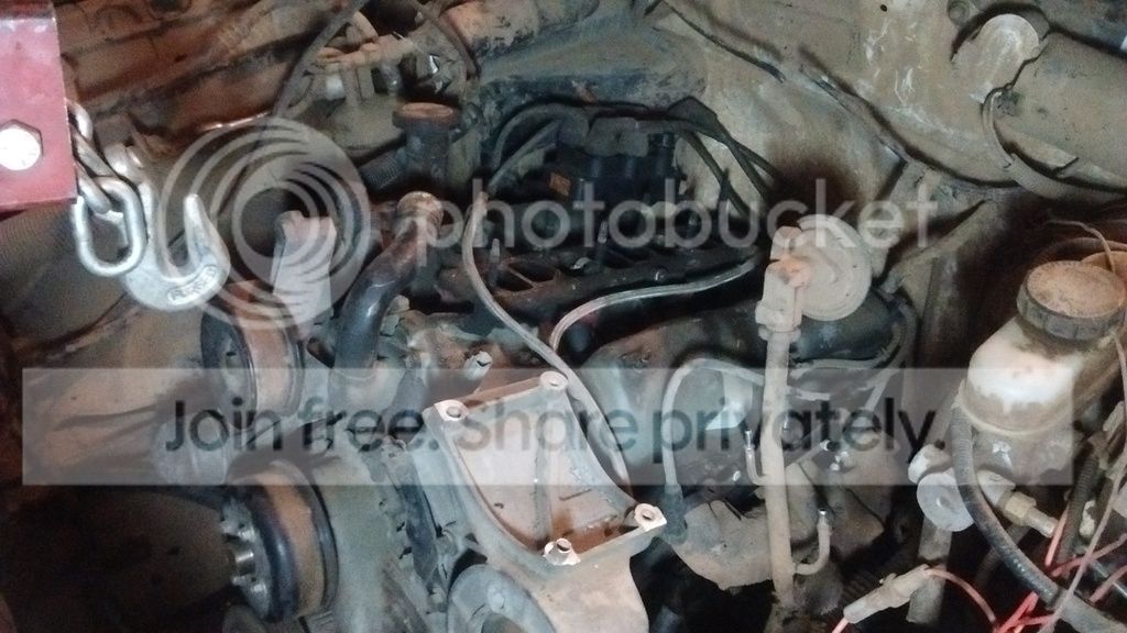

at this point i fired up the engine and STILL had a air leak some where... i knew the only part of the old engine was the intake, so i pulled it back off and coated the gasket with gasket maker, deleted all the egr stuff and all the extra vacuum lines that went all around the engine. fired it up and had an idle of about 600
unless im forgetting one then im only running the brake booster line, fuel pressure regulator line, and the heat/ac/fan blower line.
the only part of the egr that im running is the tube from the manifold to the intake, and only because it was easier to just install it, then bother trying to delete it.
as far as idle; fuel/air, type sensors go, i run the tps, iac, o2, crankshaft position sensor, but no camshaft position sensor.
ive read quite a few posts saying that there will be a loss of power or the engine wont run right without the camshaft position sensor, i honestly am not buying into this. this engine is definitely more powerful than the old engine, and runs fine all day, rev limiter or not.
one of the biggest issues i had was finding the upper radiator hose for this engine, it turns out that the 94 and 96 upper hose spigot have a different diameter, so a 94 hose wont fit on the 96 end. after swapping the 96 out for the 94, it finally worked.

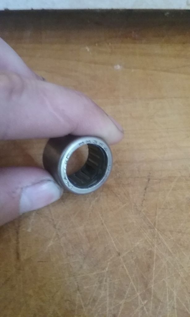

took a wheeling trip, i dropped into the hole that started my engine problems last time. it was way deeper this year so i backed out, and then i couldnt shift... turns out i neglected to change the pilot bearing. after i got it home i dropped the transmission...
as you can see there is a bearing missing

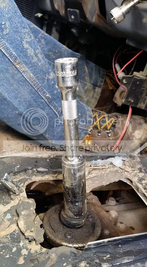

also on the same trip, this happened... the shifter came off... macgyvere'd it home, with out a clutch and a redneck short throw...

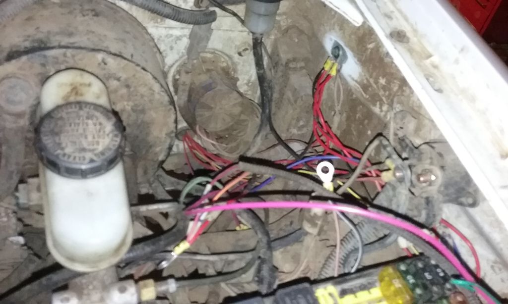

then after some time, the voltage guage started going haywire, when i used the left blinker, then it started popping fuses, i messed with it and only made it worse (grounded out a power on accident) so then i couldnt even probe it to see what was going on. i tore apart the wiring harness to look for a short, in the process i cleaned up the mess i had under the dash.
my mazda
my mazda
i put all of the relays and fuses in the under hood fuse box, so the majority of it would be hidden.
my mazda
as it turns out there was a big round thing in the in-cab fuse panel... it smelled like smoke. went to the auto parts store to get a replacement, it was a blinker module... and there are 2 types, 1 for incandescent bulbs and 1 for l.e.d/ incandescent bulbs. so if you plan on running l.e.d blinkers you have to buy the new module, or it will over time short out the original unit. my blinkers work fine now.

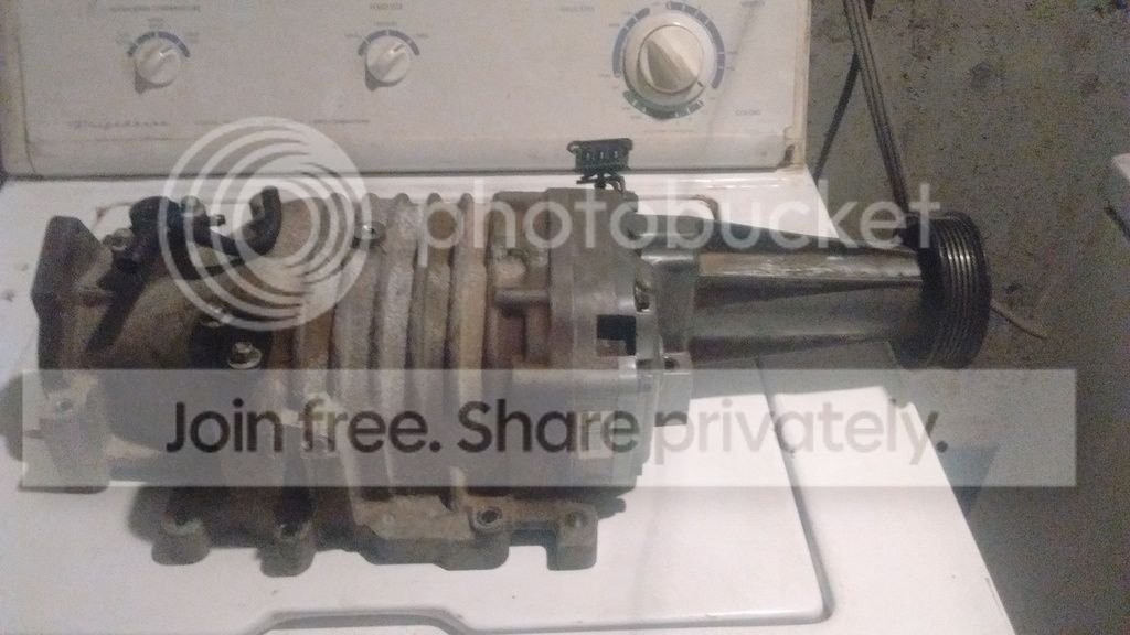

went to the pull and save, i always search every rig that i know might have a turbo/supercharger on it. i was going to leave and then we found this on a 1998 grand prix. 17$$$.
ive noticed lately that the 4.0 sohc super charger kit has dropped in price, as well has the timing chain kit. so hopefully that and the hybrid m50d will happen soon/at the same time.

What's the plan for mounting that?
the original plan was to mount it off to the side of the engine, like a turbo setup. but there is not enough room for that, unless i trim the heater core, but i still might look into this more.
ive talked to ron at rpcaster and got some info about making a mounting plate for it. seeing as its from a 1998 pontiac, it has the longer snout, and all ranger supercharger kits use a short snout; the snouts are interchangeable but its not cost effective.
more than likely ill just sell this one to a jeep guy, and buy the thunderbird model... if i dont go v8.
