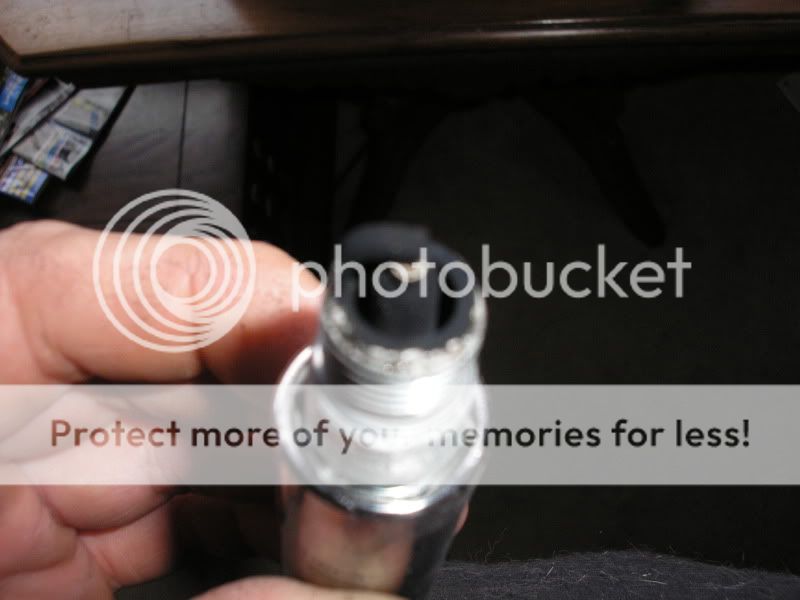

Now I just got to address the tranny leak and the waaaaaaaaay excessive black smoke that it pours out( The theory is that the factory MAF{19lb} isn't rated for the 24lb injectors, so lots of unburned fuel is the cause of the smoke.)
We'll find out after a look-see on the spark plugs.
If you've ever wondered what an extremely rich engine does to the spark plugs, here you go.
I think the culprit is the 24lb injectors that came from the "donor" vehicle.
The MAF and computer are calibrated for stock 19lb injectors, so the 24lb ones are letting extra fuel in that the computer isn't reading, thus a rich and very doggy launch.
