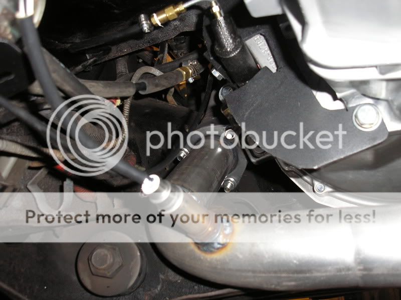

Got the true duals welded up to the muffler, O2's installed, electric fan installed, and the slave cylinder is FINALLY done(Broke 3 of them in the process:annoyed:) Pics will follow.

Here's my fruity charcoal canister:icon_twisted:. My brother laughed at me when he saw it, but when I installed it, he didn't think it looked too bad.

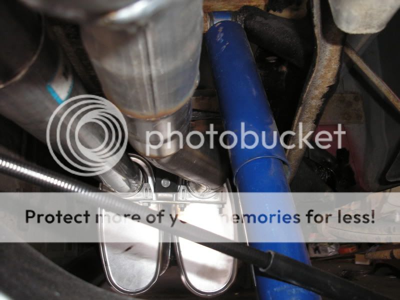

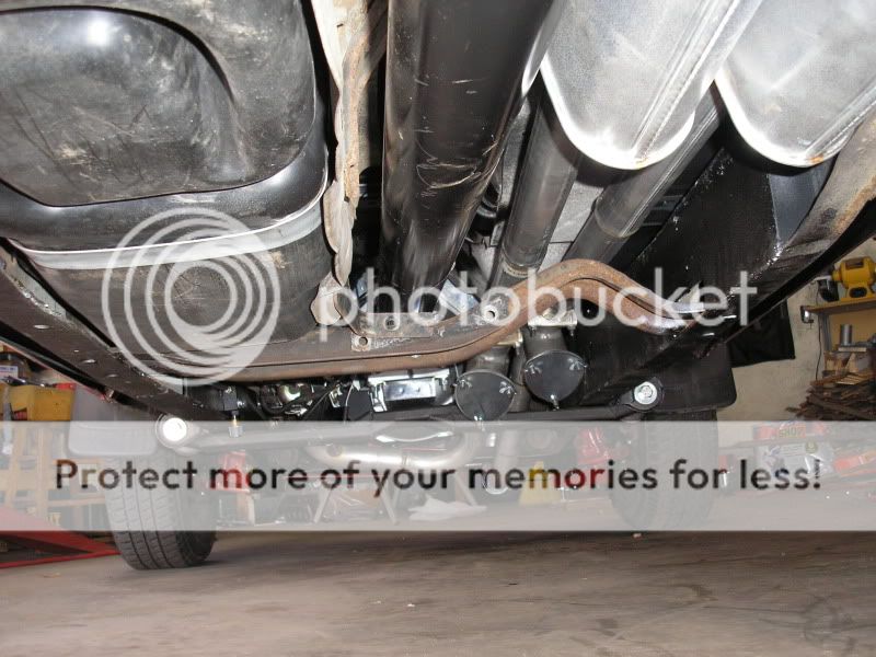

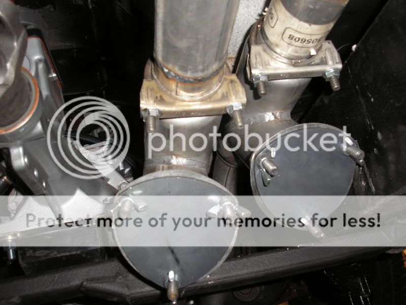

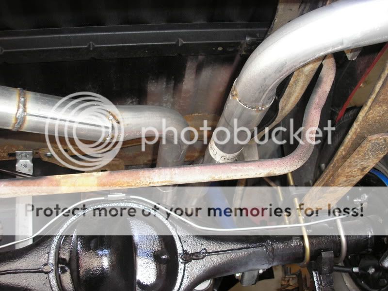

Various pics of the true dual exhaust.
SHHHHHHHHHHHHHHH........................... We'll keep this one from the fuzz. Notice how it's tucked behind the frame? :D:D:D:D:D:D

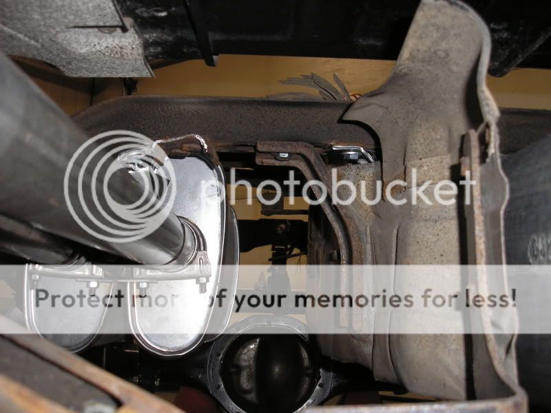

I think the drive shaft will juuuuuuuuuuuuuuuuuuuuust squeeze through.(I hope)

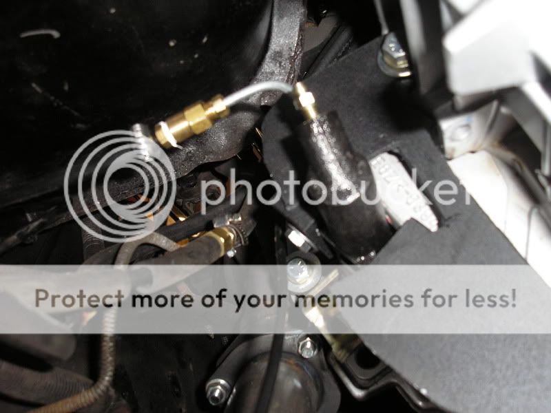

And, the slave cylinder with some various hydraulic and pipe fittings with some brake line in the mix.

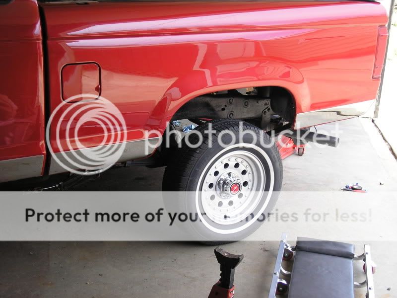

And, what happens when you weigh 275 and roll onto a rut in the cement.:icon_twisted: I squished it flat to the ground. First words out of my brother's mouth "Fat A$$":shok:
Noooooooooooooo...................I'm not fat, the engineers didn't design to take side weight. Jeeeeez.........................:dunno::dunno:
I tried to straighten it..............................didn't work too well.

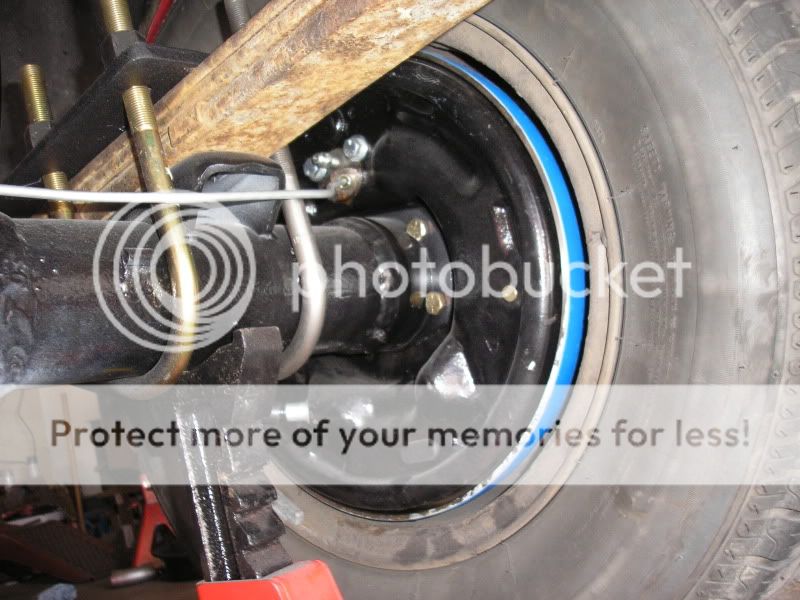

After lots of sweat, fear, and prayers, the third member is back from the tranny shop and we slipped it on. OK, that part accomplished, now to see if the axles are either right or wrong:sad:.
Slid both of them in, and.............................YES!!!!! , she fits and spins like I measured for.:yahoo: The axles fit, the drums fit, the rims fit, EVERYTHING FITS!!!!! Now I can measure for a driveshaft and have it road worthy in a few weeks :yahoo::yahoo::yahoo::yahoo::yahoo:
Also notice, the yolk is dead center between the gas tank and the mufflers. I was hoping for that one too!!

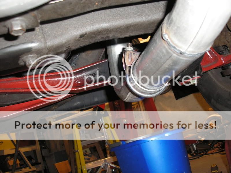

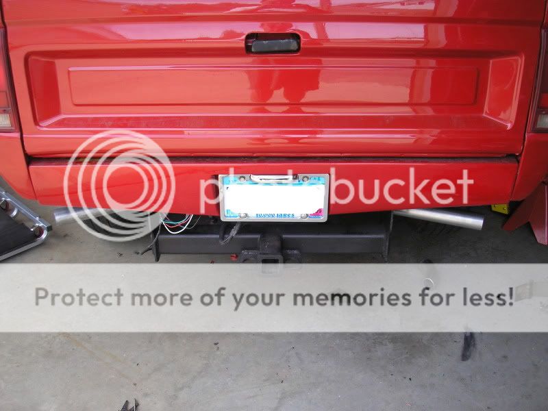

Well, got the box put back on with the 3" body lift (harder than it sounds), and got my true duals figured out. The exit points are exactly where I want them and they are at the same height also.
Since the front is an inch lower than the rear(motor weight), it looks like a drag truck ready to conquer the highway:D.
My hitch I built now looks very out of place because of the 3" body gap. I'm thinking of selling this one and using the $$$ to buy materials for another one, except it'll be more "sleek" looking.
Yes. True duals are possible(although space is tight)..................
Nice new driveshaft sits right smack dab in the middle of the mufflers and gas tank. That's a relief!!

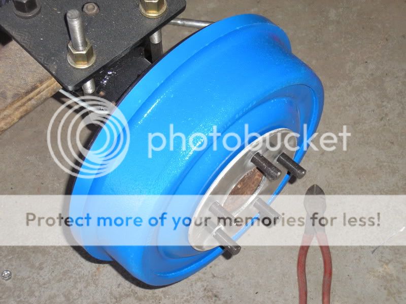

And proof that an 11" drum will fit behind a 14" rim (3/8" clearance all around).
