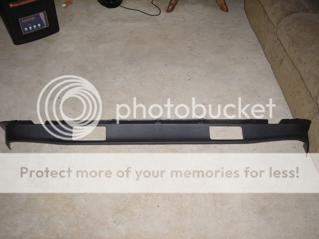

To start, I ordered a new valance from LMC Truck to replace the old, broken one. I got the one with the driving light holes cut out of it.
It's got that "GT" look to it that I've always liked. Some other ones on the list are new mirrors, driving lights, altezza tail lights, and a few odds and ends.

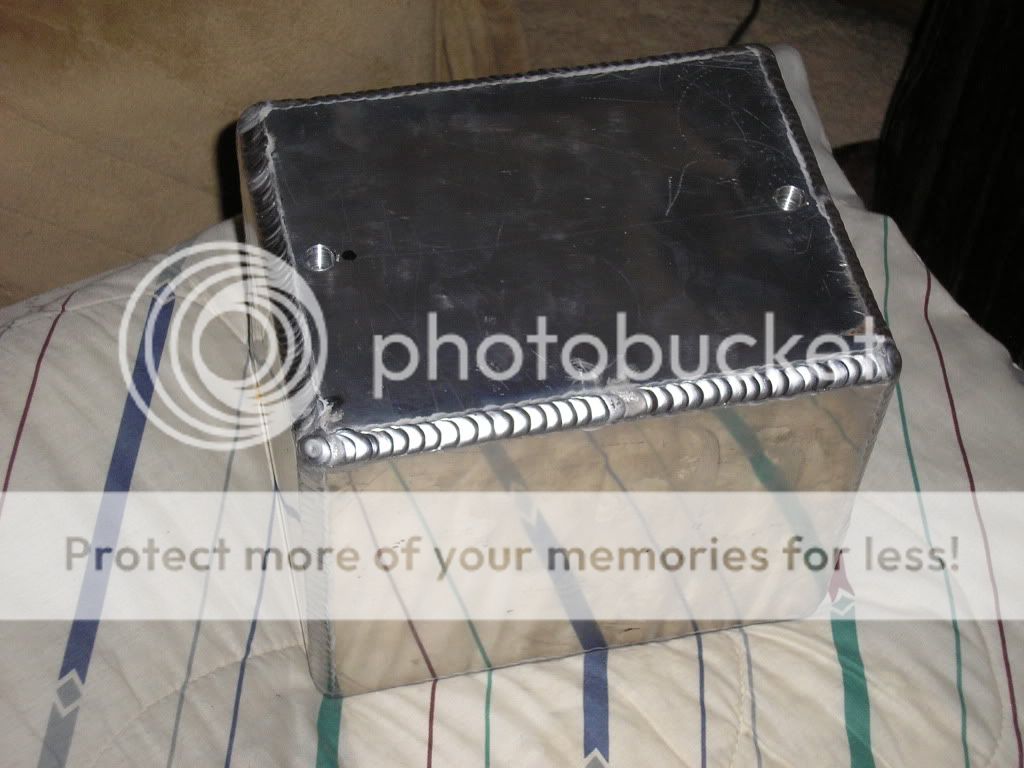

I'm starting off with the overflow coolant tank, don't care much for the factory plastic one, and I need to make room on that side for my ignition box & coil.

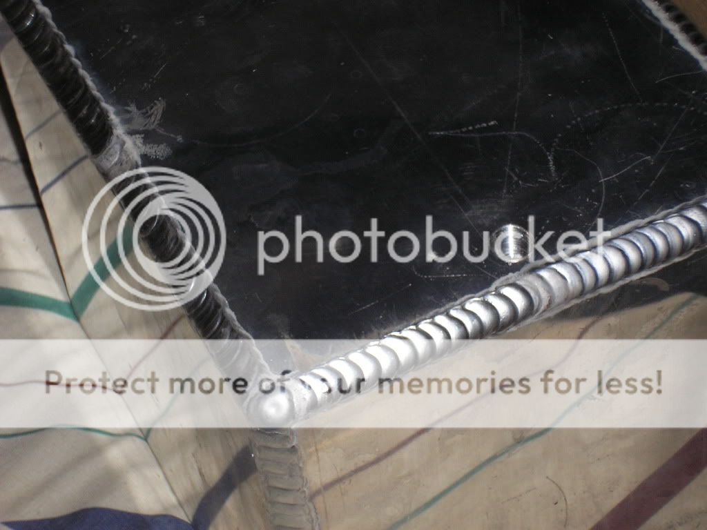

Got started with some 1/4" aluminum "I know, highly overkill, but it's the only thing at work I could find for free."
That is, after the old man told me he had lots of 1/8" aluminum at home:annoyed:, well, now you tell me!!
Here's what I got so far:
I knew God gave me this TIG welding ability for something!! :D

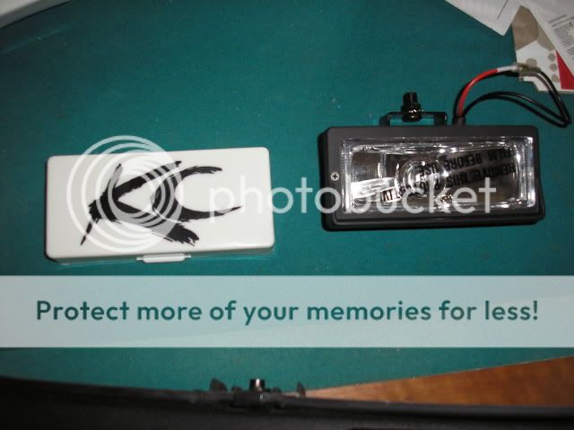

I decided to take matters into my own hands! My brother is taking his sweet time ordering the camshaft, so I decided to go to Summit Racing and order a set of KC allweather driving lights for the lower air dam. They came today!!! :yahoo::yahoo:
I think after a little trimming, it'll fit just like factory. :icon_thumby:

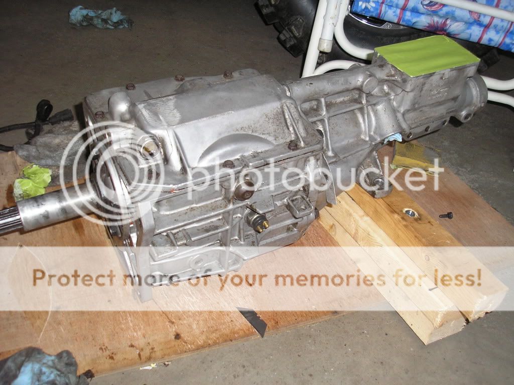

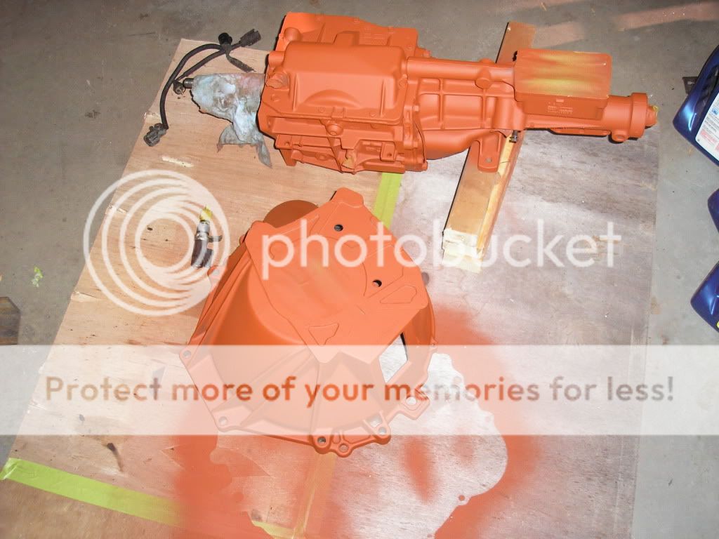

I've started cleaning it up with a product called Duplicolor Surface Prep, that I've never used before, and I got amazing results with it in very little time. This stuff works 100X better than brake parts cleaner! :icon_thumby:
Bellhousing and tranny before the prep:
Tranny after 45 mins of prep spray and wipes:

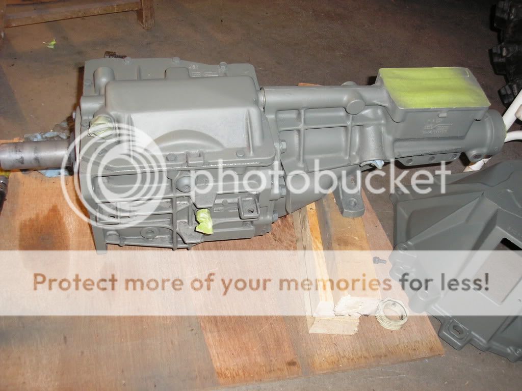

And the tranny/bellhousing after a couple thin coats of Duplicolor Self-etch primer:

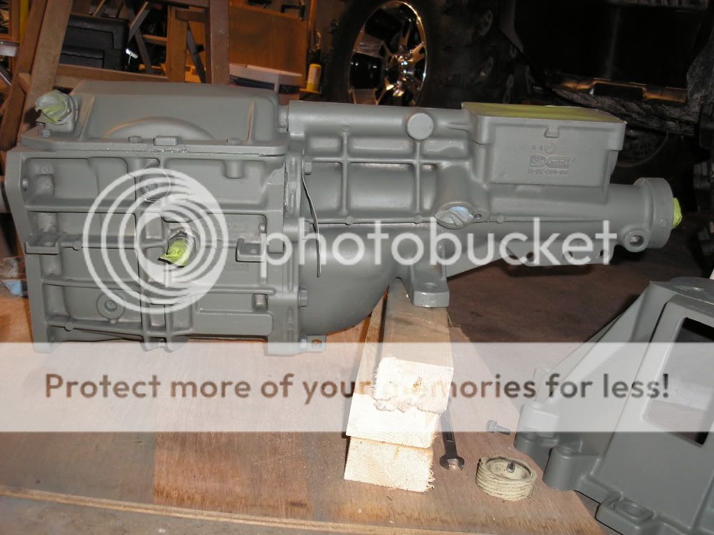

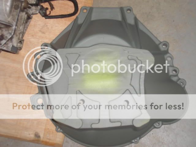

I just got done shooting it with some Duplicolor Filler primer. Gonna let it dry for a day before I lay down the Ford Blue!! :icon_thumby:

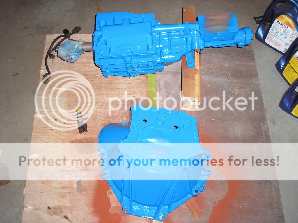

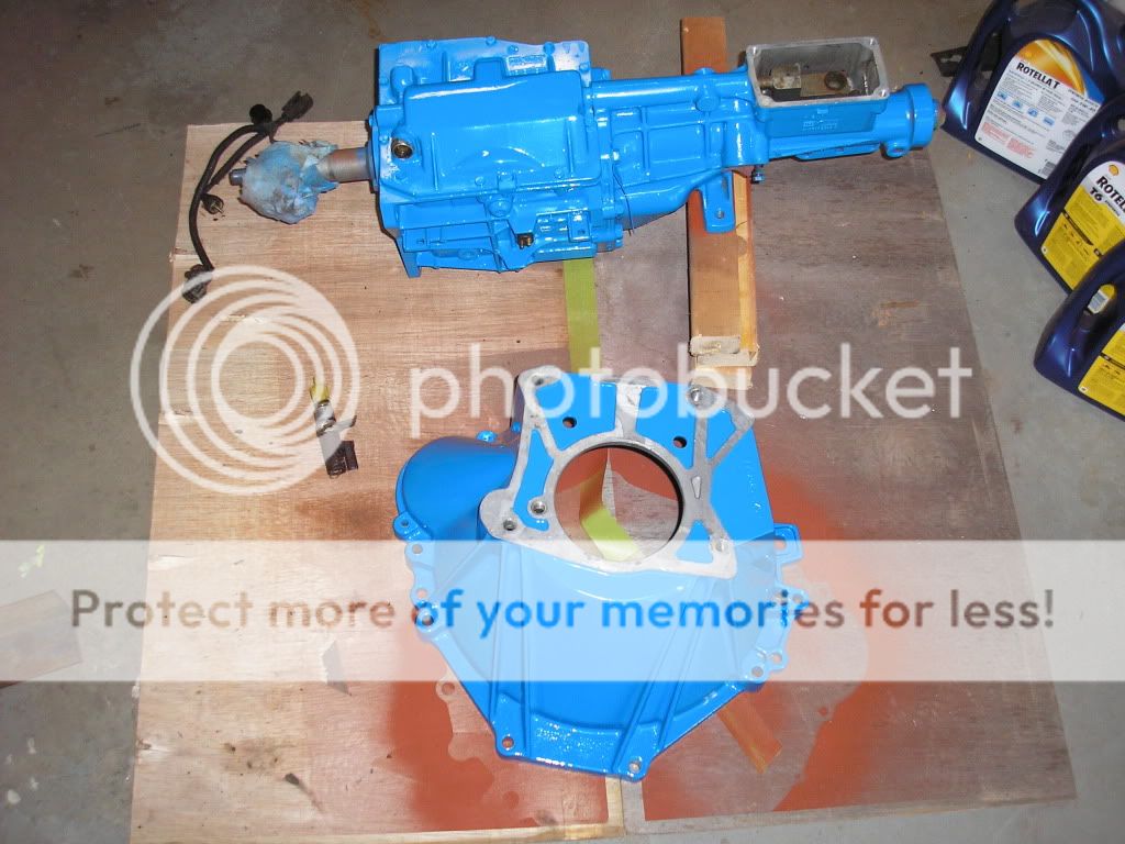

Well, just got done putting on the coats of Ford Blue!! :icon_thumby:
Some of you may think; why take the time and paint a transmission?
I say; why not? It's gotta look at least once, right? :D
After the Duplicolor filler primer:
And the Duplicolor Ford Blue:
Just gotta replace the output shaft seal, re-RTV the input retainer (just to make sure) and then she's ready to be installed!! :yahoo:
