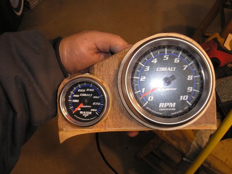

My brother had to make a new gauge pod because the fiberglass on the other one simply would not stick to the fleece. And he tried to cover it in one huge sheet of fiberglass so that didn't help either.

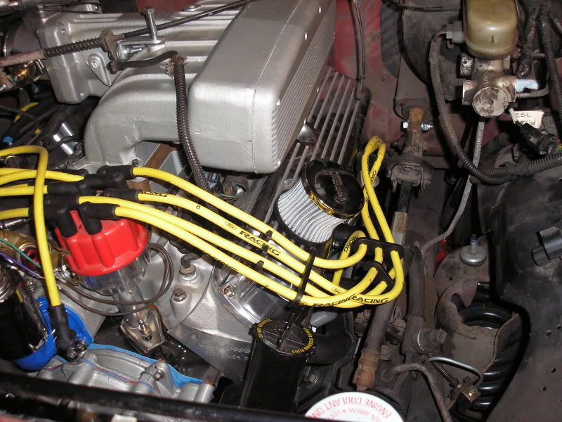

And, finally, I got the spark plug wire looms from Moroso and got'em separated. Looks alright, but I wish there wasn't so much slack in some of the wires.
As my dad would say "OWGH" (Oh Well, Good Enough):icon_thumby::icon_thumby:

As far as the plug wires go, mine are the same way, but I hear you can pull the boots off and trim the wires to length if you really want to. I thought about doing it, but it seemed like too much work.

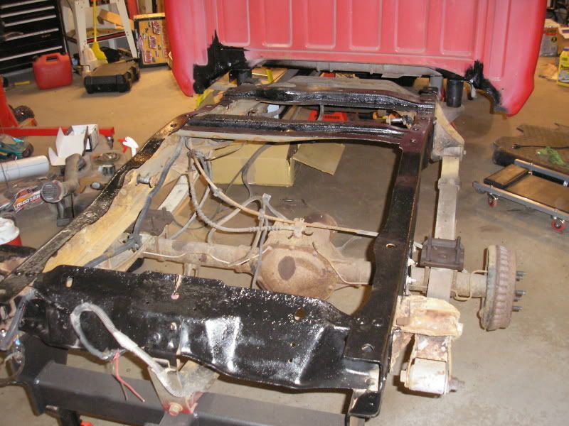

My brother and I just got the box lifted off to make sure that there wasn't any hang-ups with the wiring and such. After it was lifted off, there was 17 years of dirt just compacted into the various gas tank crossmembers:annoyed:
But at least I got the old box bolts cut off so that the box didn't have to be perfect when reinstalling it back on the truck(Temporarly until I get the rear end built and a coat of POR on the frame and the cab/box lips.)

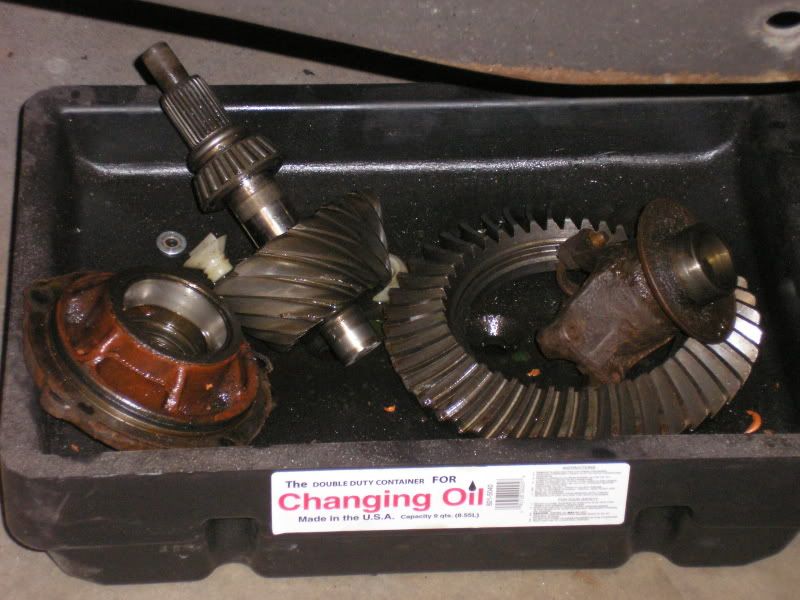

I bought a 3.89 ring and pinion set off ebay, still waiting for that to arrive. Here's the old 2.75 gears ready for whatever.
My little Iron Ranger {Part 2}
I'm still looking for a posi-lock setup vs the one-wheel-wonder open diff. I got now. But if I can't find one, oh well. At least the rebuild kit came. Now when the gears arrive, I can send this to the tranny shop to get the gears set and the new bearings installed

I also started on the time consuming task of POR ing the rear section of the frame and the backside of the cab on the trouble spots. If Ford went with a 3 stage paint scheme instead of the one stage(no clearcoat), the rust wouldn't be as bad and the unpainted parts wouldn't be pink.

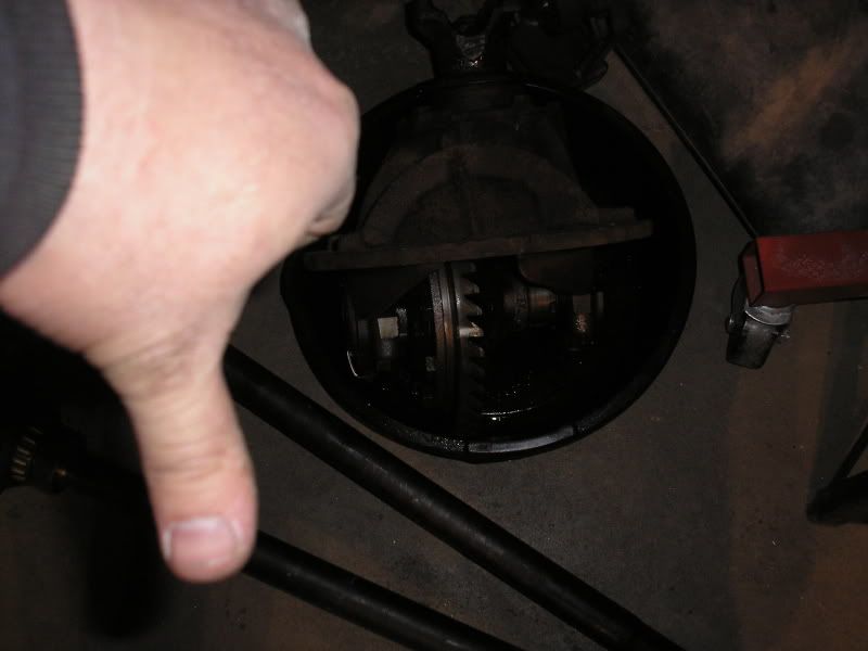

And a shot of the 7.5, 3.73 rear end before the removal, she served me well but the new power on a 5 speed would've ripped it apart.
So long, old friend.........................:bawling::bawling:

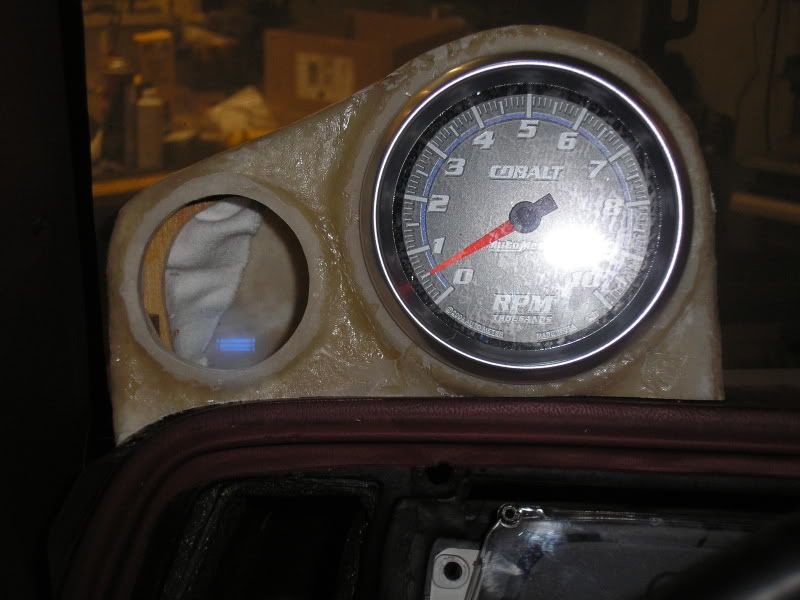

My brother got a lot of work done on the gauge pod. The secret to the fiberglass process is to use the hobby fiberglass. It's very thin and feels like silk. It works alot better than the heavy duty stuff, especially in the grooves.
I think it'll turn out slick:D
The empty hole is for the water temp gauge. It's mechanical so I couldn't put that in there yet, the line gets in the way.
Arent you gonna have to "look" through that massive space the Gauge Pod takes up?:icon_confused:
Imo looks badass though!:headbang:
From where I sit, there is a little bit of obstruction, but since it gets smaller for the water temp, I should be able to see well enough.
I hope.:dunno::icon_twisted:

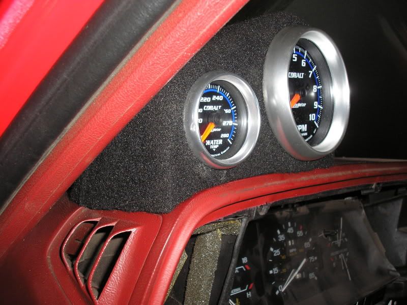

Also got the rest of the coolant lines hooked up, including the mechanical water temp from Autometer. It has slack now that the new gauge pod is done and mounted closer to the pre-existing grommet hole in the firewall.
I gotta say, this is one awesome, sharp looking gauge pod my brother made for me. It turned out just perfect!!!
