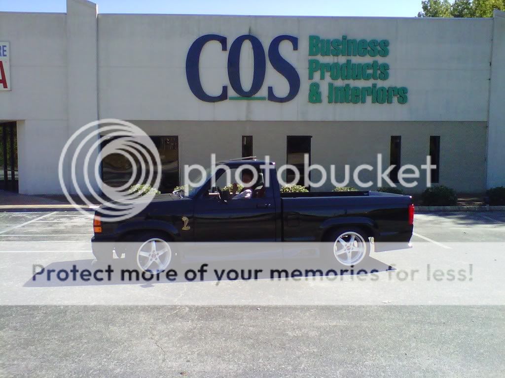

My idea of a Shelby Ranger if there would have been one.

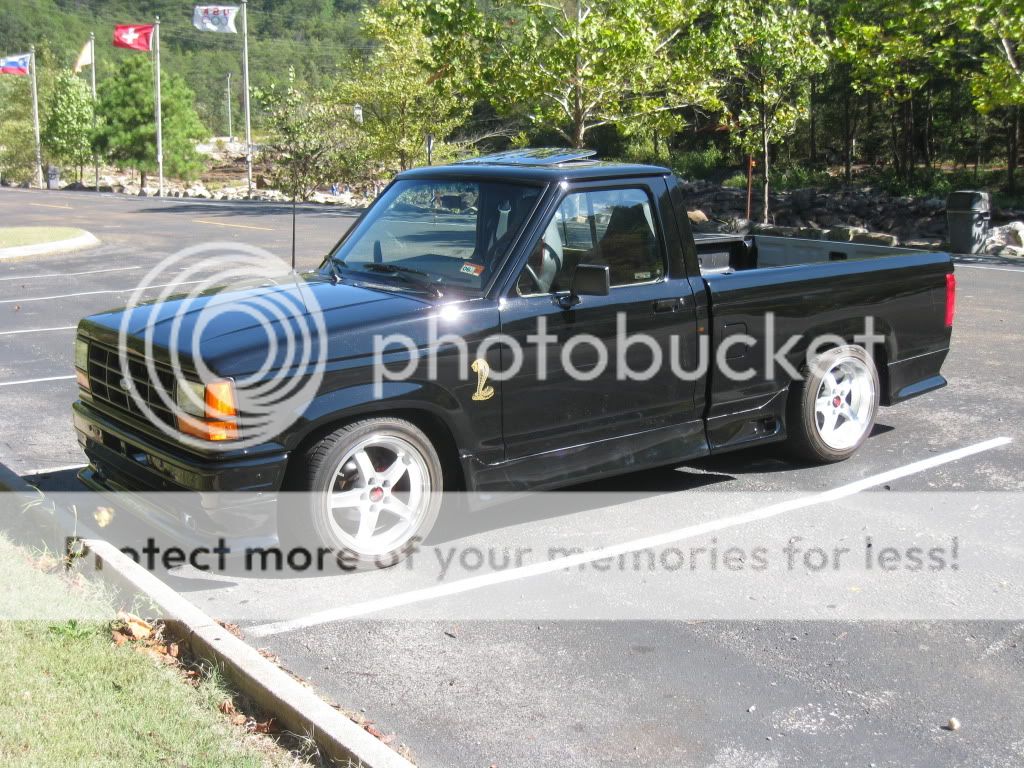

Pics of the truck from over the weekend..

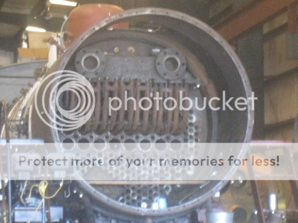

What a steam engine looks like on the inside

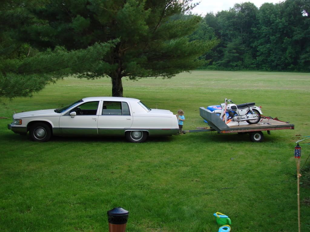

Here is my ole girl towing my new bike home on fathers day!
And once I got her home.

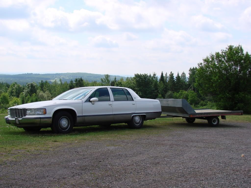

On my grandparents hill up in norther maine.
