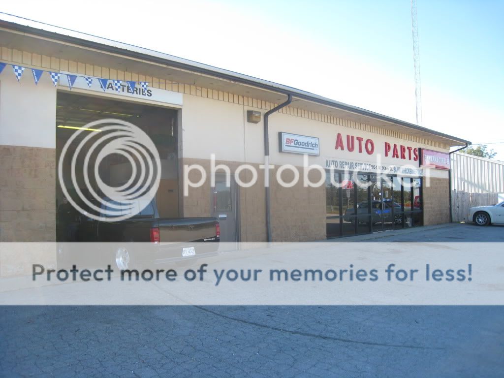

First I'd like to give a small shout out to Denton Wrecker Service MontEagle Firestone. The guy there helped with getting the nut off the Alt! If anyone is ever in MontEagle TN and need service go check them out. They have a parts store there too!! The Tech and the lady I had the pleasure to talk to were really nice folks!
