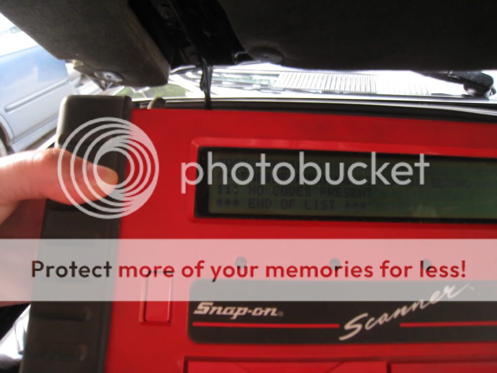

Last night after getting the ole code 111 Took her for a spin filled up with gas went out to eat!! Good times was had by all... Then the effin CEL flashed on... Code 173 again..
Needless to say spent all day pulling the intake and injectors out... I soaked the injectors in Sea Foam for an hour or more.. Filled the intake with TB cleaner. Got a new gasket set for the fuel rail... Cleaned the holes where the injectors go.Sprayed the hell out of the lower intake holes. Put it all back together Torqued the lower intake ect...and wait for it... Wait for it... Code 173... again..
So frustrated and cussing like a sailor I switched the Snapon scanner to Data and watched the values... O2 was pretty high in Millivolts... Then after running a little longer the MVs dropped to very low.. Didn't recheck to see if the code was there but I shut her down cleared the codes drove her over 60 miles and no CEL and she ran really good!!
Oh yeah I checked all the Ohms on the Injectors... All were the same and all had a ticking sound through the stethoscope... If the code is there tomorrow I wonder if the freakin new FPR went south for the winter....
