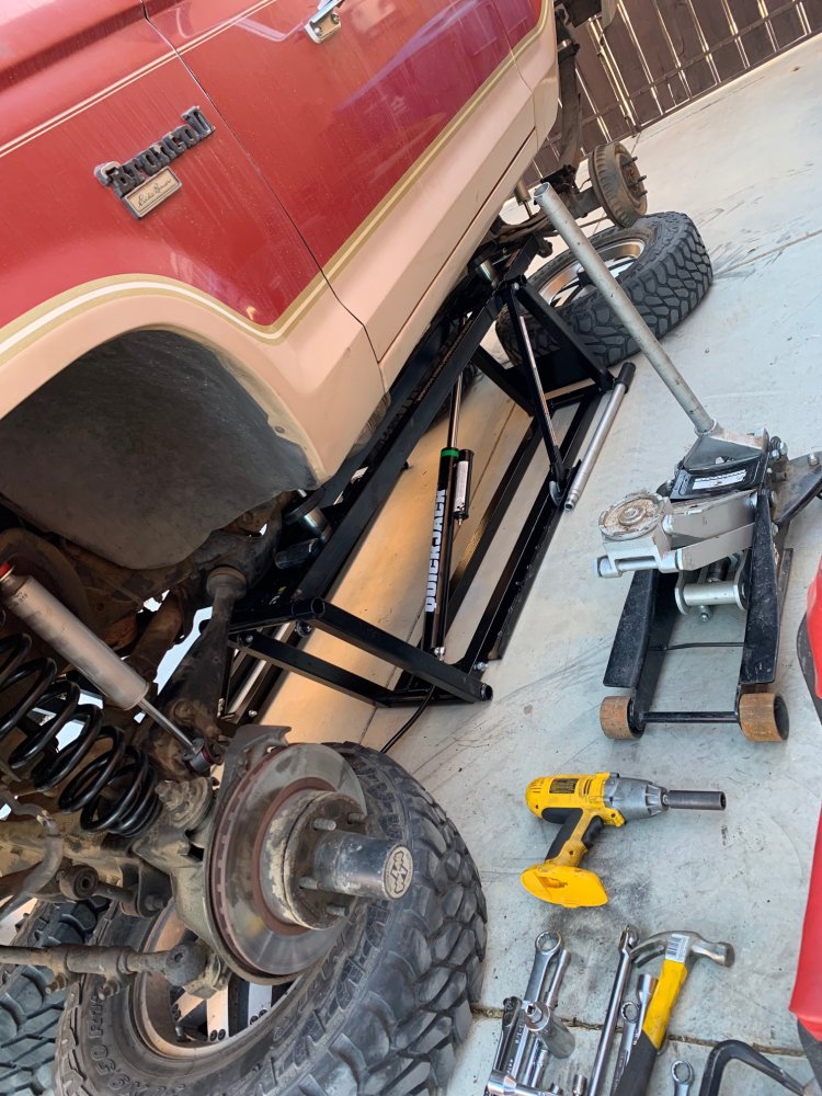

I decided to halt working on the suspension until I could get it safely lifted. I ordered a set of Quick Jacks from Home Depot with their truck/SUV adapter and it's good for 27+ inches. They fold super flat too so storage is easy and I can likewise get them under my Hellcat, which is slammed relatively speaking!

It took me a bit to get the Quick Jacks put together and find suitable lift points on the frame...LOT of up and down, shifting back and forth, etc. It's set up on a dead level concrete slab and I was happy finally getting it where I thought it was in the safest possible position. I gave it a fairly violent shake test at both lift settings before I lowered and re-lifted it and set the locking mechanism...

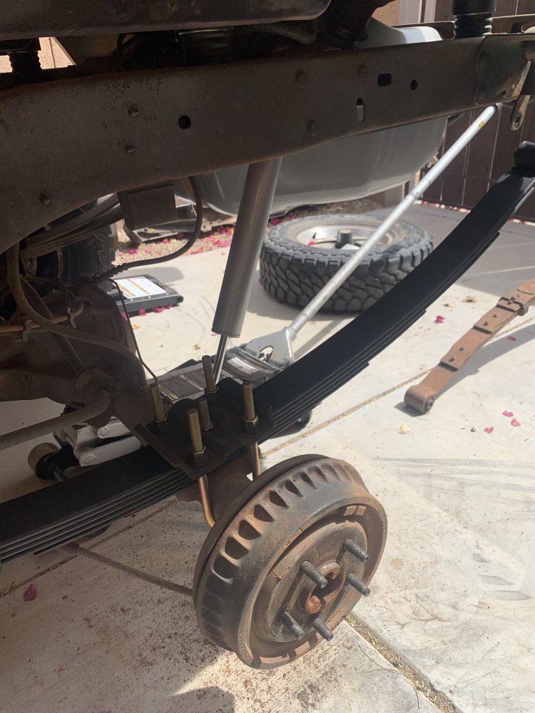

I then moved on to getting the leaf springs installed, having installed the Skyjacker helper spring into them the other day. The front and rear shackle/mounting bolts were easily removed, and U-bolts on the other hand were a show. They're likely galvanized and original equipment so at 35 years old they were not in any hurry to come out so it was a combination of my cordless impact, air impact, ratchet and breaker bar and plenty of PB Blaster to get them off.
I did NOT order new U-bolts when I ordered the leaf springs for a couple of reasons; the first being I wasn't sure what size they were and it looked like there were several different possibilities and secondly I thought I be able to readily grab them locally once I did determine what size they were...WRONG!
My U-bolts were 1/2-inch, 2 7/8ths wide...not 3 inches, not 2 3/4, 2 7/8ths, and while the stock ones were 6 1/2 inches long, I wanted to go with at least 8-inch ones to account for the extra width of the additional leaf so after looking around it looked like Dorman had exactly what I was looking for on Amazon so they'll be here in a few days. In the interim this is about as sexy as they're gonna get:

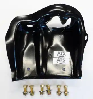

Soo… the ATS coil buckets that are listed for a Ranger work fine on a B2. Or rather fine enough. I have a set on my 88. A couple of the holes were off, but it wasn’t a world ending problem, I got it to work easy enough.

Answered my own question...well at least ATS did! The helpful gentleman I spoke to confirmed that it's more likely than not that the spring/shock tower-upper mount that fits the Ranger will likewise fit my BII. The only thing I'm gonna need to do is get the angle grinder out and take care of the rivets!
I also spoke to Skyjacker today and they were likewise helpful. We collectively came to the conclusion that the best way to figure out what's going on is to switch the springs; otherwise I'll end up with a spring/shock mount I have to return or a coil spring I'll have to return...kind of aggravating but it'll save me some money with shipping so that's on the list of things to do now...!

Got the leaf springs in the other day. For some unknown reason I did NOT order new U-bolts when I ordered the leaf springs so I had to wait on those. Took the spring packs apart to insert the Skyjacker helper spring in them was relatively easy with 2 good size C-clamps to keep them together.
I started with the driver's side and it took me entirely way too long to get the old U-bolts unbolted. Surprisingly the other mounting bolts came out rather easily however. I've been in the habit of pre-spraying hardware with PB Blaster a day or two before starting to work on something and that's served me fairly well.

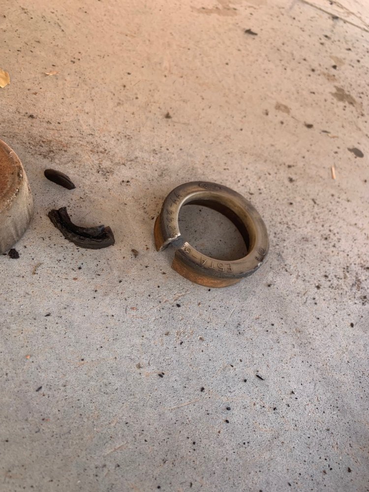

I can't tell how many articles I've read about the radius arm bushings and YouTube videos I've watch, but if your BII/Ranger is 4-wheel drive and completely rivited and NOT bolted, it's not a 10-minute YouTube one and done deal!
Started off with the passenger's side because I was concerned with the close proximity of the catalytic converter being an issue as I could barely get the 1 1/8th open end wrench over the nut. That was a mistake for reasons I'll explain in a minute...which I'm sure some of you already know!
The bushing was TRASHED and I'm almost certain this was the OE one. It disintegrated as I took it apart. I definitely was wrasslin' with it and need some ratchet straps to get the threaded end of the radius arm clear of the mount, but it came out. I did have the wheel off (DUH?!), brake caliper disconnected and supported with a bungee cord and the shock and coil spring likewise out of the way. I also ended up unbolting the axle pivot arms to (1) give me more wiggle room and (2) UGH...I gotta replace those two. So without too much struggle I managed to get the passenger side done and bolted up. Big mistake!
