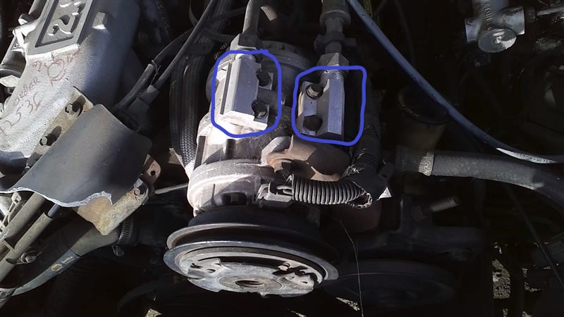

I have NO idea why I threw out the old A/C compressor before I got a chance to install the new one, but as soon as I took the new one out if the box today I discovered it was missing the compressor line fittings inlets (for lack of a better term) shown in the picture circled in blue.
Total rookie mistake and I'm furious at myself for making it, there was no reason why I couldn't have held onto the old one until I got the new one in, now I got to try to track down where I can buy these or a junk compressor to cannibalize...ARGH!

Try "compressor manifolds" when searching. Where did you source the compressor? They may have the manifolds for it.
Besides a junkyard, try 4Seasons or Vintage Air. I'm sure there's probably other sources for the small "pain in the ass" parts, but those two come to mind.
Maybe a forum member???
Good luck!
Good luck!
Thanks AGAIN @RobbieD! I had no idea what they were called (obviously!) but I found a used compressor on a junked car on eBay that might work (not sure if the manifolds are included and I'm waiting to hear back) and using a reverse search of the Ford FS6 compressor part number that I verified fit my BII through an AutoZone parts search, I found THIS kit.
While it doesn't need the high pressure relief valve and suction/discharge compressor fittings since they're elsewhere on the system, it should still work.
Looks like this completely preventable mistake is gonna cost me time, which I have plenty of, and between $75-100 depending on taxes, shipping, etc. Oh well, not the first mistake and not gonna be the last, as long as I can fix it and learn in the process it's a win!
I did a quick search too, and found the same kit, NP1614, at nostalgic ac for cheaper ($66), but it was out of stock.
Hopefully the eBay seller will pan out, or your "in search of" ad here will produce. A junkyard would be the ideal, but good yards are few and far between these days.
Don't beat yourself up over it. I'm definitely my own worst enemy at times. I've kept the most worthless shit for 50 years, yet a week after I throw something out, all of sudden I need it.
Murphy’s law, as soon as you throw it out, no matter how long you’ve kept it, you’ll need that exact thing. I tend to be particular with what I get rid of because it’s usually just waiting to bite me in the arse

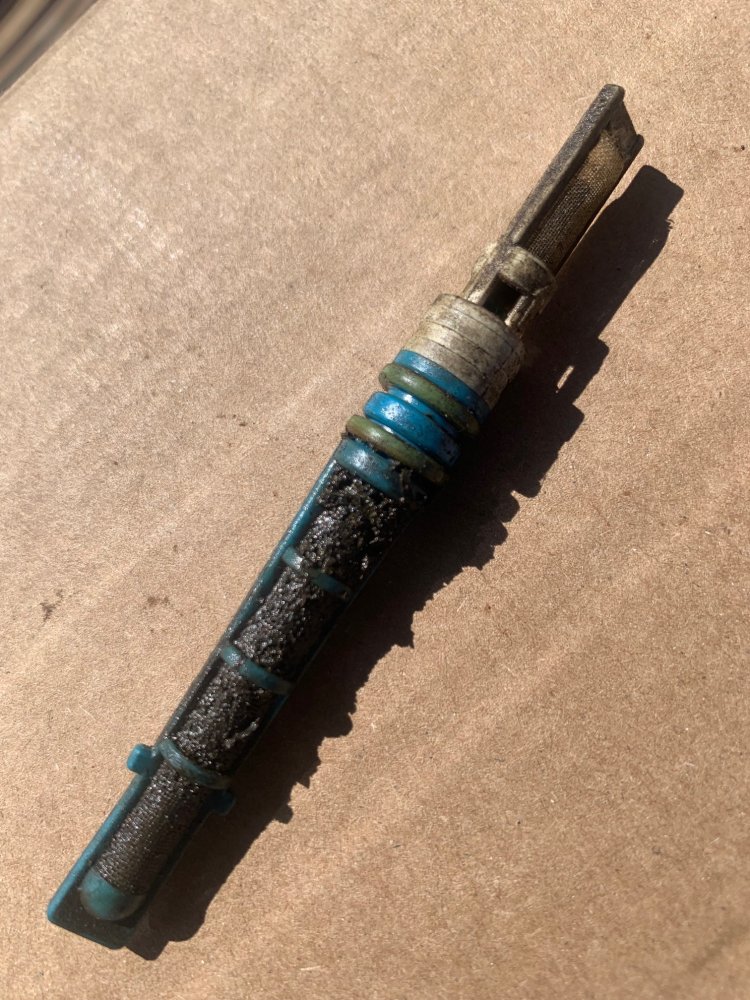

Although I never knew what an A/C orifice tube was prior to completely redoing my system, I do now and MAN am I glad I changed it out. From the looks of it it was likely the original and while you can make out the metal shavings still on it a whole bunch more slid out of the tube along with it and fell off the tube while I was handling it. With a new accumulator, compressor, condenser and lines it's cheap insurance while you're at it to change it out. The only thing that bummed me out was the "high ambient temp" rated orifice tube would NOT fit, even after trimming off the installation tabs as directed. What chapped my arse about that was it was both a 4Seasons line and orifice tube so using different manufacturers wasn't the issue. Fortunately the rebuild kit I ordered had a new one so I used that...

Keep the shipping caps on any new AC components that you install, especially the accumulator/drier. You want limit as much as possible any exposure to the atmosphere, of the insides of the new components.

Actually I'm doing EXACTLY that, even though I live in the desert and it's extremely arid I recall reading/hearing that doing that is important during installation, especially in a case like mine which is...AHEM...an "extended" process...!
I just bought the eBay junkyard compressor so hopefully that'll work. I have an O-ring rebuild kit for the manifolds which came with the compressor (THAT should have been a clue) so I'll have an extra A/C compressor when all is said and done. The one I took off was almost certainly the original, I'll see what kind of shape this one is in and might add it to my ever growing pile of usable parts that I'm going to end up selling when I'm done...

So a little about the orifice tubes…
My 92 Ranger someone had hacked part of the A/C out before I got it. When I ended up replacing the 4.0, I wanted to fix the A/C, so I got a variable orifice tube for it. I tried to make it fit, I really did, but it would not fit at all. Ended up going with the stock replacement (wish I would have gone to the next step up for cooling, the stock type are color coded for hotter or colder climates). I still don’t understand what was preventing me from using the variable one. The tube that came out of mine looked pretty nasty like that.
My 00 when I pulled it out was about as bad as yours and had some big metal chunks. I’m really surprised it put out cold air at all. The variable orifice tube fit in that truck perfectly. I don’t know how well it will perform yet.
