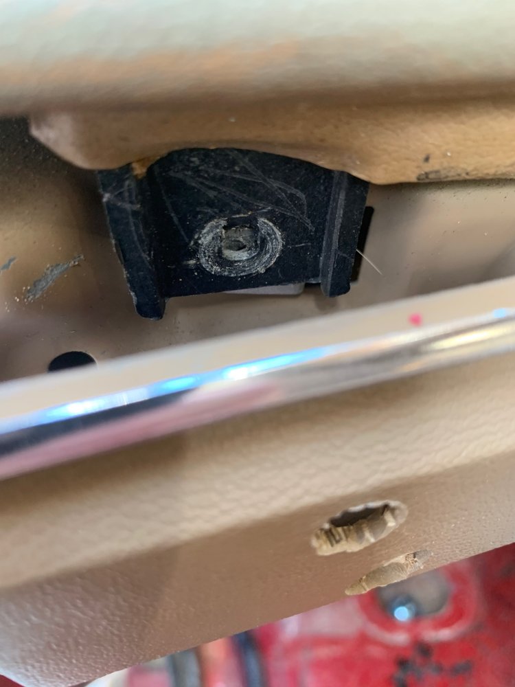

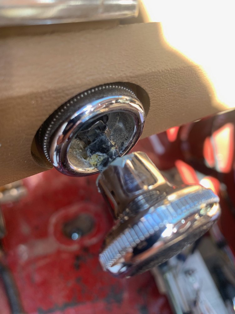

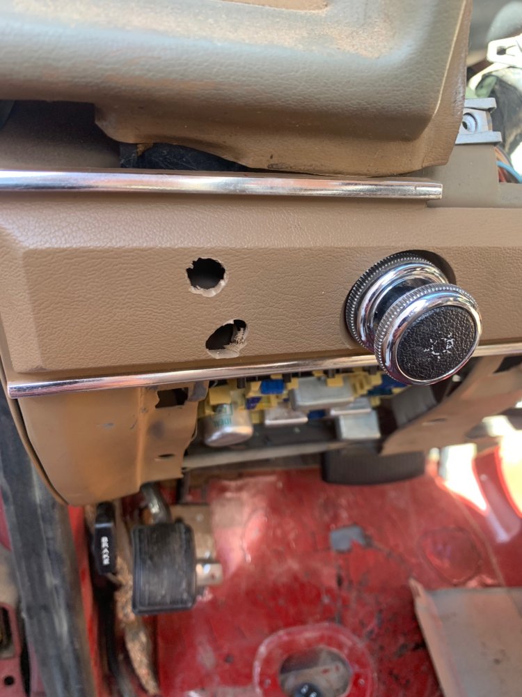

Speaking of "fun" anyone whose dug into the dash of one of these or a similar Ranger knows that the headlight knob needs to be removed from the stem to pull the dash piece off that section. Once I started to work on mine, the 2 "mystery holes" that were on that piece all started to make sense. I was able to get the internal locking device that couples the knob to the stem pushed in since apparently pushing back on it, as you're supposed to remove it, was getting nowhere. That's when I noticed what looked like dried epoxy on it, which, not coincidentally, is not the only place there's epoxy where it shouldn't be. I quickly determined that the knob was epoxied on the stem and wasn't coming off...

So as you can see "chucklehead" (which is what we'll call the PO that did this) apparently discovered AFTER epoxying the knob to the stem that the knob has to be removed to remove the trim piece and access the leftmost lower dash screw...OR you can drill a hole...or two if the first time doesn't do the trick, so you can fit your screwdriver through the trim piece to access the screw...
UNREAL.
Looking at a parts diagram on LMT is was apparent that the headlight switch/stem/knob were separate pieces so there had to be a way to remove the stem and thank the good Lord that a gentleman posted a quick video on YouTube that there's a spring loaded release/button on the switch housing that does EXACTLY that...so that's what I needed to do to start getting the dash taken apart for the instrument panel overlay/LED and stereo head unit and dash speaker upgrade.

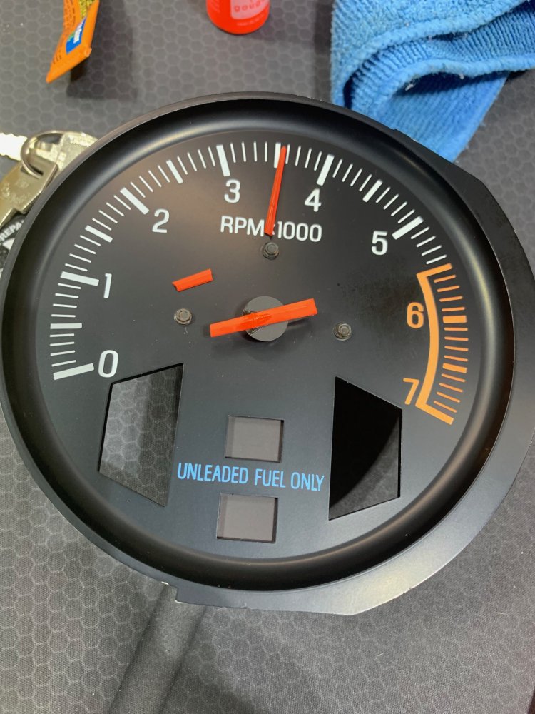

So I then set out to start working on the gauge cluster, intending to upgrade any bulb I could to a LED of the proper color, update the look of the gauge cluster with a white overlay (with blue LED lighting) and paint the needles bright orange as the tach in particular was completely sun faded. That's when this happened...
Initially there was a small hairline crack closest to the center of the needle where I attempted to repair it with superglue...which failed FANTASTICALLY as it literally started to crack into a series of smaller pieces, mind you I was doing this work on my bench and approached it as I would open heart surgery, knowing that at 35 years old that something like exactly this could happen...and did of course. Off to eBay and as of now the most cost effective option was to replace it with the 4-gauge cluster of fuel/coolant temp/oil pressure/DC-volts; replacement gauge clusters with tachometers were cost prohibitive.

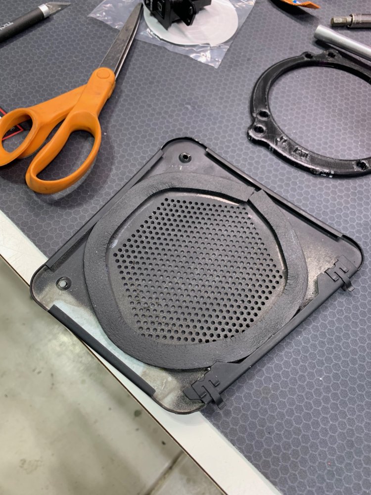

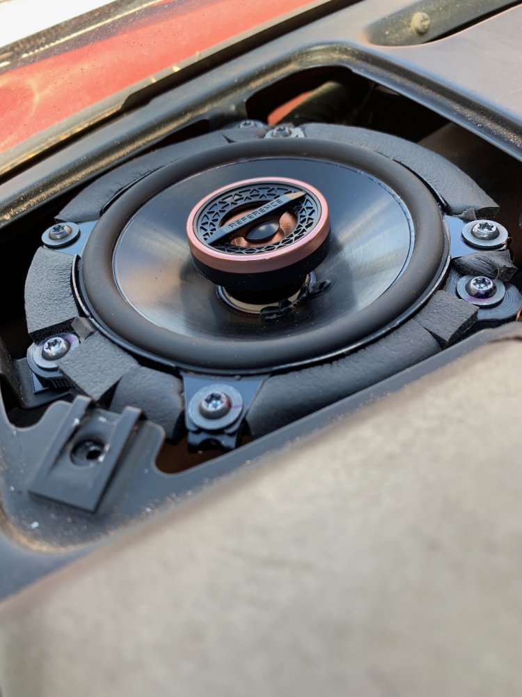

At this point I gotta get a win so I decided to start working on the stereo, the dash speakers specifically. My neighbor that I bought it from had replaced them with hot garbage Chinesium junk and bolted it down in exactly ONE spot. Obviously unacceptable...
So using the adapters I read about here and bought off of Etsy, I mounted my Infinity Reference speakers in the adapter, using foam insulation tape on both sides of the speaker. The screw closest to the windshield required a field improvised T-15 driver made out of a bit, micro wrench and hockey tape to keep the bit from slipping (I kept my finger on top of it to keep it place.).
Start to finish for one speaker was nearly 2 hours all said and done; the mounting clips kept getting stuck to the massive magnet and other assorted comedies of error but it's in there securely fastened by all three mounting points in the dash (4 from the speaker to the adapter bracket itself).
I noticed the factory grill had some dry rotted foam insulation, so I cleaned it off and added new stuff. As I screwed the speaker grill down into the dash I felt it snug up against the top of the speaker, so my overkill with the foam tape SHOULD pay off with no rattling!

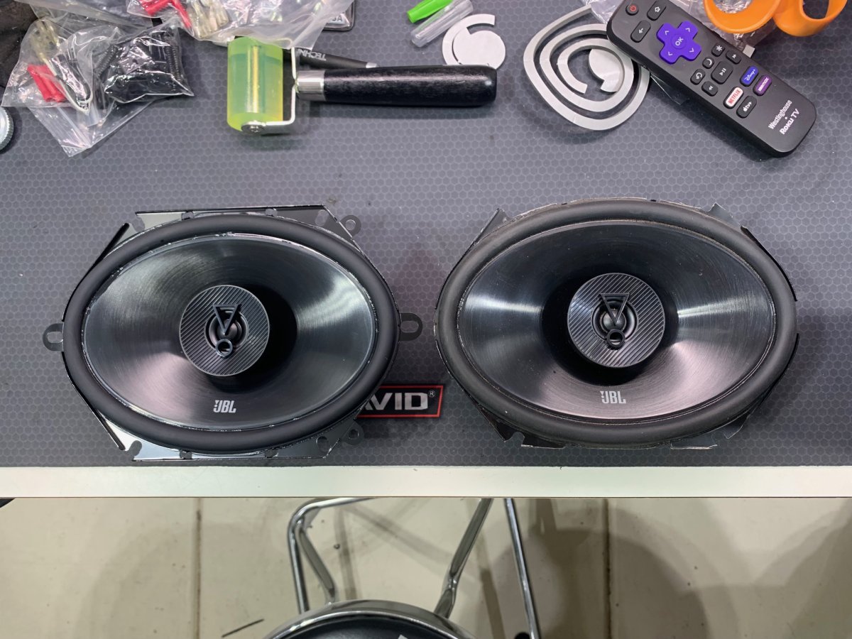

In a separate thread I mentioned that I ordered some JBL 6x8s for what Crutchfield calls the "mid panel", specifically the JBL 8621F. I just double checked for argument's sake, and Crutchfield says these speakers fit as long as there's already speakers in there. To me, and having been a customer of Crutchfield for 35+ years, that sounds like plug and play to me...WRONG!
On the left is the speaker out of the box, on the right is what it needs to look like to SMASH it into mid panel where it doesn't really line up with any of the stock speaker mounting hardware:
I immediately knew they didn't fit and weren't going to once I mocked them up. I had to make a decision to modify or send them back, and had a pretty good idea that they were gonna fit one modified, but it'd likely look like homemade soap afterwards; sure it works, it just ain't pretty...
Having said that I would NOT do it again. When cutting/modifying the speaker there's infinite opportunities for the Dremel or cutting/etc. tool of choice to slip and go right into the speaker surround and destroy the speaker. Not only that but you're obviously generating some heat when cutting through the metal which can likewise damage the speakers. I consider myself lucky that didn't happen, but that doesn't mean I'd do it again!
