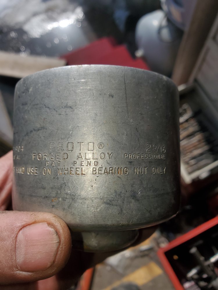

Got my MONSTER axle nut socket, 2 5/16ths and 1/2 to 3/4 drive connector so I could get the driver's side off, and the weight/heft of the socket and breaker bar were enough to get it started without putting practically any weight on it, whatsoever...

I bought this socket many decades ago... just cause the price was right. Still haven't used it...but it only cost $5.00 (~1990).
