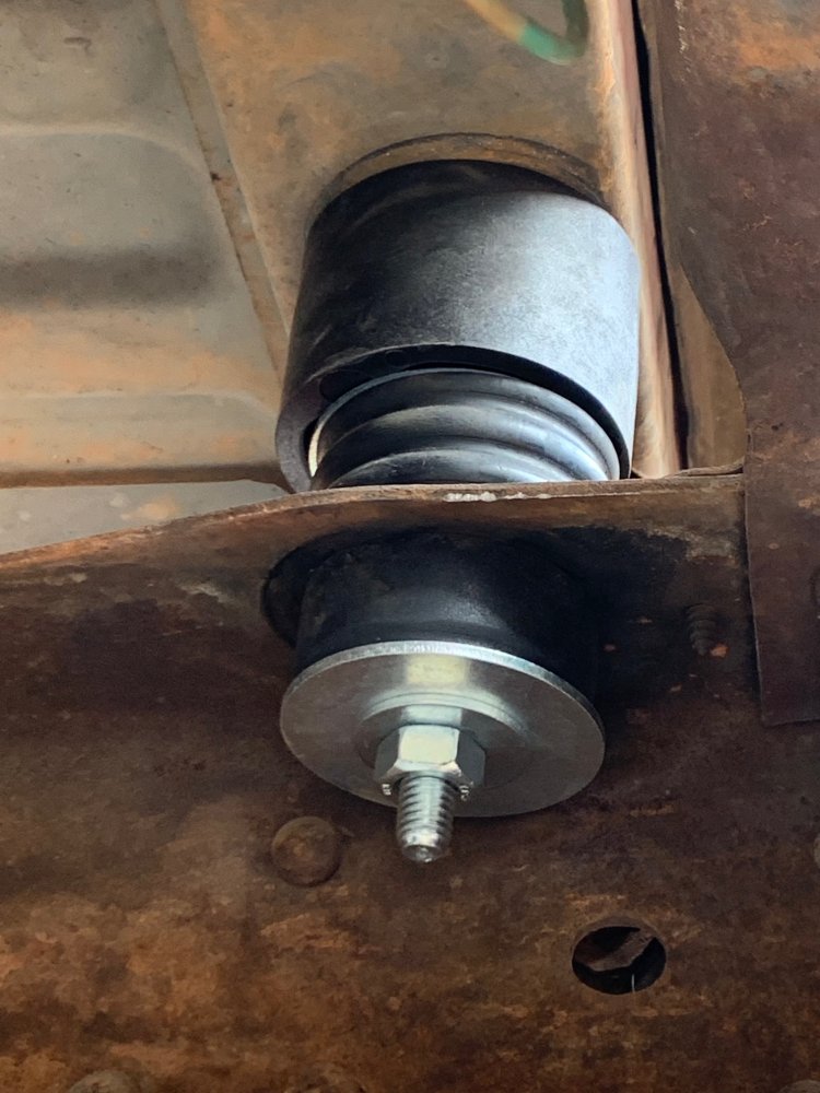

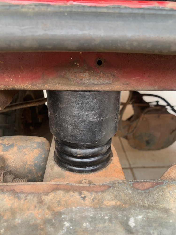

With the exception of torquing them down, I FINALLY finished my body mounts/bushings and 2-inch body lift swap (from 3-inch) portion of the project...
The 4 front seating area bushings (2 on each side, one in the footwell and the other directly behind the seat) were a real pain in the arse as anyone whose done them will tell you. They're pressed fit (likely hydraulically) at the factory and the various methods I saw for their removal weren't even remotely effectively. Driving a punch downward with the bolt screwed in at the bottom as suggested by the instructions I had from Duff were a joke, and I was smashing it like Thor with Mjölnir! Drilling it out as also suggested was a bust-out and homemade bushing pullers made out of 3-inch sections of exhaust pipe only succeeded in stripping out one of the mounting bolts. Sooooo in the interest of refreshing everything as I go, I bought Duff's new bushing kit AND a new "Torch" blade for my Sawz-All. Aftermath of that shown here:

Hindsight being 20-20 I wish I had just cut to the chase and saved all the time I wasted but it's part of the learning process I suppose...
With a new body lift and mounts it made sense anyway to replace the bushings, bolts, etc. I ended up with a lot of extra hardware, which is arguably wasted money, but I'll just add them to the hardware drawer.
While I was at it I had noticed while taking measurements that the body was clearly misaligned on the frame and was off by nearly an inch and a half in both the front and rear, which resulted in the bumper smashing/rubbing one of the front fenders and leaving a massive gap on the other. A couple of heave-hos and it was within an 1/8th of an inch in the front and a 1/16th in the rear...I'll take it!
The bushings were obviously stock/original and SMOKED. Some of them fell apart and were crumbling as I removed them so I'm quite satisfied it was a worthy undertaking. Not the least bit complicated, just a little more time consuming than expected.
The truck sits MUCH nicer now and is dead even/level. I'm going to continue my work on the suspension prior to reinstalling the gas tank and then go from there!

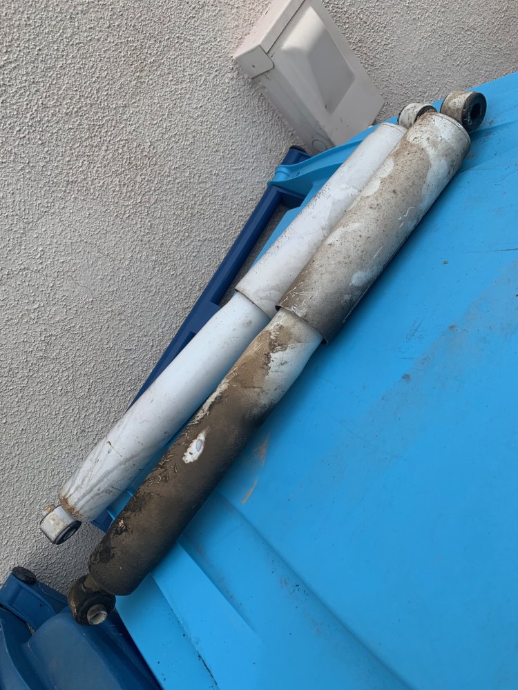

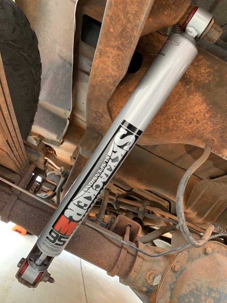

I got the rear shocks in today, pretty straightforward with the exception of the retaining/installation strap/tie breaking mid installation and after exploring several methods of getting the second shock in I ended up manually collapsing it and recycling the tie from the other shock. A bottle jack was handy in getting the bottom of the shock squeezed into the lower mount, the second shock was proving problematic until I figured out the bushing was slightly proud on one side...nothing's easy! 🥵

Not sure if the ones on there were original (they're Motorcraft) but one was definitely smoked and had puked its guts (oil) out...

Figured I'd throw in a couple of pictures of the 2-inch body lift with new bushings/mounts since I was futzing around...

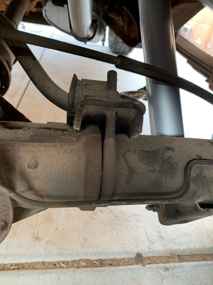

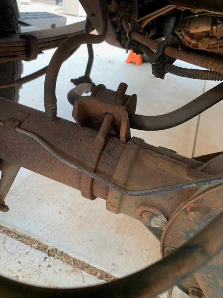

I also discovered that it would appear the passenger side of the rear sway bar is improperly mounted and is over the axle "collar" (for lack of a better term) with the bushing squeezing out. Since I'm replacing the bushings on those anyway I'll make sure to get it straight!

^ Driver side showing the mount flush to the larger flange/collar of axle tube.

^Passenger side showing inside portion of sway bar mount over larger OD axle tube.
I can check my 88, that may or may not be correct positions, I don’t quite remember. Far as I know, my 88 is factory spec in the rear at the moment. It’s gonna get some new leaf springs at some point
Thanks @lil_Blue_Ford I'd appreciate it if you'd do that for me!
It just doesn't look right to me (which doesn't mean it's wrong of course!), especially with the bushing squishing out of the one side. I didn't take picture of it but there's a rub mark on one of the sway bar links too which would seem to indicate some wonky-ness...
