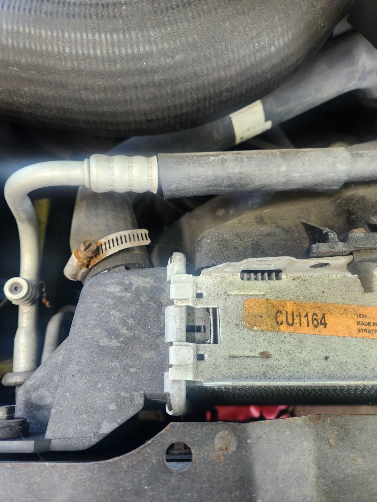

I just cracked open the box for my new radiator...and it looks NO different from the old one, which has a significant angle which puts a kink on the hose:

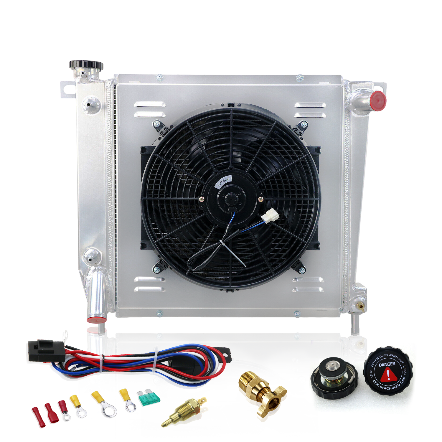

This Alloy Works radiator is sold here and listed as fitting '85-'94 Ranger/Bronco II/Navajo. My understanding is that the later model vehicles require the angle while Bronco IIs like mine, do not. I'm continuing to have cooling/overheating issues which is why I wanted a stock configuration radiator and Parts Geek sent me this one which is no different and has the same angle to it:
I bought the Autopart Premium Radiator, Part Number: 4976-02643390
Before I COMPLETELY lose my mind, I have to ask, am I correct that the stock radiator upper radiator outlet does NOT have a bend in it? The way the hose is kinked and how I had to wrestle it on I KNOW it's not correct...which I why I bought a new radiator, hoses, thermostat and cap.
This whole cooling system was a :poop: show when I first bought it and started digging into it; it had no thermostat and a piece of PVC pipe in the lower hose to act as an adapter for the oversized lower outlet, which is another difference I thought between my BII and the newer model year Rangers/Navajos...
If anyone has any pictures of their BII I'd appreciate, or anything else to help me regain my grip on my ever slipping sanity! :ROFLMAO:
I’ll have to see what I have sitting around for radiators. I can’t remember if it’s straight or angled
My truck has the 2 row expo radiator.
The inlet certainly isn't straight.

Thanks for responding with pictures @UncleGump! That's a radiator for a later model Exploder, correct?
I was at O'Reilly's yesterday driving them crazy and I'll have both the upper and lower hoses for my application and a later model 4.0 Exploder this week. Mocking up with upper radiator hose that should with my radiator it's WAY out of whack and puts it on a crazy angle nowhere near the thermostat hosing. Flexible/universal hoses are an option, I have one now on my lower radiator hose but it took two clamps to keep it from leaking which chapped my backside...
