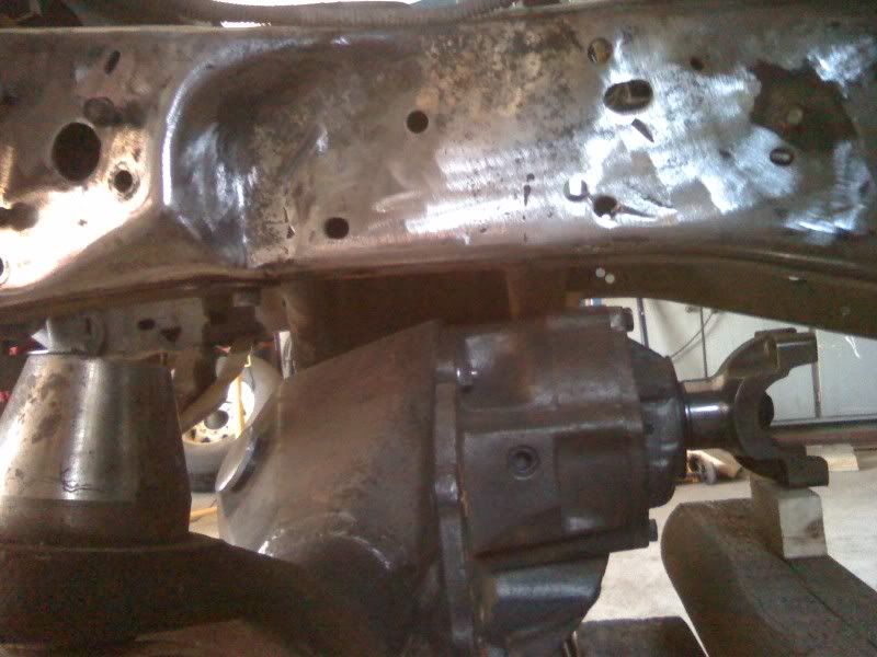

i have never seen a knuckle with the bevel on the outside. Looks pretty cool

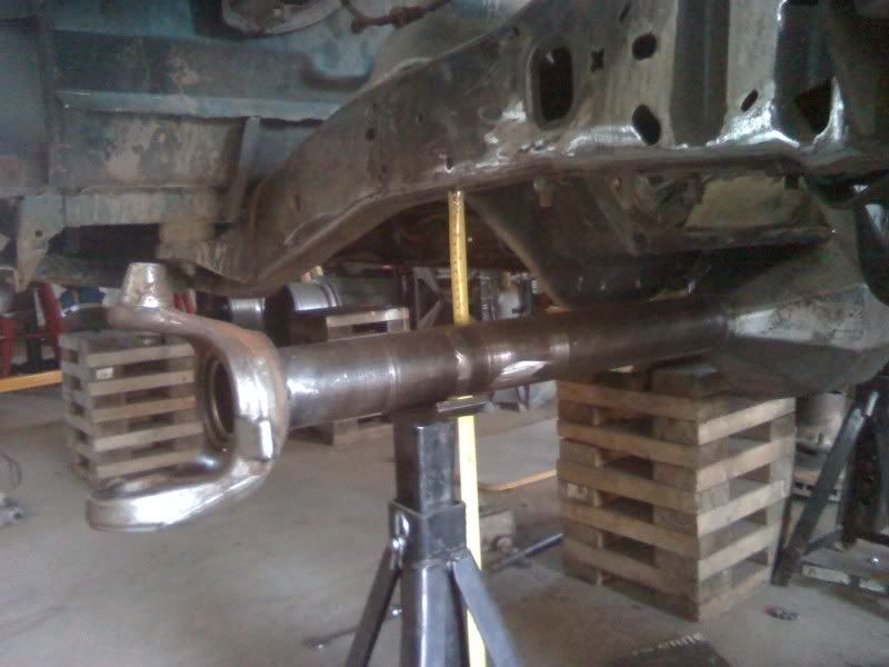

It fits in the nicely..... like the old D35! Thats 5.5" from frame to top of axle tube at full bump.
It's 1/2" at spots, and not much between the tube and the 'inside' of the crossmember. I basically lifted the axle until it started to hit stuff, then lowered it just enough to feel safe clearance. It's gonna get some healthy bumpstops and fit REALLY tight, I want this thing able to tuck 40's and be no taller at ride height then it was on 37's.

42" semi tire used for mockup.... this is at full bump.
