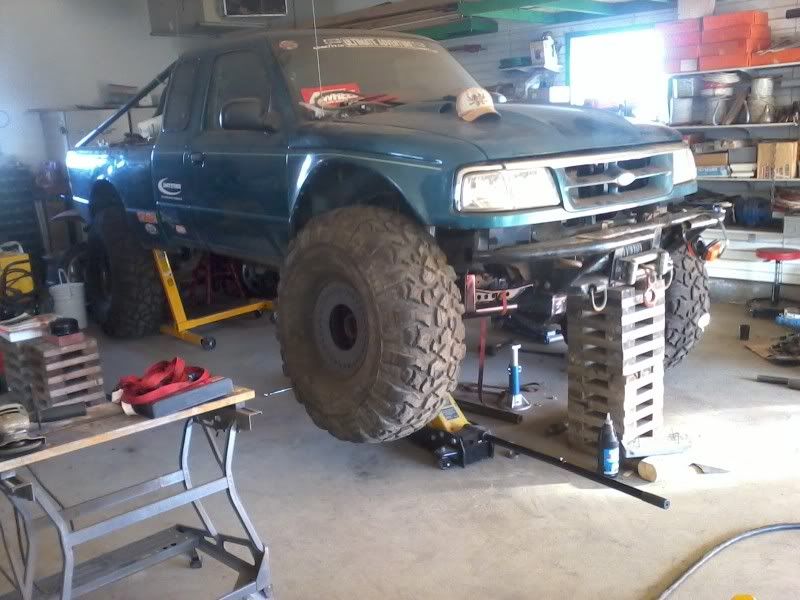

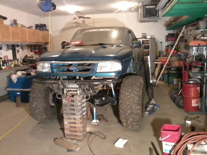

Had buddy's 'hoe (that we're takin to moab on tuesday :headbang:) over for some sliders and crossmember fab and decided to use the help while I had it and see if my hood clears my tower brace, and it does.... :yahoo:

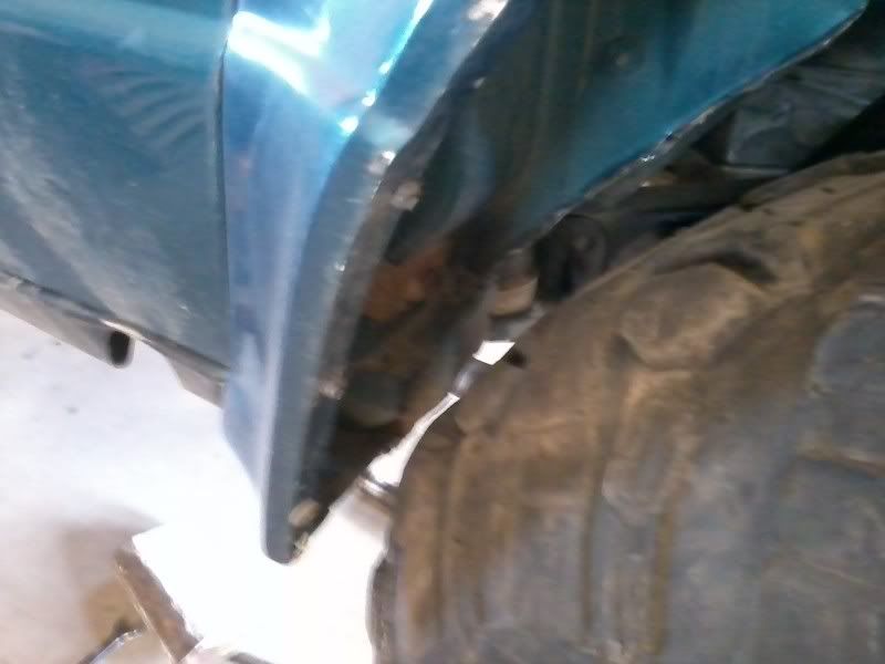

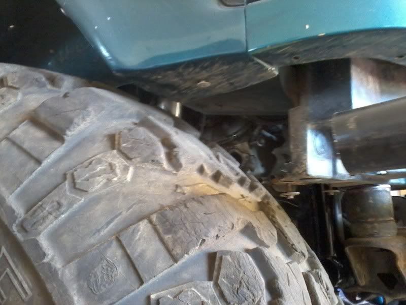

Slowly but ever surely I'm making progress.... 3' forward...2' back, always tack, then check... then weld. Probably end cutting the inserts outta the links and shortening them up 1.5" to better center the tire, I have lotsa clearance out back and rub a lil up front.

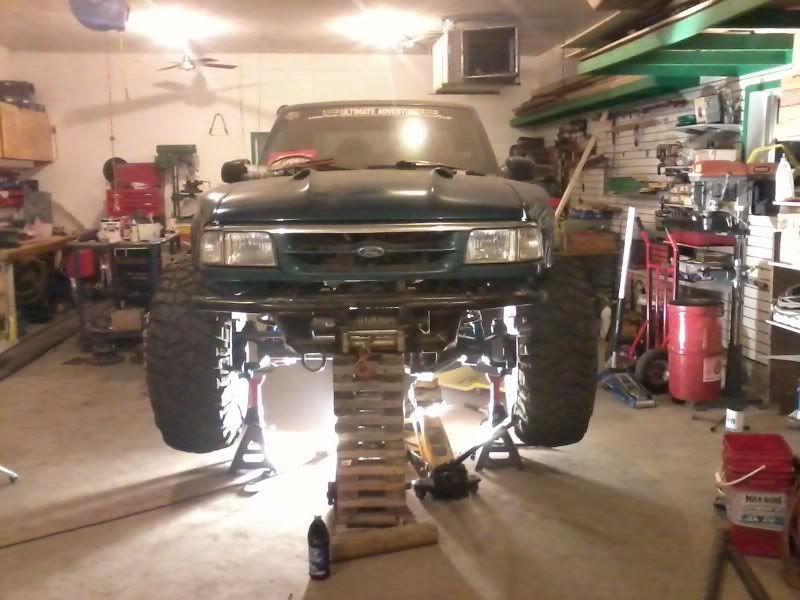

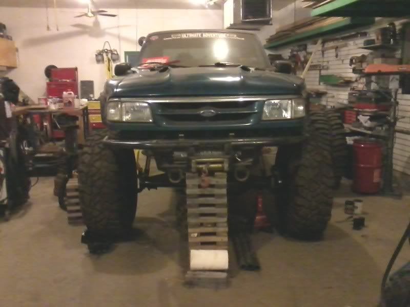

Progress! Sort of!

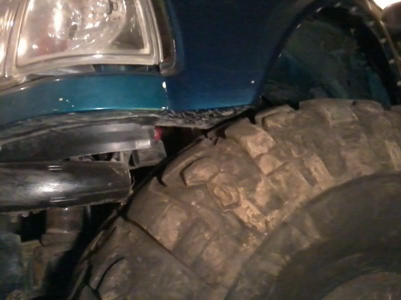

I think it's gonna rub...lol
It's still good progress, indeed. You're doing phenomenal work, man.

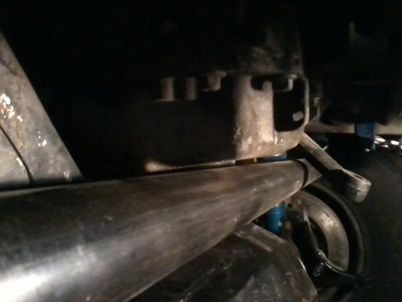

Track bar mockup at full bump..... clearance is gettin tight!

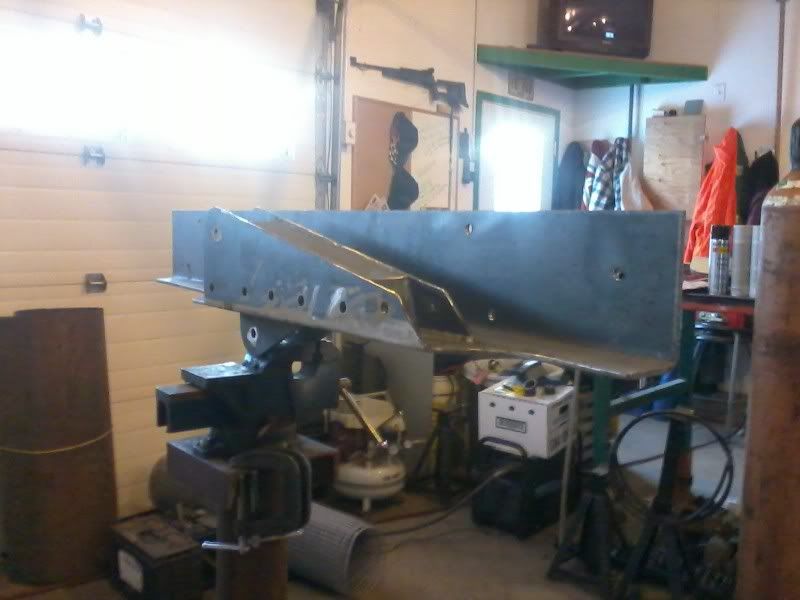

The plate thats bolted on will have the tubes for the X-members welded to it. Look's like the NWF BBi and Dana 20 Tcase is only 2" longer then the NP241 in there.... gonna save the pennies up to throw it in there before I build the Xmembers.
