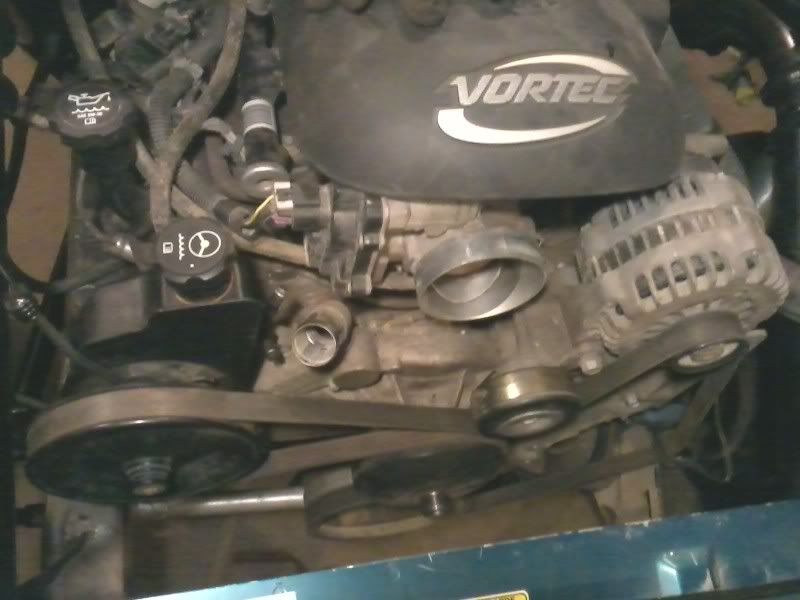

Got bored and started playing around with the belt routing.... Looks like the factory 6.0L P/S pump just traded places with the belt tensioner!

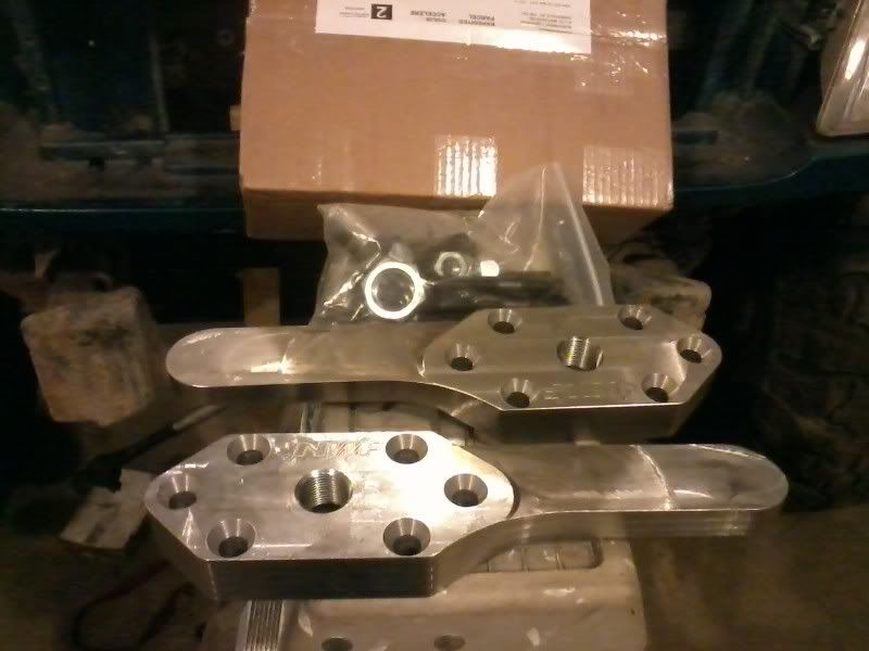

Some steering Bling from NWF

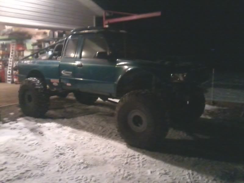

And the start of work on the rear housing.... Gotta make it mobile so the EXO ranger can get in the shop before we get 'real' snow here.
My Build, All Parts And Prices ***2016 Updated*** still not done...

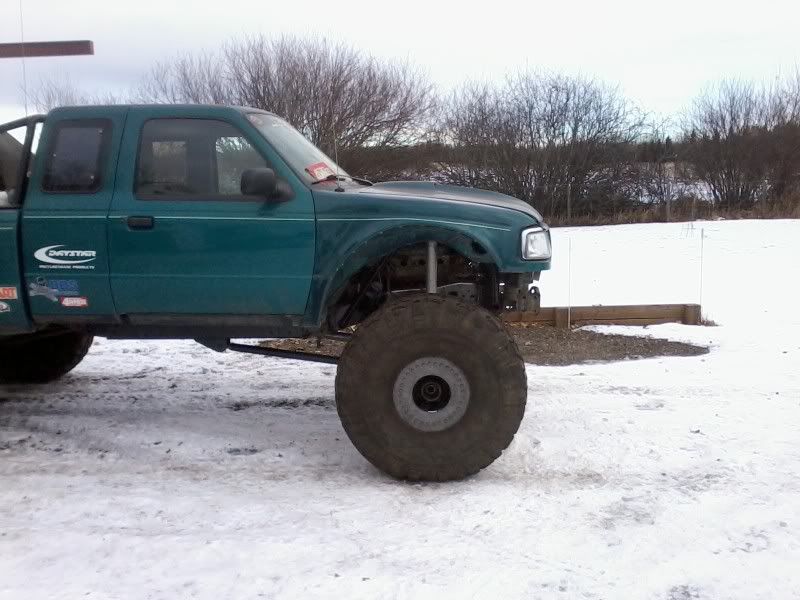

Got it rollin, my old mans happy that his project is inside before it snow'd too much.

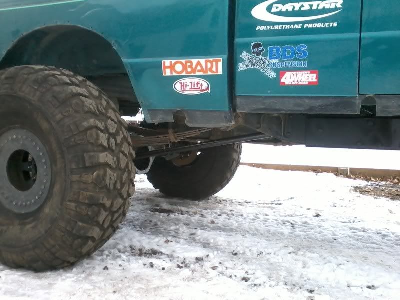

Rear housing done... needs a few more pieces but its under it.

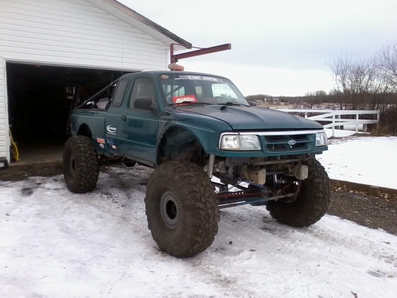

Pic whoring time, there was sunshine!
