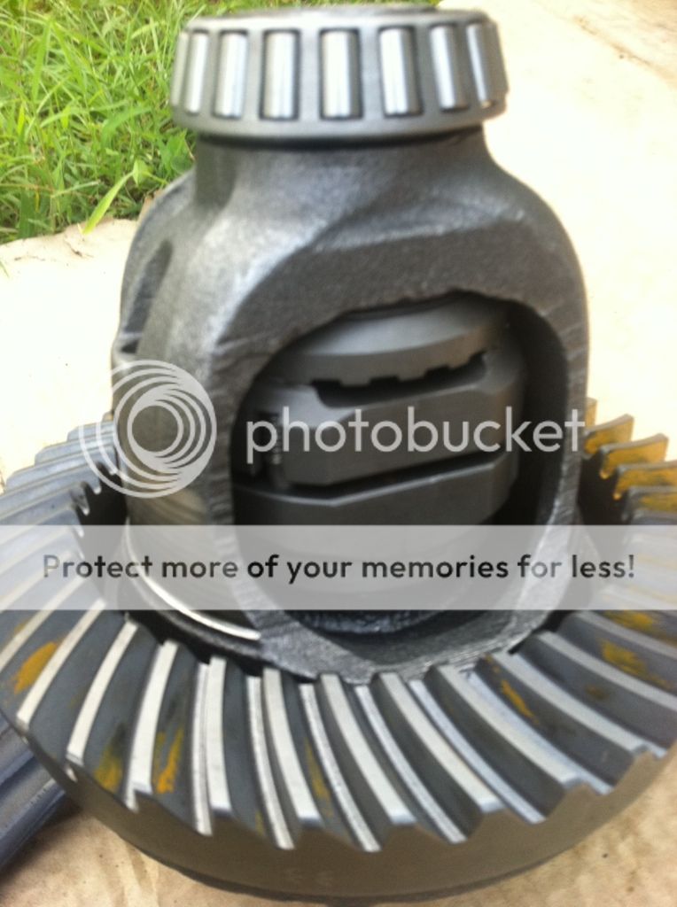

Aussie Locker Installed in Carrier.

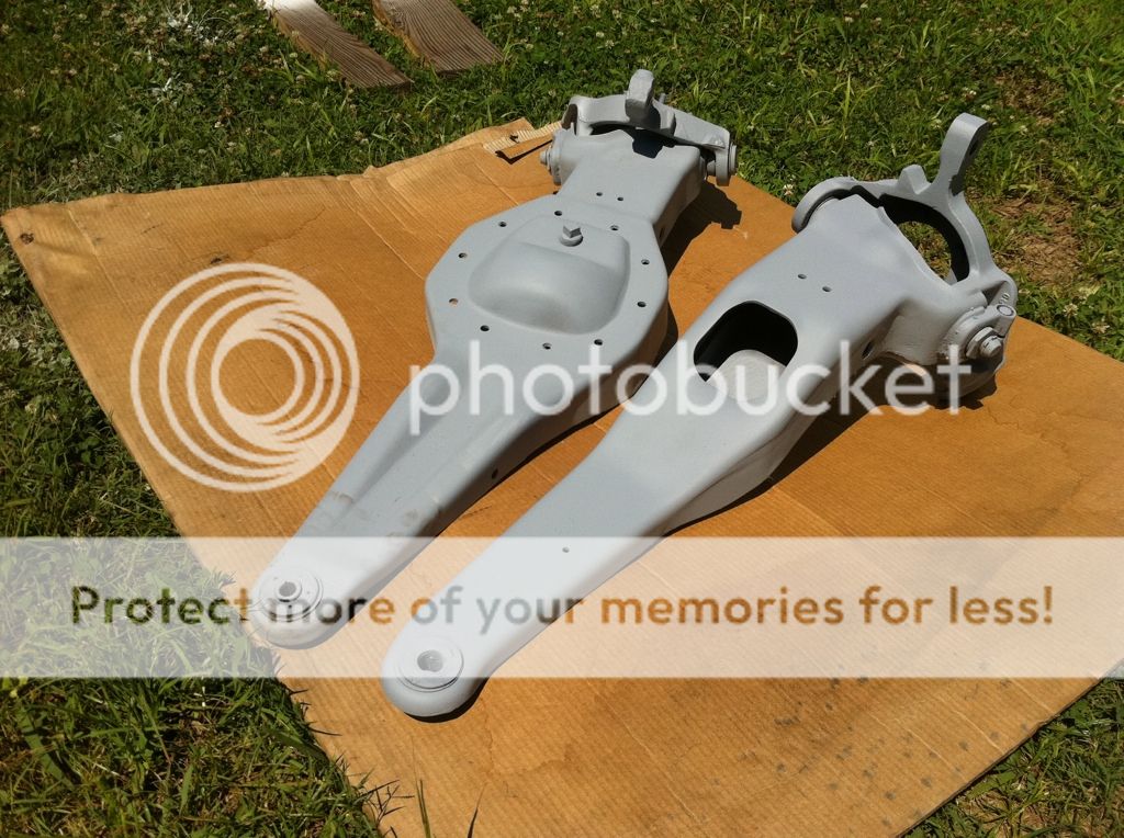

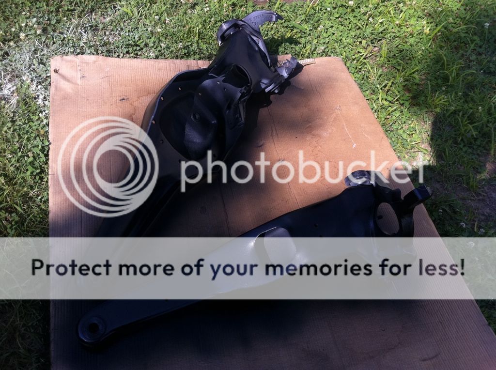

Axle housing cleaned up some more....only to find out i don't have any primer at home...:facepalm:
oh here's a pic, don't pay attention to the gear pattern tho, I'm gonna clean it off and try it again once its torqued down in the housing.

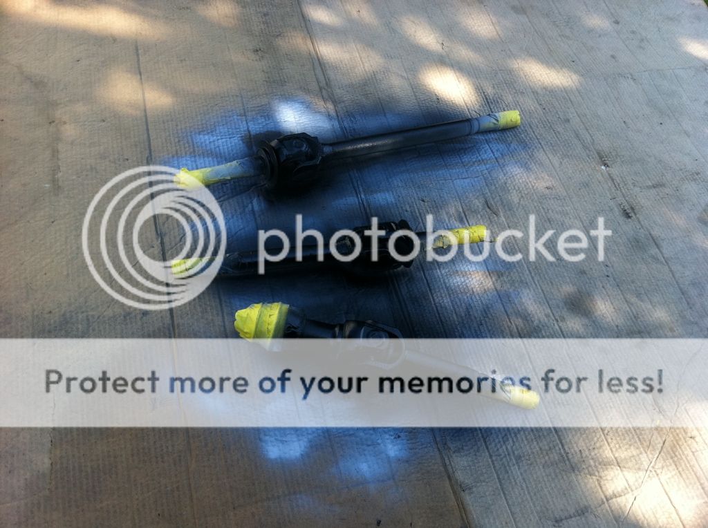

after the shafts are completely painted I'm gonna be changing out all the joints...just didn't wanna get paint in the openings for the joints and have to convince them to fit... so the old joints are keeping the openings clean lol.
did you at least take the c clips out before you painted them on? would have been easier to take the joints out first, then put just the caps back in...plus would have given you better access to the inside of the joint. Youre likely to scratch them all up taking the caps out...but not that it really matters...
Yeah after talking to a couple others I think I'm tear them down and spray them again so I can get inside easier. Clips are out all but one shaft. Forgot to take them off one.
Yeah so my "great plan" might not have been so great... Thanks Nate lol. I'm just glad I'm making some progress.

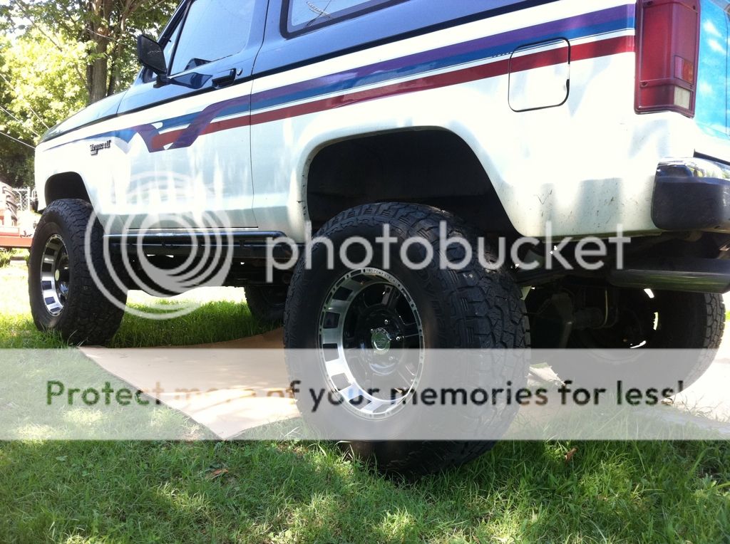

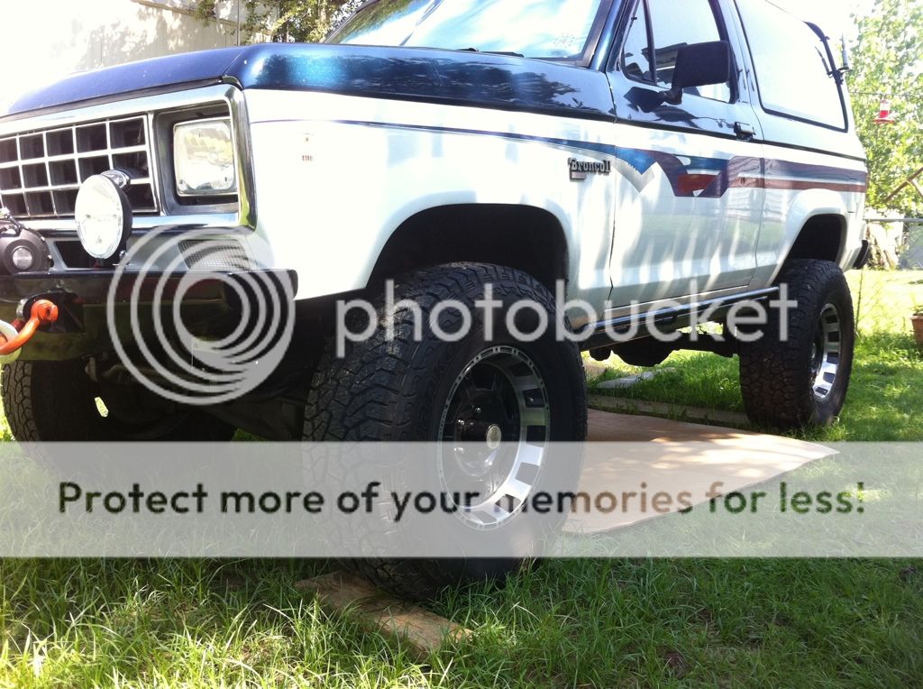

before pics:

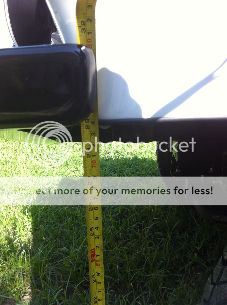

notice how much the front has sagged since I did the RC lift....

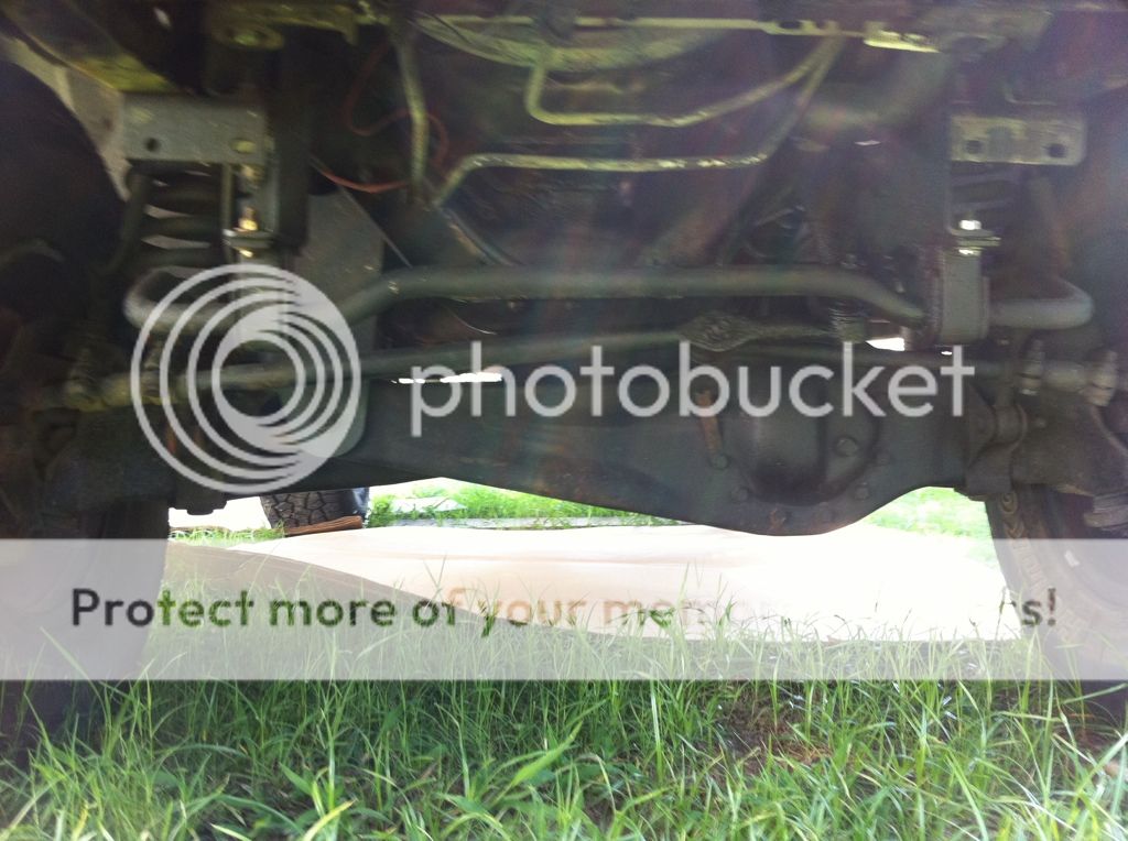

front

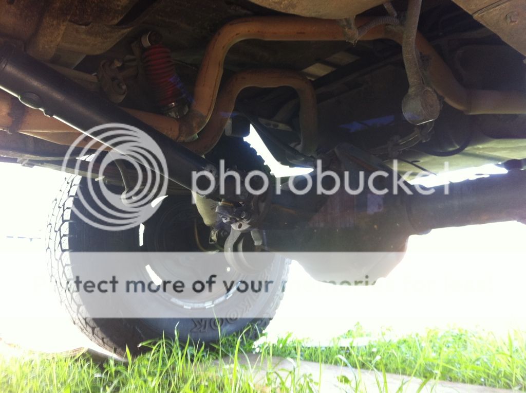

rear

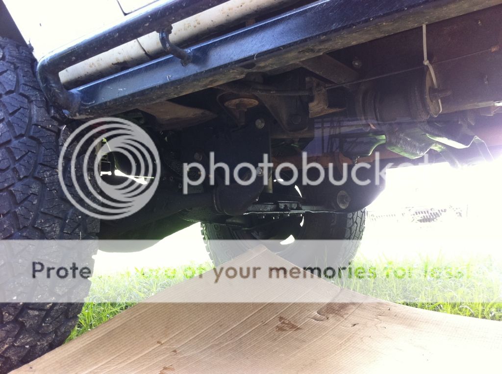

front by bumper

crossmember will be remade to something like 88_eddie just did, with some changes

so many changes will happen in this pic
My Bronco 2
sway bar will be mounted in stock location, with JKS quick disco's
superrunner steering
xj coils
vms brackets
oil leaks fixed
so on... so forth.

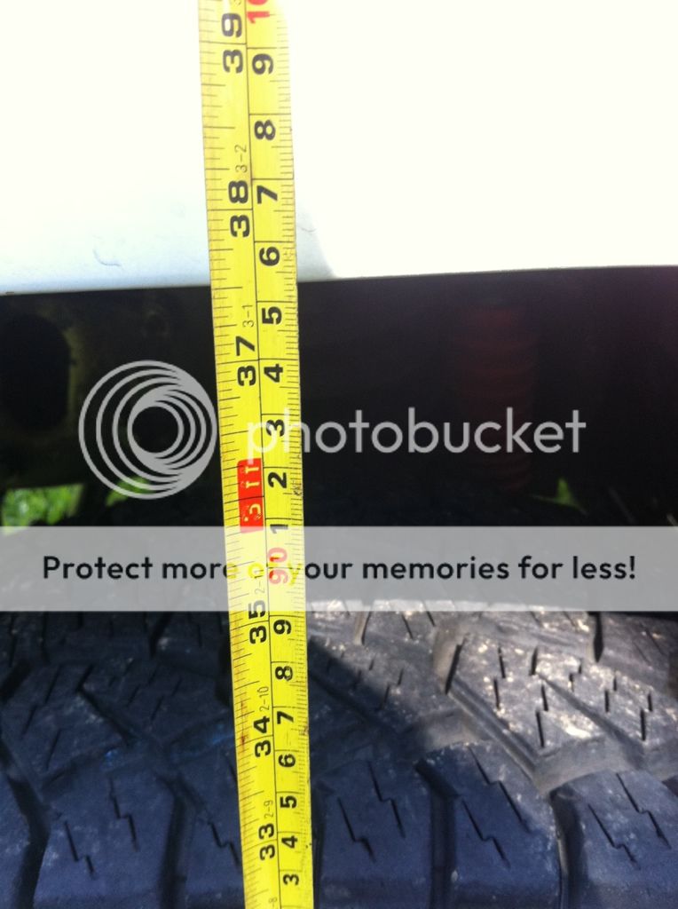

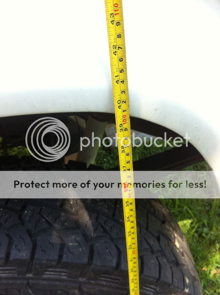

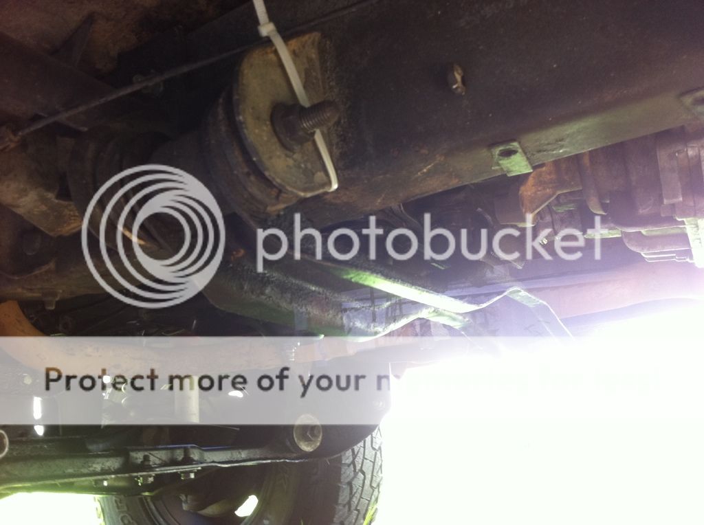

pic of the rear, shows that I need to find someone better to balance my tires, think i'll take them off and take them to a buddy's shop to have him do it.

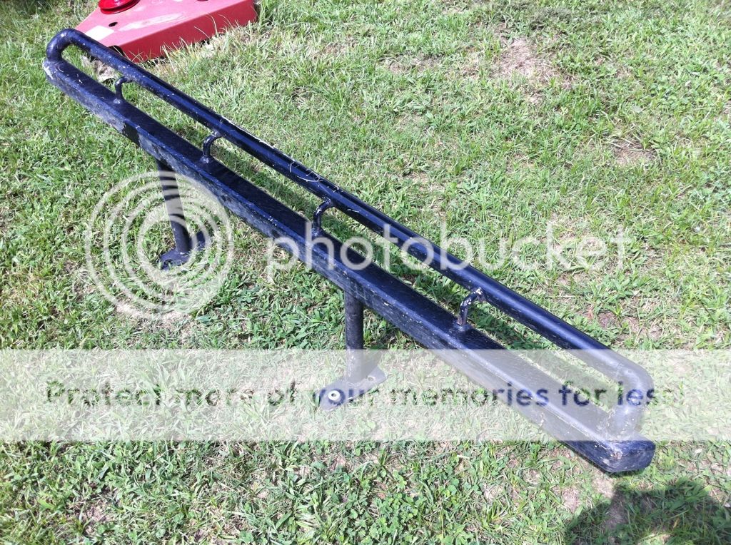

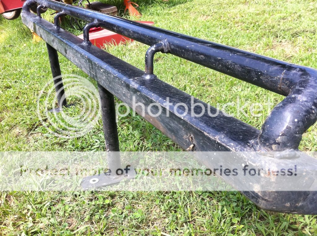

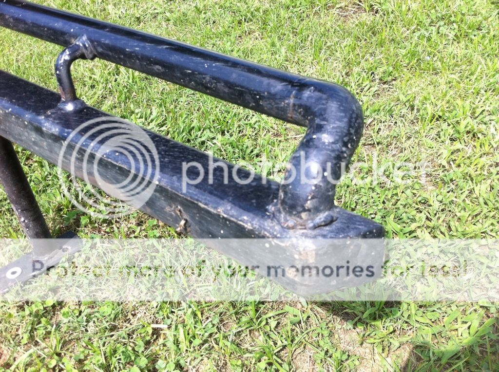

i'm gonna sorta copy your sliders....just so you know lol

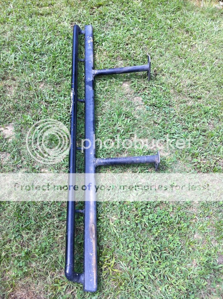

want a pic of them off? I just took them off.
I'm gonna copy your crossmember, guess we're even huh? :icon_rofl:
only thing I would recommend with the sliders is 3 legs instead of just 2, and bigger footprints on the frame. Mine only have 2 legs with 2 bolts each. not my best idea lol

think I'm gonna use the square and round "outer" pieces, just remake my legs and frame plates.. mine rattle against the fender bolts, that bolt in the rear of the fender is gonna cause you some pain.. lol
