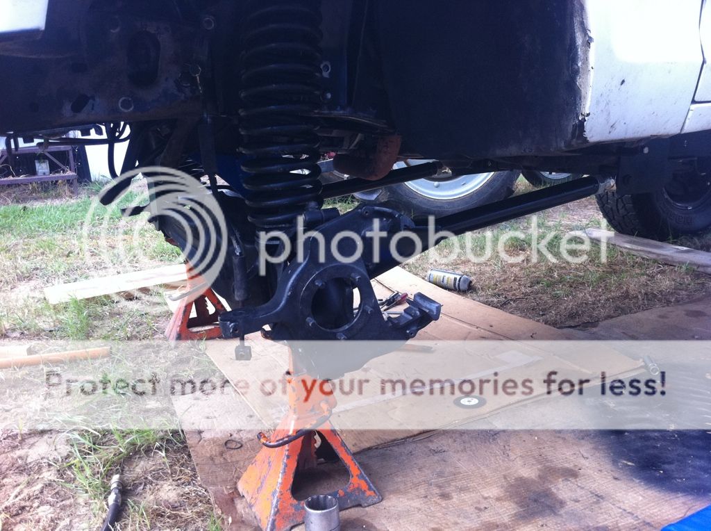

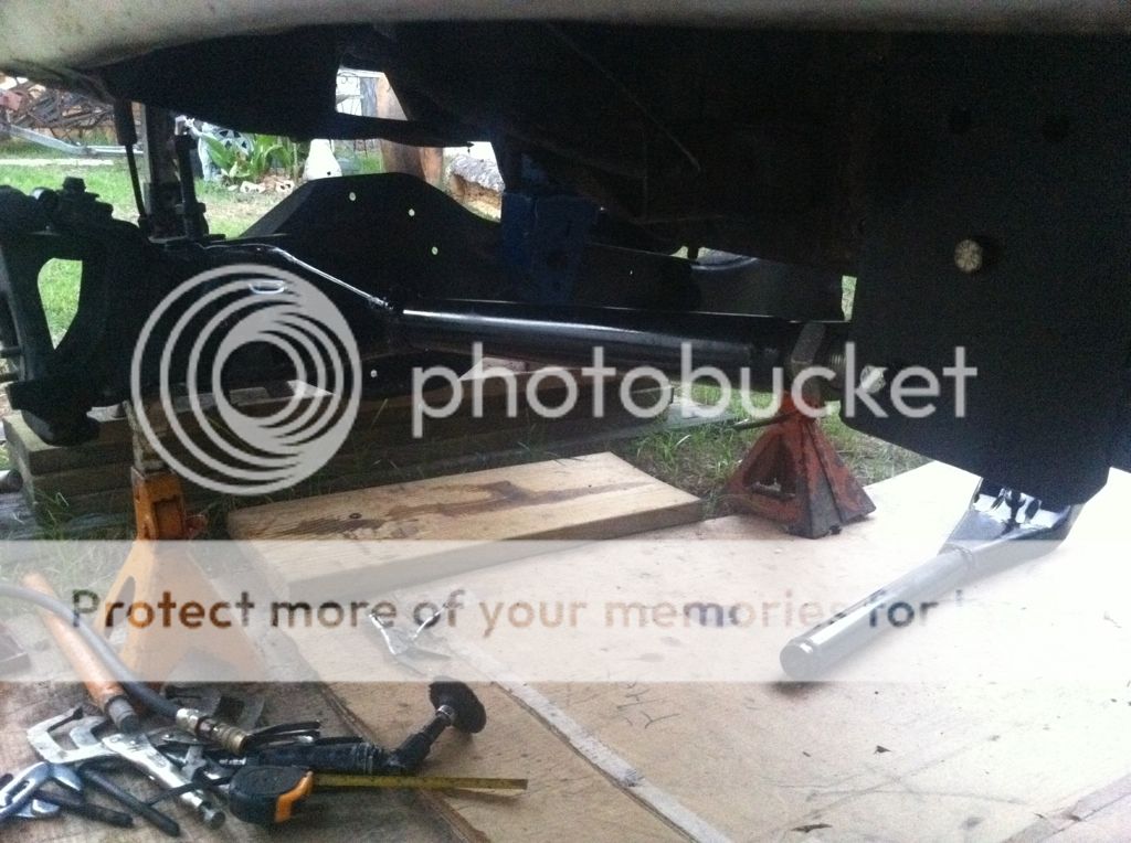

Looks like that joint is awfully snug in there....looks as though your going to snap off the grease zerk, on top of having no room for articulation of the joint.
yeah, I'm debating my best option here.
I have zerk plugs, so I wouldn't have to leave the zerks in.. flip the joint over and just plug the zerks till I grease up. :icon_confused: idk yet.
edit: also there is a little more room than the pic appears to have.

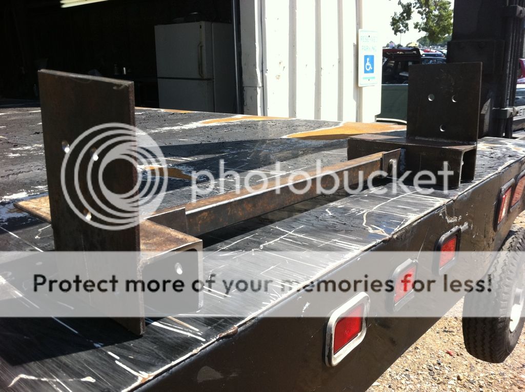

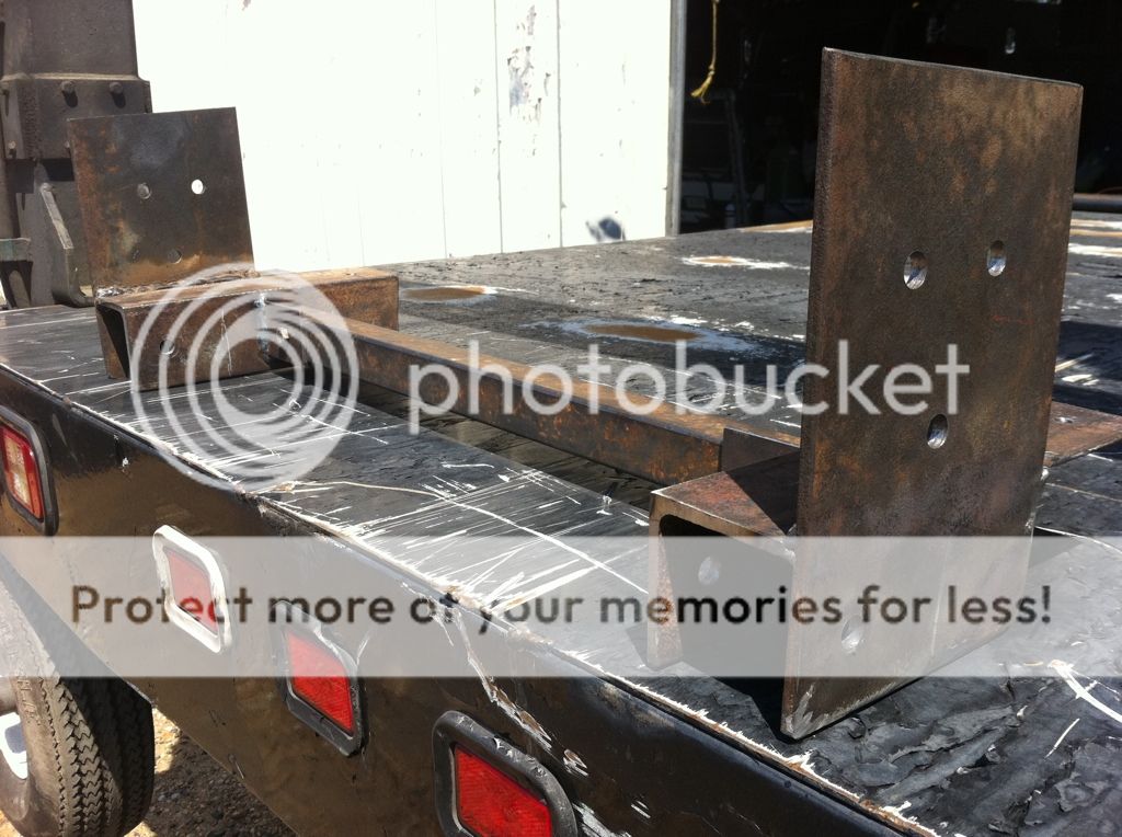

crossmember almost complete other than trans mount standoff, got those pieces cut out today.

I hope you're double shear mounting that transmission crossmember and rounding off all sharp edges on that mount. Sharp edges are where the steel will rip.
I'm not worried about the trans Crossmember. 2 grade 8's and tack welded. It'll hold. It'll be stouter than the original crossmember that had to grade 5 bolts in it. It won't go anywhere.
The back of the radius arm mounts are probably gonna be angled off; if nothing else it'll look better. Lol.

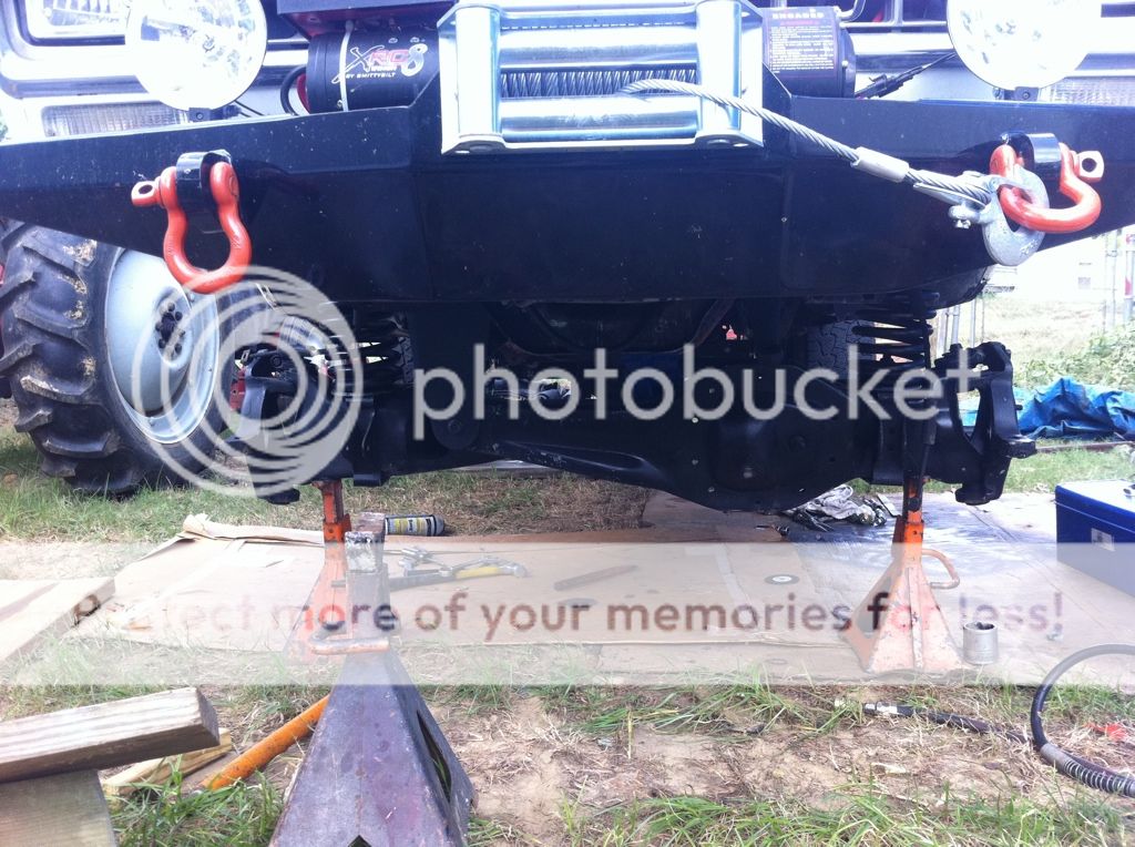

crossmember/RA mounts-- bolted up
RA's-- In
Coils-- In with custom bottom coil perches

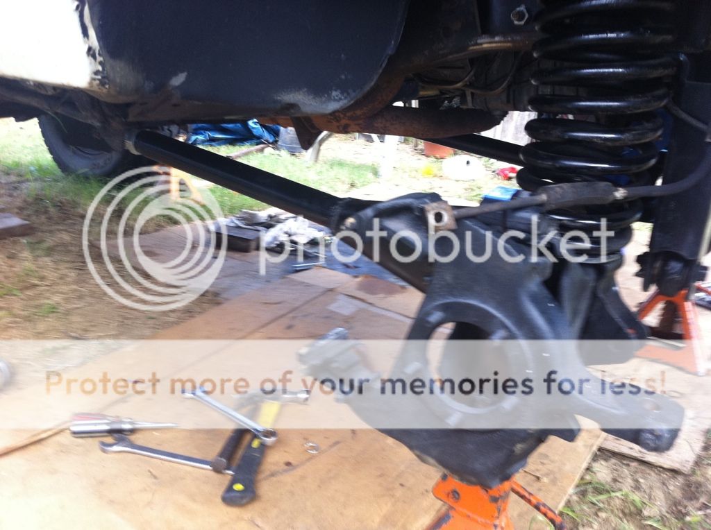

so far so good... took more cutting/grinding to make it fit then I thought it would...
the coils look to give me the right height or maybe about an inch to much... but I'll just level out the rear if that's the case. right now the coils don't wanna sit in there straight even tho the bottom and top are lined up... idk.
pics:
here's an explanation of what I did to make the bottom of the coils mount up;
I took a 3/16's piece of metal, cut a 4.5 inch round piece then welded a 2.5" piece of pipe on the top middle of that (just tall enough to clear the bottom coil of the spring) then took a 4" piece of round flat metal on top of the bottom coil... tighten it down with the factory nut on the factory stud. I think I have pics of this... If not, sorry but I'm not taking them back off! lol
