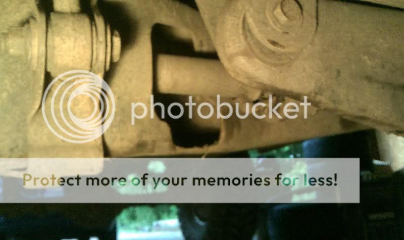

Basically for the k-link you just cut off the mounting bracket, clean it up, then weld in a another piece of 3/4" thick flat bar, 1, 1.5, or 2" wide to drop it down like so. I needed 2.5" of drop, so I welded in a 2.5" x 7" long piece:
My Bronco 2
My Bronco 2
My Bronco 2
You are just basically trying to get the tie-rods level with the amount of lift you have. So once you figure that out, then you can buy the appropriate piece of steel to weld in.
For me I wanted the ultimate in durability so I reamed those two holes plus the ones @ the knuckles for chevy 3/4 ton TRE's/DRE's and run 1.25" OD 0.219 wall tubing for tie-rods, tapped 7/8-18 so the TRE's/DRE's just thread right in.
