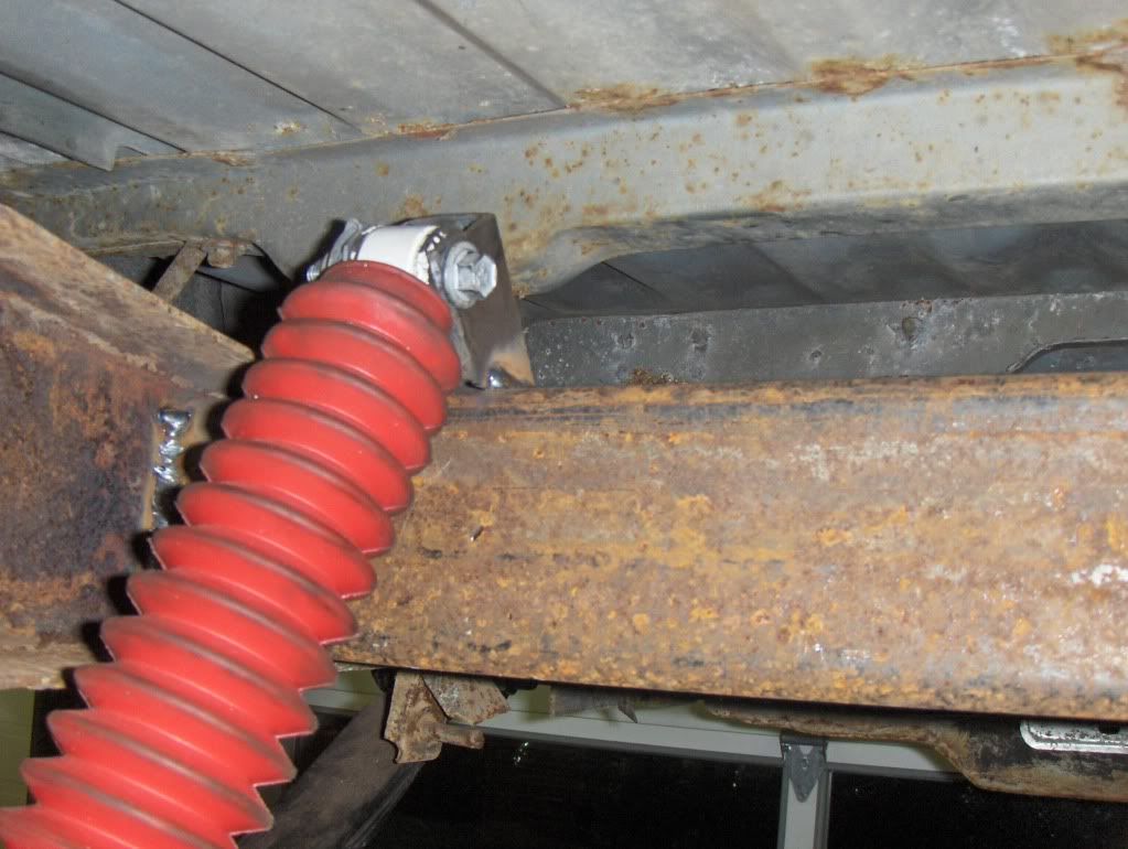

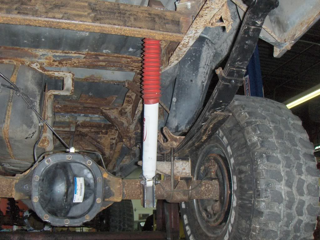

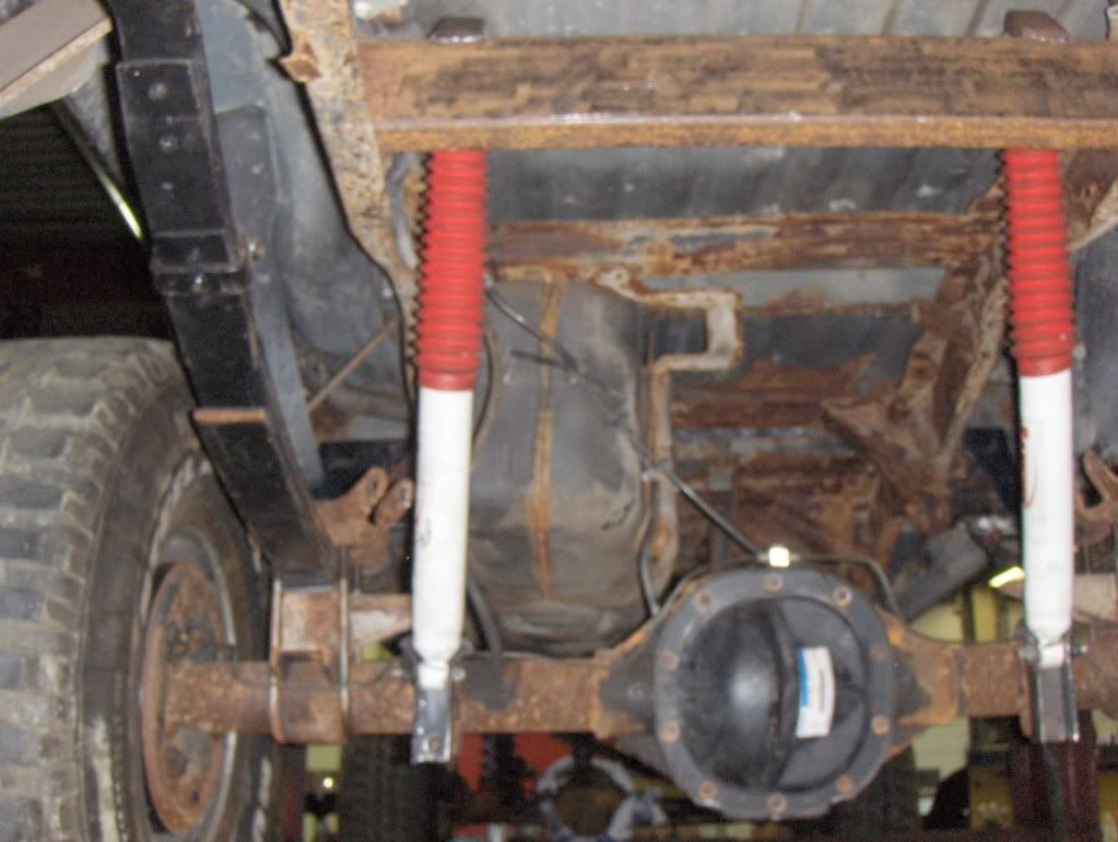

Made use of the explorer swaybar bushing mount location, and welded in a nice beefy crossmember.
The shocks are for a 4x4 f250 with highrider package if i remember correctly. Not sure, I bought the shocks 3 or 4 years ago. All i remember was that i bought them on sale and ordered the biggest ones i could think of.

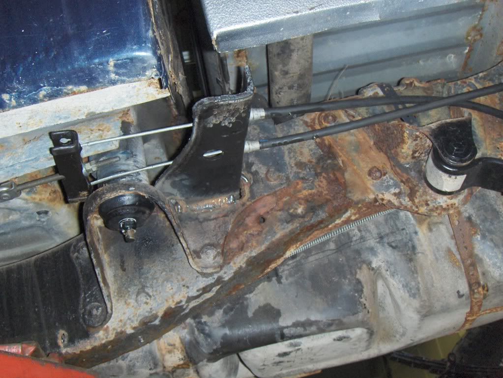

Im really slackin on this. Recent updates are installed and fabricated brackets for the ebrake cables. I used the front cable from the ranger and the rear cables adjuster/equalizer from the 91 f-150. Worked out great. The brackets are made from Escape lower control arms that I replace all the time at work and had some in the scrap bin. Figured they are beefy enough and cheap(FREE!).

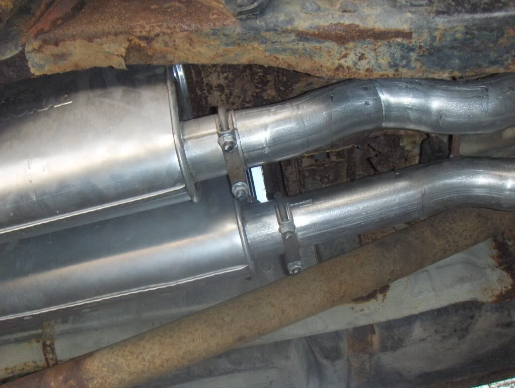

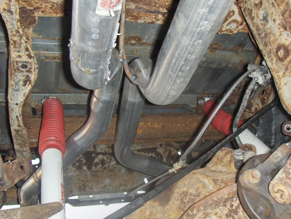

The exhaust is done, but i havn't gotten pictures of it all yet, only the front portion. Yes I put cats on it, I want to make sure this trucks legal WHEN i get pulled over, its not a matter of if, its when im not going to try and fool myself. Its nice and quiet at idle and its got a little rumbble when i give it a bit of throttle. Its exactly how i wanted it. 2.5" all the way back. No cross-over pipe. I will get more pictures later but for now...

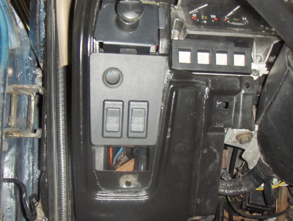

Next is the power windows that were installed on the truck quite a while before it came off the road. They were never actually wired up, i left the wires exposed under the dash near the center. When i needed a window up or down i stuck the wires in the cigatrette lighter. But for the first time they are fully functional.

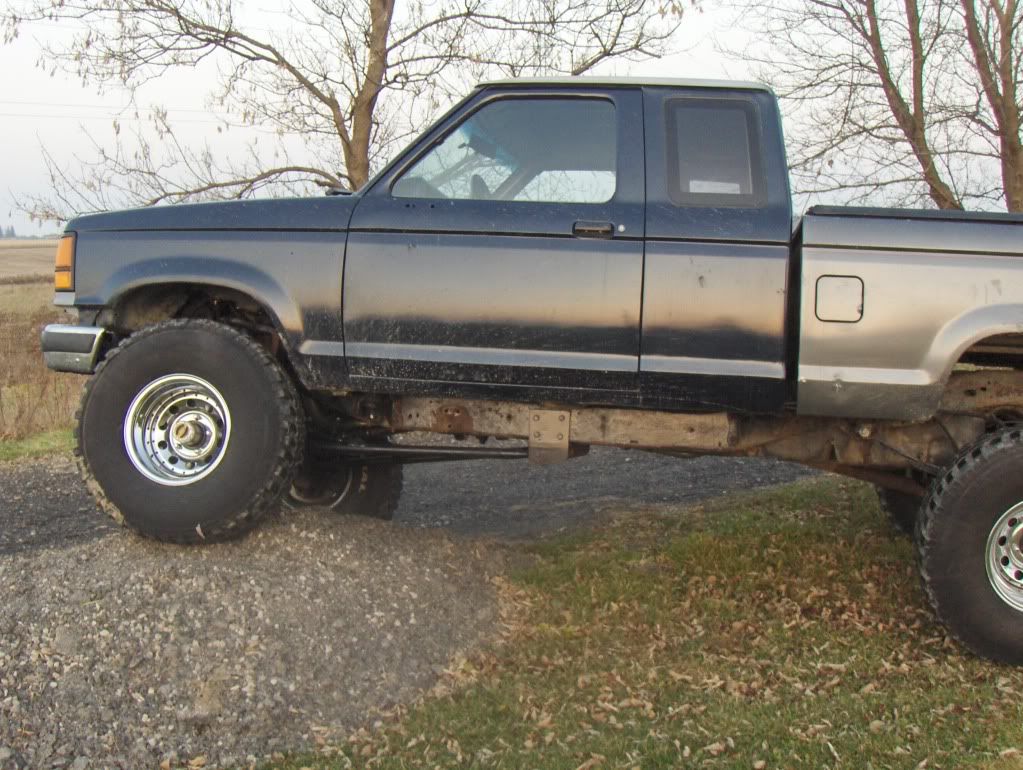

For another update. The Alignement was set. When I narrowed the front axle 6" i tack welded the passengers side inner "C". Enough that i knew it would hold together enough for temporary slow speed driving but not too much to grind off. This was so that i could measure the caster on the alignement machine.
I set the caster angle according to the 4x4 ranger factory specs. The caster i had it at was only 1 hammer swing away from the spec. It was in specs, but not close enough. Then tac it back on with the shop welder untill i can use my buddys big welder to make it solid.
After setting the alignement, I decided it was time for a maiden voyage! I needed to transport the truck to my buddys place to do some welding on the axles and frame. No better time than the present! Threw a dealer plate on the back and took it for 10 - 15km drive. Good news is that it drives better than it did when I drove it last(3 years ago!). Bad news, throttle cable still needs adjustment, wont get into 4th, and forced upshifts. But it is driveable!

i promised pics of the rest of the exhaust.

ANd to get pictures of the exhaust this is what i did.
