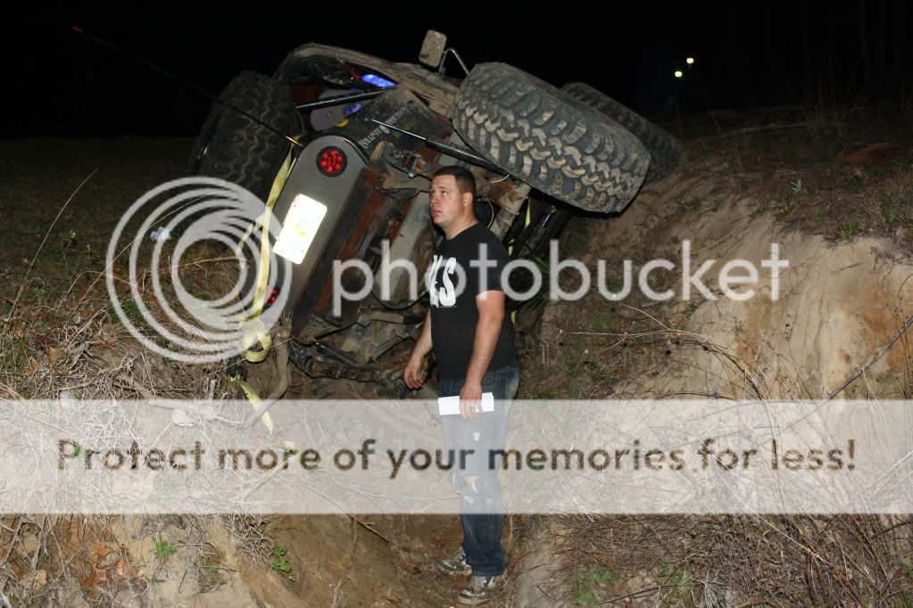

trashed the gears and broke the housing. Shaft looks ok. Need to get another case for sure though to chop up. Broke windshield and smashed the whole driver side of the truck also.
my B2
everything was going good till the case blew up
Is that the tow truck driver standing in the ditch? :thefinger:
Major bummer dude. I know the pic doesn't do it justice, but the ditch looks like fun. I've spent hours playing in big washouts and ditches and shit.
i see what your were describing now. i had it pictured differently.
leaning toward fatigue on this. unless it does it similarly and in short order again. then i will be leaning towards c6/aod 205 or some stak type thing.

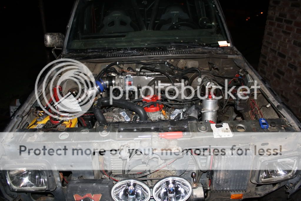

update pics.

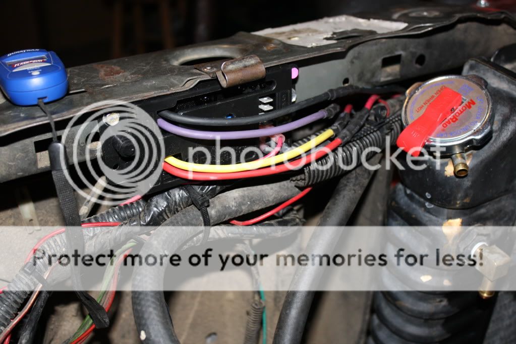

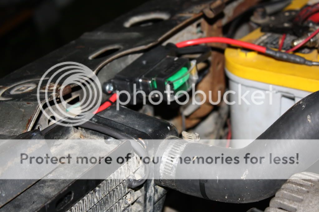

new flex-a-lite fan controller

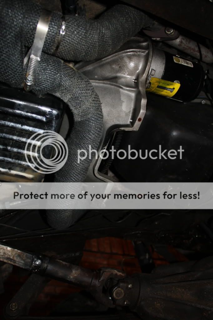

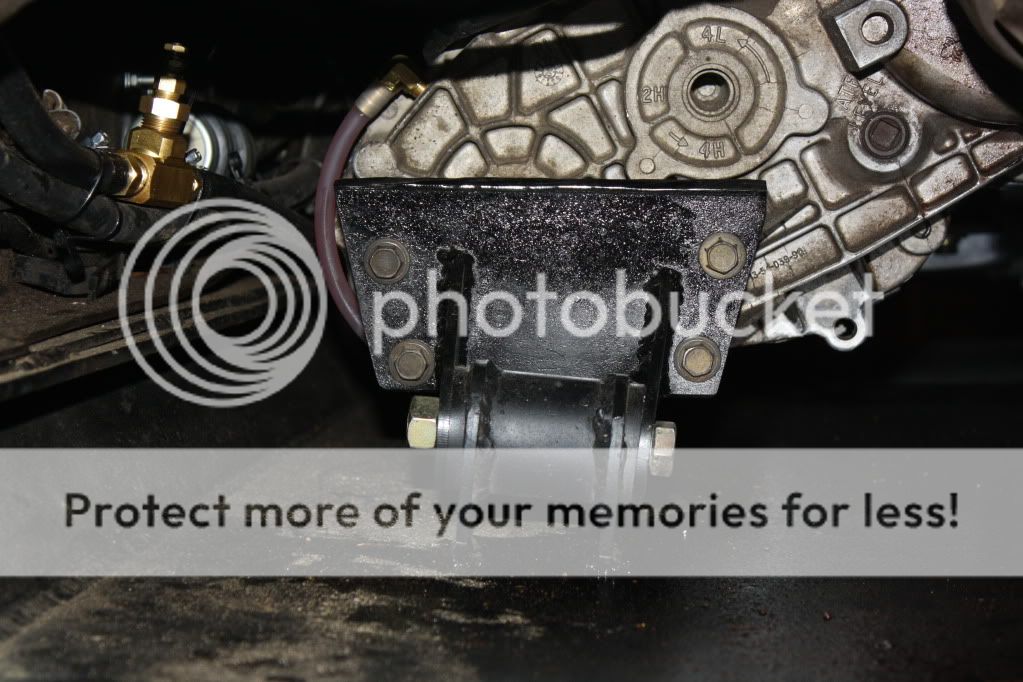

got rid of my old t-case support/mount, and changed it to this:

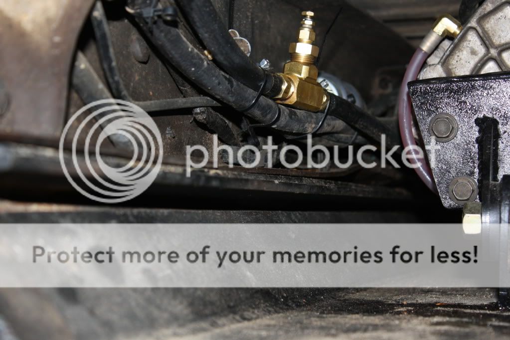

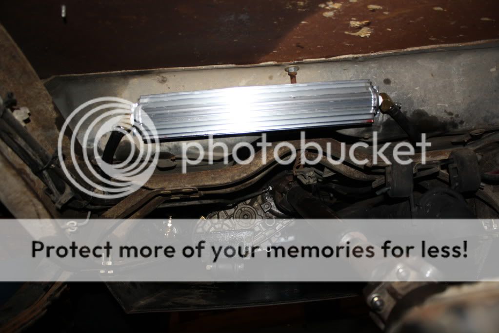

transmission cooler
my B2

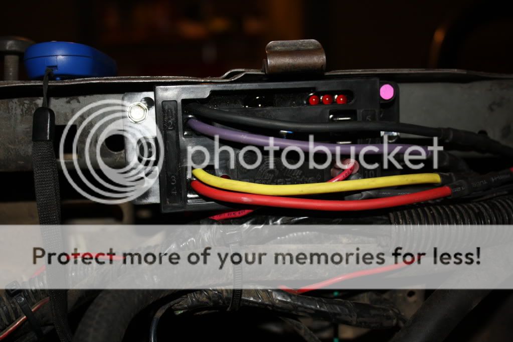

trans temp sender

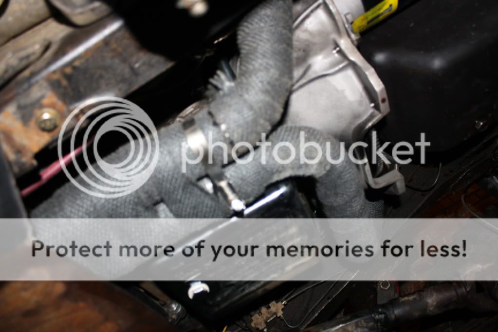

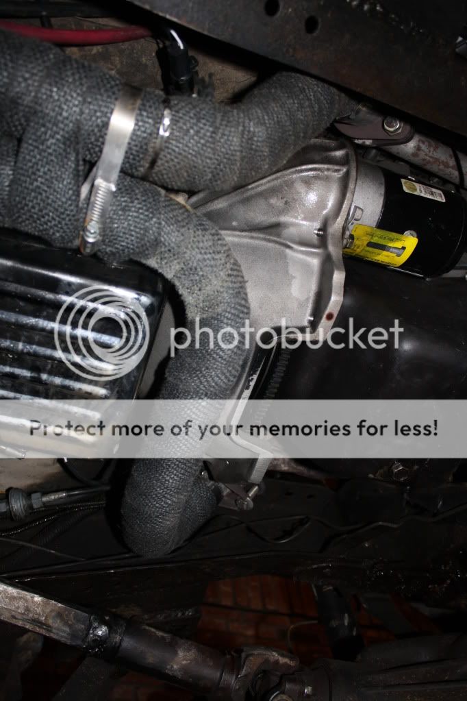

and wrapped my pipes

looks good, outa stay togather now...
You've got poly motor mounts and a poly trans mount? Even with the t-case mount being rubber, the offset from the driveline centerline will make it resist more rotation than the poly trans mount will. That's my guess anyways.

wraped pipes + mud = the loose
along with the open air filter
I hope so. I never ripped t-case off before, but I did break my rear mount, so I changed to this poly bushed tube.
motor mounts are vulcanized rubber, they are stiff. Trans mount is energy suspension poly. that new rear mount is poly.
this is my old style:
my B2
that mount ended up coming apart in clayton, which is why I changed to the poly bushed tube style.
I tend to agree with you, the trans mount resists lifting, the offset mount I have built supports the load of the doubler, and resists rotation.

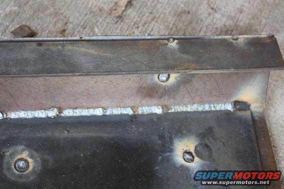

Thanks for the compliment on the skidplate... especially since last summer when I made it, I did it on the cheap.
I had a buttload of 1/8" laying around from when I built the bed, and I didnt want to dish out the $200 some bucks for a sheet of 1/4 to build my plate.
so the entire thing is double sheeted:
my B2
my B2
my B2
my B2
and yes, its heavy.
