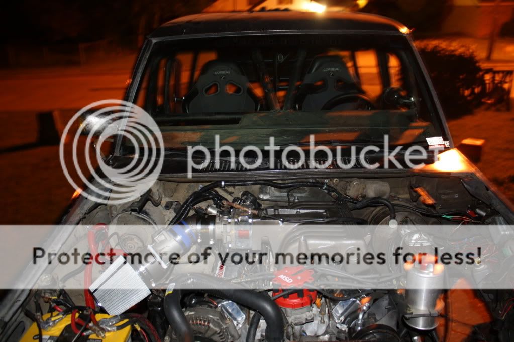

ok firstly before I post this video. I still have more power to unlock.....

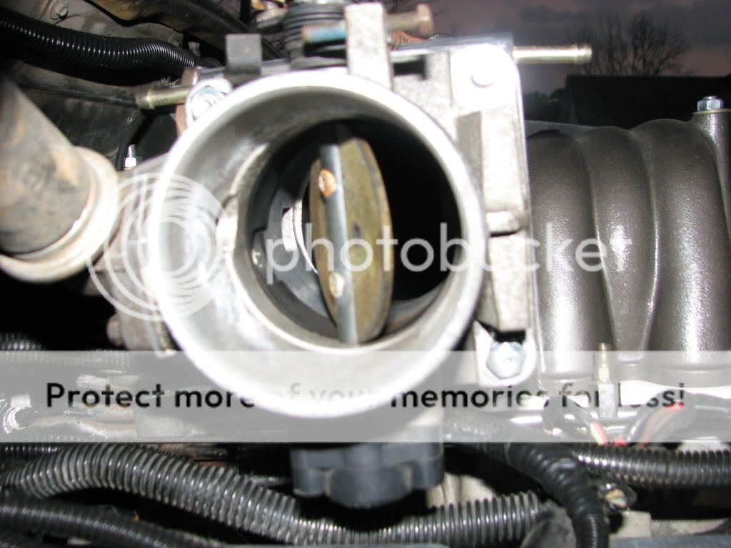

This is all my pedal will open the TB, which isnt enough to make the TPS go into WOT. I need to figure a solution for this.

Not enough "throw" on the exposed cable mounting location at the TB? I've had this problem using non standard cables on bikes before & had to fab/bend a bracket to make the inner cable pull farther. If that mumbo jumbo makes any sense to you. :icon_idea: :dunno:

Cable has enough throw, its an explorer 4.0 cable. Just not enough throw at my pedal. I think I will have to cut, bend, re weld it so at zero throttle its a little higher off the floor, about 1/2-3/4" im thinking, so it shouldnt feel weird.

had a similar problem with my truck the cable had stretched. fixed it on the side of the trail using a nut as a spacer and ziptied the end of the cable to keep the nut from sliding back over the barrel end. jsut reminded me i need to fix that.
with it to the floor in 1st i couldnt get above 3500 rpm's
same thing happened with my 2.9.
this however is not the issue with my cable. My cable has no slack in it.
My pedal just doesnt have enough throw. it'll be an easy fix.

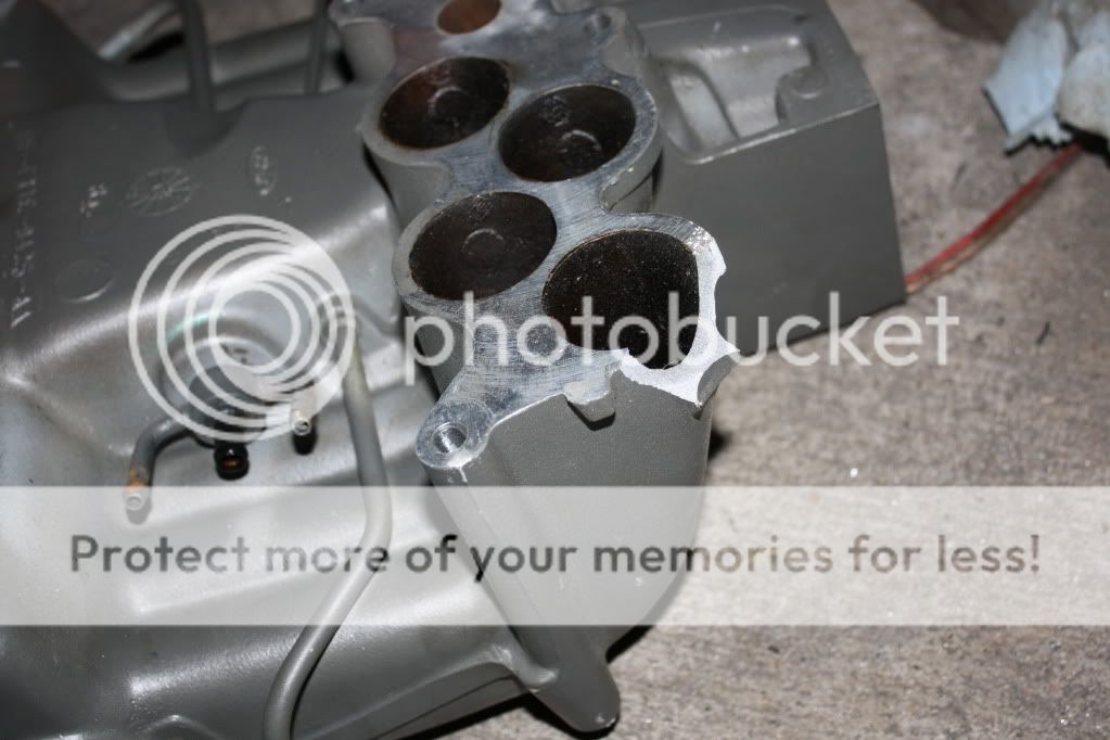

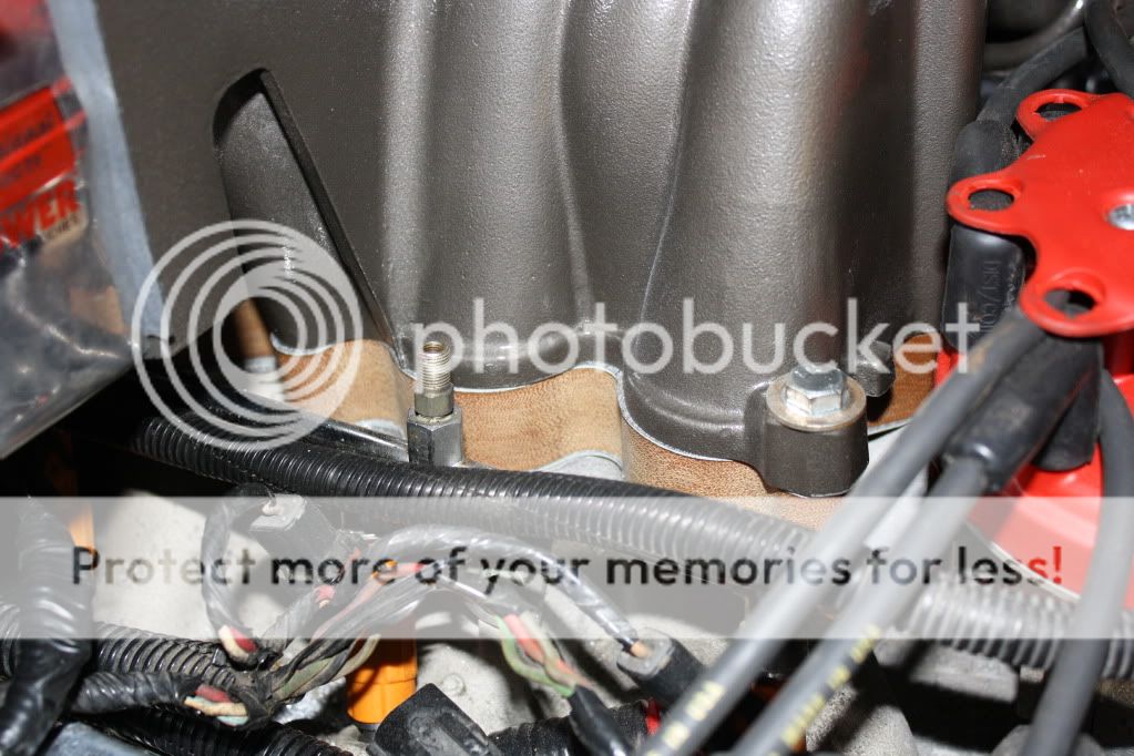

Now that your spacer is off, I took pictures and measurements.
Trickflow and new intake bolted on.
my B2

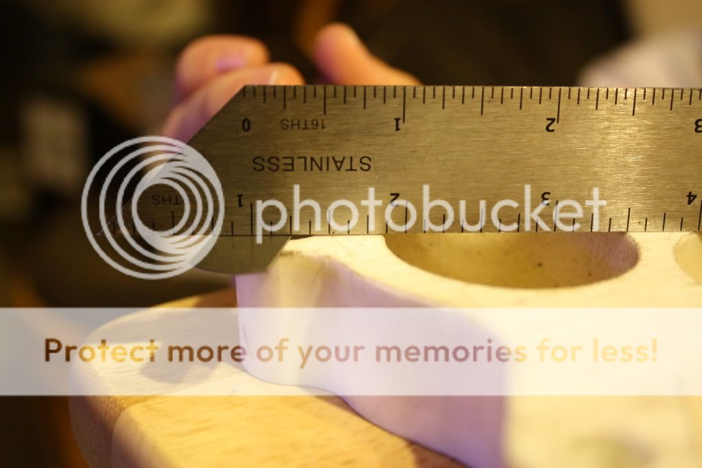

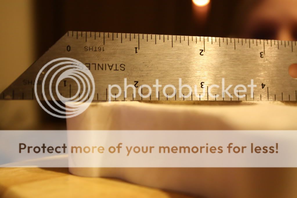

straight edge across old spacer, where my intakes broke.
my B2
.016" gap, on this side alone
my B2

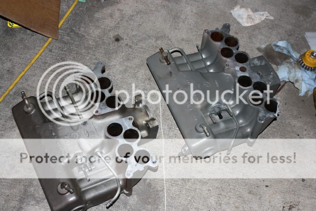

the first two intakes:
my B2

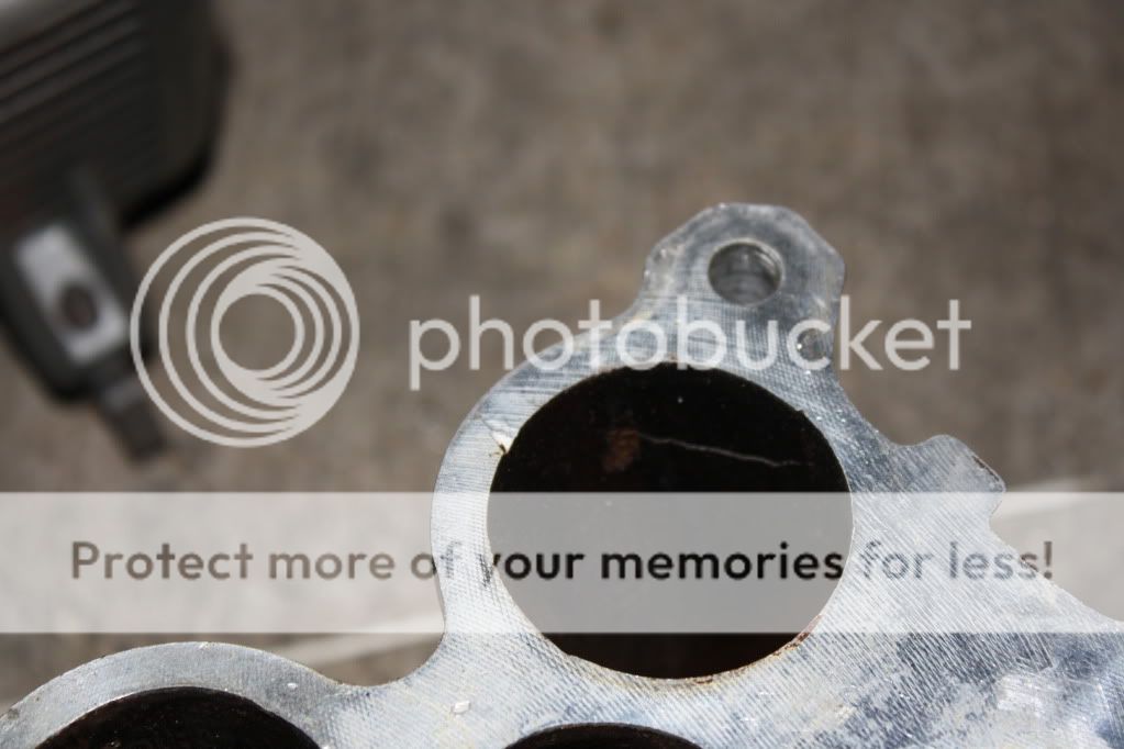

first one that broke, with full torque, snapped completely off
my B2
second one that broke, which only got about 8lbs before it cracked
my B2

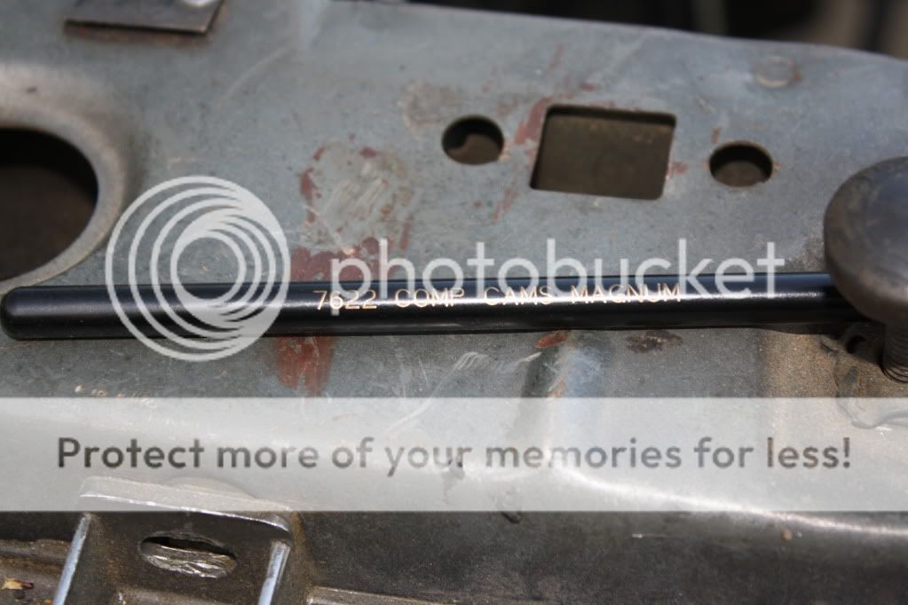

new pushrods, the rocker clatter is gone.
comp cams magnum series. 6.300"

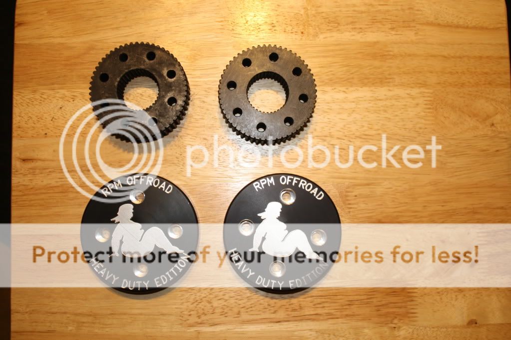

oh, and I forgot.. I got these:

who was the spacer from? thats bullshit...

dude....that outfit pulled some of the saddest customer dealings i have ever heard. awful ugly story really. worse is the end result...two broken intakes...awesome intakes at that..total bummer. i hope he steps up and does the right thing. most of us can understand with proper installation being the key in these situations, it is easy to have the preconceived notions get the best of you.....people ignorantly screw stuff up and expect vendors to make up for their failures which sux ass for vendors....but until it is properly investigated and objectively weighed the customer should be treated top of the line service first. i wont go any further then that.

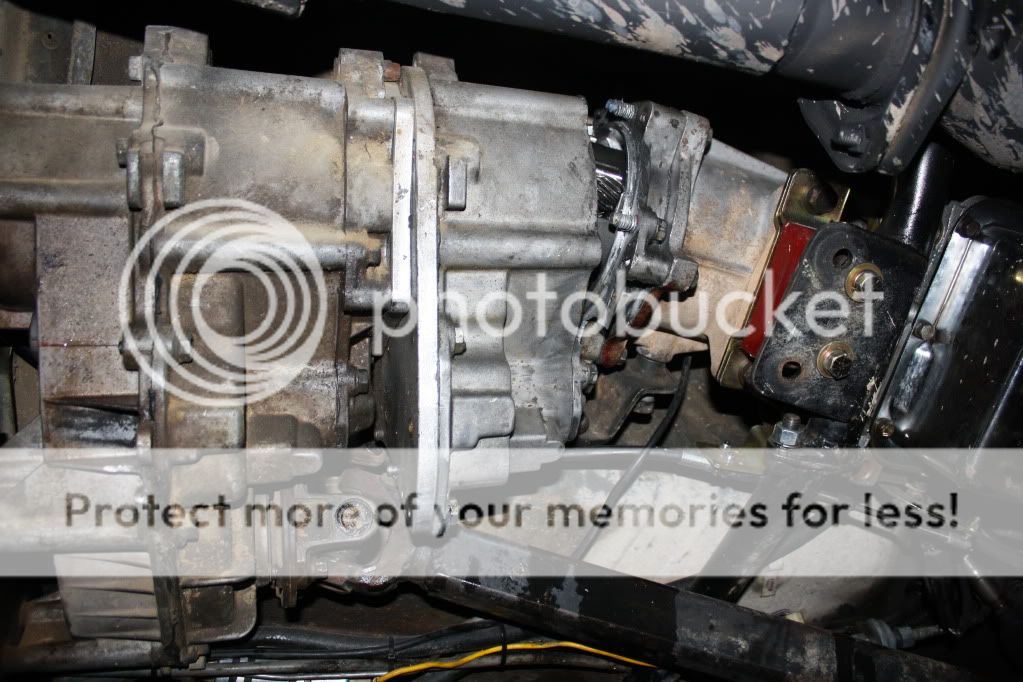

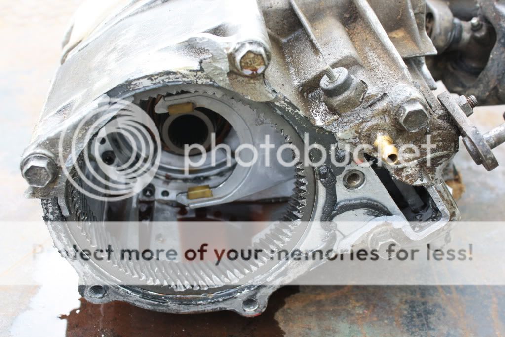

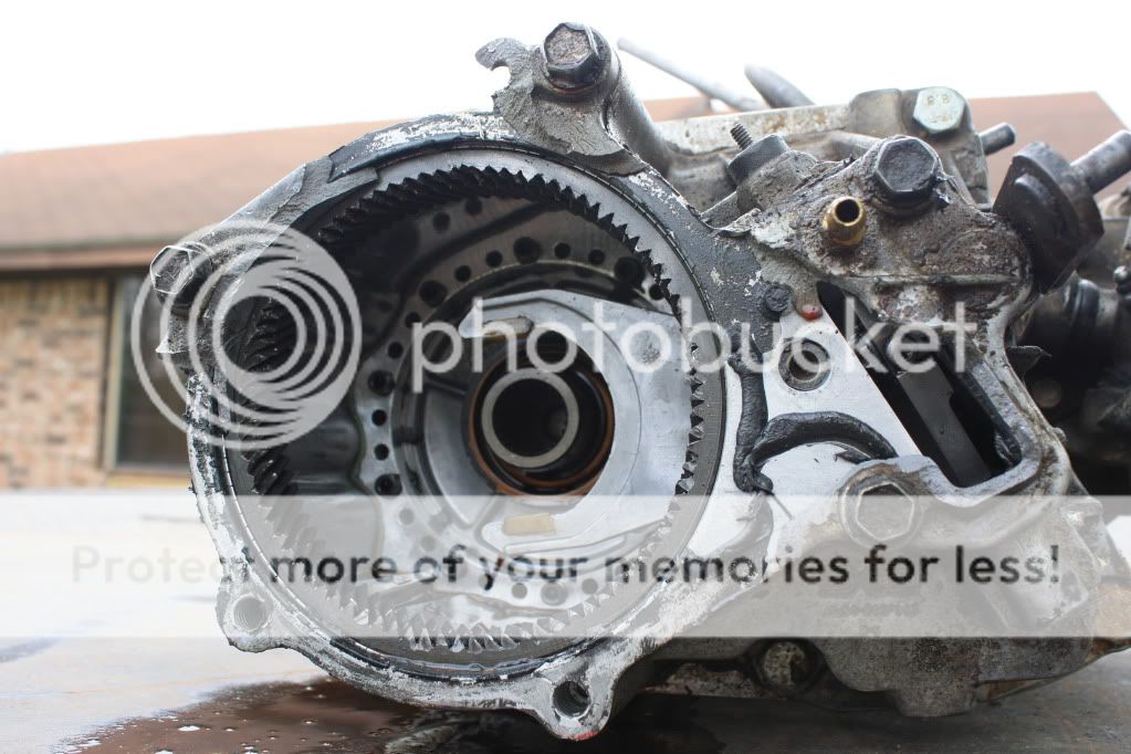

it broke its very first time out, in an unexpected place too:sad:
my B2
my B2
my B2
Oh No that doesn't look good at all. Who was that box through? Hope things get better and hold together for ya!
damn, did you thrash the shaft and internals or just the housing?
