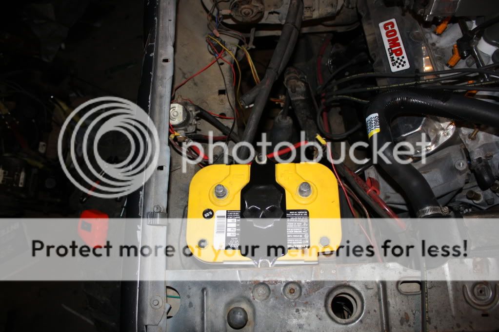

NMB2 July 2010 OTOTM Winner TRS Event Participant U.S. Military - Veteran OTOTM Winner V8 Engine Swap Solid Axle Swap TRS Banner 2010-2011 Joined Jul 25, 2009 Messages 1,444 Points 3,101 City Cody, WY Vehicle Year 1984 Transmission Automatic Mar 13, 2011 #197 so last nights working on the truck mostly turned into drinking. However, here are some pics.

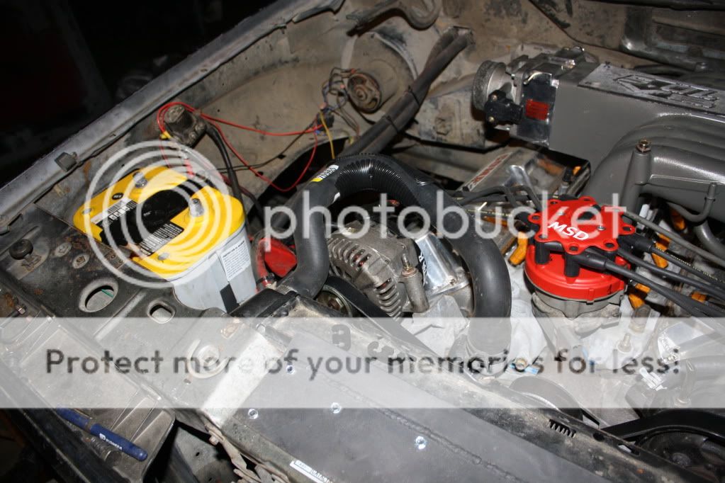

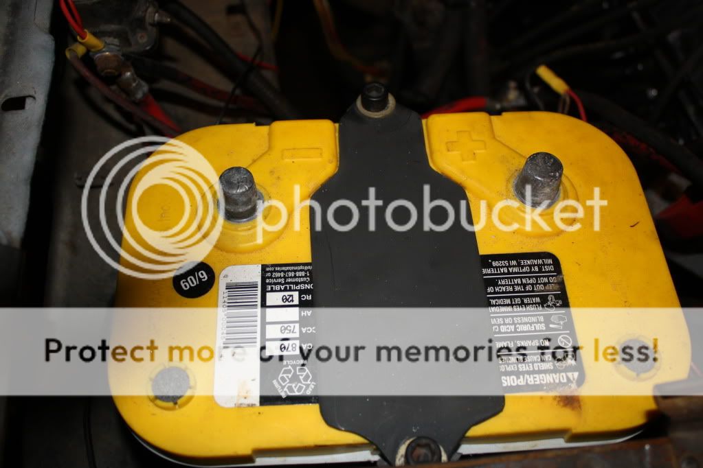

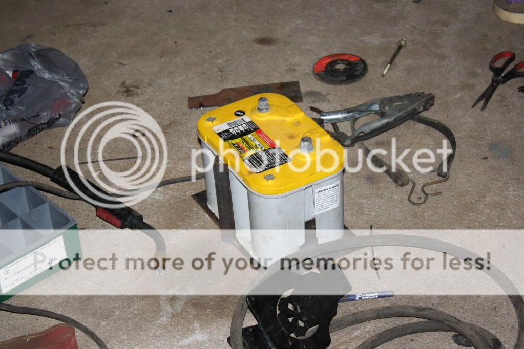

86 slo-vo 02/2011 OTOTM Winner OTOTM Winner TRS Banner 2010-2011 Joined Jan 5, 2009 Messages 4,510 Points 3,101 City owensboro, KY Vehicle Year 1994 Transmission Manual Mar 13, 2011 #198 battery tray looks good, need to make one myself

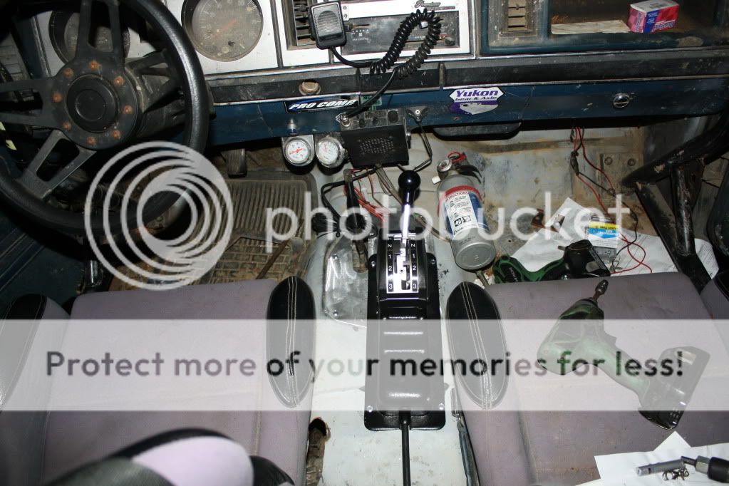

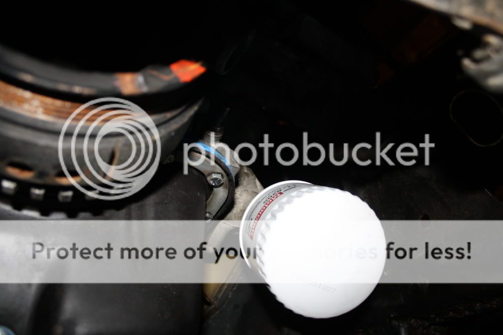

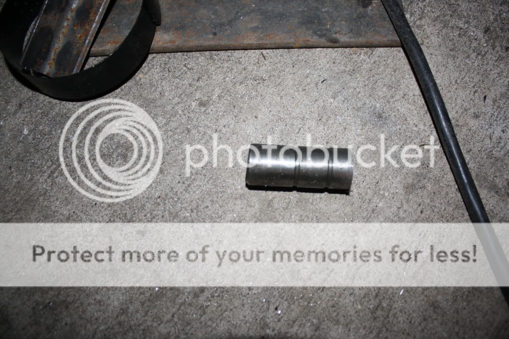

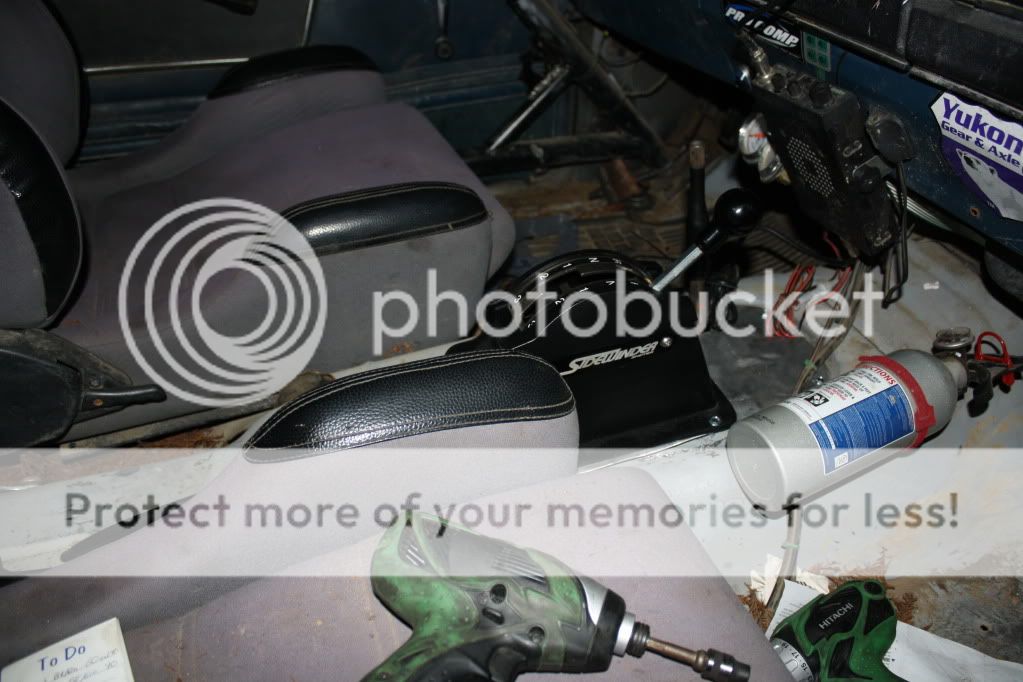

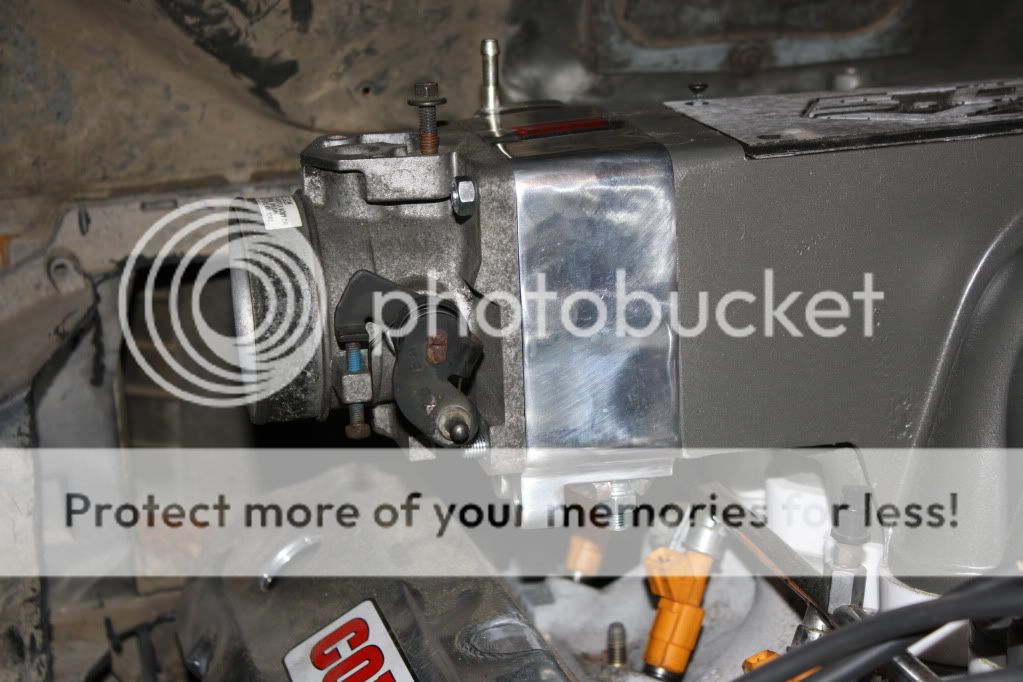

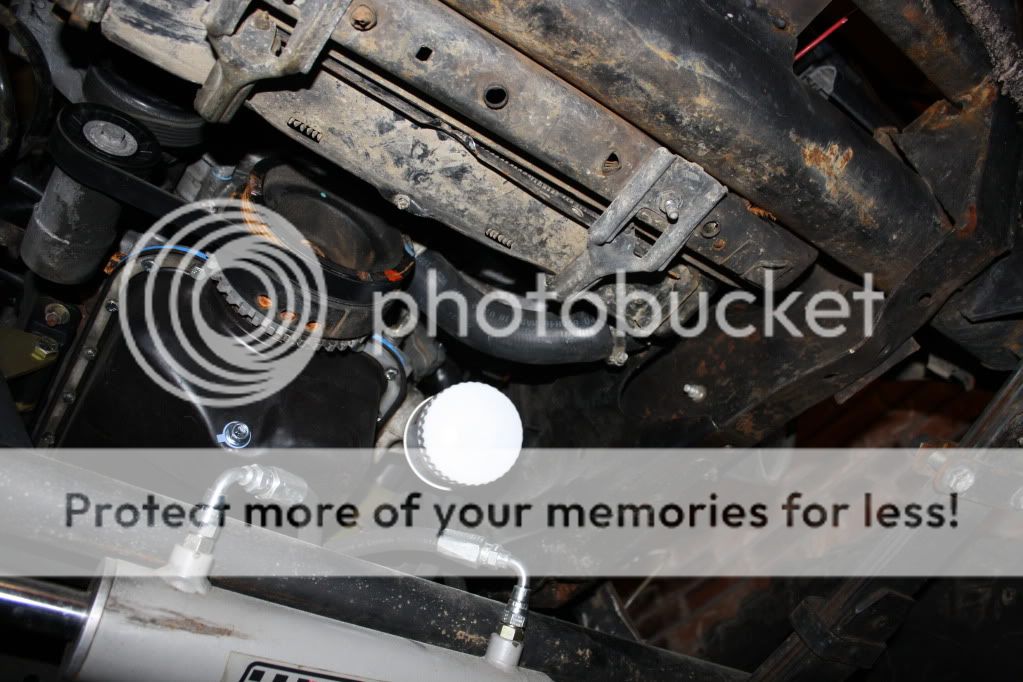

NMB2 July 2010 OTOTM Winner TRS Event Participant U.S. Military - Veteran OTOTM Winner V8 Engine Swap Solid Axle Swap TRS Banner 2010-2011 Joined Jul 25, 2009 Messages 1,444 Points 3,101 City Cody, WY Vehicle Year 1984 Transmission Automatic Mar 13, 2011 #200 Josh40601 said: did you take the ballistic top and toss it? Click to expand... no, I used it to trace out onto my other strap. I made my own 90* oil filter out of the stock exploder stuff. I pulled the through bolt out of the bolt that holes the cooler onto the 90* fitting. Cut the threaded/flanged ends off, put the allen key through to make sure they were perfectly straight, and welded them together. Its not a ballistic peice, but I had an extra skull and they look cool. Finished battery tray/top. aluminum cover for the 5spd hole. crawlbox shifter modified, and Winters Rock-gate installed, on the trans side as well.

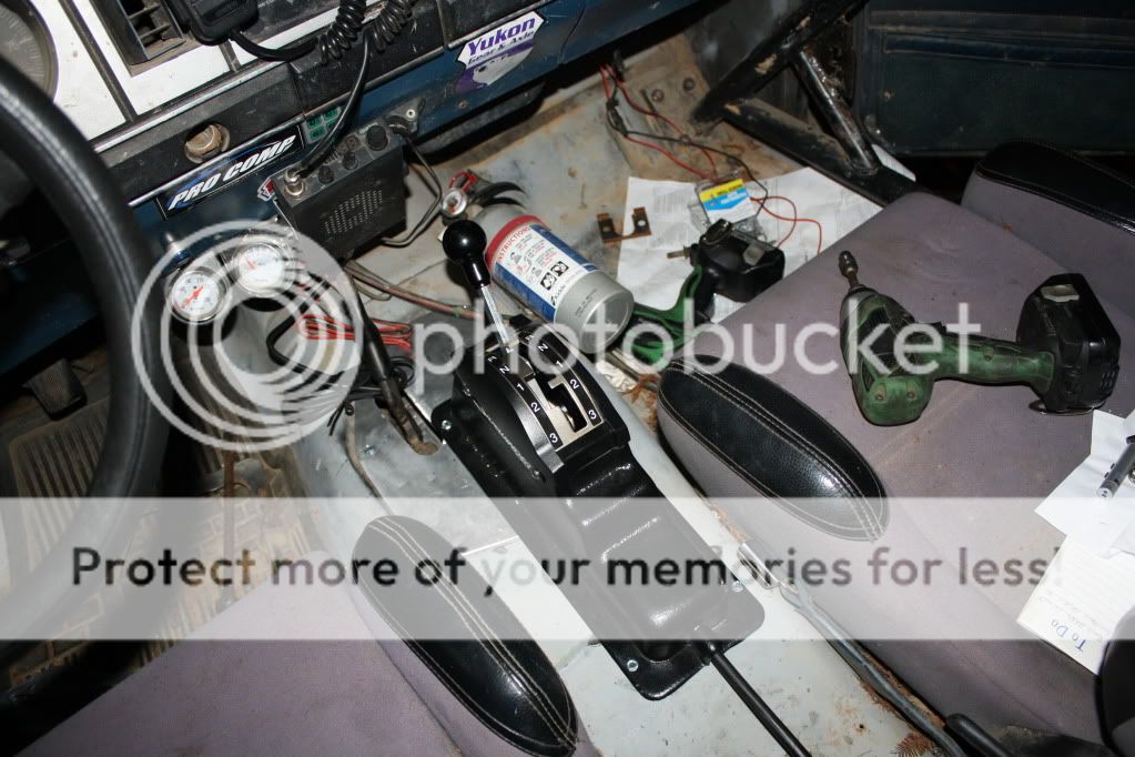

86 slo-vo 02/2011 OTOTM Winner OTOTM Winner TRS Banner 2010-2011 Joined Jan 5, 2009 Messages 4,510 Points 3,101 City owensboro, KY Vehicle Year 1994 Transmission Manual Mar 14, 2011 #204 i like that shifter, looks good in there

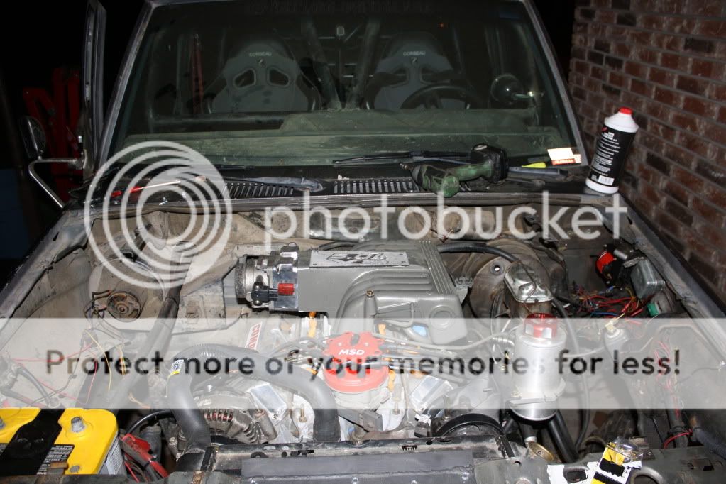

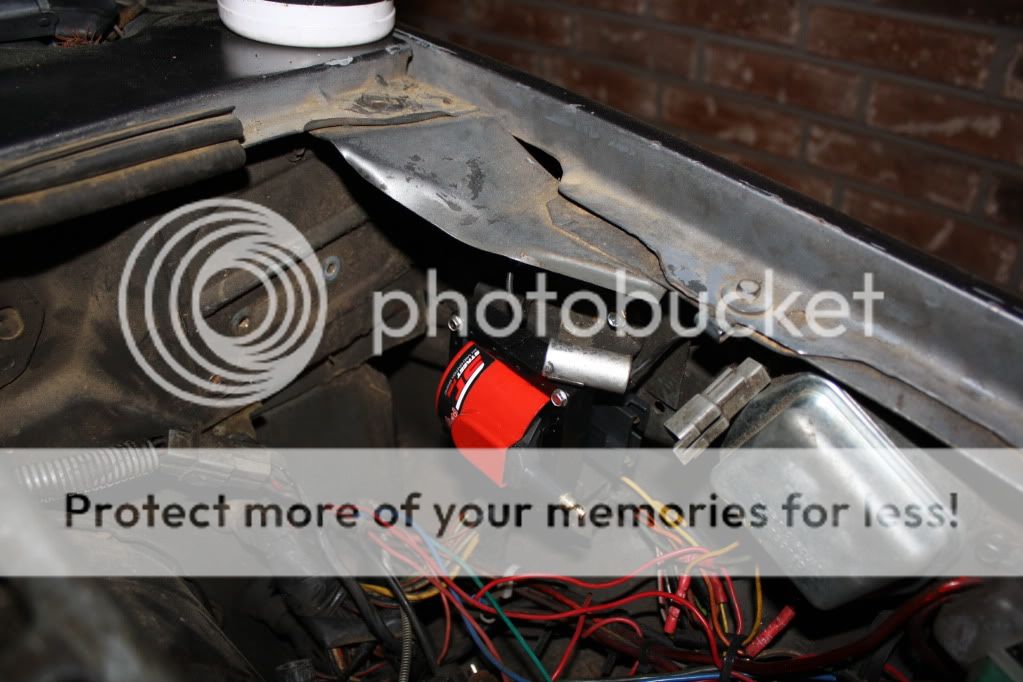

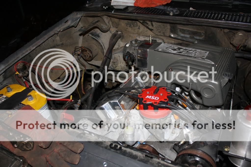

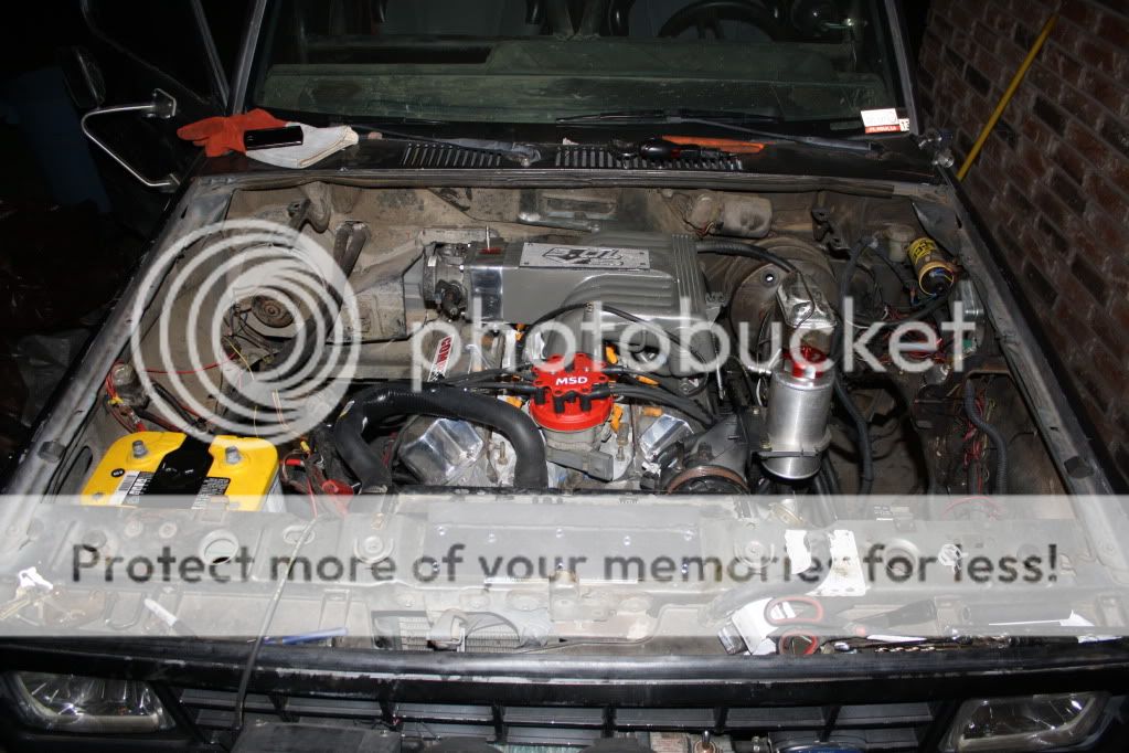

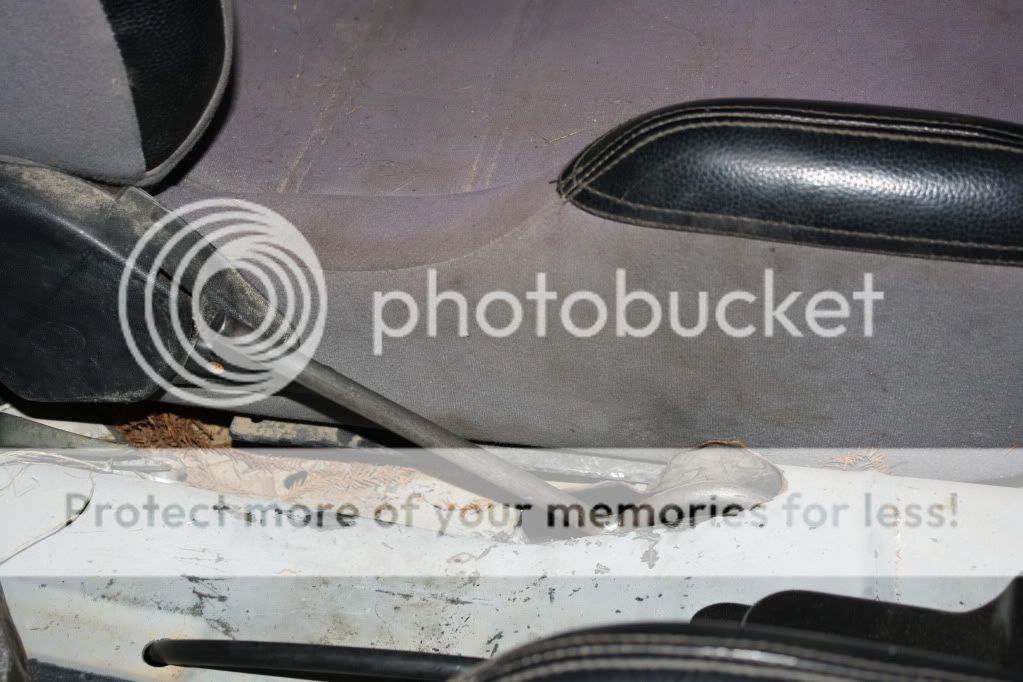

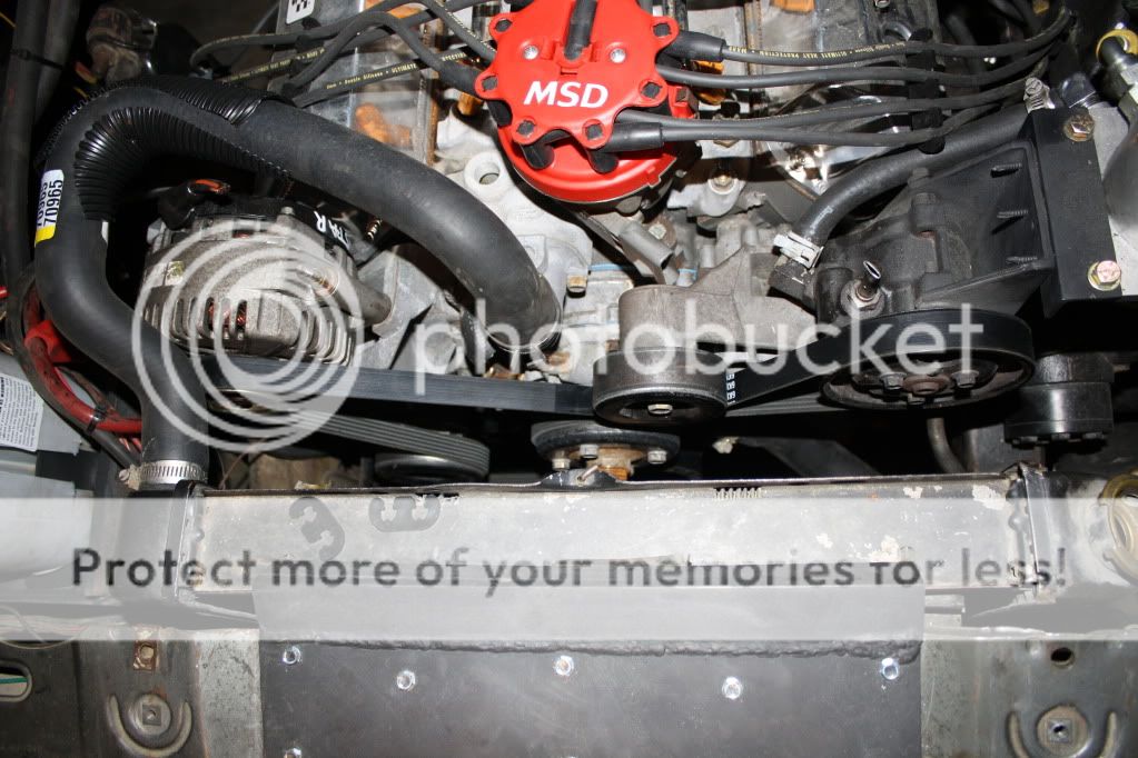

NMB2 July 2010 OTOTM Winner TRS Event Participant U.S. Military - Veteran OTOTM Winner V8 Engine Swap Solid Axle Swap TRS Banner 2010-2011 Joined Jul 25, 2009 Messages 1,444 Points 3,101 City Cody, WY Vehicle Year 1984 Transmission Automatic Mar 15, 2011 #207 got a functional shifter on my rear case, work on prettying it up later found a lower rad hose to work alternator found a belt to work with the A/C delete pulled old coil out, installed new MSD coil. Will clean out the rest of the unused wires tomorrow got a throttle cable installed and mocked up so after its wired up, will hook right up tomorrow I will be getting some packages hopefully. PSC parts to build my pressure line, fuel pump from Summit, and some intake parts.
