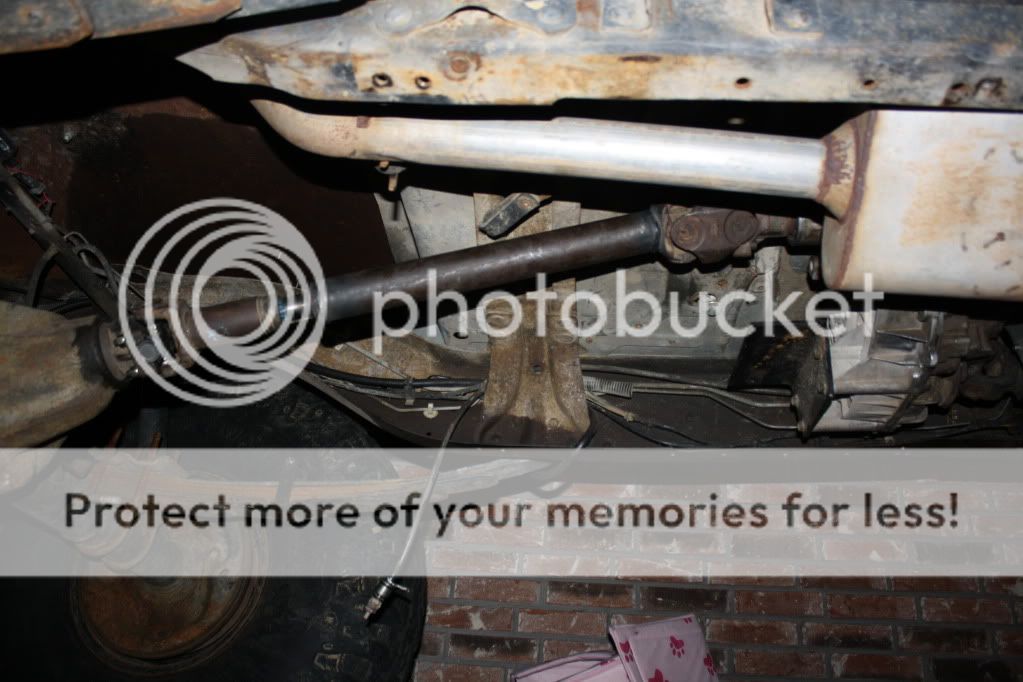

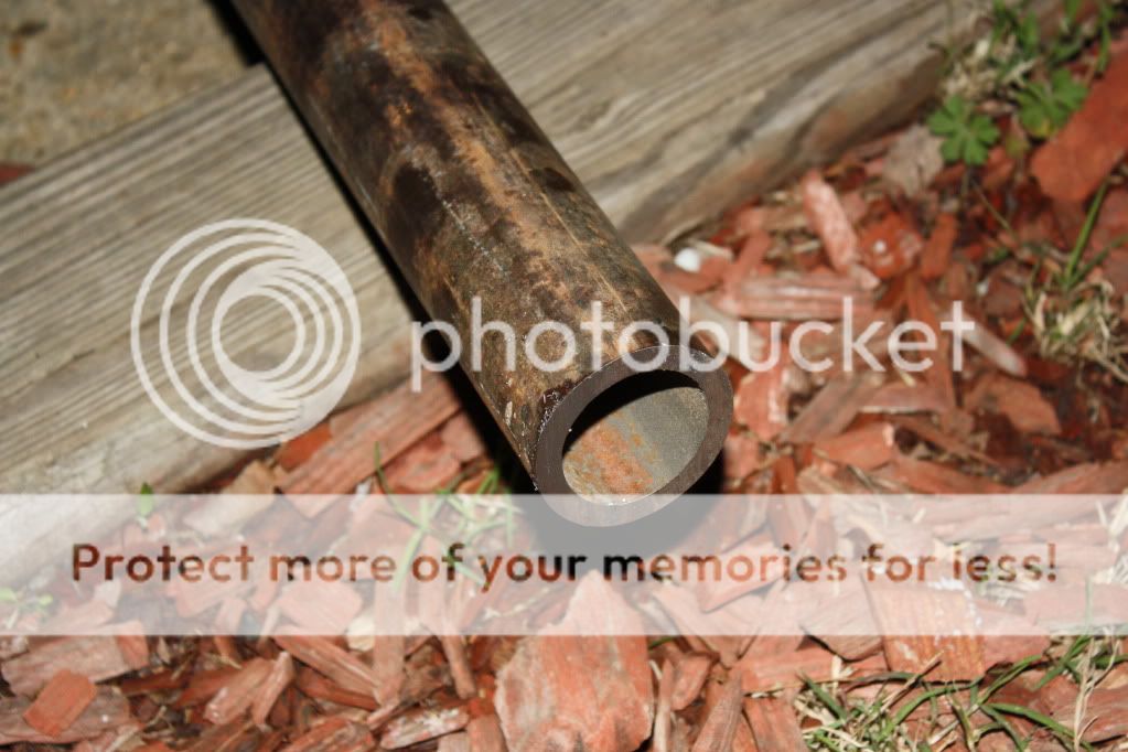

rear d-shaft finished:
material used 2" x .250" DOM

Damn dude, driveshaft/slider? haha. That thing is BEEF.

DOM is to expensive to use for a driveshaft! lol... i do need some to make long arms tho!
basically is a slider. front d-shaft is 1/4 wall also, just square.

driveshafts hit the same rocks that your links do, and twist. I dont chance losing something like a d-shaft.

that's what I was gettin at foo. I would think DOM is good too since it'll be more concentric than pipe or HREW. Easier to balance (or not even need it).

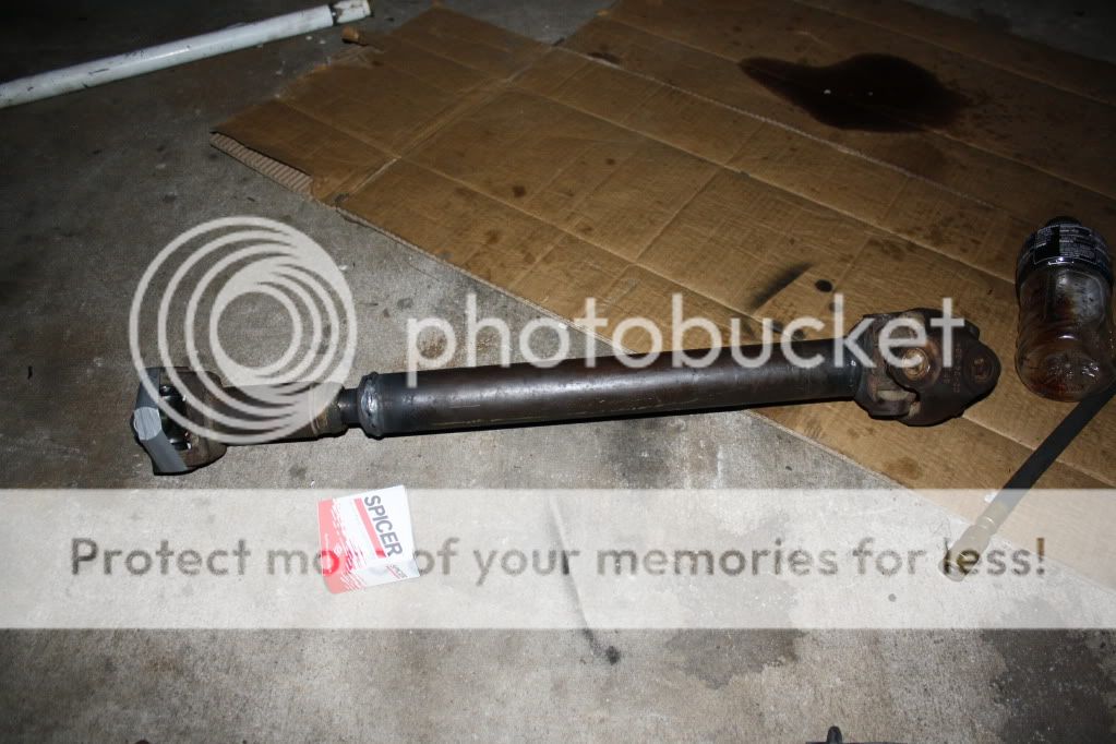

I twisted two just like the first pic on my 79 CJ. Most likely will do the DOM thing to mine once i put the 14 bolt back there.

sure did. Here is proof

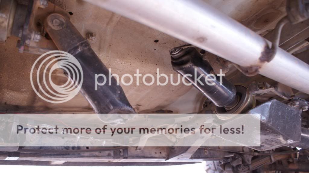

Here is the rig that did it.... and there is my Ranger...
