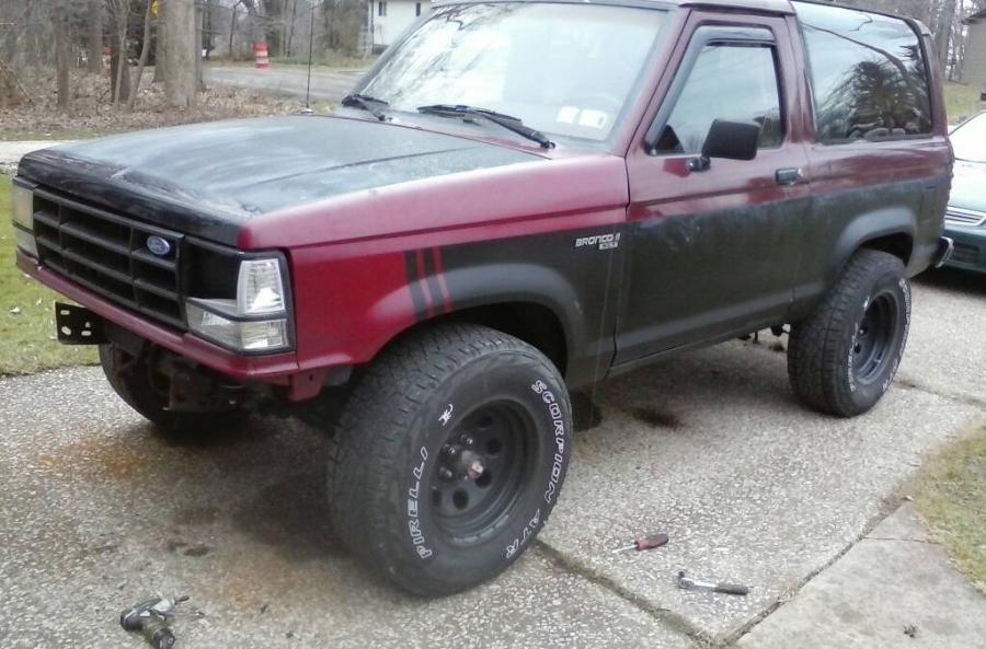

Well heres a pic of the new fender on. Trying to get everything straight and even with new parts its proving to be a challenge. Im not looking for a perfect finish but everythings crooked lol. Mostly its the driverside inner fender throwing stuff out of wack.

Looks good so far. Did you use any shims to help align the fenders? Just a thought. Looks like a good paint match too. I'd lose those mirrors, always disliked how small they are.
Sent from my LGLS991 using Tapatalk
Thanks. The paint is close enough people wont notice at first glance. Its just burgundy krylon rattle can. I didnt use shims i just kinda hung stuff to see where its at not finished fitting everything yet. I dont care for the mirrors either. Havent got around to getting some better ones. I do really like the bigger chrome ones.. Maybe ill get a set and paint them black or something. I know the brace for those mirrors is in the door so all i have to do is drill the lower holes.

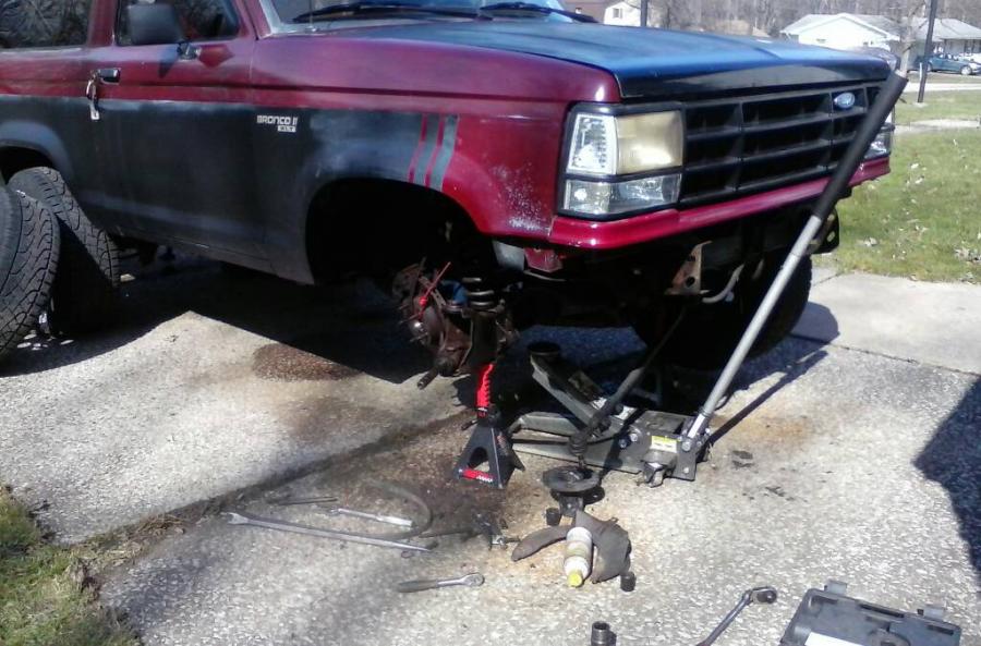

Today i did the upper and lower pass side ball joints. Im hoping the camber is fine.

Well it took me from 11am to 6pm to do the ball joints. The guy at oreillys didnt give me the "4wd adapter" for the balljoint press so i spent a good amount of time trying to get it to work without it and eventually called them and had them send one to the local store. It only took me about 45 mins to get everything apart. Another big time eater was trying to get the hub off the spindle so it would come off the truck. The hub was frozen but i got out my air hammer once again and eventually got it off.
