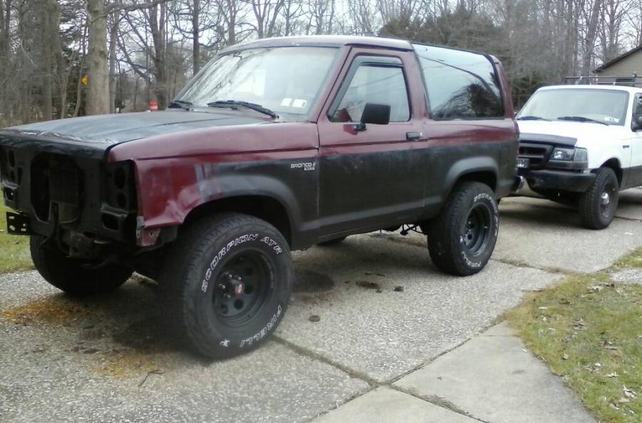

Here is an updated pic. The jackstands are gone lol.

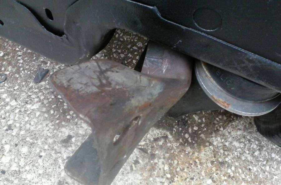

Now the question is... What do i do with that?...

Is that the front end frame? If so you've got your work cut out for you. Body shop or BFH action I'm thinking.
Sent from my Alcatel9007T using Tapatalk
Yeah that is the driver side frame rail. The pass side is still straight. I wish i had some chain falls and some anchor points. A comealong or something. I might try heating it up and a bfh/ jack under it. Its bent all kinds of directions.
Like ive said before i think the easiest thing to do would be to cut off the bent stuff and weld and fishplate a new stub. Where do i get one though? Lol i did manage to get a front stub however i didnt realise that 88 and back is different.. I could put the 88 style bumper on but it might look dorky. However those parts are in the back of my 57 which is in storage for a couple more weeks.

Yeah, I'm no help there. My welding leaves a lot to be desired lol. That's why I said body shop. Are you sure that's the only place bent too? I wish you luck with that one.
Oh this thing was bent when it rolled off the factory floor lol. Though from the accident i can tell the whole body shifted back atleast a quarter inch. I did drive it after the accident and it pulls hard to one direction so it could be totally out of wack.
The plan atm is to get everything as straight as i can, replace the pass side lower ball joint throw insurance on it and drop it off at an alignment shop and see what they say.
My welding isnt pretty but ive never had anything break lol. (Knock on wood.
